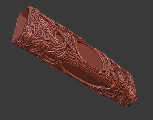

Still a long way to go- this is an extremely difficult prop to get right, but here's a w-i-p where the squiggly details have been generated by images of the real (well, CGI) prop:
The detail level is so high now that every command I do, like selecting an object, takes the computer 20-60 seconds to react to. (And more complex functions, like cutting parts, can take minutes-to-hours!)
Hopefully I'll have parts in the printer tomorrow for another test (and a junkyard thread up soon).
Another model render that shows off the details. It's not the final model... some tweaks still to be made, like compressing the midsection, but I'm fairly happy with the surface detail overall. It also has the correct taper at the ende and slight convex shape. With a bit of luck, I'll have a first successful "final" print this week.

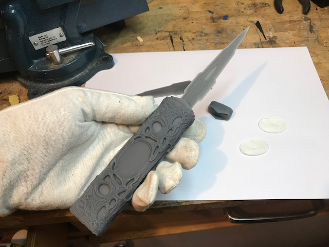

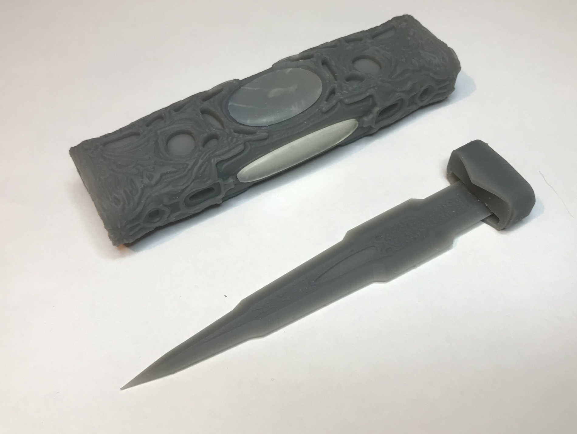

I did a test print of the above file that turned out great, and will post a photo as soon as the paint dries.
Tweaked, final model, of the main body.

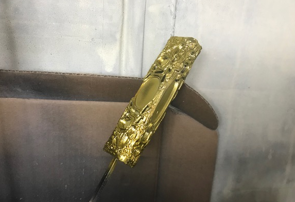

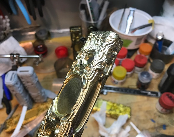

Molotow chrome base, with a thin layer of Alclad gold candy on top, then 2-part urethane based auto lacquer clear. I wanted a very pale brass color and all the pre-mixed brass or gold shades you find (including the ones from Alclad) are always too dark yellow-orange, and not as shiny. One this gets some nice layered washed of black and dark brown, the extra shine shoudl really make it pop.

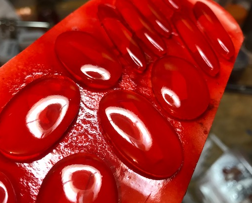

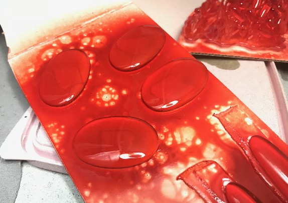

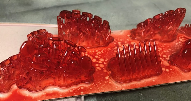

Jewels were sprayed with Tamiya clear red (you can even brush that stuff on... do it thick enough and it will even out the brush strokes as it dries). Then given two fairly thick clear coats- the final one is the same 2-part auto lacquer. Take about a day to fully cure, but is worth it!
Many of the stones are so small, I left them on the sprues while painting:
Some more progress. Reprinting the smaller gems for the third time now to make them easier to install.

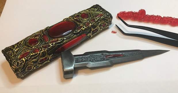

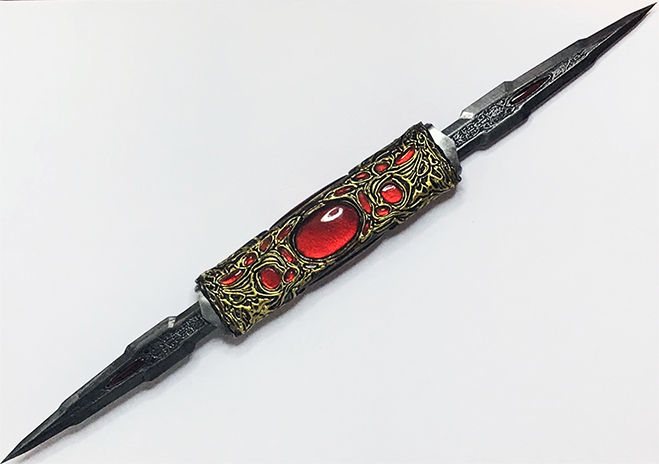

Now, photos. (Note: I haven't glued the blades in place yet.)

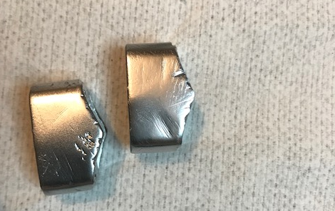

Main blade gem is printed, the two small ones are clear epoxy glue mixed with a couple drops of paint. Blade was painted gloss black, then slightly scuffed with 400 grit wetsanding paper, then painted with Alclad chrome, then washed with a Citadel Contrast paint, then rubbed with graphite powder that was polished into the blade with a wet cotton swab.

Not a huge update today. Been printing even more size variants of the gems to get a good fit that is also easy to install. (The ones installed here were slightly too large near the bottom, so I had to trim them with a scalpel. It took the better part of two hours just to do what you see and I want to cut down that time considerably. So, I've made all the smaller gems tapered towards the bottom and decreased the size in 0.5% increments until I reached what I hope to be a good level. Waiting on the paint to dry right now so I can install them and have the first finished copy.

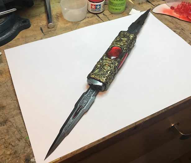

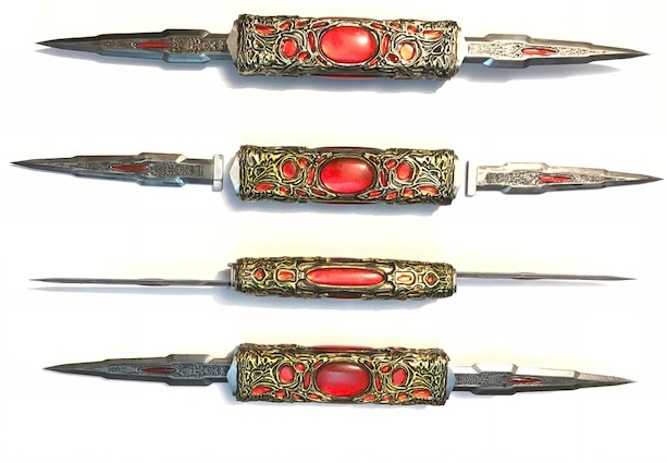

Another shot of the almost-finished proto:

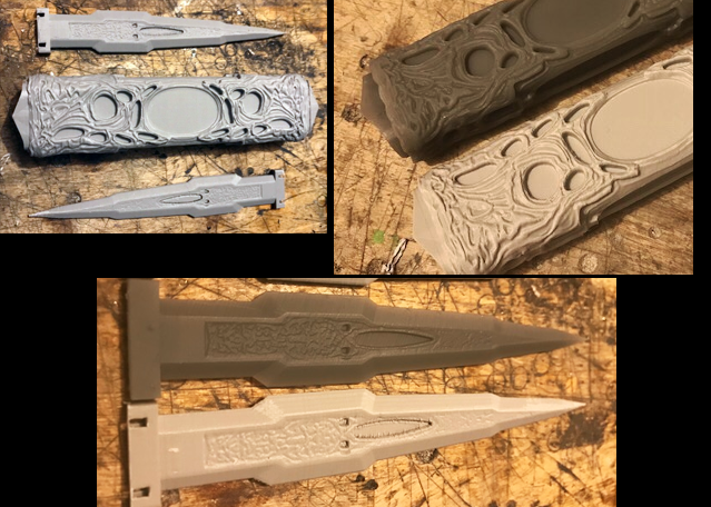

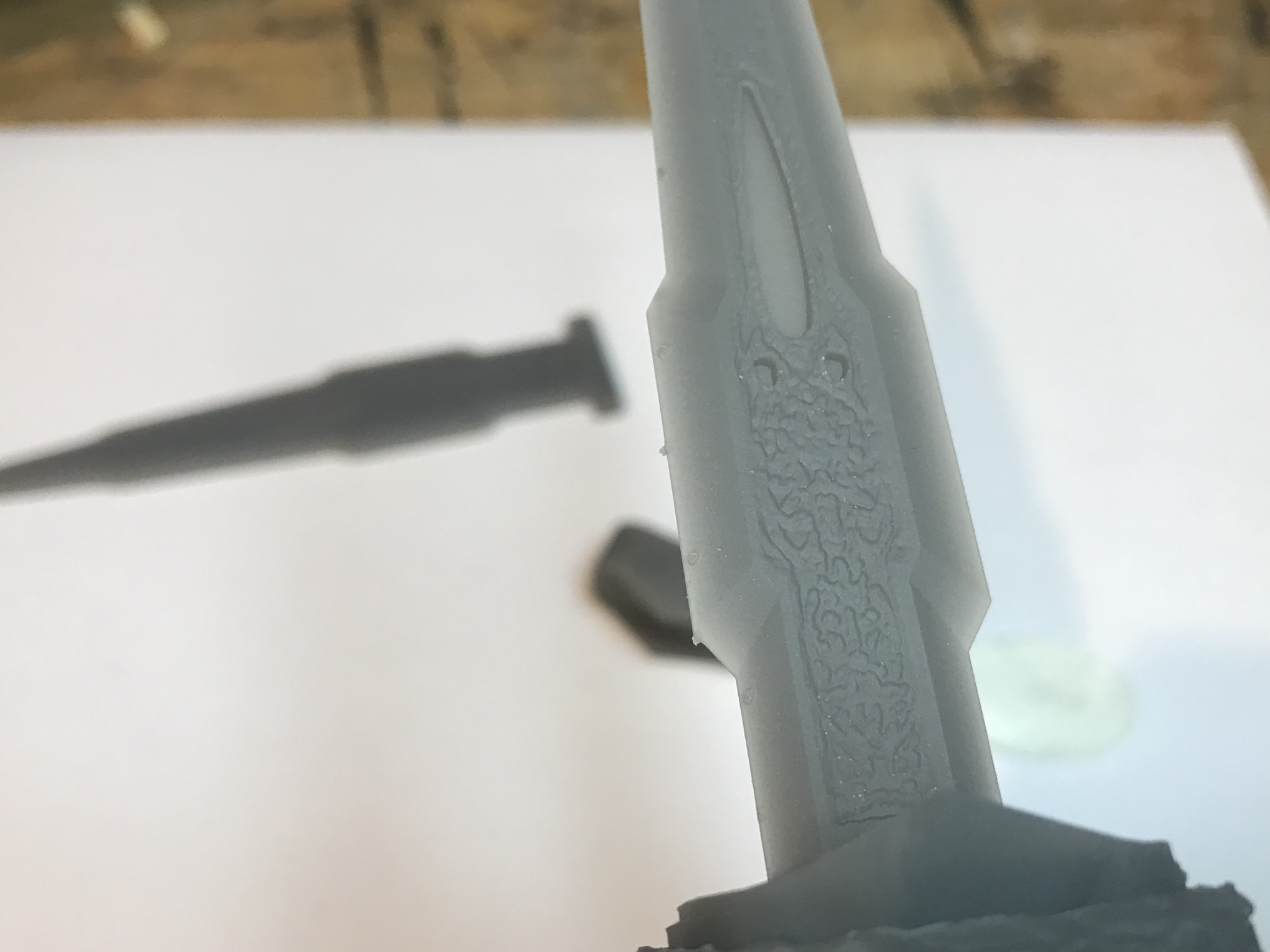

As an experiment for a possible (currently shelved) low-cost run, I managed to get it to print rather acceptably in PLA after a bit of work. Details are softer, but I'm surprised it turned out this well. The difference is more noticeable in the blades. I also added slits for magnets in both the blades and the body. (The slots are visible in the PLA blades because the minimum wall thickness has lower tolerances than the resin. They would not be seen when the blades are mounted anyway.)
Still some more tinkering and finishing up to do, but I'm happy enough with it so far.

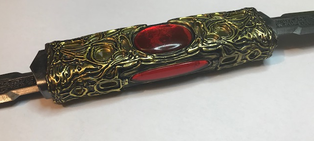

Trying a brass-tinted paint that is a little more pale:
Becoming obsessed with painting gems...
The CGI screen prop is pretty dinged up at the ends. I modeled the blade seats "as new" but decided to carve out some dings and scratches in my own copy.
Rare earth magnets added. Tested the functionality this morning and it seems to work great!
