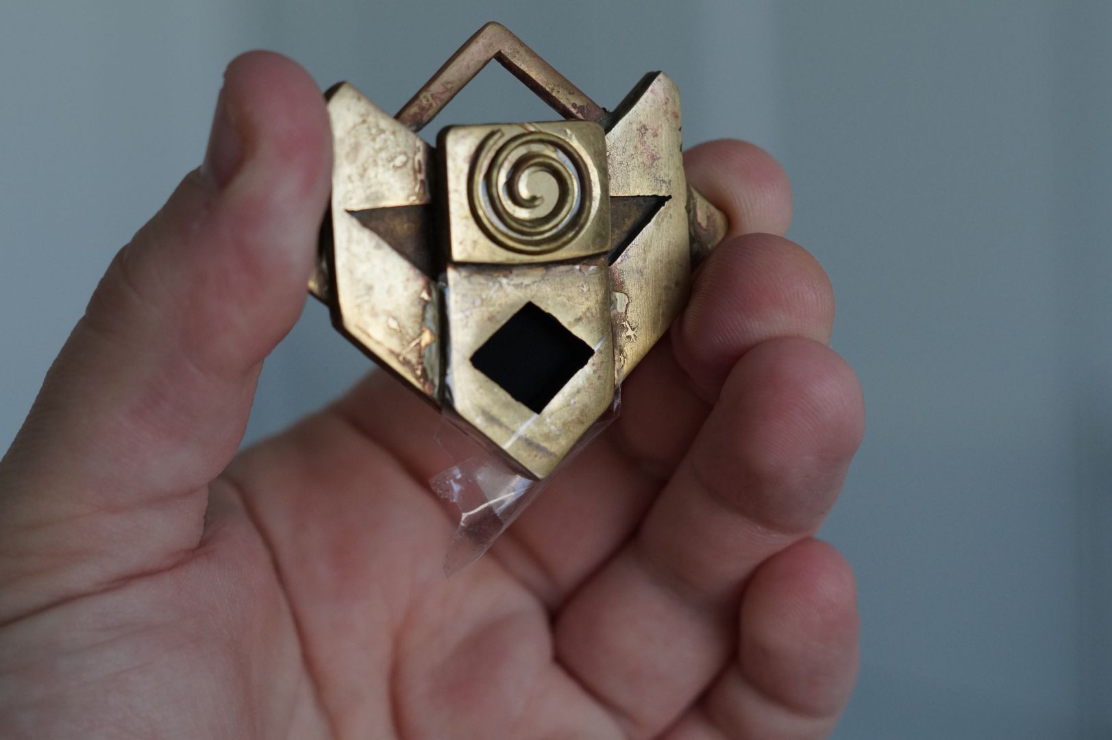

After some metalwork researching, I revised the surface of the medallion. It's far away from perfect but now it looks much better.
I guess this is how it looked like thousands of years ago before the story of Fate of Atlantis :). Progress can be seen in this series.

We are approaching the finish line! After a lot of back and forth, I got the final finish. Unfortunately, the variant above did not work because the green rust is not stable. Besides this it's toxic and there is no real option to seal it. So I wanted to darken it more with vinegar, but one time I checked it, it was all red - It looked like the necklace got a sunburn. I am pretty sure that the acid removed all the zinc so only the copper remained. Anyway, again - Slightly grinding, slightly polishing, and back into salt-water.
But then I got it - I knew immediately that this is the look the medallion is supposed to have:
The glue is still visible but I will grind it a little. I also finally found a solution for the spiral. After trial and error (actually more error than trial) I got the idea to simply use some cheap brass earrings which worked perfectly.
Besides the chain there is one significant part is missing, but this will be the last step after I did a lot of photographs because this can irreversibly mess up the whole thing.
