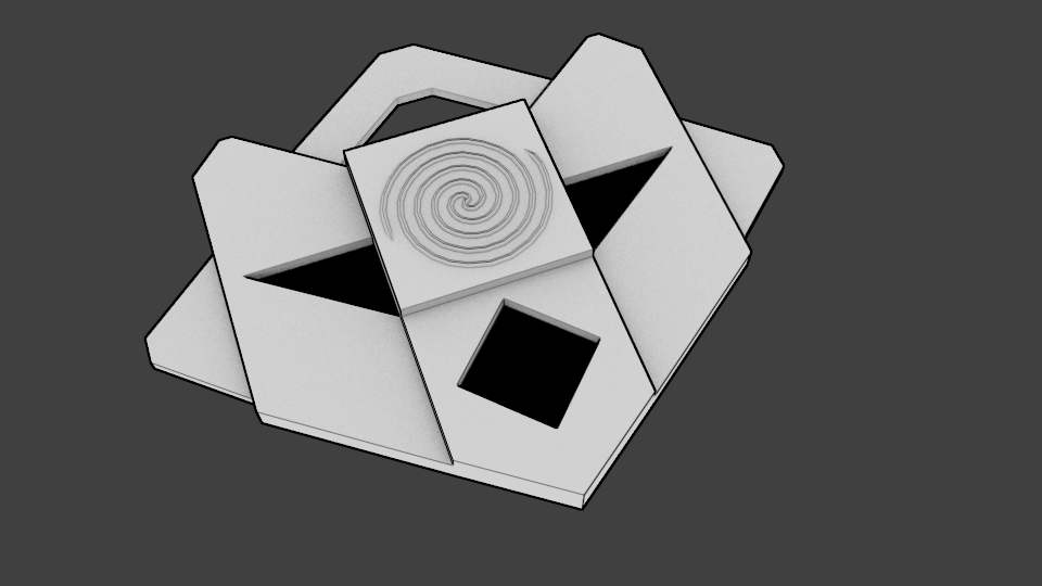

I used my 3D model to print out lifesize templates of the different shapes so that I could use them as reference, which helped immensely. I know the sculpt isn't perfectly exact, but I'm fairly proud of how it turned out. After around six or eight hours, I decided it was probably as good as I can get it and poured the silicone for the mold. I'm hoping to pull the first cast tomorrow. It's just going to be resin, but maybe after our Disney trip I'll pick up some of that cold-casting metal powder and see if I can do a brass-resin cast.
3D model made in Blender.

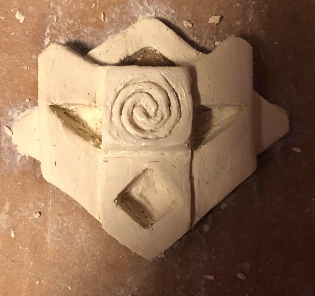

This is about 3 hours in, most of that time was spent just trying to get some clean lines in the super wet clay.
Added the eyes and goofed the mouth so I had to fill it up and try again.
I think this is like 5 or 6 hours in. I left it to dry a little bit so it firmed up and tried to straighten the angles and fix the symmetry a bit. I was super worried about the spiral on the forehead but it came together fairly easy - obviously it's not super clean and perfect but the impression is there and I kept telling myself "it's supposed to be from like 9,000 BC it doesn't have to be exact"
Here's the finished sculpt before molding. Added a slight texture all around and gave it some dings / scratches / chipped edges for some character and to try to draw attention away from some of the symmetry problems.

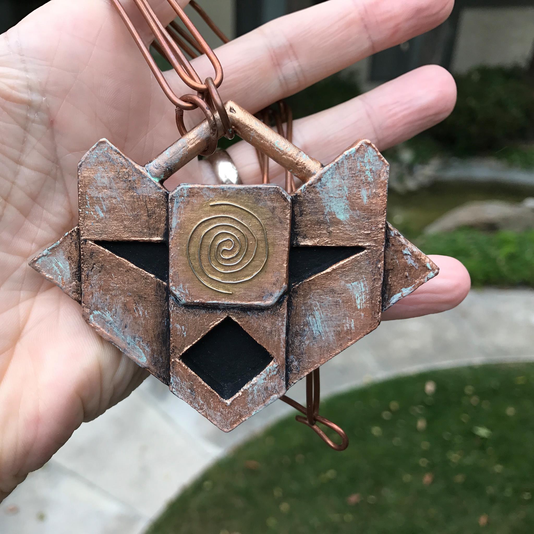

Greg Frost
Here's a version I made a couple of years ago, using layers of cardboard cut out and glued together. I cut some copper grounding wire for the chain.

Greg Frost Could you tell me where you got the chain from? I am looking for sth. like this (long and short parts alternating) but I found nothing appropriate so far..
Greg Frost
The chain is actually really easy to make out of solid copper grounding wire, which you can get from any hardware or electrical supply store. I think it's #6 AWG or similar, because that's what I had, though smaller diameter wire (#8 or #10 AWG) would have been easier to work with. Copper grounding wire usually costs $0.40 to $0.70 per foot; four feet should be plenty to make a chain 18-20 inches long, including the clasp.
I used a dowel as a mandrel for the round links and a yardstick as a mandrel for the long links. It's the same process you would use for chain mail links: you wrap the wire around the mandrel multiple times in a tight spiral, then slide it off and cut the rings apart. If you don't solder the links together after assembling the chain, you will want to file down the edges so they aren't sharp.
