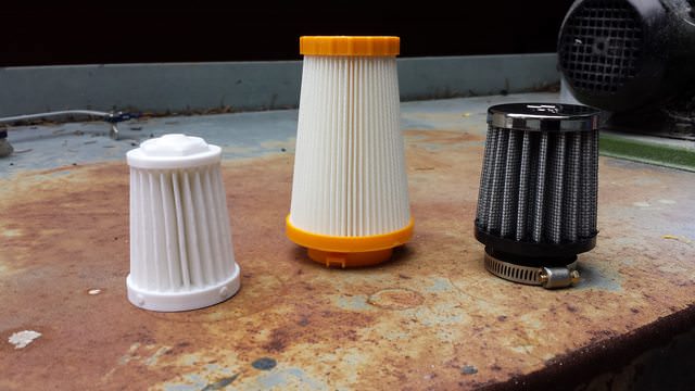

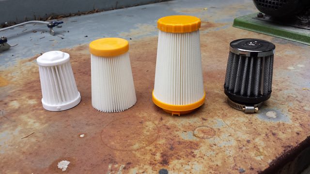

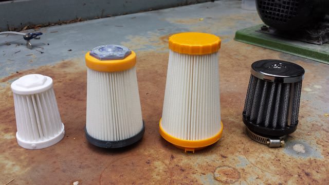

Truth be told, I was not satisfied with the K&N filters I had just due to their squat profile. I ended up rereading the other Immortan Joe thread and saw that Bigboss1o1 had found Dirt Devil F2 filters that looked kinda close to the part - and also that they were the kind of thing my local Walmart carried. I took a quick drive down and bought a pair just to toy around with.
My print on the left, Dust Devil filter in the middle, K&N on the right. The print I came up with was eyeballed as best as I could based on the scale of the phone pad right below the filter, which I have for reference... but that's not to say it is entirely correct. The Dust Devil filter was obviously a bit too long, but it had a better profile in line with the sort of thing I was shooting for. Soooo...
I trimmed it down about three quarters of an inch off from the bottom, to make the outside diameter of the filter at its widest 60mm. Then I modeled up and printed a quick bottom 'cap' to test out:
I actually think, out of all the options, this one is my favorite right now. I sanded the little grip nubs off the top cap and I think I can get away with painting the filter to look like the movie one.

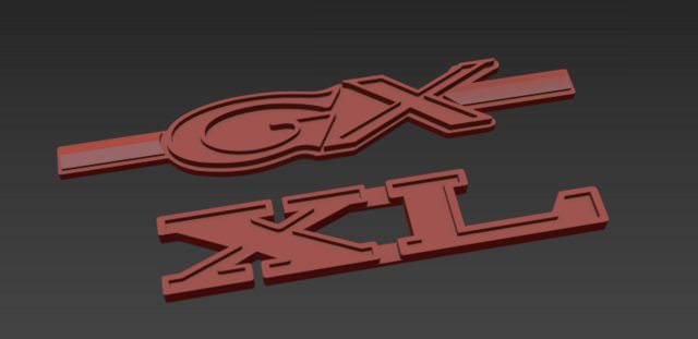

Here's the 3d models I've come up with for these so far.
I know Hamsterstyle came up with 3d files for these same badges in the other thread, but I always had trouble printing them as it looked like a lot of the normals were flipped. My other rationale, in truth, was that I wanted to make sure I could offer the complete set on Shapeways, which meant it had to be my own work. :p
Once I've confirmed these print properly and at the right scale I will add them to the OP.
