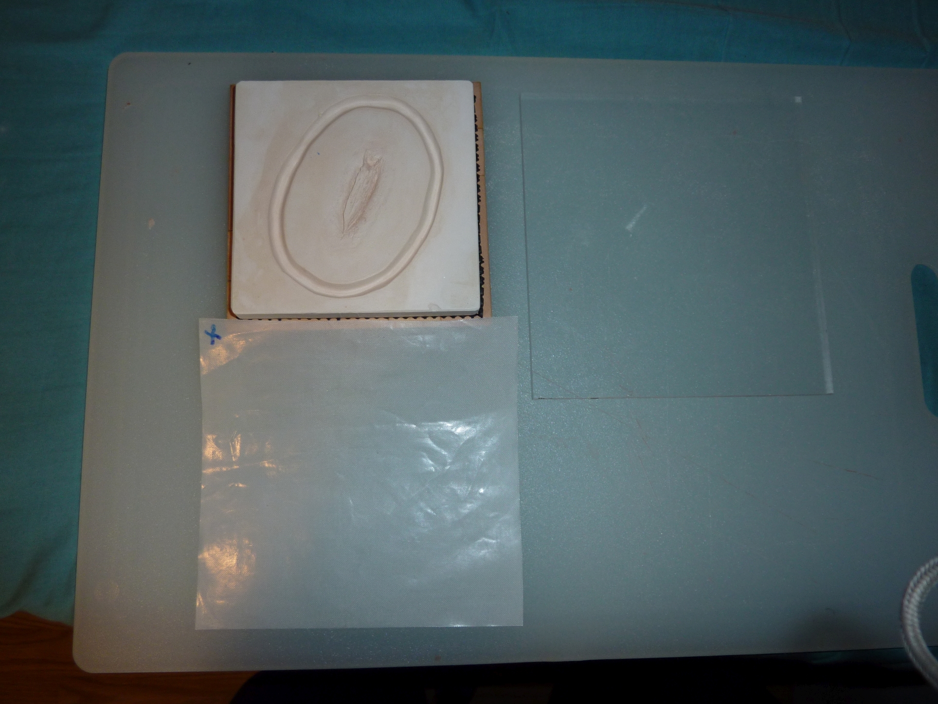

I will start this from already having a flat prosthetic mold. My molds have all been made from hydrocal. I seal them with Smooth-On "Superseal" and use the 205 Ease Release.
Things you will need:
1.) Clear piece of Plexiglass, I've been using a 6" X 6" - 1/4" thick
2.) Heat Press Teflon Sheets
3.) Microwave safe container filled with Witch Hazel
Cut a piece of the teflon sheet a little bit bigger then the plexiglass. Heat up some gelatin in the microwave to fill the mold. It doesn't have to be perfect, but make sure all the detail is filled and there is enough extra that will spread out.
Cover the gelatin with the Teflon sheet (rubbed with Pam) and then place the plexiglass on top and press down a little bit.
Take the mold, Teflon sheet and plexiglass and put it in the microwave.
It doesn't take long depending how much gelatin was used in the mold.
Try under 5 seconds on high then quickly open the microwave door and carefully push down the plexiglass to flatten the gelatin. You can also try using a microwave safe weight. I have been trying out a container I filled with sand so I don't have to push down.
Take it all out of the microwave after a few minutes of cooling. Take off the plexiglass.
You should be able to see through the Teflon sheet were the gelatin is very thin around the edges.
When the gelatin is cool enough slowly peel off the Teflon sheet.
Powder the back of the prosthetic and carefully pull it out from the mold using more powder on the front side.
