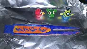

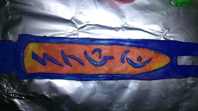

thanks guys... meanwhile, been playing around with fimo modelling clay and have had a go at the blade for my dagger. I based it roughly on some pics I found in the gallery here so thank you to whoever posted them. Its cooking in the oven at the moment and if if comes out fairly ok, I will try moulding it and then make the handle for it. the lighting bolt symbol is the symbol of the clan, the rest of the symbols are invented.. probably with some Vulcan influence, lol.

Does the whole "two part mould" thing even work with latex? Or will it all fuse together when the second half is poured? I suspect I will find out tomorrow. (yes, I know, I should have bought silicon) and I really must remember to put in a hole to pour the resin in otherwise I will be in trouble. I remembered to put keys in and I remember reading something about pry points which makes a lot of sense. I wonder if a bit of vaseline between the layers will help?
*pokes it again* Nope... its still not dry...
I don't think you can make a 2 part latex mold, since it would only create a "seam" like a latex mask if you poured more on the other side.
I'm with xdmray - What are you molding ? We could be of more help if we knew the application and had some pics.
I think she's moulding the knife blade that she modelled out of Fimo?
[The knife is] cooking in the oven at the moment and if if comes out fairly ok, I will try moulding it and then make the handle for it.

sorry, should have been more clear. The knife blade will be made from resin and yes, that's what I am moulding. I might try putting a layer of tinfoil down to separate the layers (since Ive started theres nothing to lose by trying it before spending more money) I posted a pic of the the plastecine version, will post more when and if it comes out the mould ok.

If your making a 2 piece latex mold you will most likely need a hard outside shell to hold the latex in shape. You can use vaseleen between the 2 latex halves so they do not become one. You will need to make the hard shell while the part is still in the latex mold to retain the shape. This is exactly what I did to create a latex mold for my blade gauntlet. I did not pour the latex I brushed on several layers. If you pour on a really thick layer like you would do with silicon it will take a LONG time to harden.
Hope this helps.
