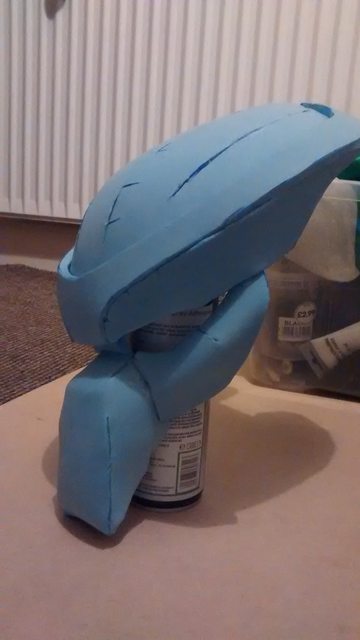

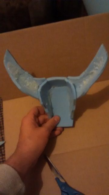

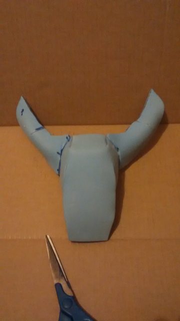

You can also hold the foam into a curve, and fill the back of the curved piece with some hot glue - when the glue sets, the foam will be glued into place. So for example, to get this curve in the bio-mask piece to hold
I've filled the back with hot glue to hold the curve
You don't really need as much as that, just a couple of lines from one side to the other is usually enough, resulting in something like this
