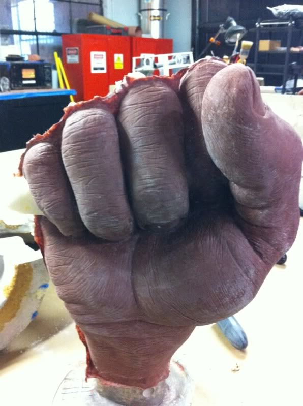

I started by running a latex and polyfoam hand ( there is a stone core in the middle that was coated with polyfoam release so Marks hand will fit inside) Notice the large seam from casting this in two pieces, then placing the core inside before closing the mold for foam ..injected into a pour hole.
Next I use small curved cuticle scissors to remove the latex flash ...in some places, I actually cut the seam completely away so that there is almost a centimeter or two of gap between latex halves ..exposing the polyfoam.

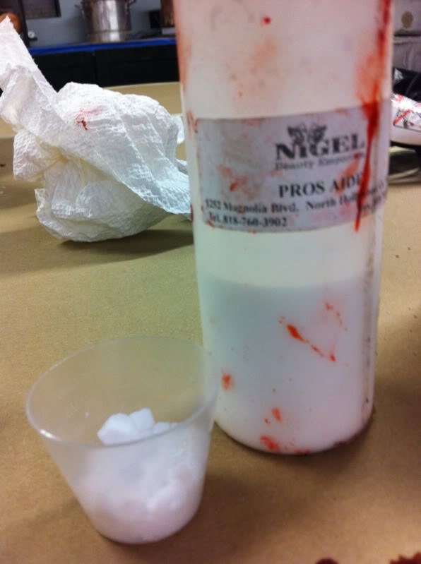

Now Im gathering my materials to create latex bondo ( sometimes known as cabo patch).
you will need cabosil ( a silica filler much akin to fine ground fiberglass ) BE CAREFUL this stuff is very dangerous to breath when its in its fine dust state ..so wear a respirator when handling)

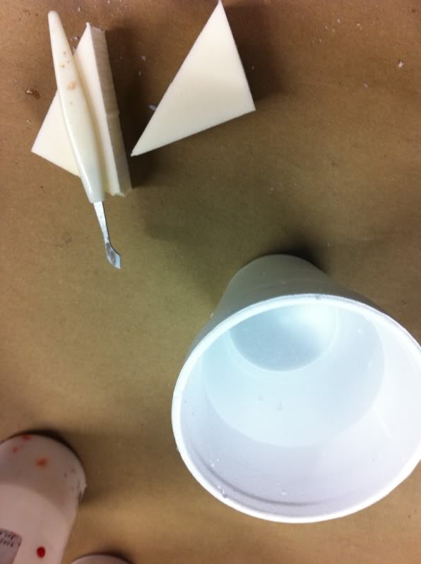

You will also need Prosaid, a small plastic cup and some stir sticks, a cup of water and some small sponges ( im using makeup sponges)
mix the prosaid and the cabosil until you get a frosting-like consistency

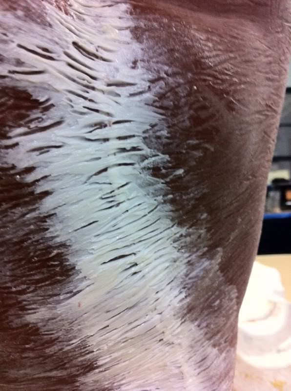

Using the stir stick I spackle heavily the seam area with the latex bondo
Now ..using a sculpting tool, I carve the texture lines back into the bondo, keeping consistent the patterns in the sculpt.

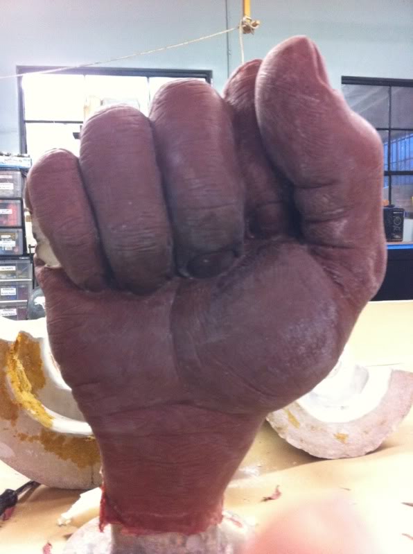

Using a wet sponge, I start to blend and feather the edges of the bondo ..and smooth out the body of the patch ( much like sanding an area of body filler on resin)

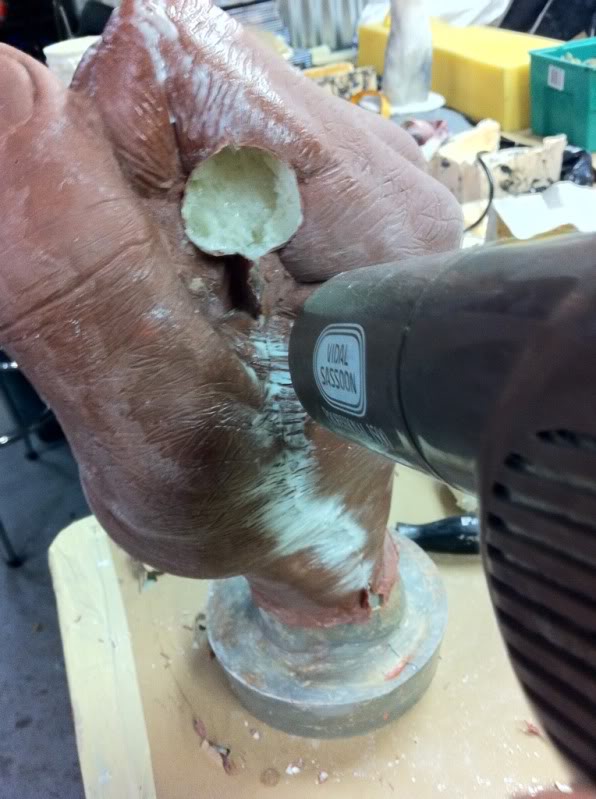

I then use a hair dryer to dry up the patch and excess sponge water

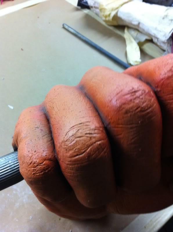

After a few minutes, I brush on some baby powder or talc to remove the tackiness of the bondo...then prep it for paint.
