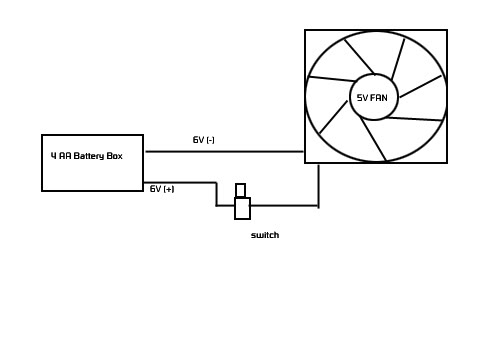

Not for nothing I suggested the 5V fan due to less weight from the batteries. Very simple to build with parts from radio shack. Probably even cheaper than me shipping them to you. But take a look at this. If you want I will throw it together for you.

hey that is really simple I'm going to try something similar to this as well when I get my bio thanks for posting mate

hey that is really simple I'm going to try something similar to this as well when I get my bio thanks for posting mate :rolleyes:
Hey no problem, I have no real artistic talent to offer here but I can beat the **** outta electronics so whatever I can do to help I will gladly do. And this was SUPER easy anyway. If he lived in the US it would be cost effective for me to buy the stuff and send it to him but overseas shipping kills.
