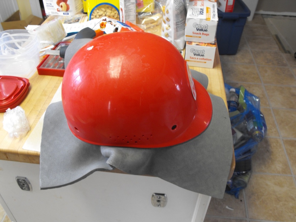

This is what you will need... two plastic hard hats, I am using toy ones I picked up at a yard sale for 25c each. You will not that on one of them I have removed the little black clips that held the liner in, this is because they would of made marks on the foam. You will also need some tape.
Step 1 has two parts to it, first and most important is make sure the wife is out before using the oven!!!!,, then heat up the foam.

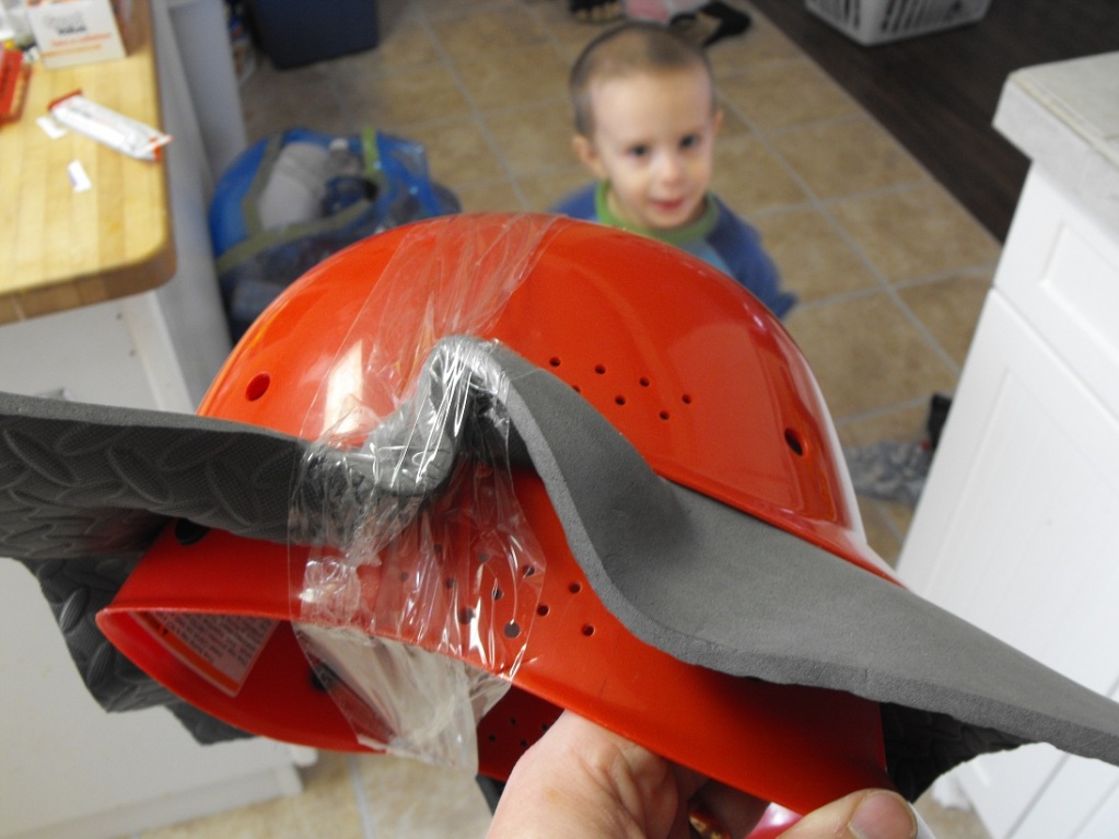

Step 2, place foam over one of the helmets. then place the other helmet on top and push them together, sandwiching the foam between the two.
Step 3, tape the helmets together as tight as you can, you may need some help here. You can see my little helper in the backgroun, he was able to pick up the tape after I had dropped it.

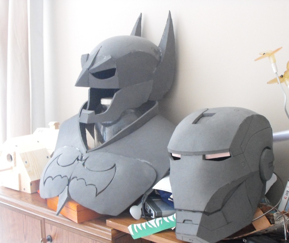

Here is a dome getting ready to be used as the top of my batman cowl.
Here it is on the batman cowl.

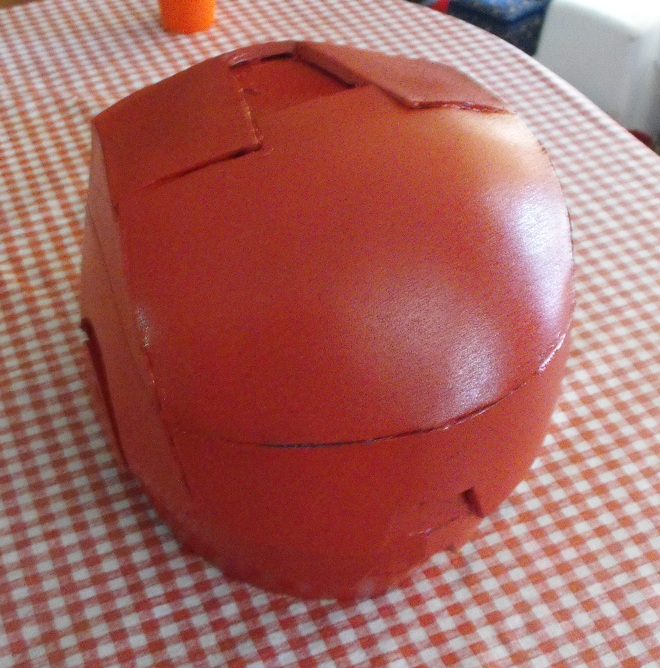

Here is a dome I made for the top of an IronMan helmet.
