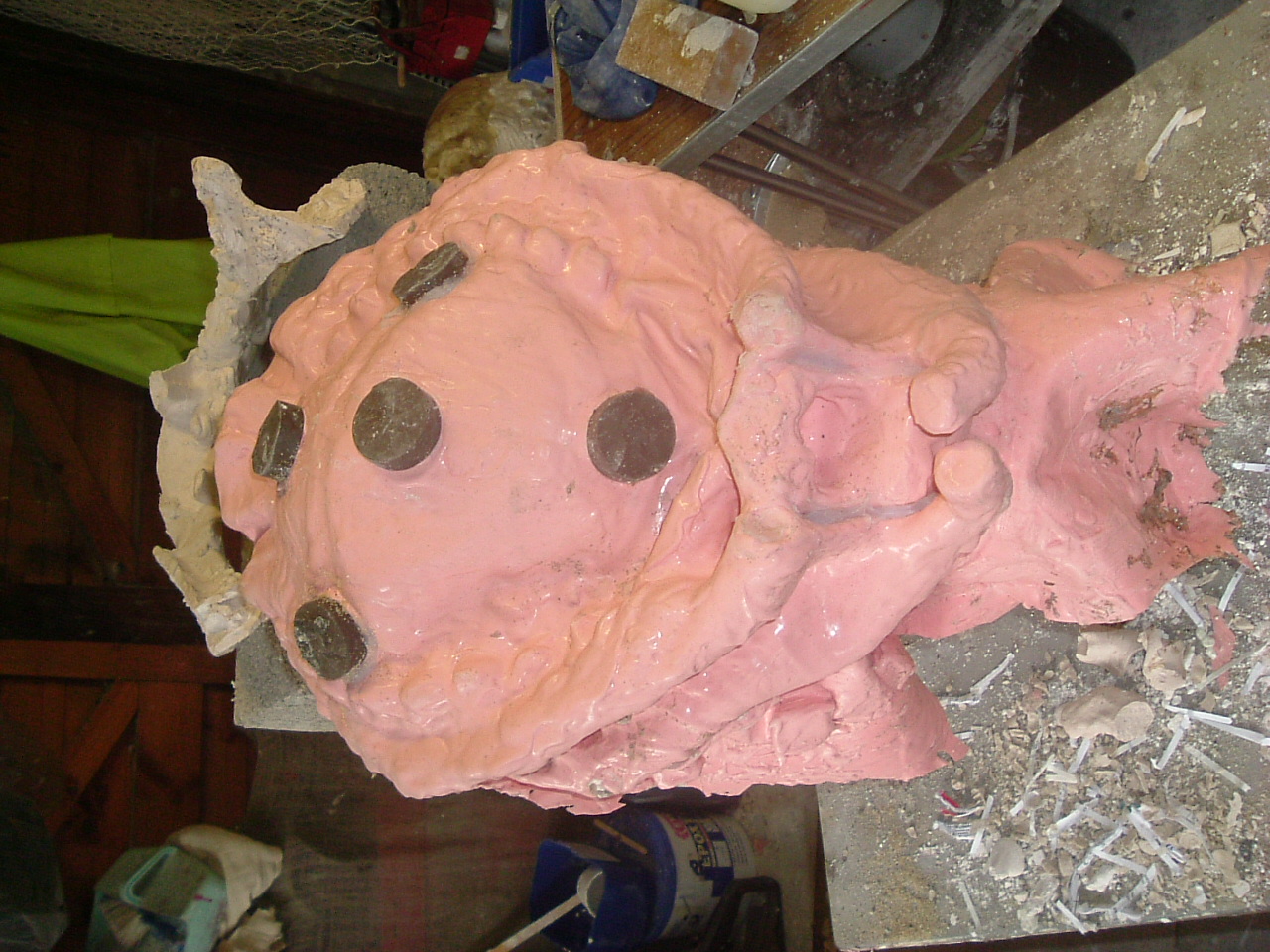

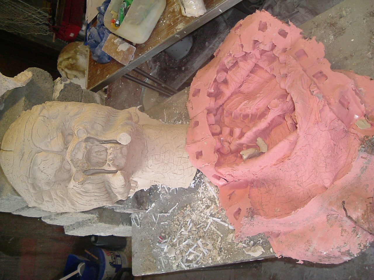

hi all,okay problem the jacket thats goes over the silicone when you have finished sculpting has crumbled away,and i am left with a silicone mask all floppy and no shell to support it with.
solution if any,ask the hunters lair!!!!?
so there s my problem,does anyone have any ideas to getting back this shell,ive tried filling the mask with sand,allginate,foam,but it leaves it over inflated,i find it hard to get back the proper form!the only solution i can come up with is to resculpt or try to fix the alginate peices,its like a jigsaw at the mo.
so i wonder what you guys might come up with!!many thanks for your thoughts..predwolf (tony) :)

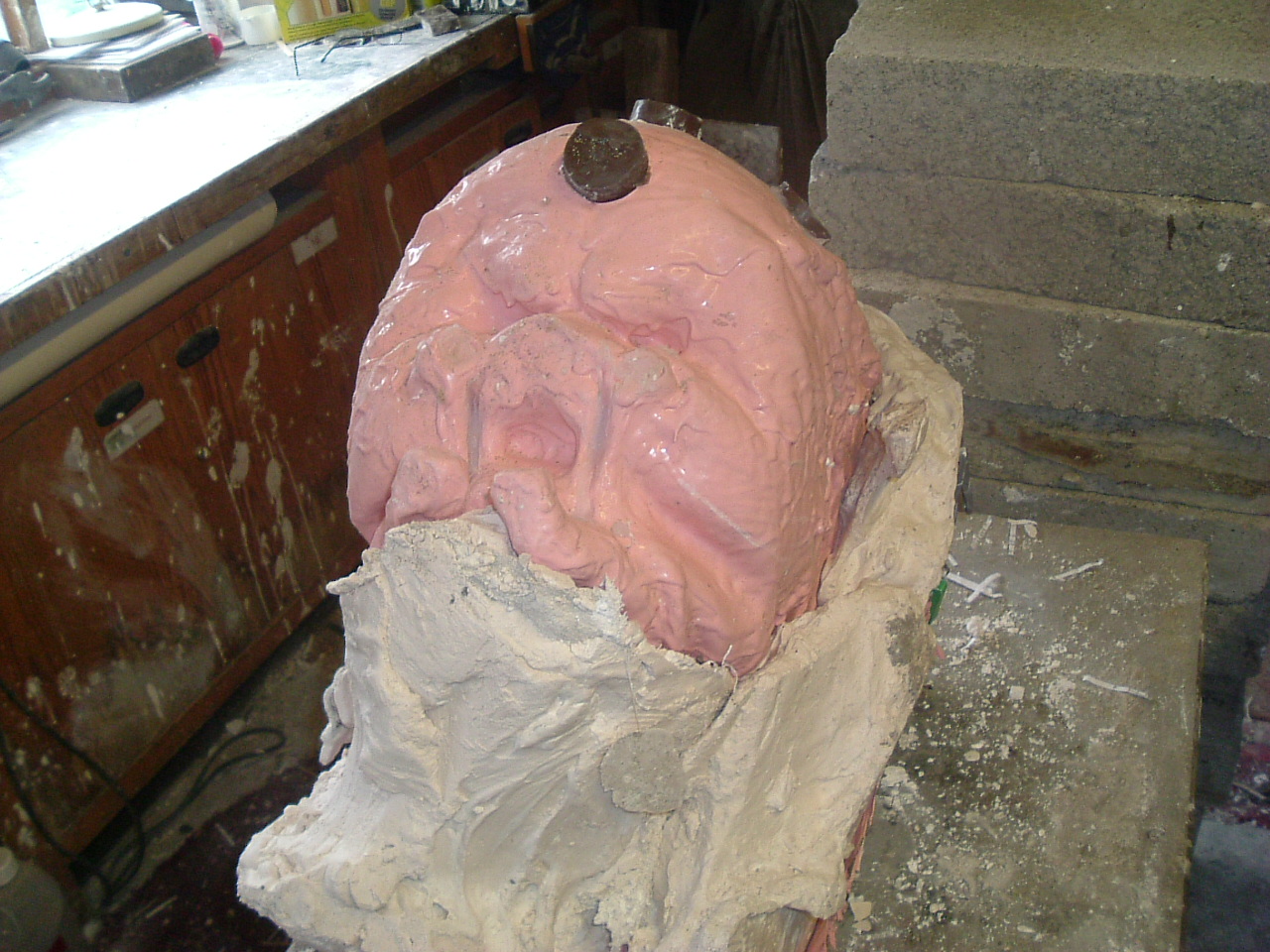

in the process of re-putting together the original plaster jacket,underneath the silicone mask,and while doing this put a layer of plaster on the inside of the mask hopefully to get the shape back.if all fails will probably re- sculpt !thats how it goes i guess,all a learning curve for me!.

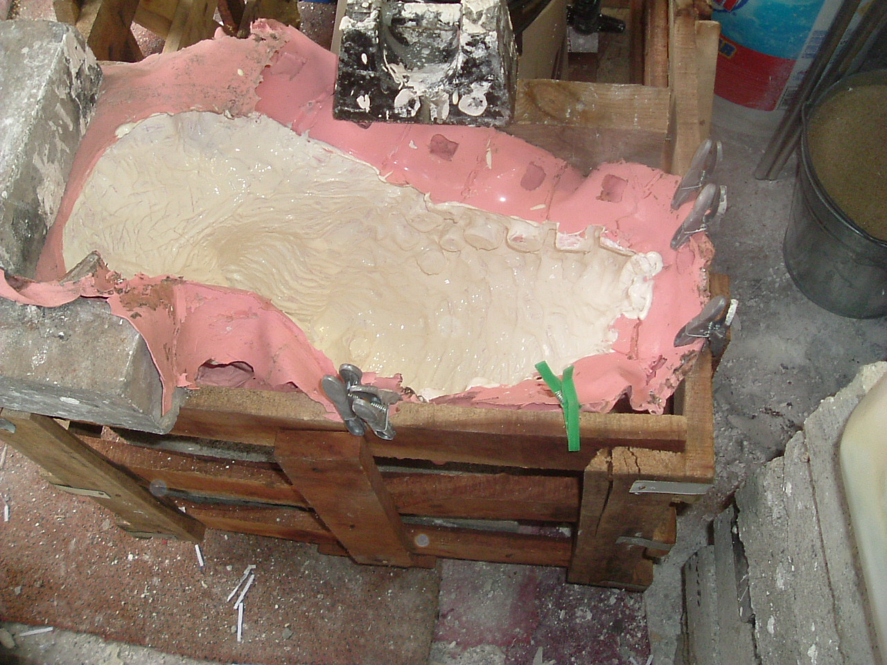

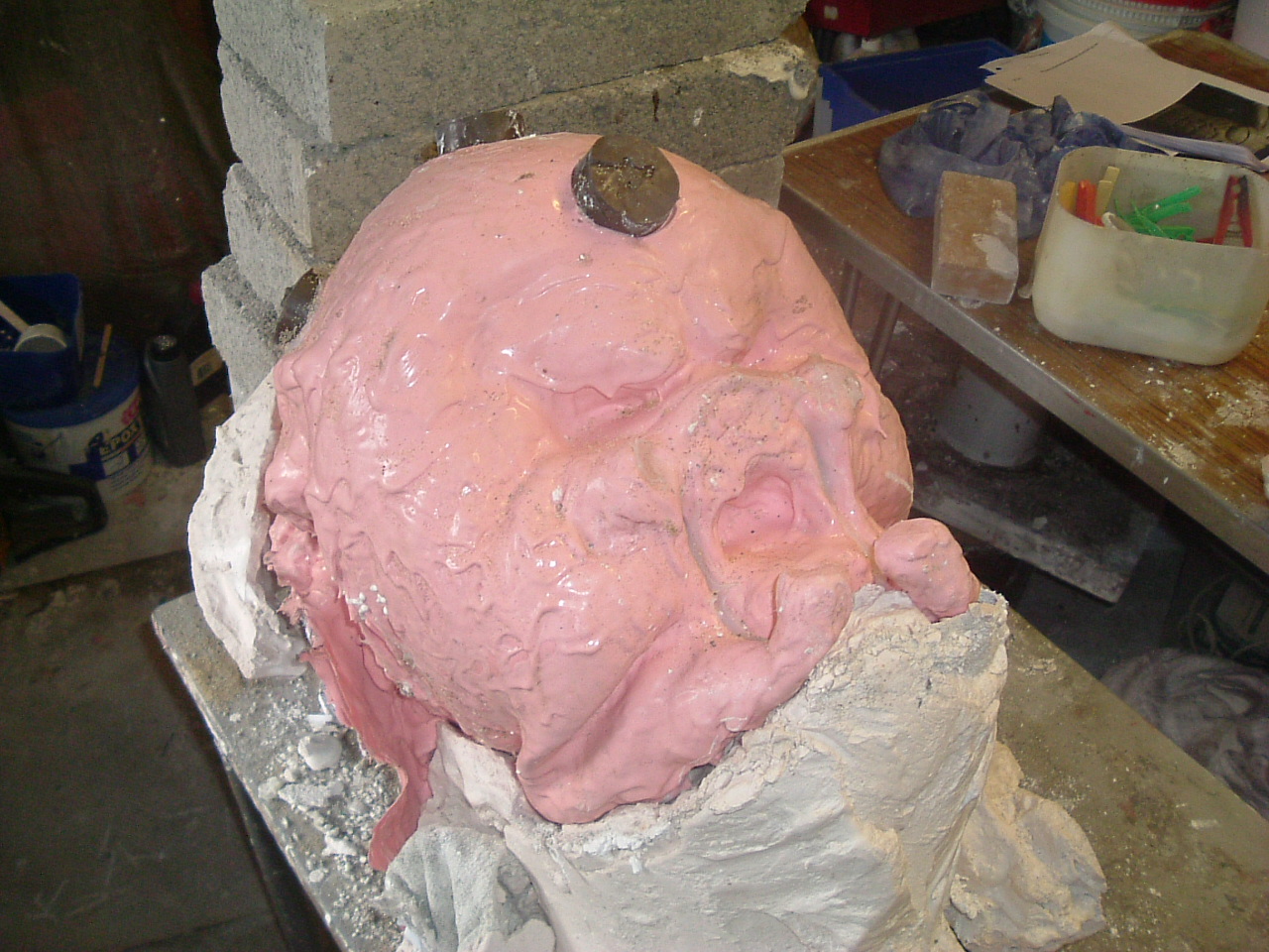

right guys here r some pics ive done an experiment on the mask with latex to see how it goes !meanwhile ive started another sculpt.ive spoke to a tutor at the uni i went to for my lifecast and he said to get it to him he might be able to do something with it!!?well see.
no never got to pour one ,which pissed me off a bit lol!! so i tried numerous ways to do another jacket,only thing is that everytime i filled the mask it came out deformed,i coulnt get the actual shape back again.so any suggestions i will try!!many thanks.
oh man i know your pain i sculpted somthing that took me off and on a year to complete and i had the same thing happen,the ultracal 30 adheared to the silicone and i had to break the mother mold so i could try and keep the silicone detail layer intact,i thought nothing adheared to silicone except silicone,but you had a good idea by putting it in that wooden box,possibly try to prop somthing under it to support the weight and maybe try and cast it in somthing lighter maybe a polyfoam? goodluck,hope it gets resolved cuz im in the same boat
thanks for that support mate,ive tried expanding foam but it developed in to a predator having too many mc donalds lol!!!ive tried sand,foam ,alginate you name it,without success,my last attempt now is the latex,suspended in the box ,if it fails so be it as you can see in the pics ive started a new sculpt,its good to experiment,you tend to learn a ton of things!!!
