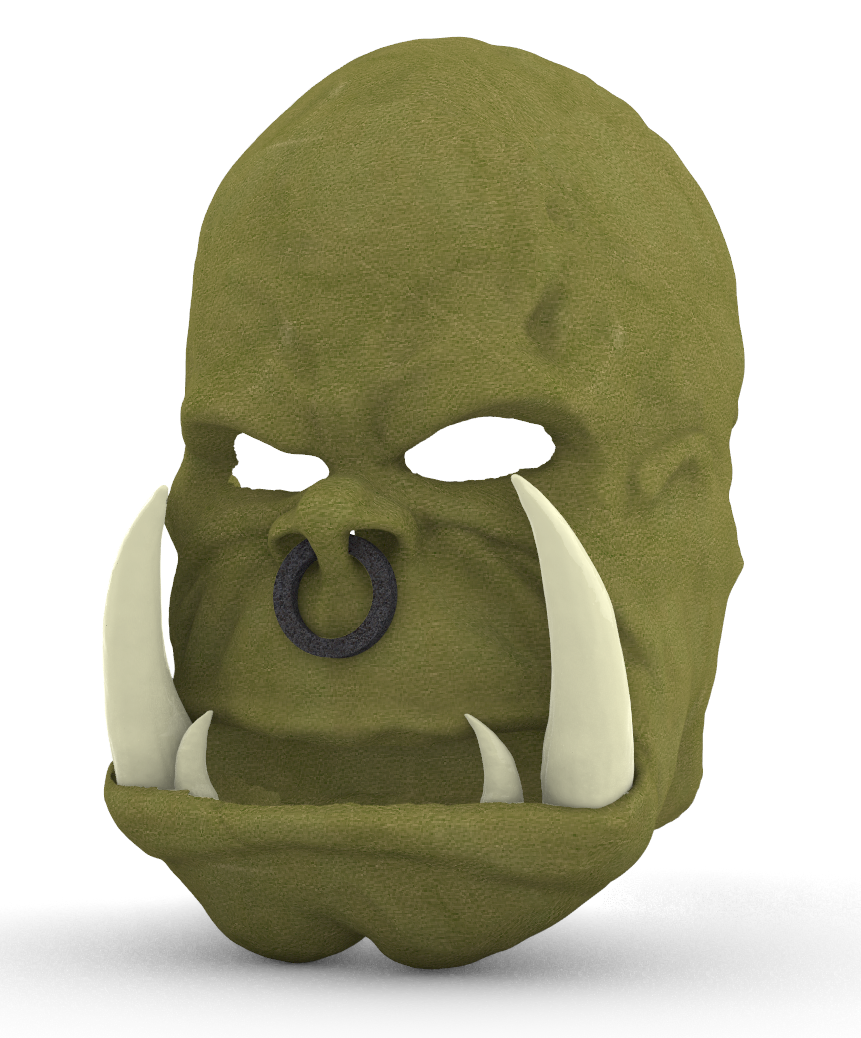

While being in the digital realm, a place I fel much more confident in, I used the 3d scan to make a face plate to use for attaching the forthcoming (?) silicone mask and animatronics.
My plan is to build the same type of upper lip snarl when opening my mouth as AlphaTech686 has on his Grommash build. Thanks for showing that in so much detail, btw!

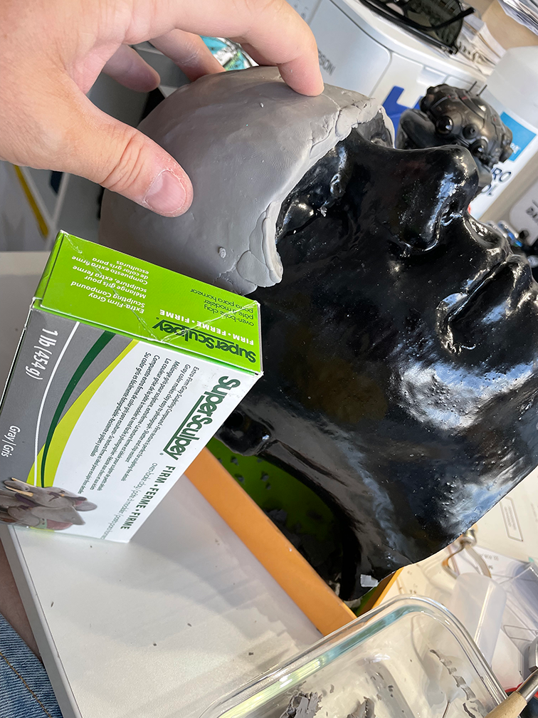

I then brought out my really old Super Sculpey and tried to start.
The firm Super Sculpey might be excellent for capturing details, but it was extremely brittle and VERY difficult to work with. Not even my pasta maker could process it.
After a few hours I had at least managed to get some clay on the head. To be honest it looked ... not good.
The problem, I realized, is that Orc physiology in the face is so much different. Where the tip of my (large-ish) nose is, I would need to have the upper lip with the nose ring hanging in front of it. The end of the gray clay on the picture is where Saurfang's own nose would be. I would need to bulk up the face a LOT.
And.. with the extremely hard to work with Suer Sculpey this wasn't going to happen.

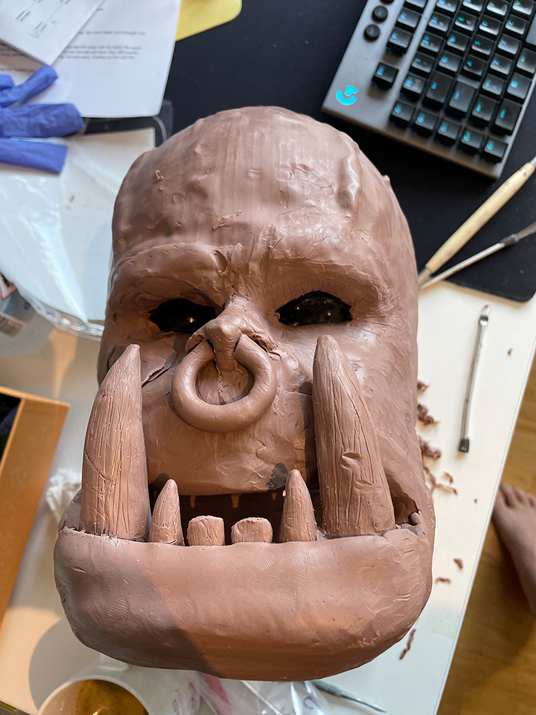

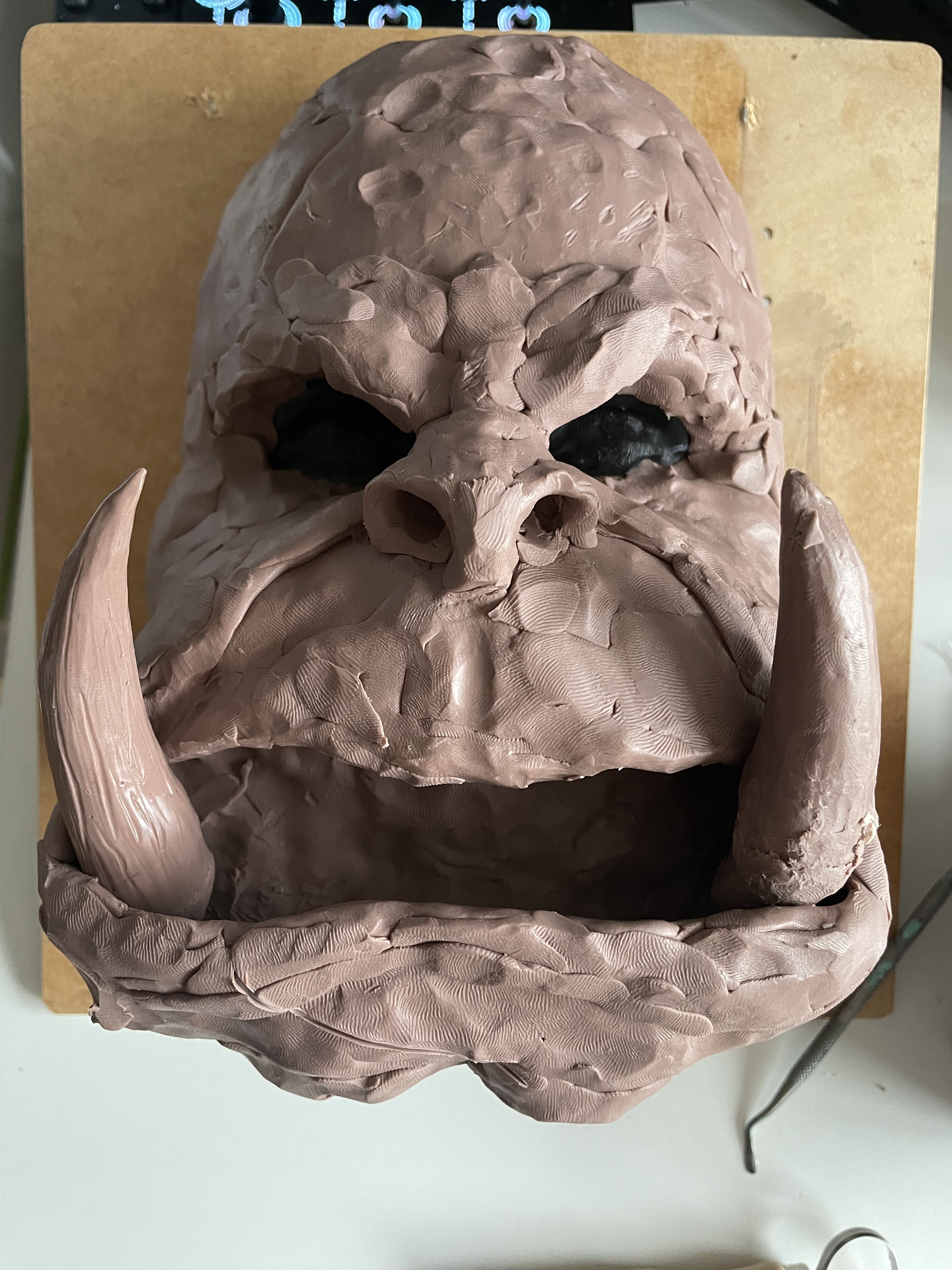

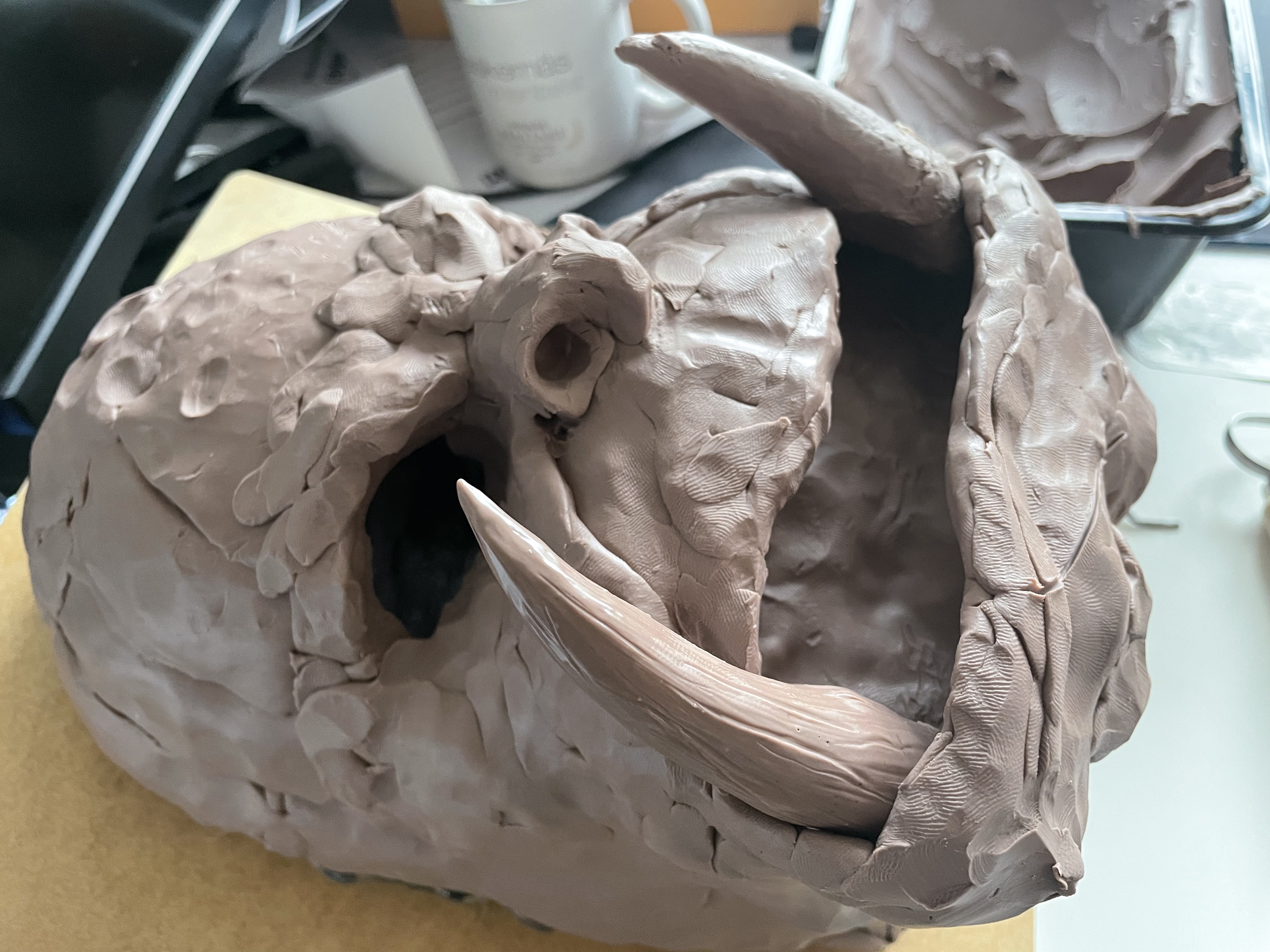

So, I ordered two boxes of Monster Clay (soft) and started bulking out.
I started with just testing to make his teeth...
While I can understand this is a tad too soft to make the actual outermost skin layer for details on (just touching it would break any detail I have put in), it was a LOT easier to at least block out the general shape.
After sitting with this for just a little over an hour, I had already come way longer than I had with the 2 hours I spent with the Super Sculpey:
I let that sit over night, and started this morning to block out some more.
After 2 hours more of blocking out, this is where I am:
This is just done from the top of my head. Looking at the Saurfang face now when I am writing this, I see the teeth needs to be wider, as would the mouth. The lower lip needs to cover the middle front teeth, and .. well a ton of detail that I have not even started with yet.,
This is at least a start.

Insane project askernaso_O Kudos trying to sculpt something like this for the first time. I think that the main fangs are too thick and not "dainty" enough (as the other two canines). Furthermore; they are slightly curved, away from his face (according to the first pic you've posted).
Keep up the good work and eager to see your next update;)
askernas
Thanks for the feedback =)
The fangs and teeth are not part of the sculpt per se, but a piece that is just lose and as such, it is "falling" against the face as I don't want to fasten it at the moment.
There are a lot of things that are not correct and needs fixing, but I try and just get a base done and then adjust one area at the time.
The fangs are about 2cm in diameter at the bottom, but they should, as you point out, be thinner much more quickly. As for the angle, that is something that will be fixed and experimented with when I build the hinged jaw, as the teeth will be fastened in the jaw itself.
There are still a lot of things in the face, the nose, the main wrinkles that needs to be improved on.
I'm counting on this sculpt to take me months. One small piece at the time.
I figured that what I lack in still, I could make up for by taking things slow and doing one small area at the time.

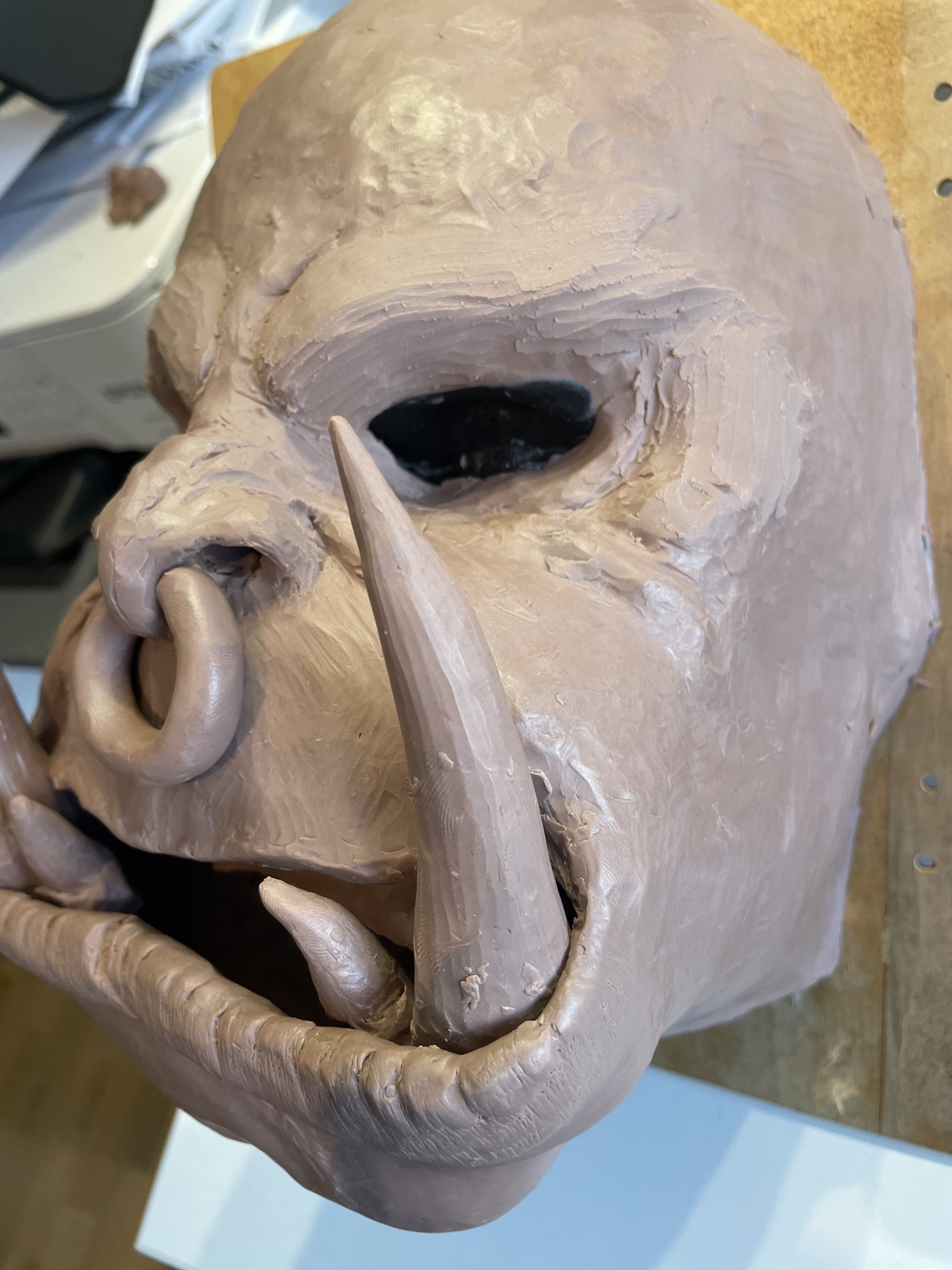

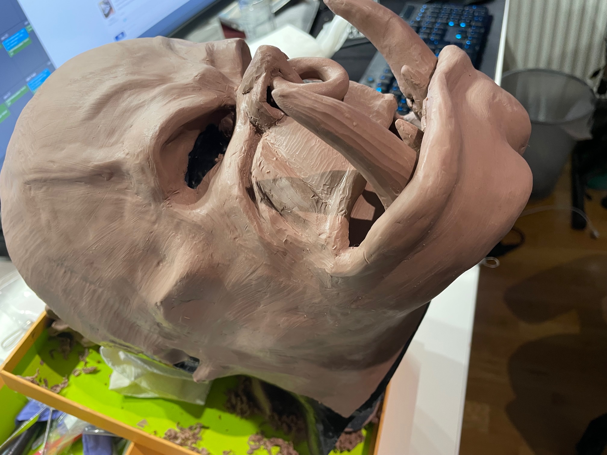

I'm just attaching a quick pic with the (same) teeth angled a bit more accurate after watching the Mak'Gora cutscene (again)...
I figured building the foam bits is the "easy" parts, so I didn't want my build project to end on not getting the mask done, hence me starting with it...

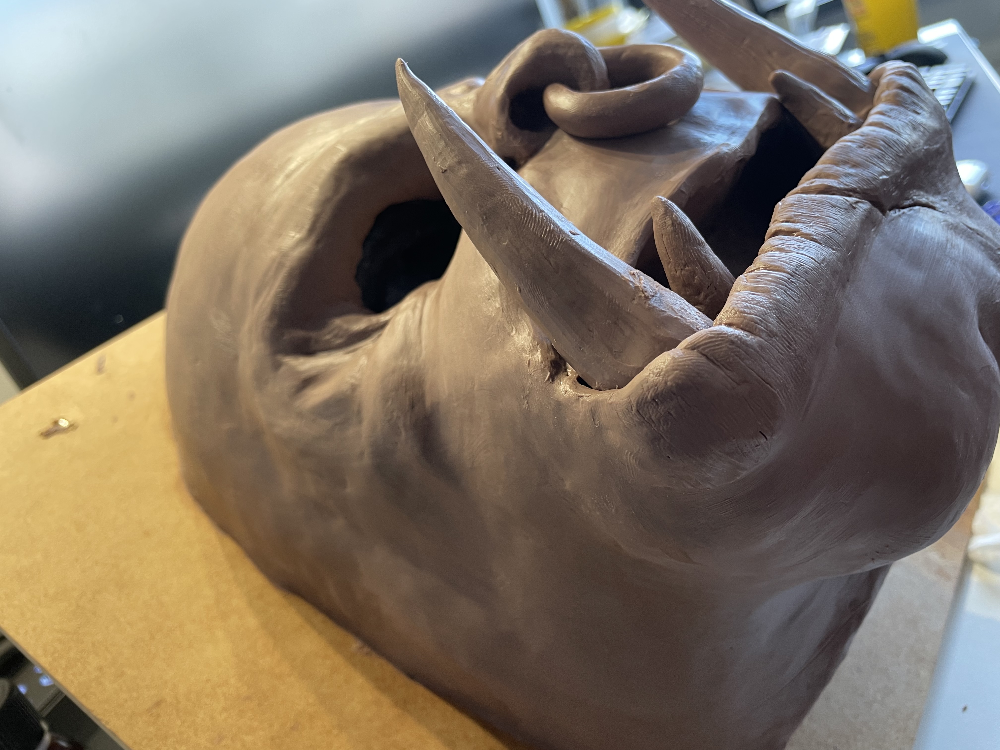

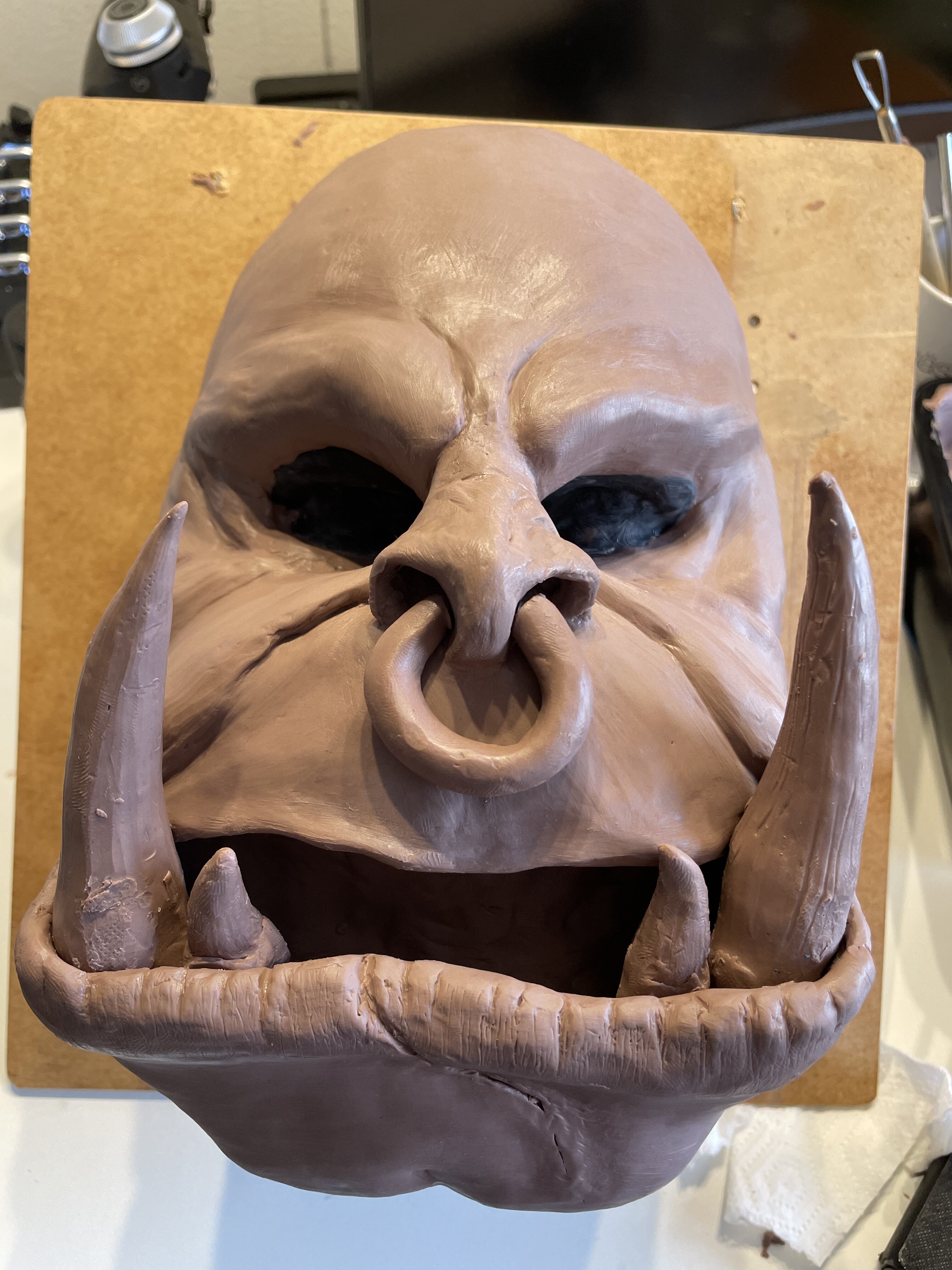

Sculpting Saurfang Day 2:

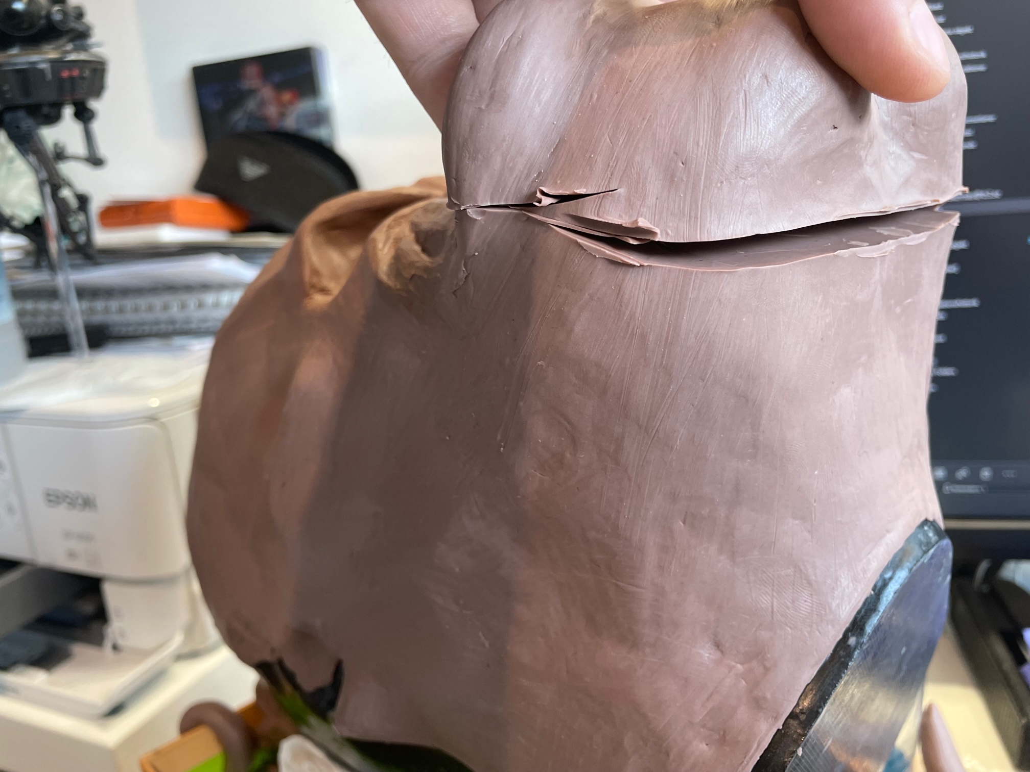

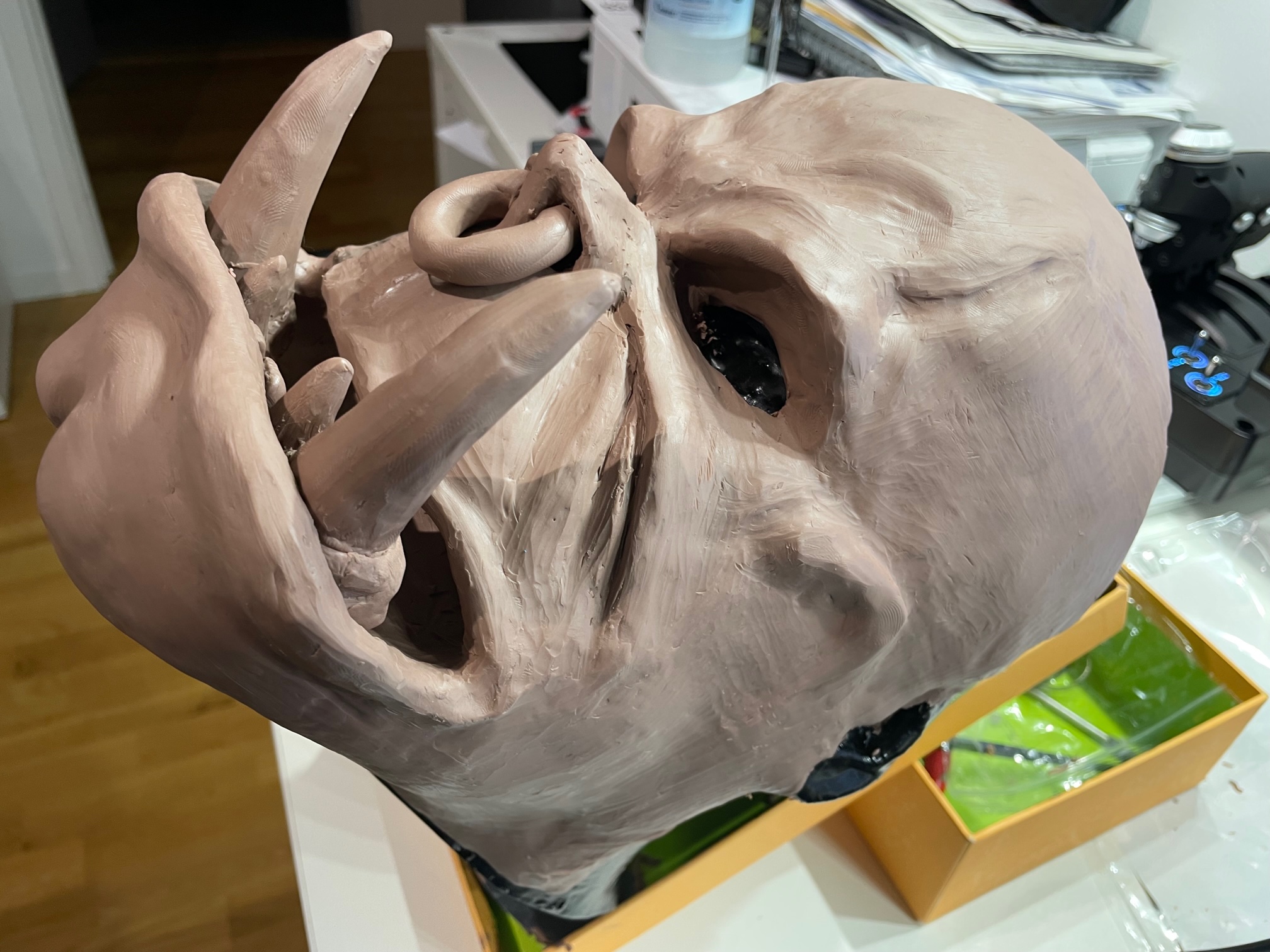

I startedthe day by looking at what I did, looking at screen caps from the Mak'Gora cutscene, and realized I hated the jaw.
The jaw stuck out way too far, and if I place the fangs leaning outwards and to the sides, they would still fit without issues.
The jaw was too square as was the mouth opening.
Fortunately, clay is a very forgiving material and easy to change things. I just wish the UNDO button would work...
So, my day started with me putting the scalpel to poor Varok's throat and I cut his jaw off!
Once it was off, I could work on smoothing the clay inside his mouth and also reshaping the mouth somewhat.
I filled up as much as I could of the jaw with clay as I am going to cast this at some point, while still having enough on a lip on the inside (Which I obviously didn't have in the pic above), reshaped the bottom jaw as well and most importantly, cut off 1 cm in length to not make it stick out quite so much.

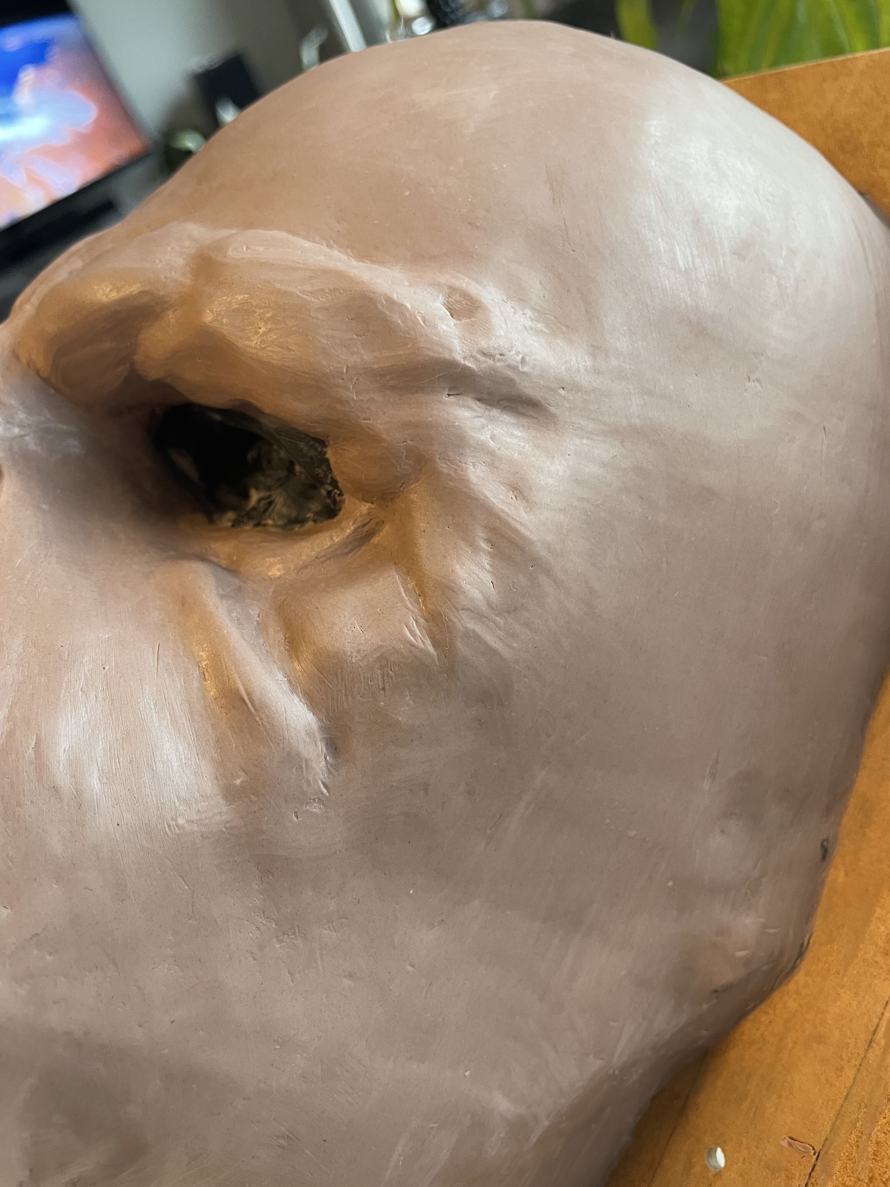

I like this a lot more, and after reattaching tje jaw, smoothing everything out, I tried to accomplish some sort of basic skin texture with a natural sponge.
I still need to add a ton of wrinkles and probably need to revisit the pores as well, but this is where things are at the moment. The lips are also a grea
Unfortunately, I can no longer fit the lose teeth through the jaw opening for prettier pictures, but I am a lot happier with how this is turning out.

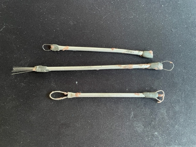

I've been trying to smooth out with makeup remover (dissolves oil) and isopropanol, but none of them really work well.
The only smoothing on him so far is by hand.. wither through any of the following tolls I've made from old guitar strings, my finger, and some from my food torch.
Guess the créme brulée will have to wait...
joberg
Well, making your own tool is very smart; since a lot of sculptor have found tricks to do certain effects that store-bought ones didn't do well;)
How was your experiment with lighter fluid?

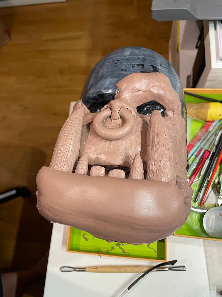

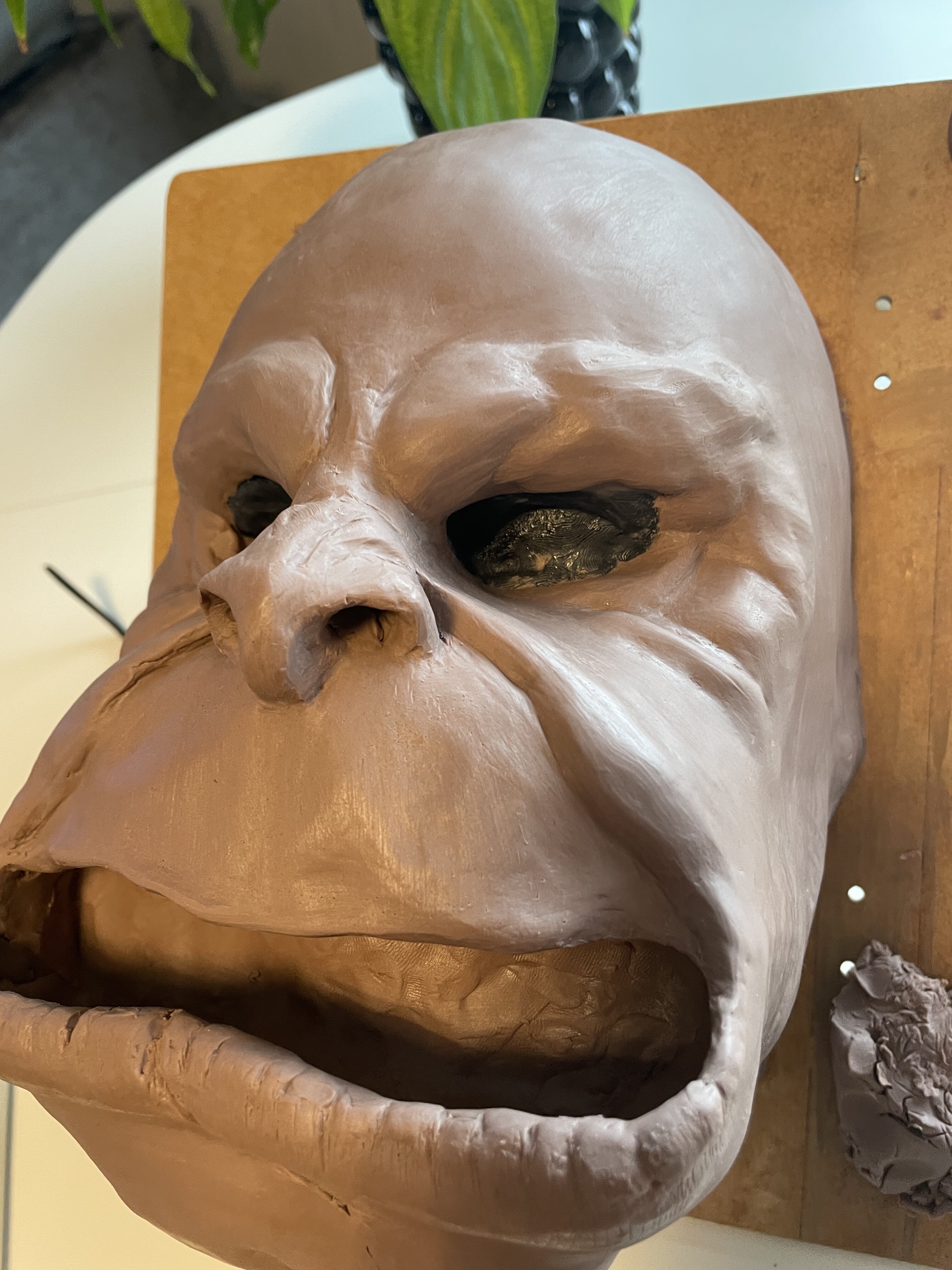

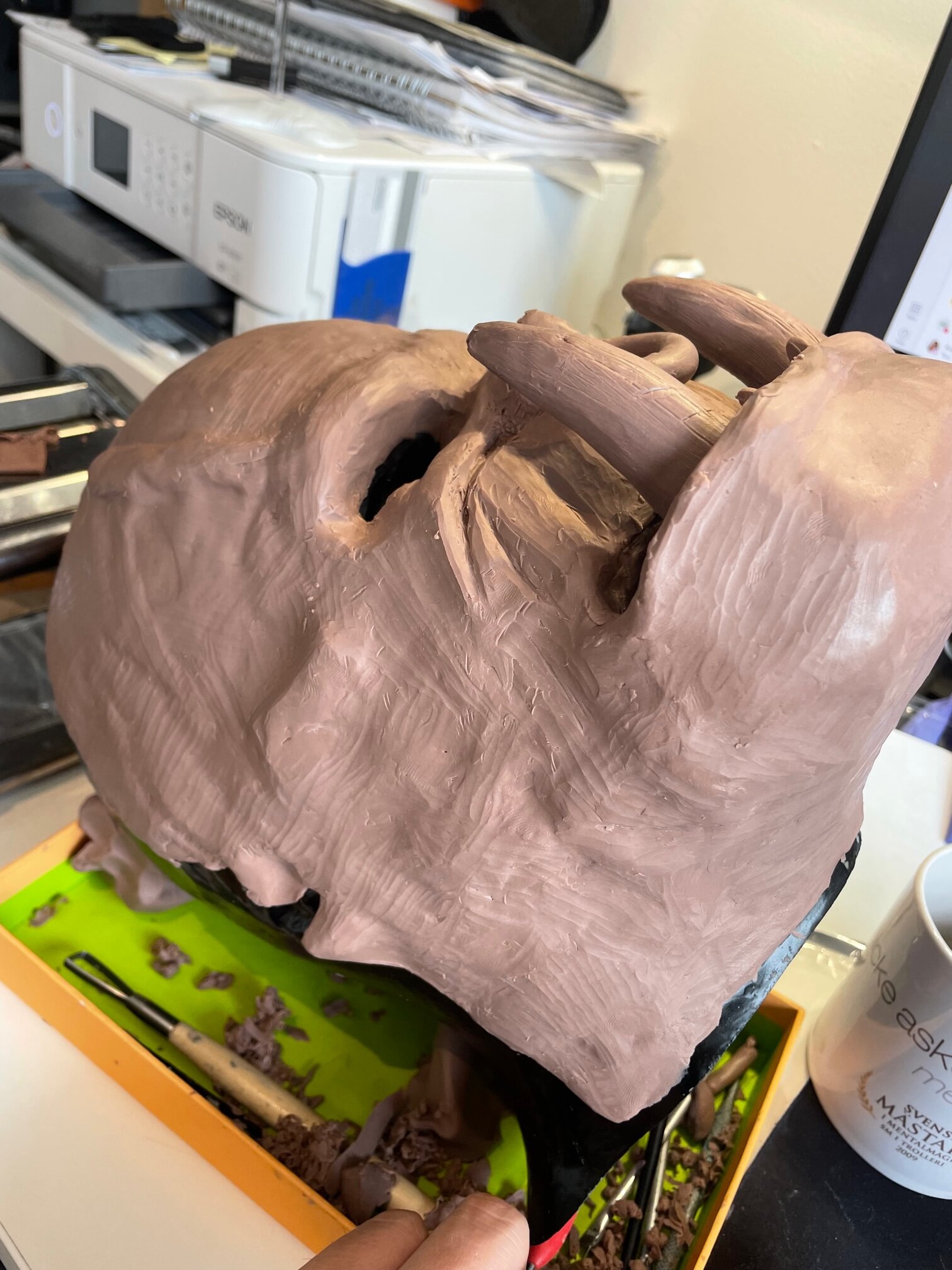

A few days of work has come in between me and the sculpting, but I had two hours to spare this afternoon.
However, I have come to an important conclusion about the sculpt:
The sculpt so far is not Saurfang.
It is an orc, yes, but not Saurfang.
I LIKE my Orc, but it was not the orc I set out to make.
So, I'm keeping this guy for now, working on learning how to make proper skin texture for future casting, but I will start on another head and just not freeball it.
I knew having my head 3d scanned was a good thing. I've printed a second face and mounted it to a slanted board:
This time I've been blocking out the character with a large printout in front of me, and already I can see Saurfang emerging from the clay.
This is of course very rough, but it feels so much more right.
The old face will be saved to practice making skin texture on, and possibly to practice casting as well. :)

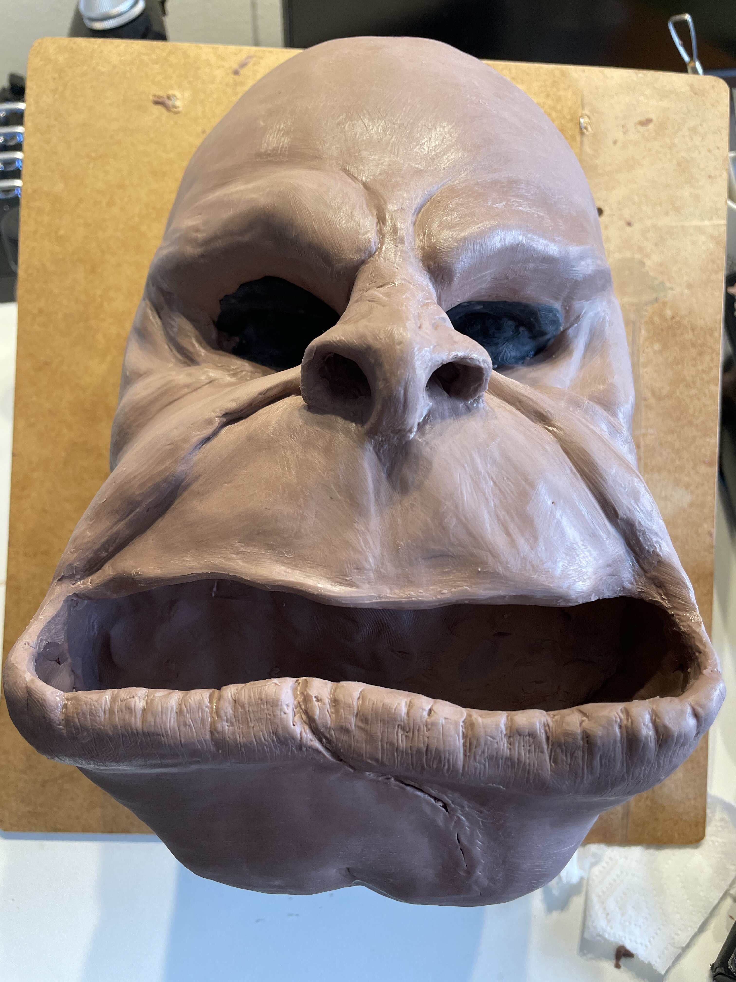

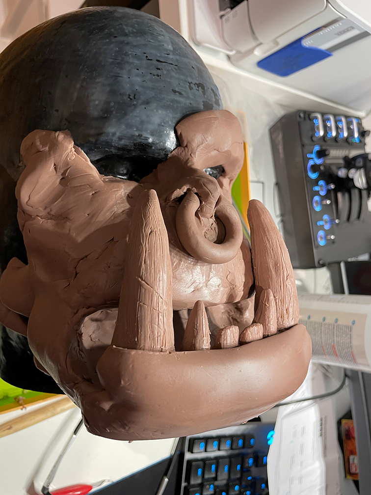

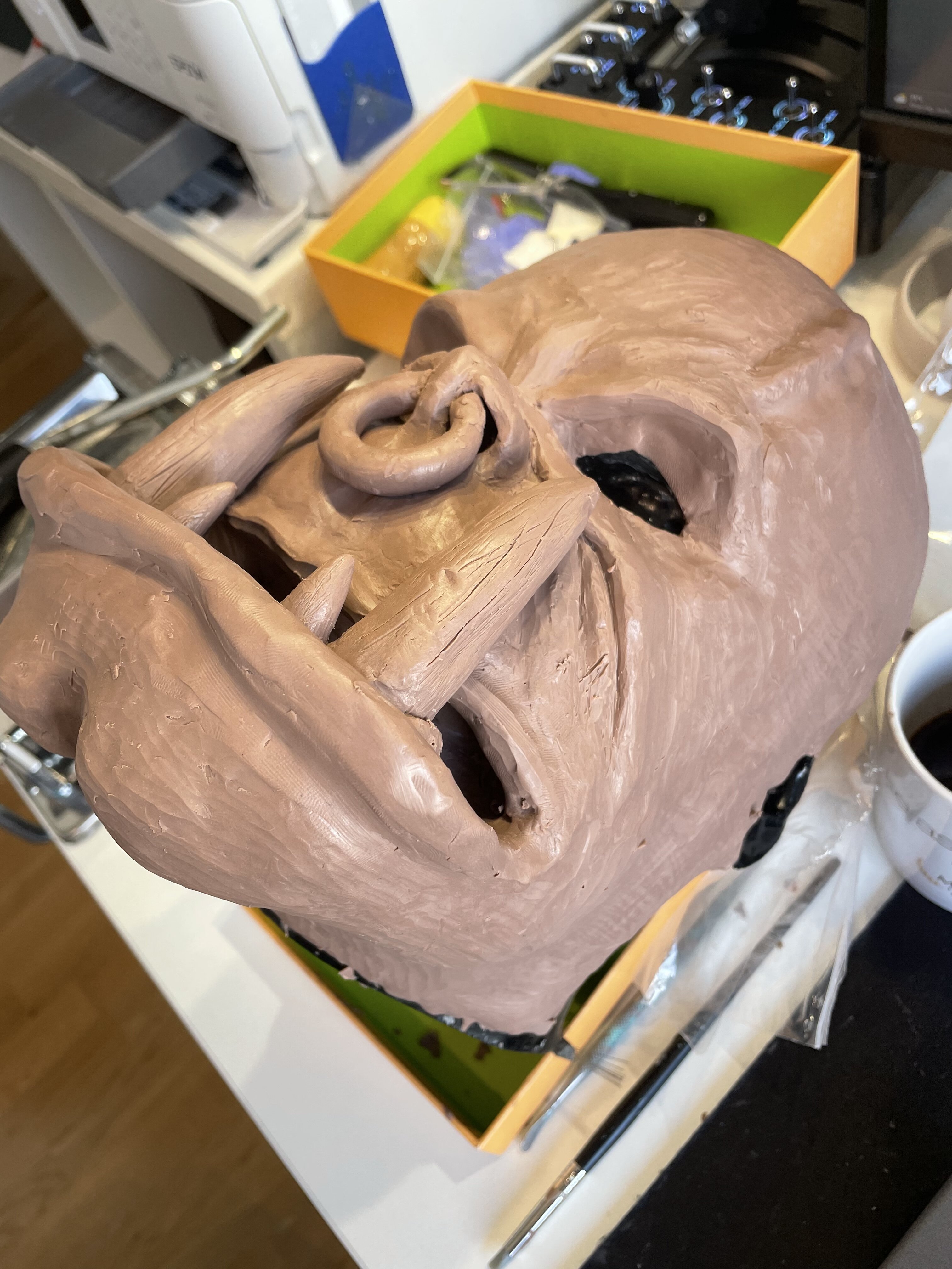

After a bit of smoothing with lighter fluid:
My plan is to letting the face rest for a little while until the weather cools down (which is in a few days) to get a bit more firm clay to work on.
In the mean time, I'm going to work on making the teeth and order some silicone for casting.

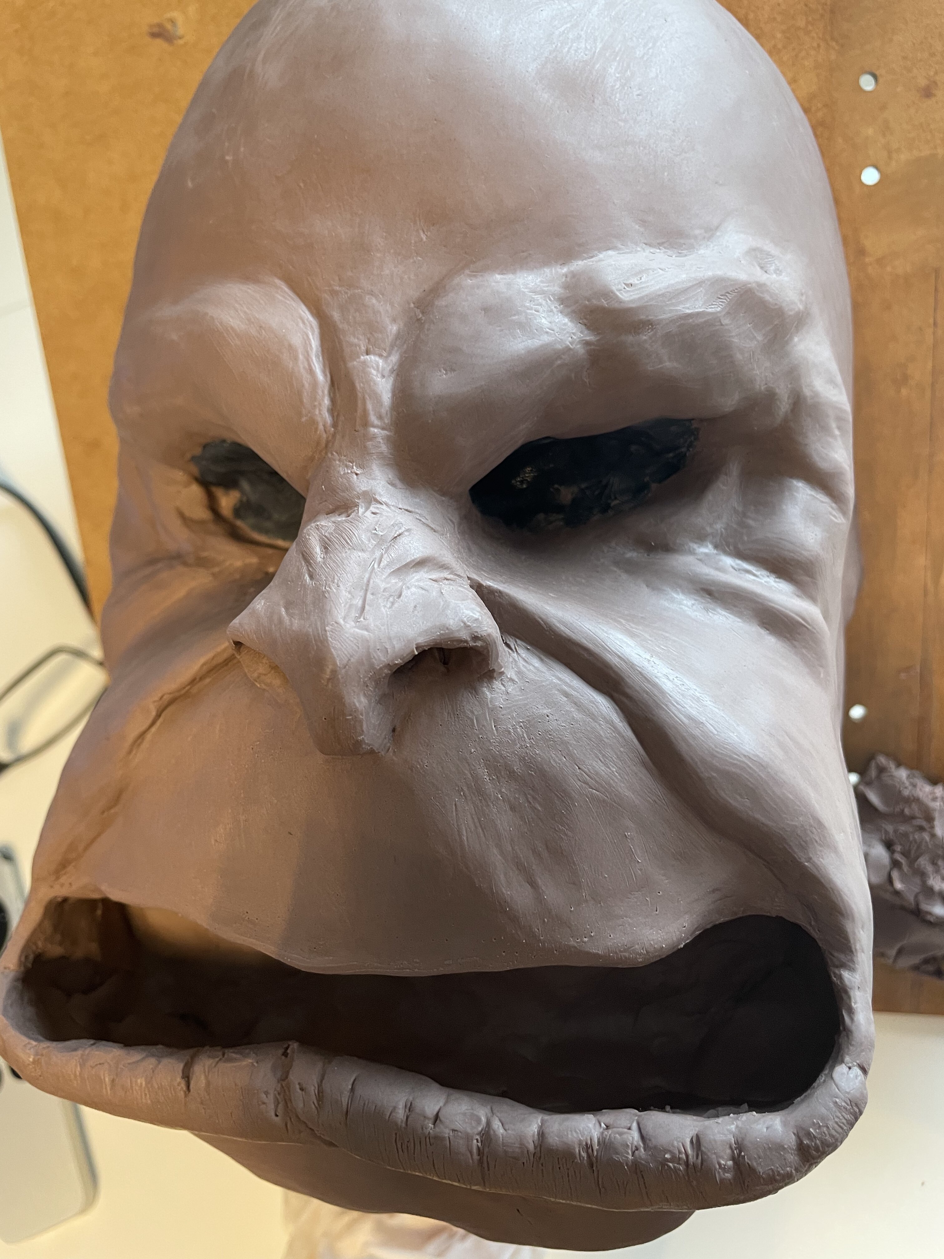

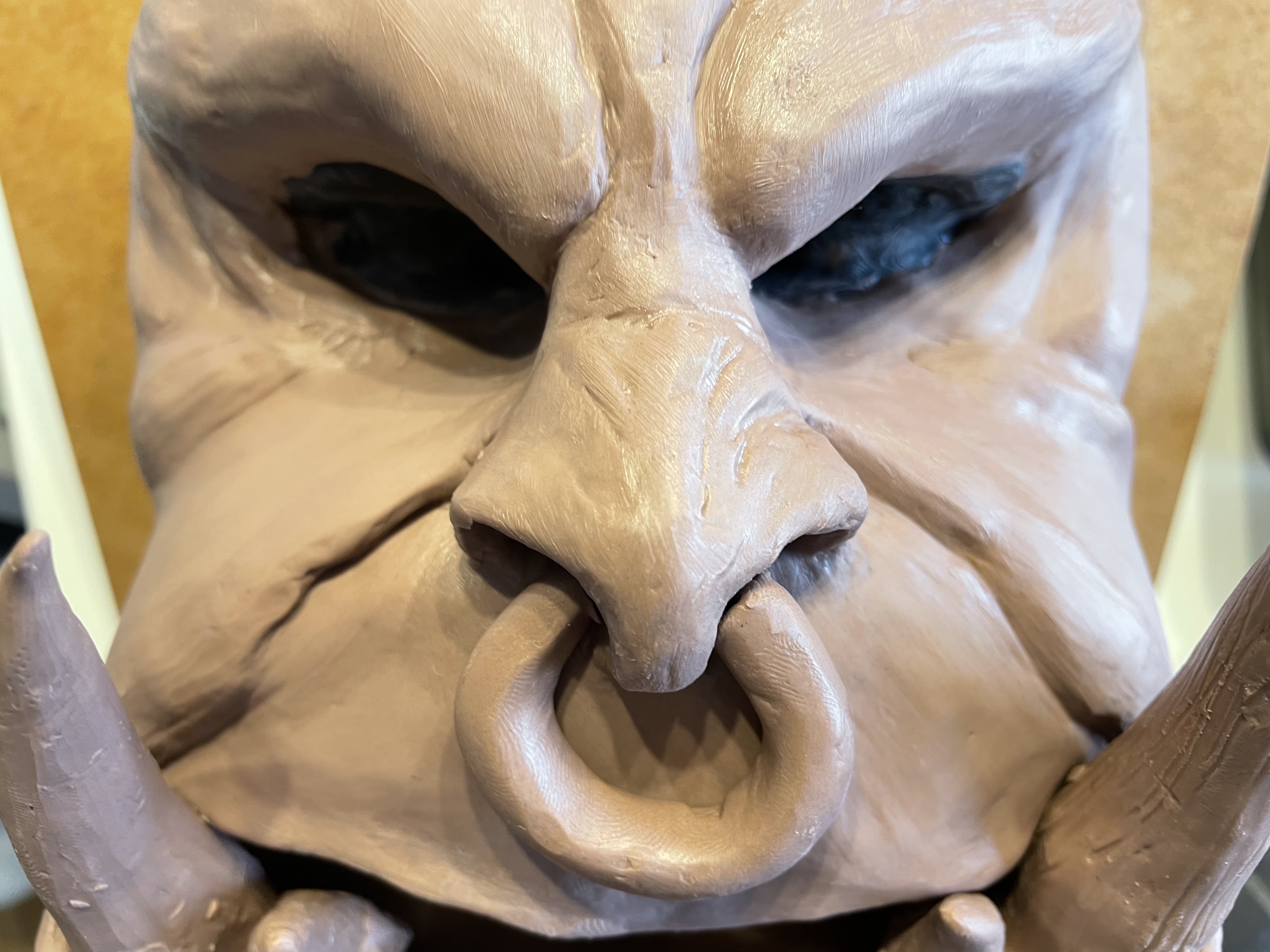

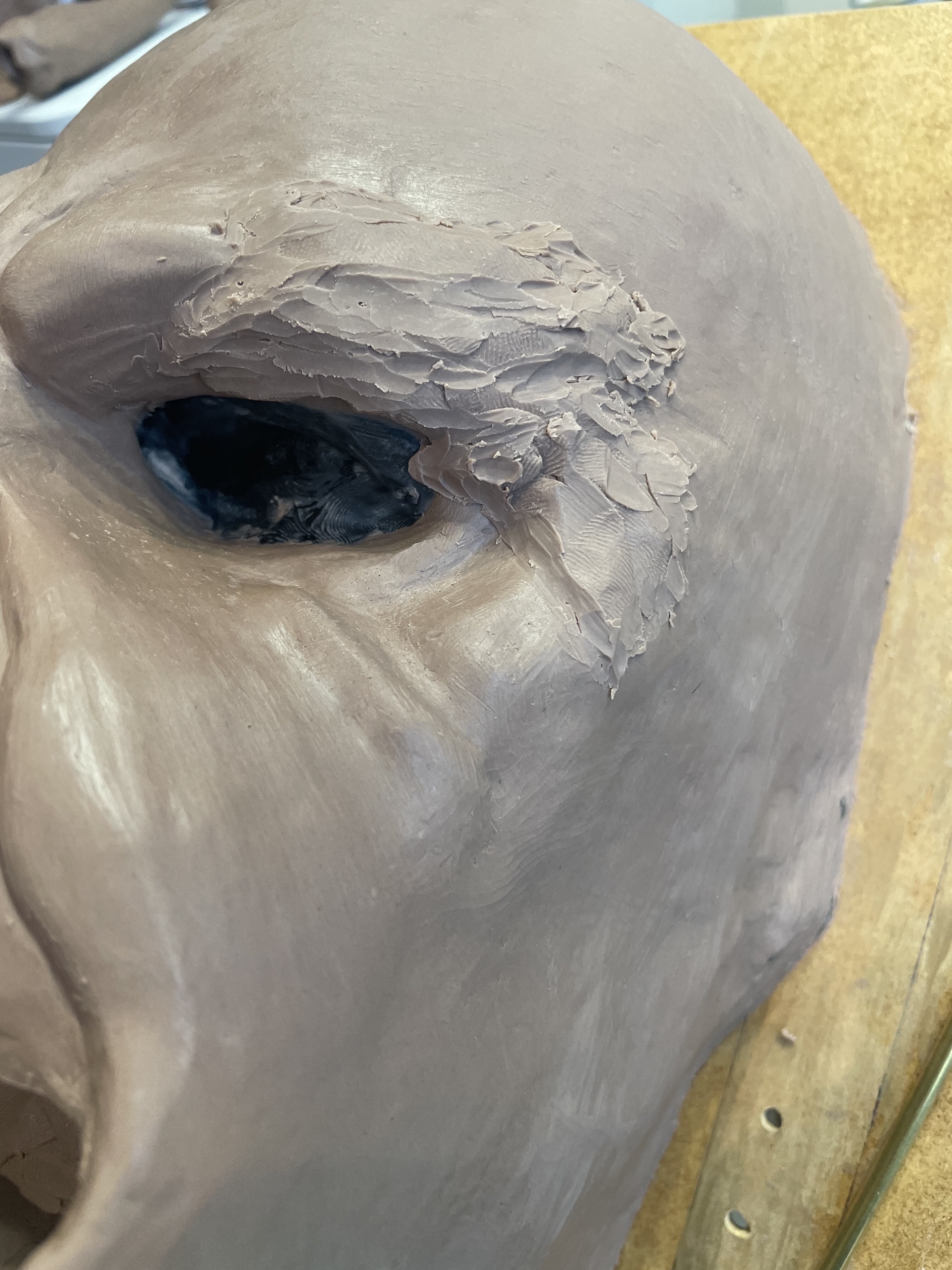

Resculpting the eyebrows…
In think his left before is a lot better now.
Right one will be revisited to match, of course.
His left side of the face is starting to feel smooth!

"Satisfied" as pertaining to your "Perfection";):) and having followed your Robocop build; I know that it'll be fantastic!
As for the skin pores; various techniques of course. My fav: Saran wrap on top of the clay and dabbing various sizes hard bristles brush.
For the nose-ring, I would (my two cents) Google "Round rubber gaskets". You'll find the right size I'm sure and something you will not have to sculpt.
