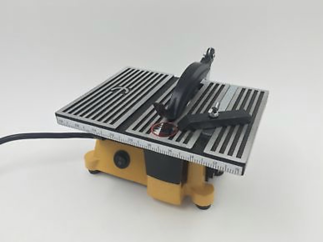

Mini table saws are almost a must for exacting cuts of sheet styrene.
You can find them for as little as $50

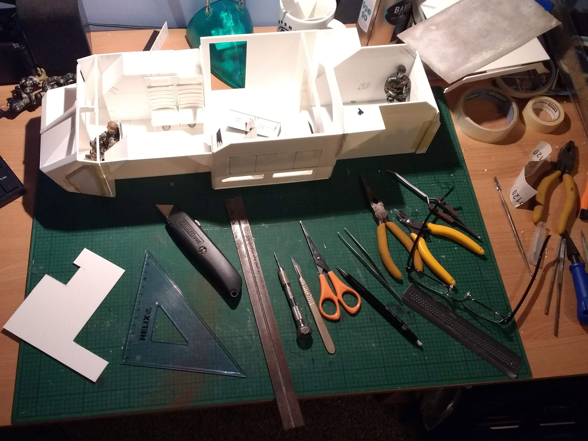

I must admit I'm old school and mark up the styrene sheet and score/snap with a no.10 blade scalpel, finishing with file and sanding.
I've seen various cutting jigs and choppers online but not heard of mini table saws before - I might have to invest. :)
I just mark carefully with a mechanical pencil before following the line with a No.10a scalpel and a steel rule.
Invest in a decent set of steel marking tools- protractor, rule and squares; I recommend Moore & Wright, Rotring or Starret (well-respected engineering companies, don't get El Cheapo Brand stuff, it's a waste of your time)

It depends on how advanced you want to get. I think if you have steady enough hands and a few simple tools you can get nice clean cuts that are accurate. I would suggest using a self healing mat, a T-Square, and a good sharp exacto knife.
