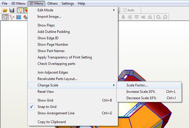

In the pepakura program, right click on the side that has the 2d pieces and select "measure distance between two points" or whatever it's called and that way you can kinda guess whether your armor/helmet will fit. Just remember it makes a straight line when you select two points so you will have to measure that way. Hope it helps and happy building guys.
Go here in the menu.
And if you didn't know, that is in Pepakura Designer, not viewer. Also if you use the point to point line tool (right click the 2D window) you need to compensate for the thickness of the material.

I found this option and tried increasing something that was too small by 10% but nots it's slightly too big (doh)
Is there any way I can upscale it by 5%

Hi.

You'd have to do Scale Factor from that same menu, do the math, and enter the preferred variable manually.
