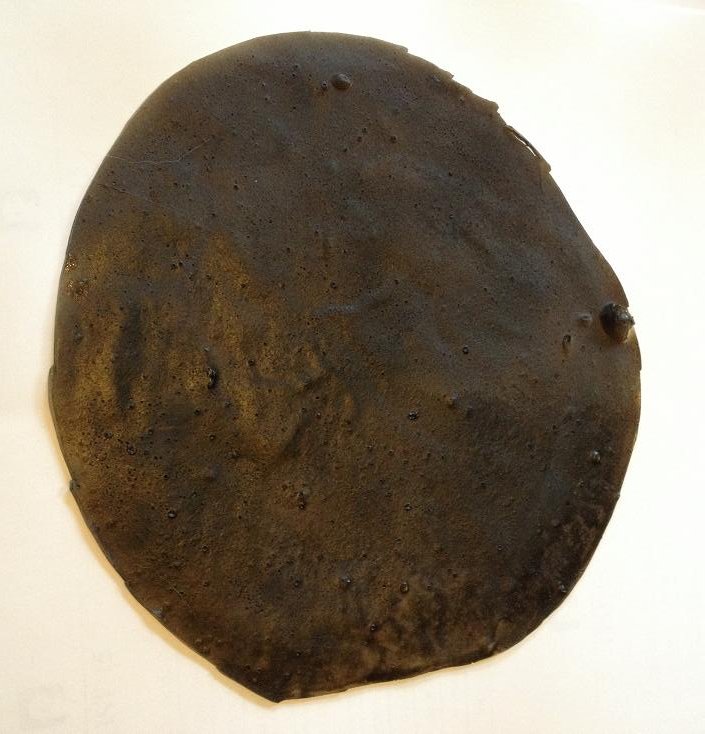

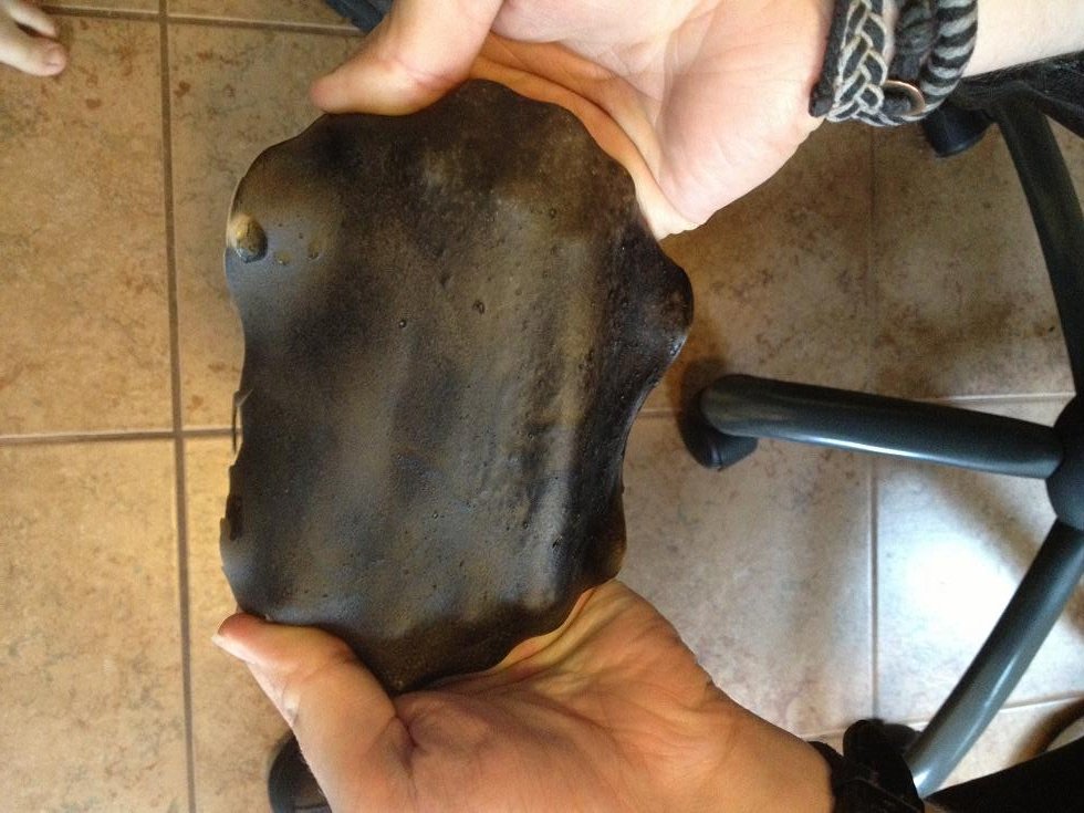

Success. The paint worked surprisingly well.
I added a base coat of pros-aid to the right half of this scrap - the left half was just bare latex.
I added about 15% v/v latex and and a touch of water to the paint.
The results were beyond my expectations. Flexible and flake free, even when stretched out to the latex's limits.
