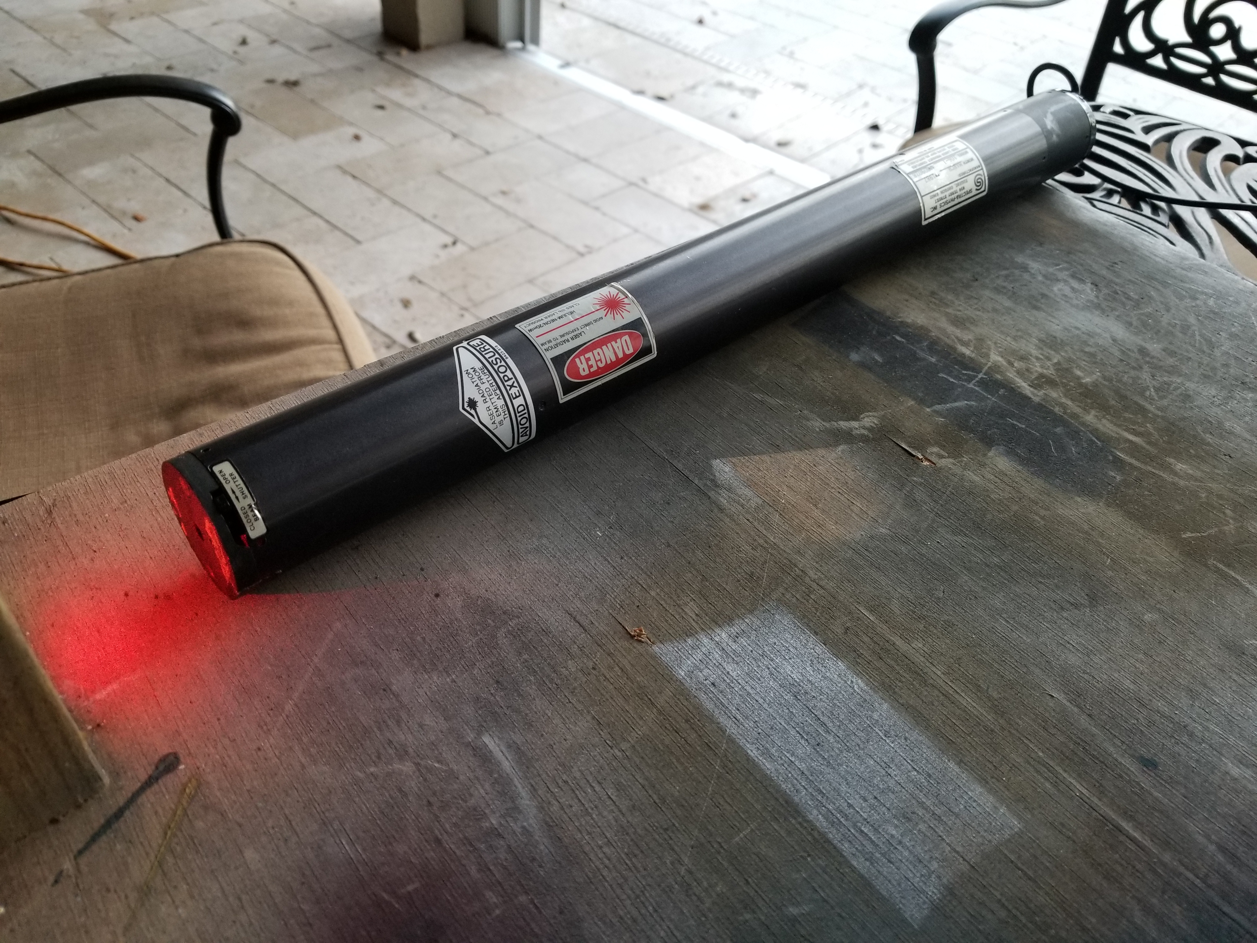

May I present the Spectra-Physics 106-1 20mW Helium Neon Laser:
I believe I've found the laser. It took a while of searching through "vintage laser" on eBay until I found a Spectra-Physics one, and saved the search. A broken one popped up last summer, but sold before I could make a decision (it was like $400 and I would get two other broken and inaccurate lasers along with it). But, I now had the model number! I had found a different website selling them, but they will only sell to businesses, schools, organizations, and government agencies. And I'm not any of those. So I sat. And waited. And then a working one popped up in the search I had saved for the model number! This one I jumped on immediately. When it arrived from Europe, I discovered that not only was the plug the wrong type (type J instead of type B), but it needed 230VAC to power the power supply! So I had to order a step-up transformer. And when that arrived and I could finally test it, nothing. It didn't turn on. Turns out it was just a blown fuse in the power supply, so $2.25 later it now works! All the stickers match the one in the film, and the main info sticker is a spot on match to what I can see. And it matches the matte section on the rear of the laser.

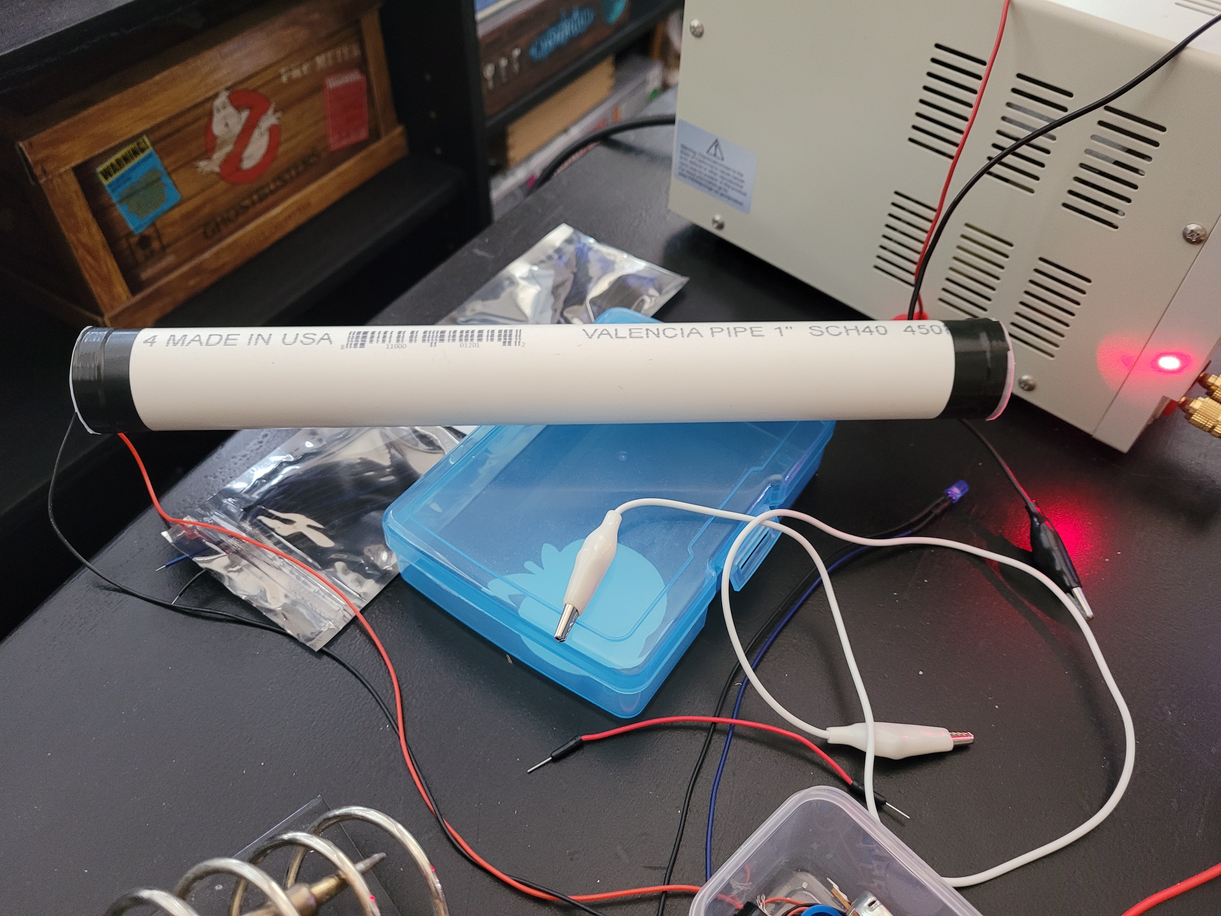

May I present the Laser That Is Totally Not a PVC pipe:
OK, part of that statement may be inaccurate, but at least I can run it off of 5v dc!

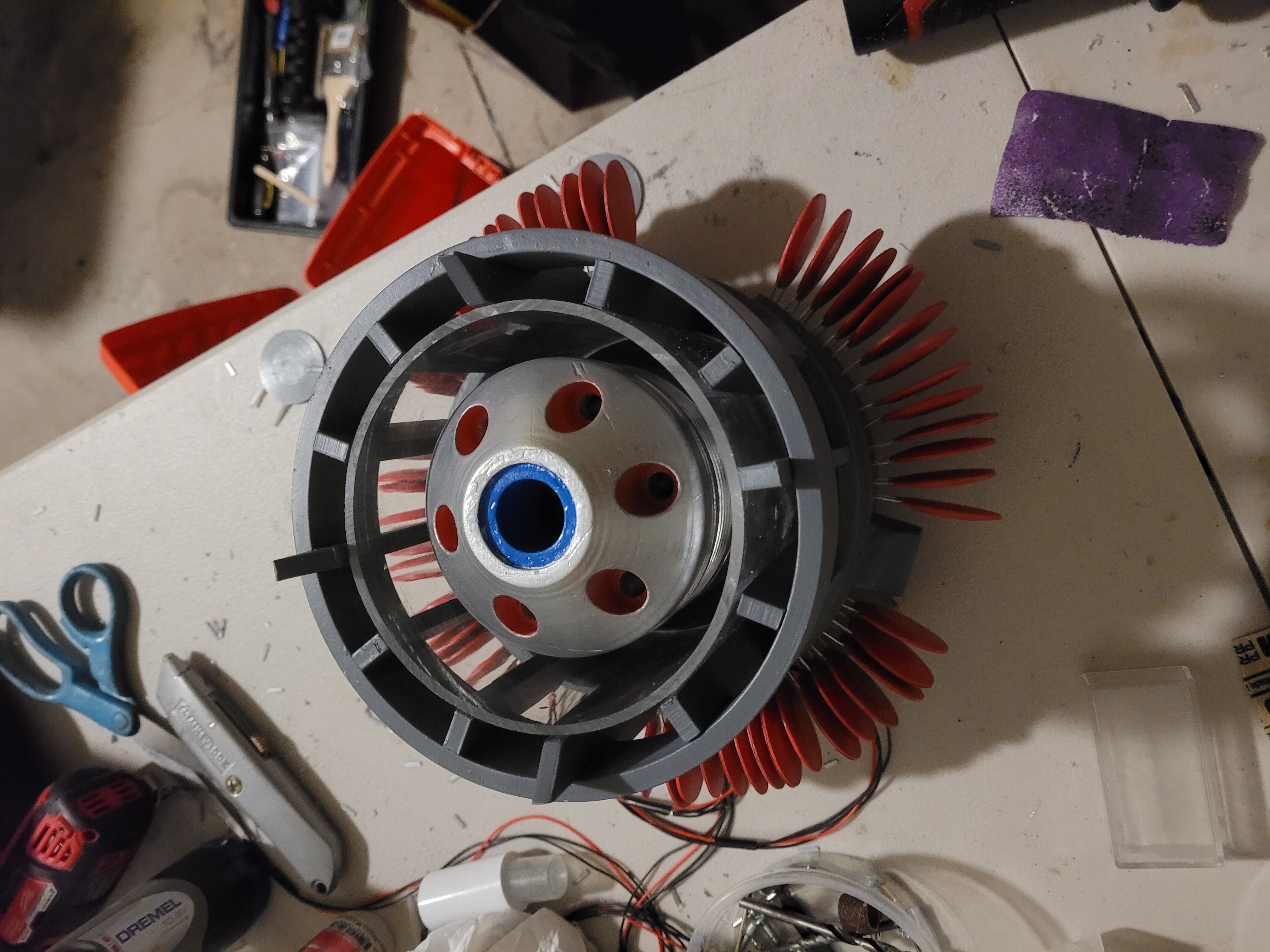

Latest and greatest from the weekend!
The nozzle assembly is now fully put together, and many of the various nurnies and whatnot are actually attached - it's still not permanently affixed to the machine, and won't be until I drill holes for all 9 million capacitors and mount them. Whomever follows my path and embarks upon this quest will have to pass through the valley of torment which shall heretofore be called The Painting of the Capacitors, which took an entire Saturday and approximately an entire season of Cowboy Bebop to achieve.
The next challenges involve electronics implementation in such a way as to not burn down the house.
Here, have some pictures. I swear I actually possess a tape measure, and, believe it or not, I have occasionally used it:
Some items of interest:

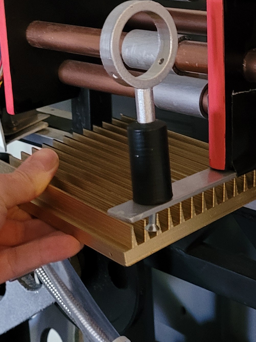

- made a bracket for the plastic "box" piece so it wouldn't bulge outward. I did this by hacking away at a piece of aluminum stock, and then managed to torch my fingertips by forgetting the laws of thermodynamics and handling said aluminum while it was still approximately 5000 degrees.
- I found a great fan in my junk bin that will run off of 12v dc - I wired it to my bench supply to test it; it fired right up; the vibrations it made shook it off the counter, onto the floor, where it broke into about 9,420 pieces.
- the "pvc laser" is now finally attached to the machine in a way that won't fall to pieces with a sideways glance:
- the heat sink I 3d printed - which is only half the overall heat sink - took a whopping 48 hours to finish. 2 subsequent attempts to print the other half have ended in catastrophe (re: the print attempts and along with them my monthly electrical bill).
I'm eager to get the electronics together, so our kitchen table can be used for less conventional things, like meals.

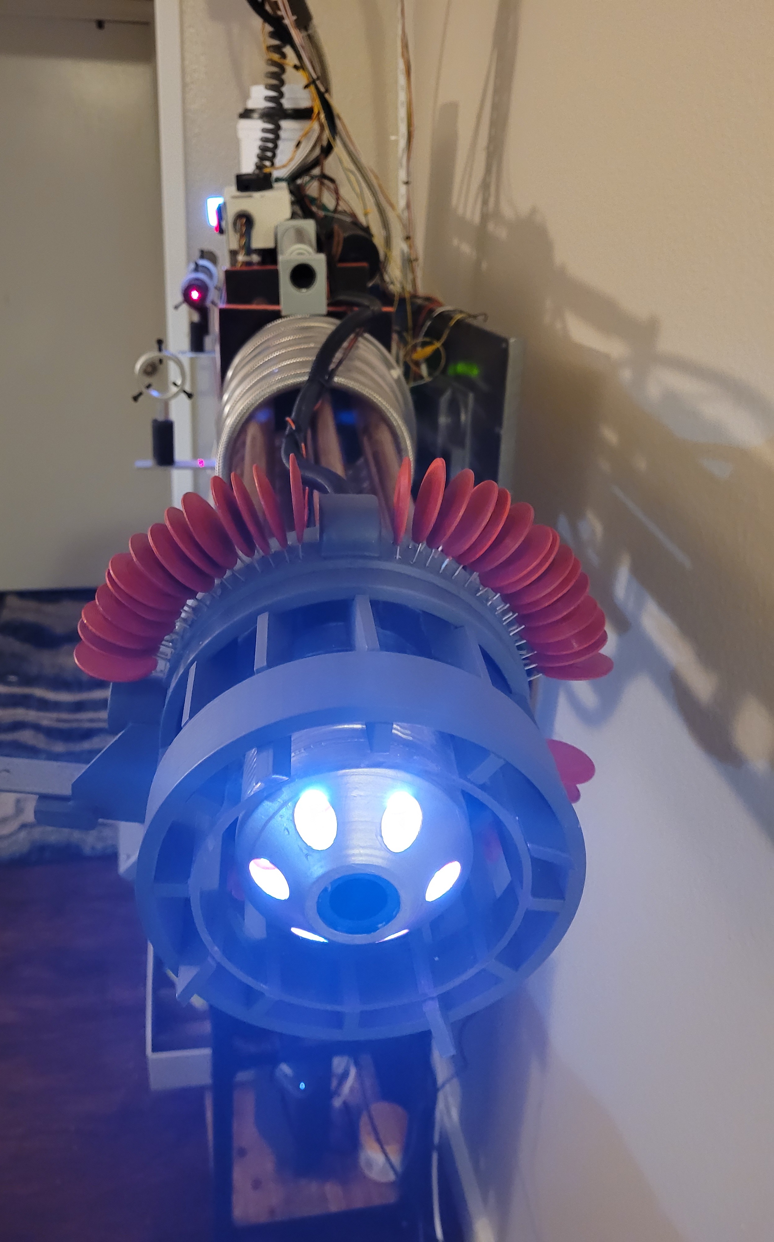

Hello!! I'm back with another (minor) update -
The big hangup in completing this project is (and will always be) money, but I finally decided to stop hemming and hawing and finish.

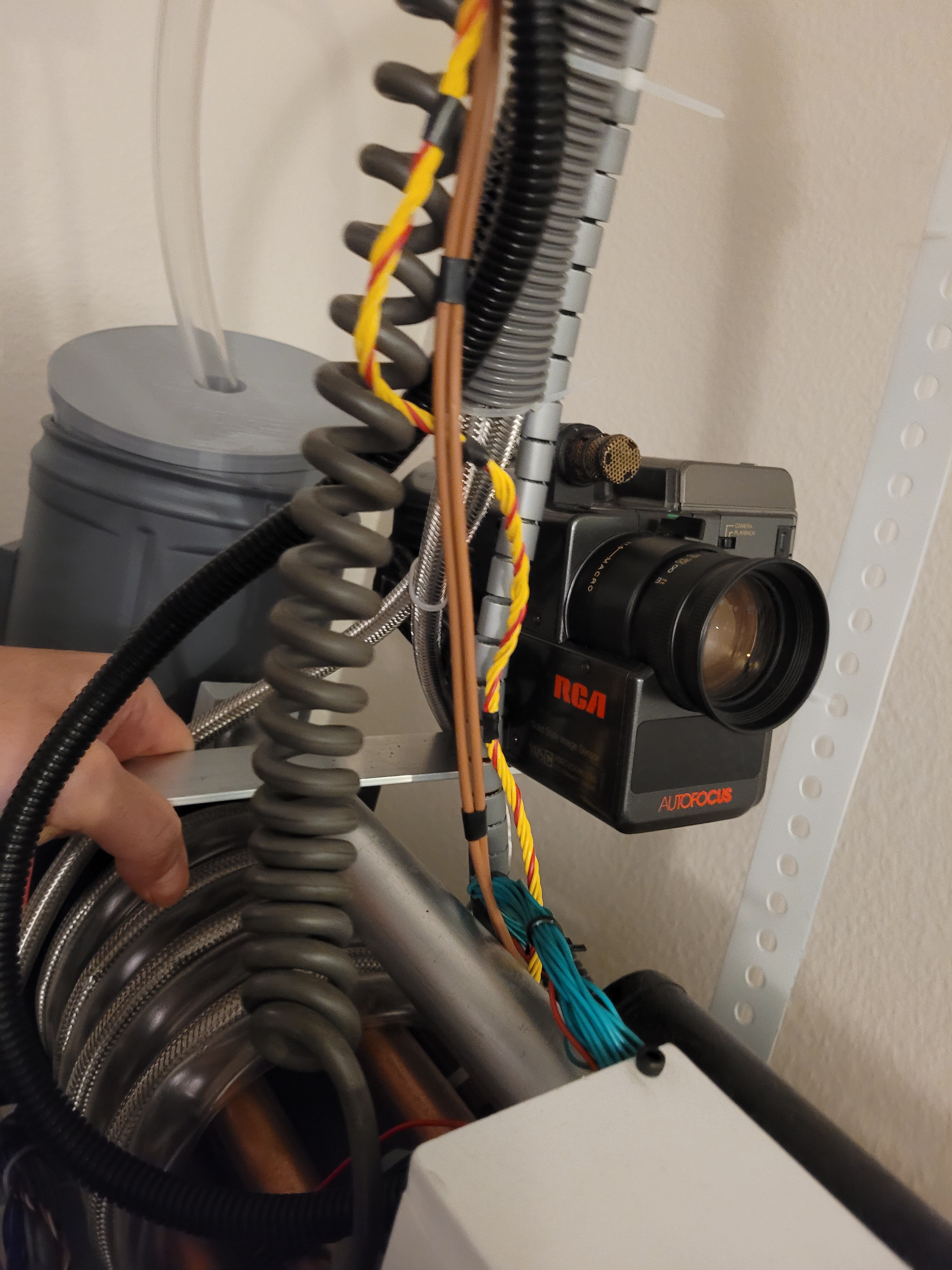

For a paltry $80 I was able to finally procure two items that are super important to balancing the forward profile of the machine; the screen and camera combination. Of course, being that (1) I already own the screen-accurate pieces (which I'm saving for a screen-accurate sequel project!), and (2) the weight of them combined would probably turn the "stink" machine into a crater, I had to go with a "stink machine" solution:
While it would be fun to stand there and hold these in place, the intention is to mount them to the aluminum bracket I made; I'd 3D printed clamps to help achieve this, but they were about as sturdy as ritz crackers due to some printing errors, so I'm exploring alternative ideas.
In other news, I came within 1 soldered connection of actually finishing up wiring the on board LEDs. Then, something happened. Maybe I miswired something, perhaps a moth farted dust into a connection somewhere, who knows, but instead of acting normally and being, you know, controllable, the LEDs will now only do this. I wish I could say this behavior is intentional as it's kind of cool objectively, but at the moment it's basically a visual representation of my rage.

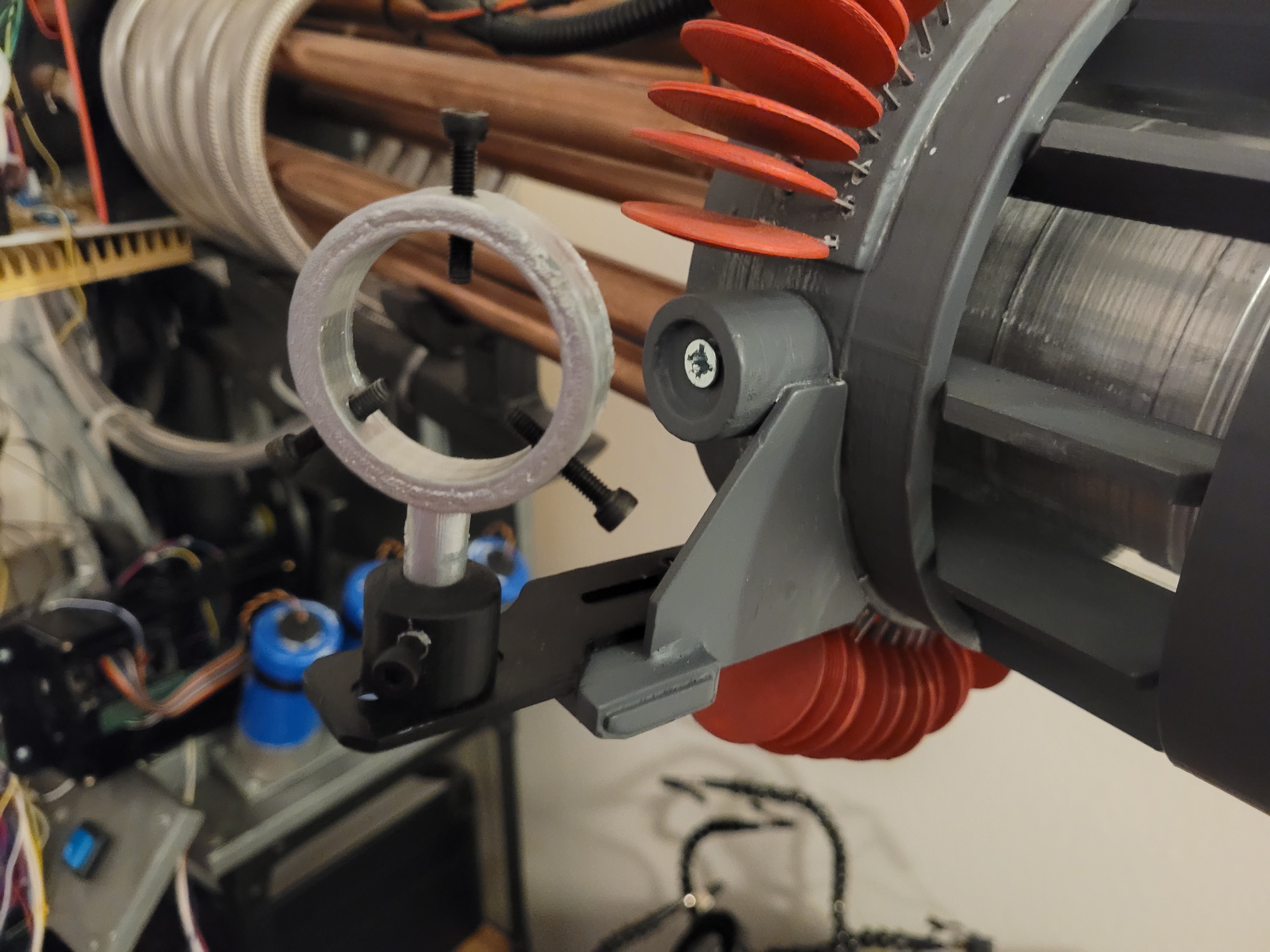

All side laser components have been printed and permanently (haphazardly) affixed:

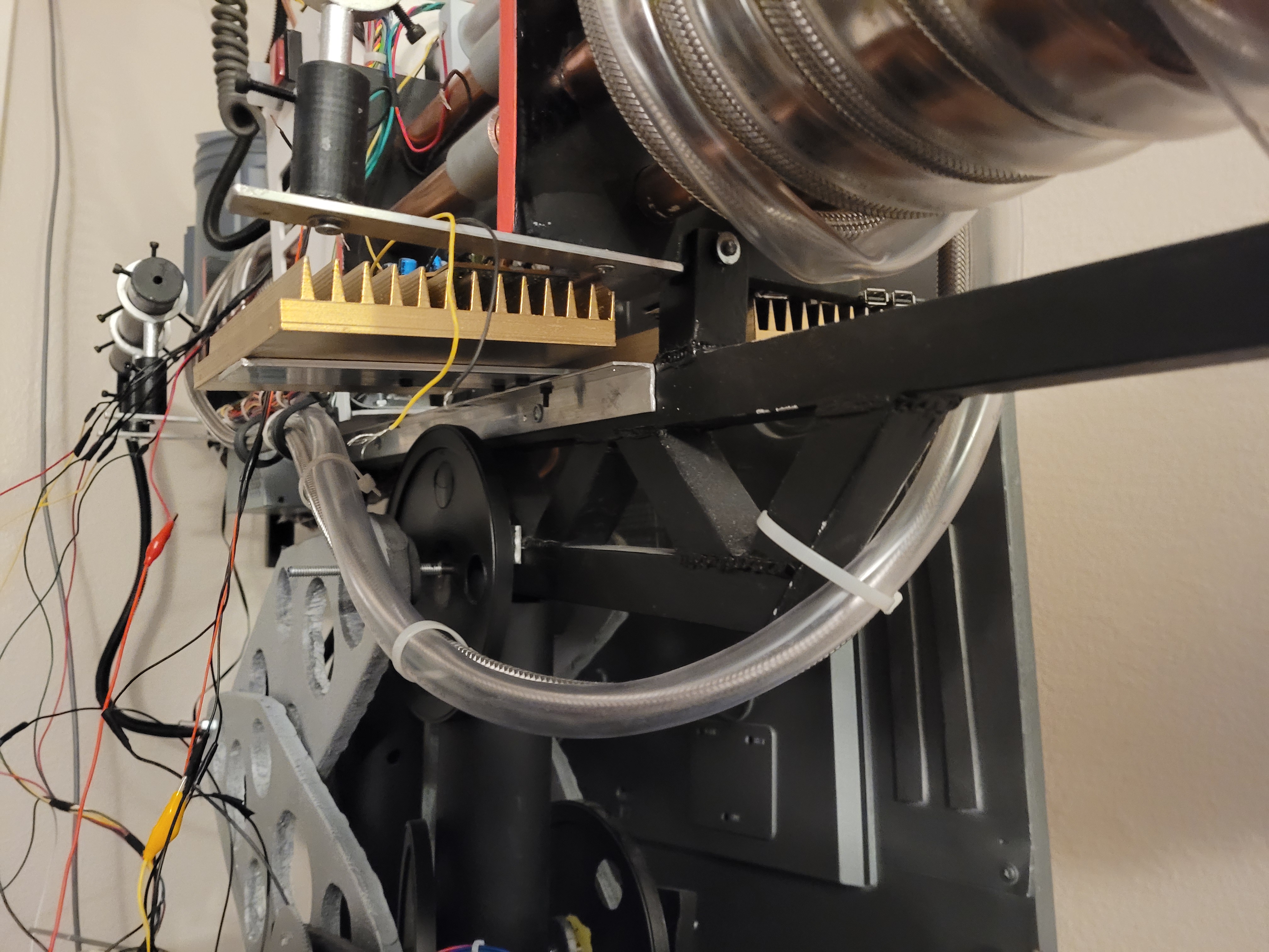

...the "heat stink" has been fully printed, painted, assembled, and attached (it only took 5 attempts for the print to not go wrong hilariously):

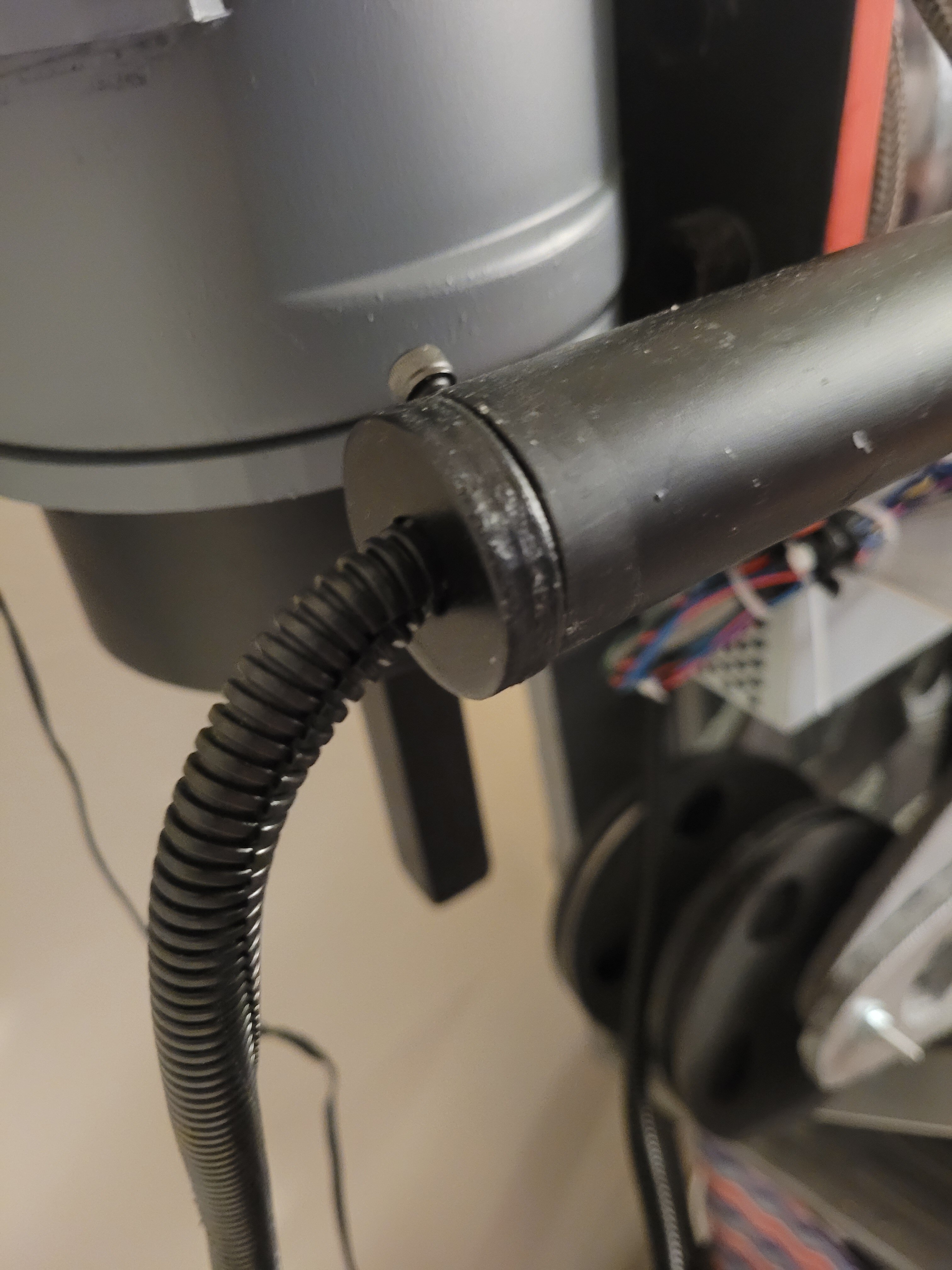

And lastly, I printed a new back piece for the side laser better capable of accepting leftover split loom:
