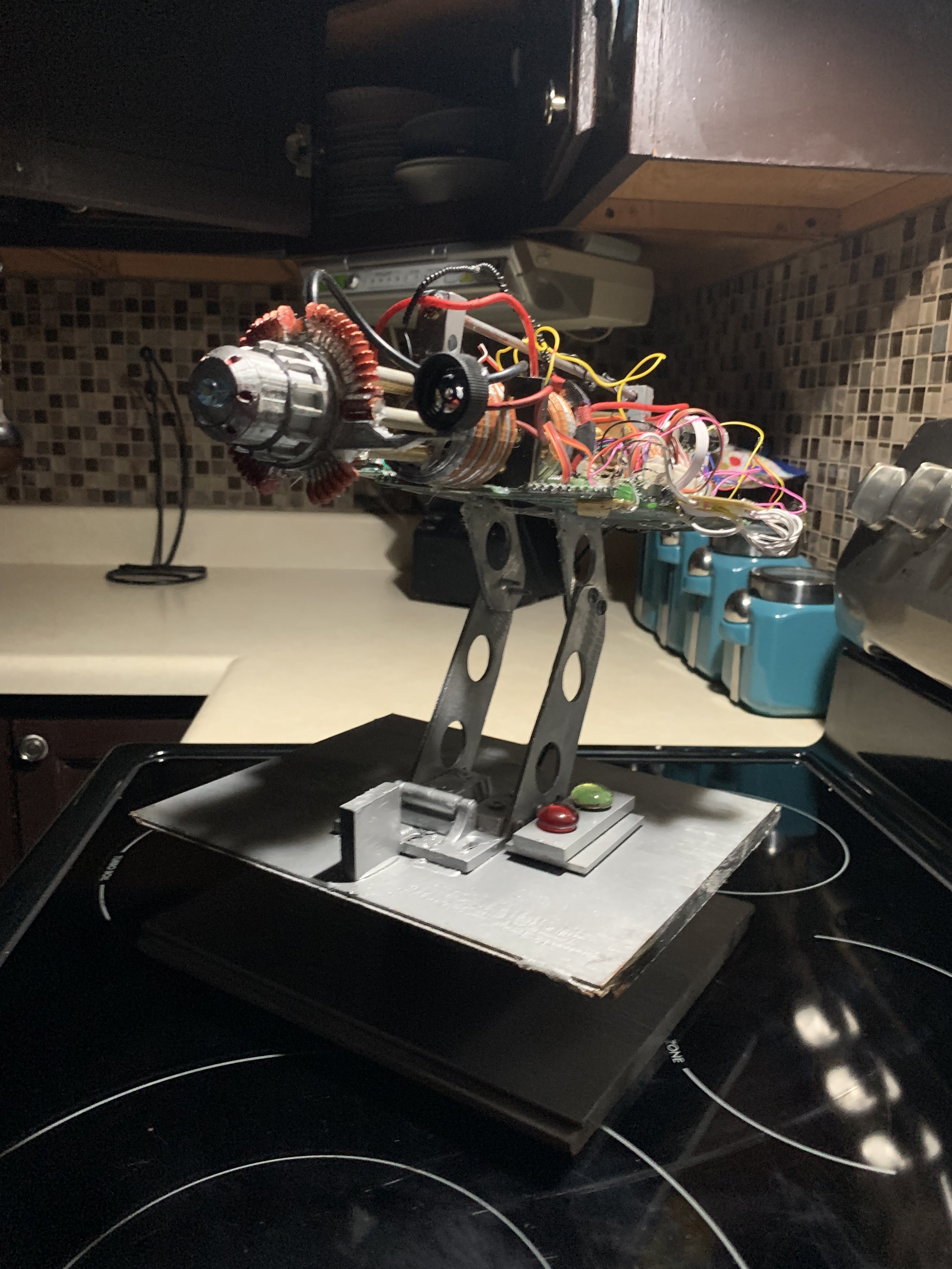

Nice small scale model, it looks like a good use of scrap. And thanks for digging up this thread, it was a fun read.
thanks, the printer I had wasn't able to print it full scale so id say its about 12 inches tall. everyone on this thread has done an incredible job of digging up rare and otherwise obscure parts and I hope to one day create a full scale version but for now this works just fine
