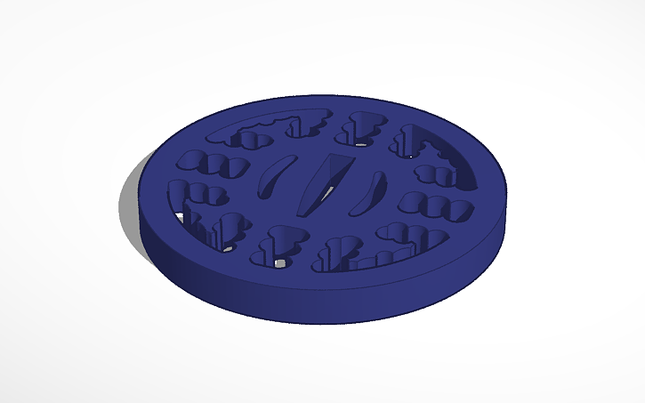

Hello all,
I wanted to see if anyone could help. One of our great members here provided a link for a Highlander I Tsuba and I can not only not get it to download, I would have no idea what to do with it if I could.
Does anyone know where I could get this cut in Brass and how I would go about that?
Thanks

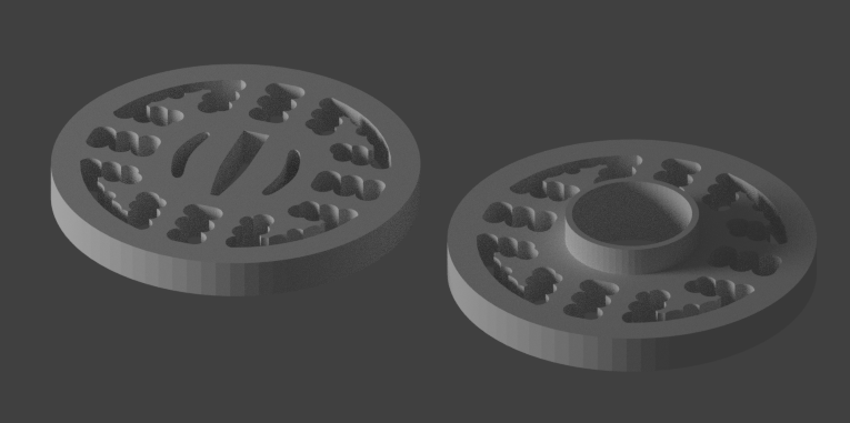

Those files had two versions, but the main bodies both measured 8.5mm X 80mm round. So you're looking at 11/32" X 3 5/32".
I posted a pic of the two Tsubas included also just to note- if you get one cut/machined, I would get rid of the faceting on those side walls. Like STEP conversion, it's an easy fix, but that would be annoying to pay for a machined metal piece and find you've gotta sand/polish those flats down.
Okay,
No clue what the one with big whole is for.
I will absolutely take care of the "faceting" as soon as you explain to me what that is and what Step Conversion is?
