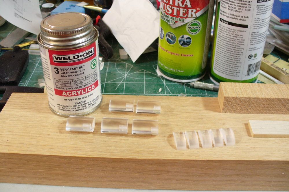

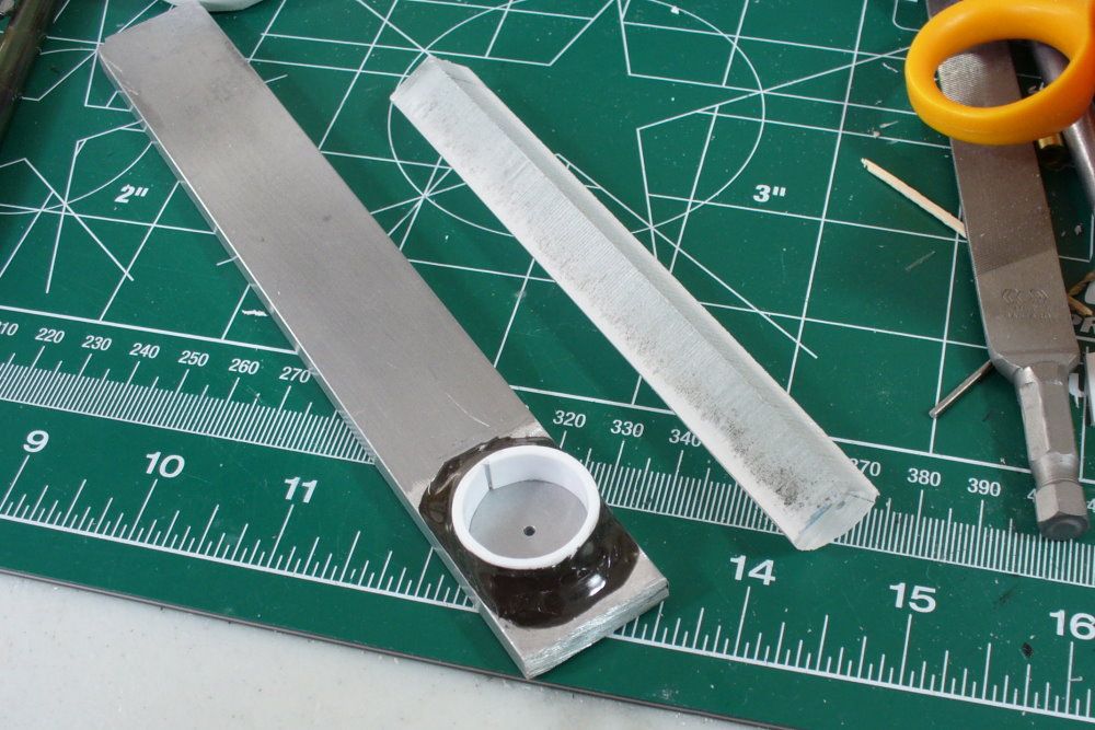

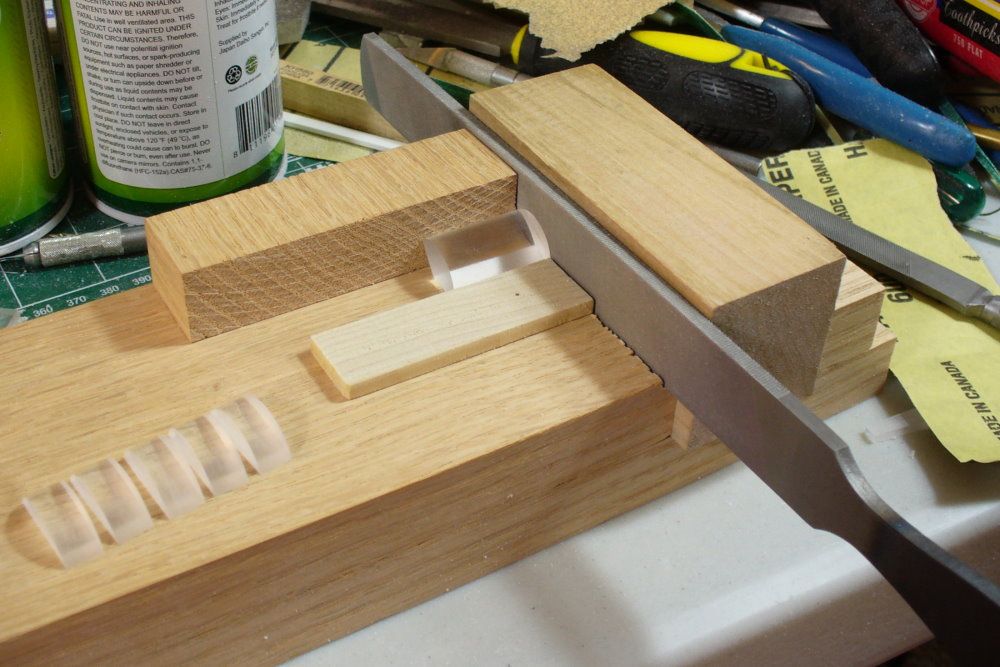

I've been working on the clear sight and meter dome parts. Cut from acrylic rod, but I have to sand it by hand because power sanders run too fast and melt it. I made a jig to keep the ends square while sanding.
This jig will be a guide for drilling the axle holes in the sights.

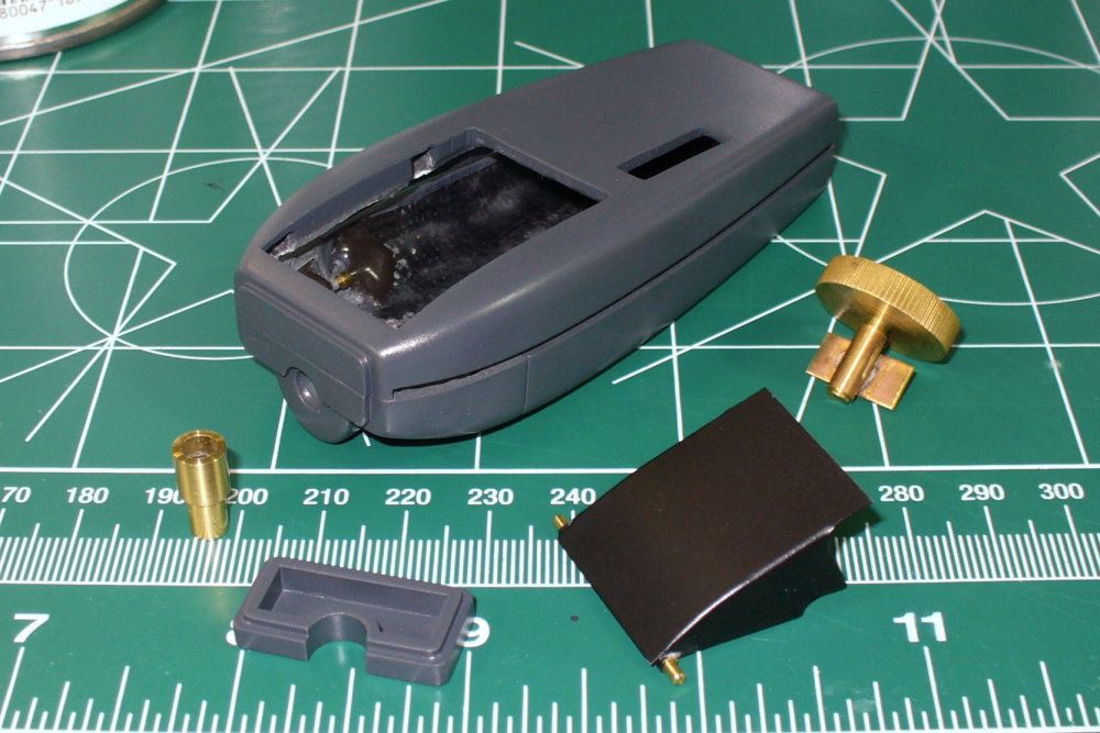

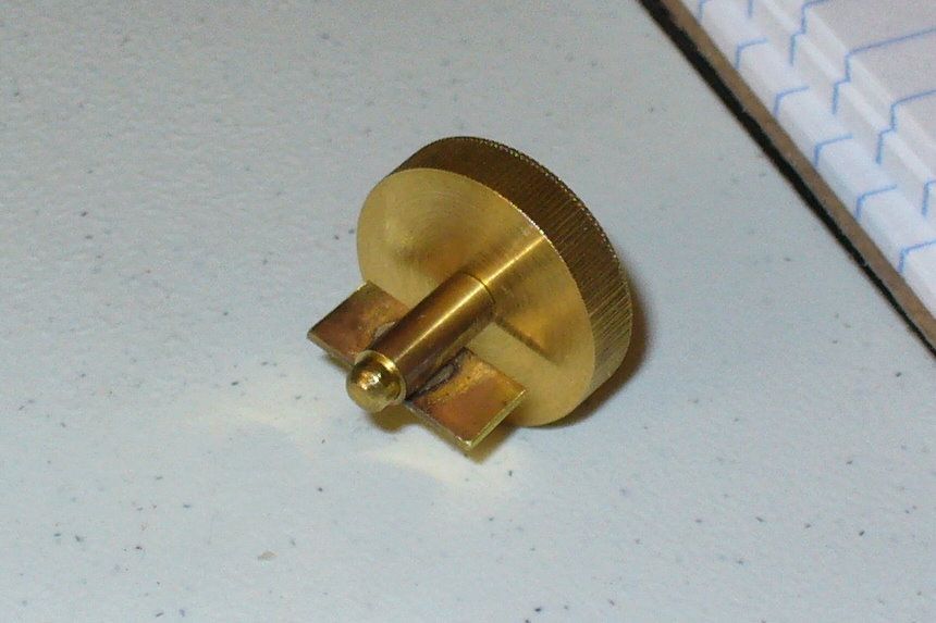

The axle mount for the thumb wheel, not authentic but it's easy to build and it works.

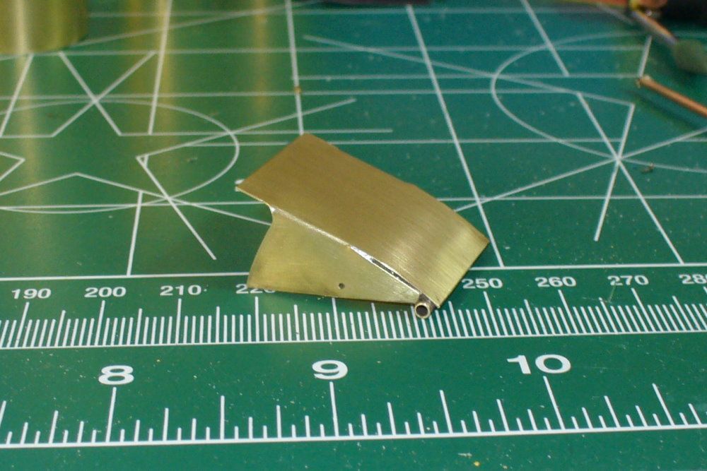

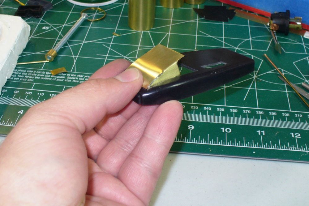

Also made the brass sight hood.

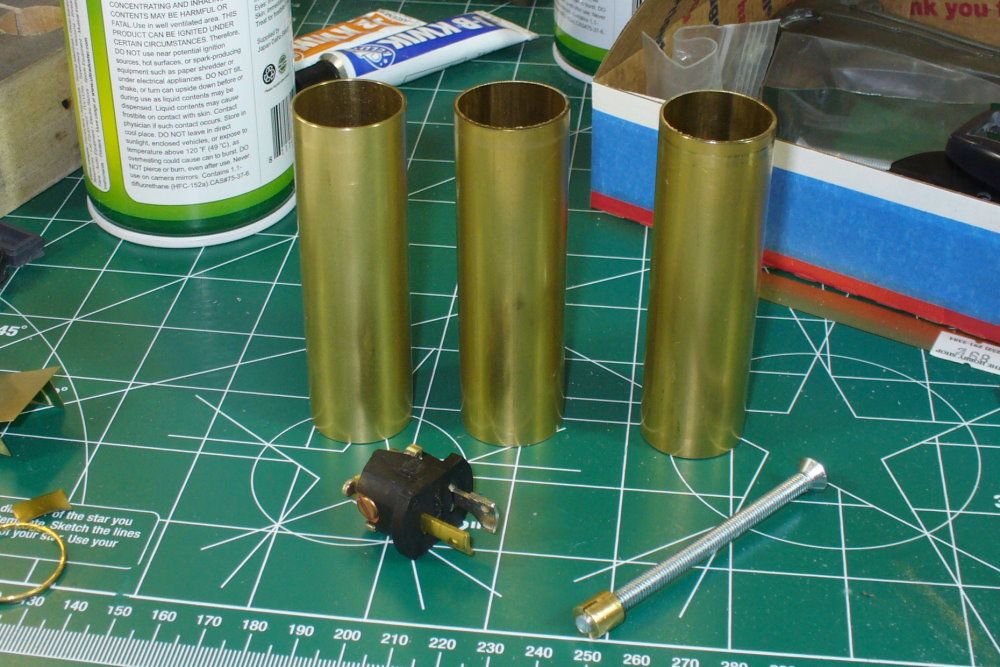

And got started on the handle. I cut three handles to length with a tube cutter.
And had this much left over :cool

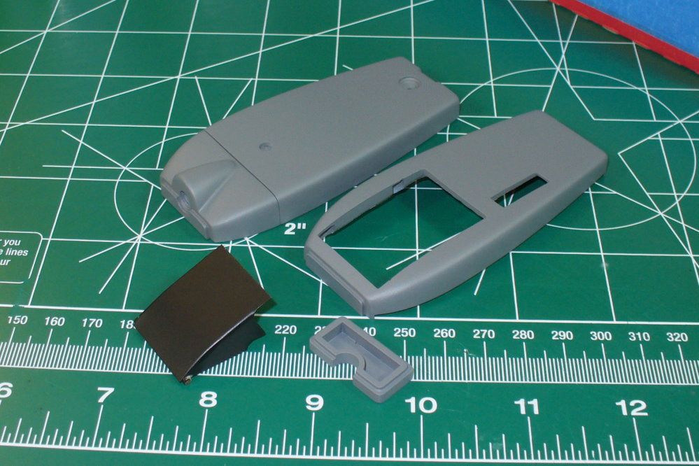

P1 shells are primered and ready for paint.
