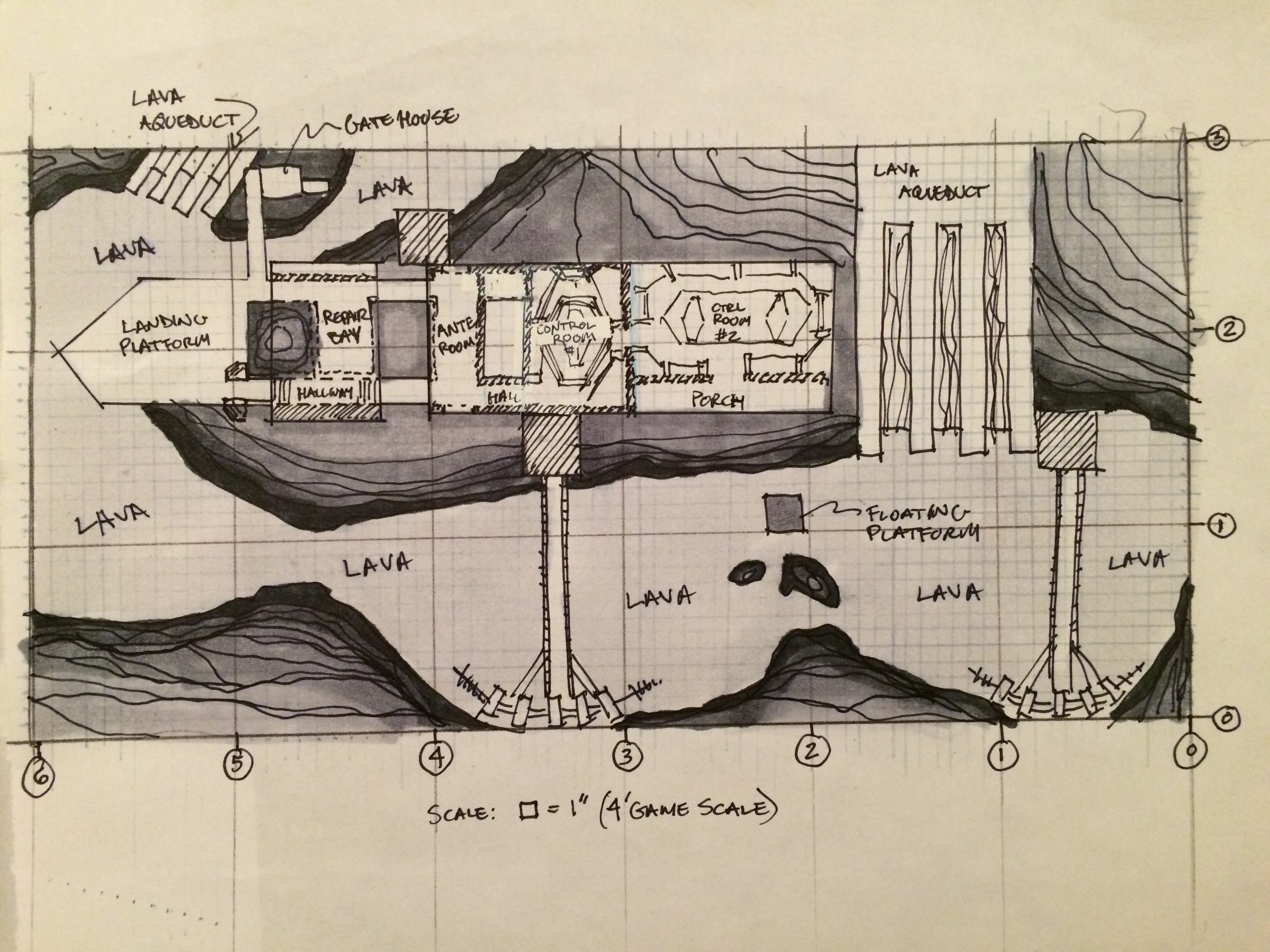

I have 450 pixels so far hoping it’ll be enough to do a couple lava streams on a 6’x4’ board. See attached rough layout I plan on using. My initial plan was to mount them around the perimeter of the flows pointing toward the center but that might require double the lights I have. I’ve got 3 - 1M strips of 150 pixels each. I’m thinking I’ll probably need to double that to have two parallel side by side 2M strips in the main flow then two parallel 1M strips in the secondary flow. Or at that point I can just do my original plan and run lights around the perimeter. I think though I can just cut up the strips and only line the lava flows as necessary. Easy enough to wire them together. Based on the rough plan and counting the feet the latter plan should work.
As for construction I was thinking of having the main base board with a platform built on top of it leaving a 1/2” gap between baseboard and platform. The lights would be mounted vertically in that gap to outline the lava flows. Then to make sure there aren’t any dark spots in the middle of the flows I’d line the baseboard with tinfoil (slight mound toward the center) to reflect the light upward. The “top” of the lava will be thin plexiglass with airbrushed lava effect on it. The lights will be backlighting the painted plexiglas. I’m hoping the lights I’m planning will be bright enough without having to run them at full brightness constantly.
