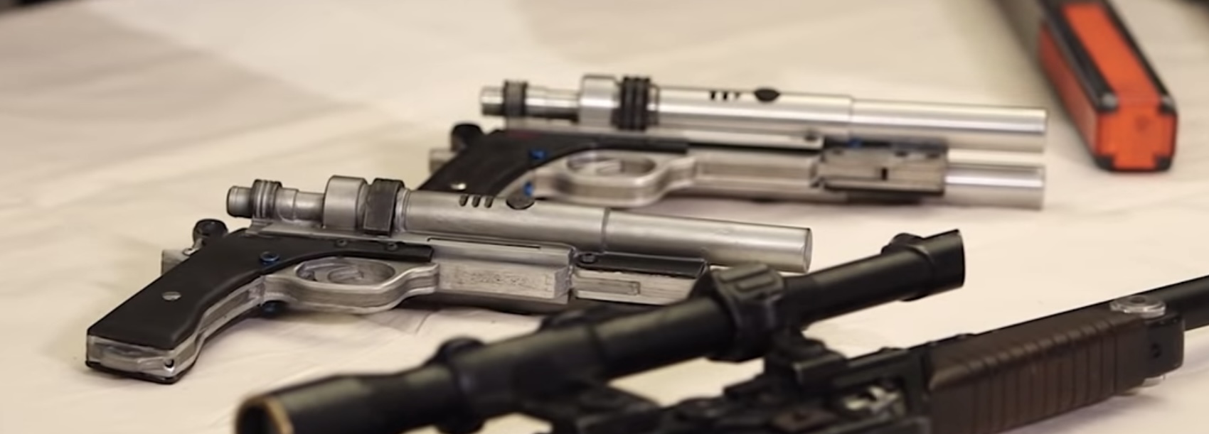

Hey guys! I'm working on a custom blaster and I am a bit stuck on making a clean break action. I am particularly in love with the sliding forward to hinged mechanism on qi'ra's blaster here
. I know I can use a small bearing slide track for the forward motion but does anyone know how to recreate the hinging motion with that, or what a combo sliding to hinge track would be called?
You can see the back of the mechanism here for a brief sec
Watching the video it pivots on the first pin only. It’s just a simple arm that pulls forward and the once the barrel slides out it allows it to pivot down.
By the way it is being held it’s just a friction fit
