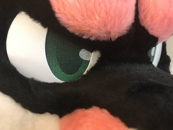

Just my two cents, but I would build the entire cosplay out of EVA foam (including the head). That will keep it light, fairly damage resistant, and be affordable.
The biggest issue with the head that I see is vision, but that's also pretty easy to work around. The wearer's line of sight can be placed right behind the large eyes of the face, and those eye areas can be cut out and replaced with perforated screen/ cross stitch plastic/any sturdy mesh material. Once the mesh is installed, you can paint on the eye details right onto the mesh surface. Combined with the head's interior painted black, you'll be able to see out quite well without anyone seeing in.
I should give a bit of an update, I did start to make the head out of cardboard starting with the bottom area just so I would have a better reference before I start working on EVA foam.
And I did make it where my line of sight matches up where the eyes will end up being and its perfect, I am still working on on the top part. As for the eyes, I am going to use some LED lights, so I’m sure that’ll affect it a little, but I truly appreciate the help, this is really useful, thank you.
