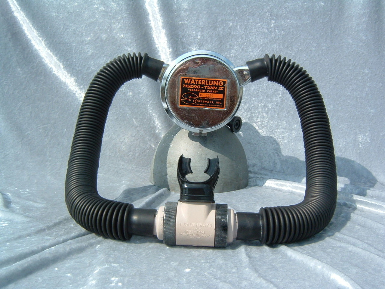

That looks really promising. What's the OD?
I don't know the OD yet - I don't have them in hand so I'm just going off the photos. But looking at the ends, the thickness of the corrugation seems about right.
