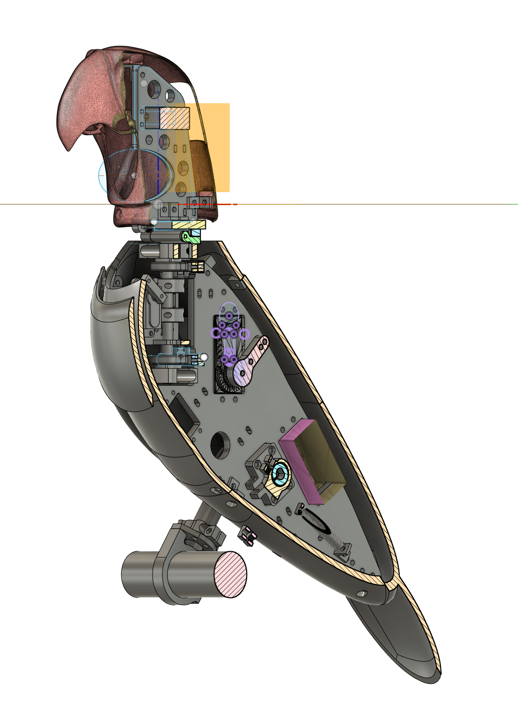

This is just a theory, but you could design an smooth exoskeleton, with joints to cover up the mechanics (much like a knight's armour) and then use a stretchable fabric like spandex or something to cover it up. Then you could glue or sew the feathers in layers to the spandex. the glue would limit the flexibility somewhat, but only at the places the glue adhered to. You'd get the skin stretching and contracting, but without the unnatural folding as with leather.
The exoskeleton would resemble something like this, except with possibly a couple of more joints.

The fabric is attached so it looks right in its rest position - in my case with the neck down- It will easily stretch as the animatronic moves.
For my birds, an aluminum armature was laser cut, and a 3D printed, PETG shell was attached using 4/40 angle brackets:
www.robotshop.com
4-40 Angle Bracket (10pk)
Description Simple angle brackets with one threaded and unthreaded hole Can also be used on the universal plate set for mounting all sorts of sensors Pack of 10 The 4-40 Angle Bracket (10pk) are very handy. Use them for connecting PCBs at 90 degree angles, mounting accelerometers, gryros, etc...
www.robotshop.com
www.robotshop.com
Your idea for a shell sounds workable.
You could also sculpt a shell and vacuform a skin, attaching it your box with standoffs or RC linkages.
Weight is the key concern for your animatronic. Whatever you use I would try to keep it as light as possible.
The feathers can be hot glued directly to the PETG.
Friendly advice: Trim the quill, and use a silicone sculpting tool or popsicle stick to press the feather into the glue. Otherwise you'll burn your fingers. It's embarrassing how many times I burned myself before figuring that out!
Good luck! I'll follow your post with interest!

Now I have a target approach, I'll probably mock it up with some of the non stretch fur fabric to get an idea how it will work & see what sizes will be needed.
From experience so far I'll probably have to re-do things a time or three to get them to go properly!
eg. The neck mechanism in the photos is Mk 4, I think - the first couple of attempts just did not work properly, then the next worked well but was too bulky to fit within the body.. I kept that in case it comes in for something else.
(MG90 servos, the sides are just under 3.5" long).
After seeing yours in the video, I may also add another servo to tilt the body rather than the rigid mount I have at present - the effect is quite dramatic and very looks worthwhile, if I can fit it in.
