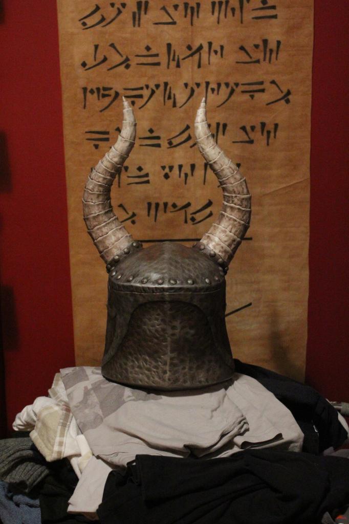

Here is the helmet as it appears in game-
I also used some helpful reference pics posted on Mr Pinski's build thread.

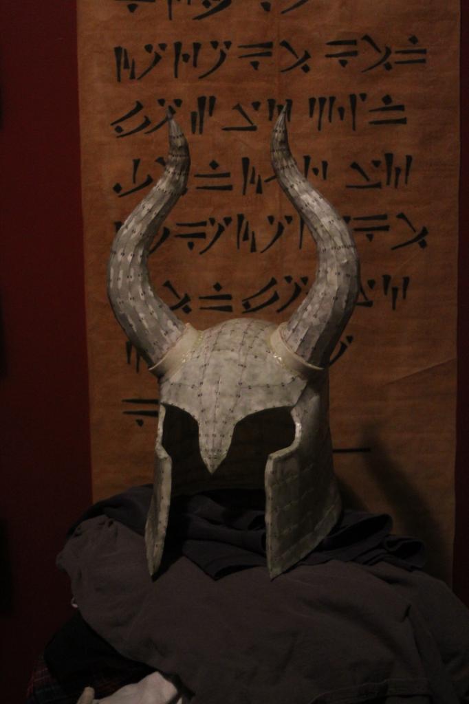

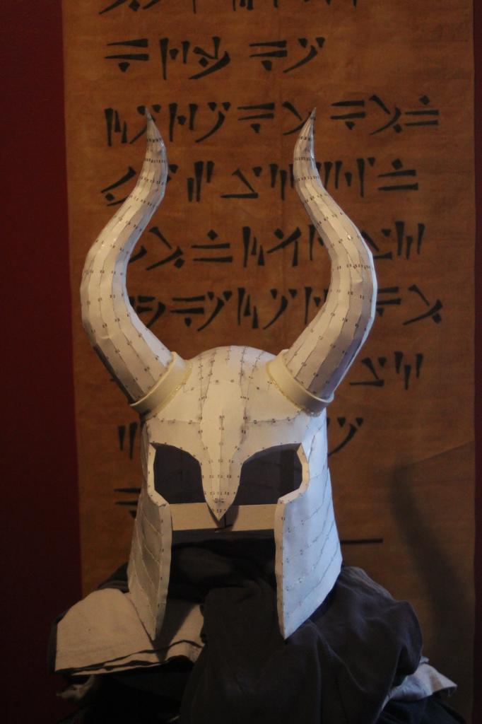

First I started with the pep file. Found one without sharp edges for quicker sanding once the bondo coat was put on.

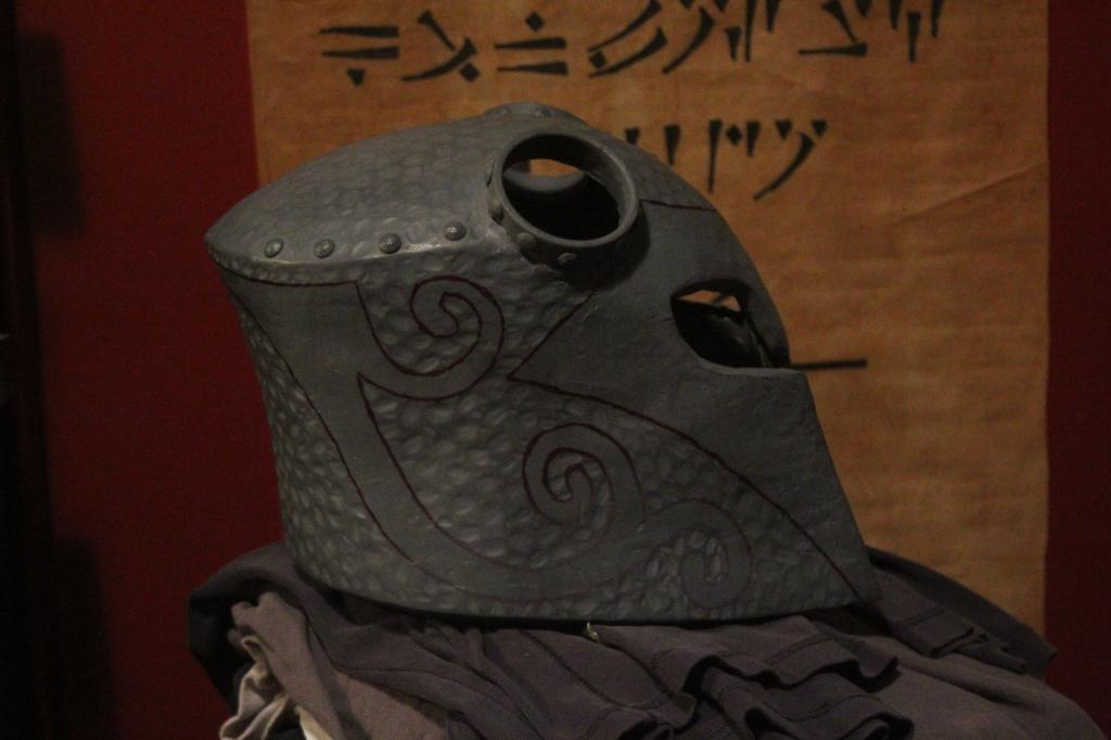

I wanted to make the horns detachable, so I attached two 3" PVC couplers to act as the horn mounts.
Then I resined everything seperately. Two coats on the outside, three slush coats on the inside.

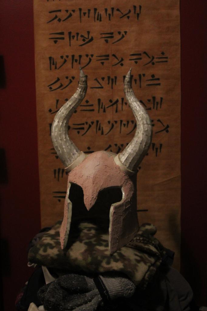

The horns were slushed also.

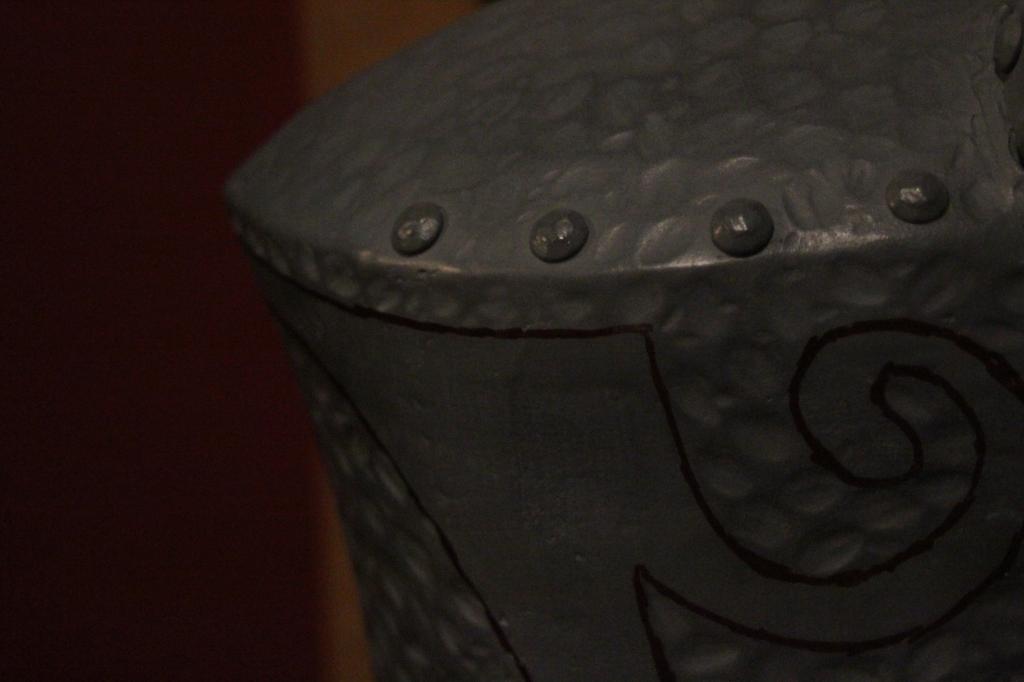

I finished up a can of old, nasty Bondo. That left a lot of ridging, so I had to sand the bejesus out of it :unsure.

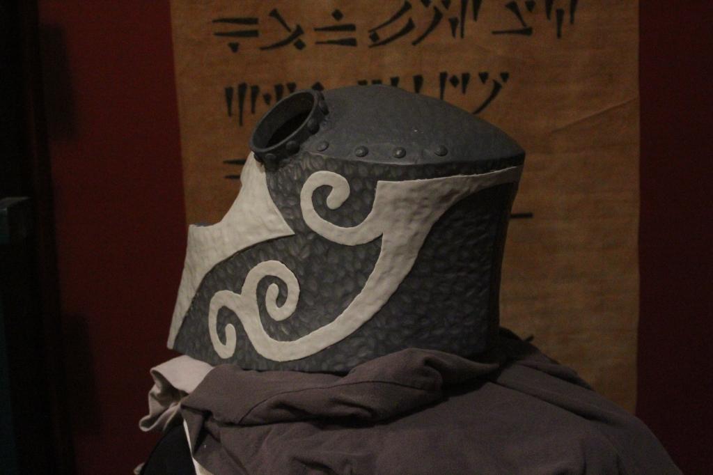

Got a new can of Bondo, and finished up the helmet. To simulate the "hammered" look of the helmet, I used my Dremel w/ a tapered sanding bit.
I primed it between sandings to see how I was doing.
The rivets are decorative tacks from Hobby Lobby that I drilled in and super glued.
Apoxie Sculpt arrived in the mail, so I got right to that.

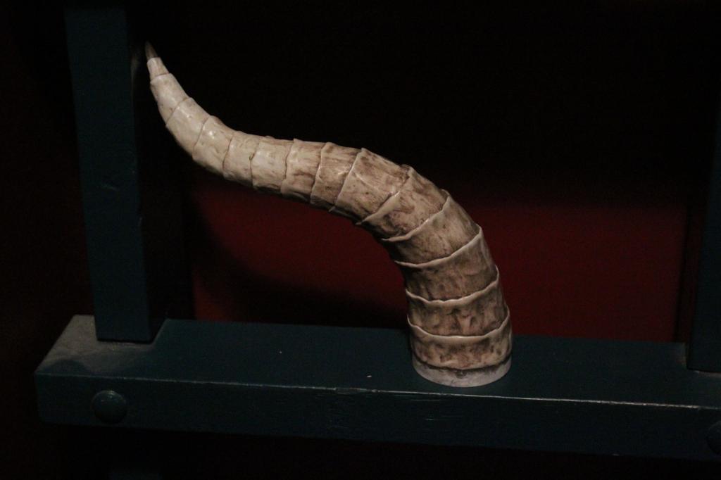

Horns, too.
Primed and painted the gosh darned heck out of everything. Flat white for the horns, Rust-Oleum Hammered Metal for the helmet.
Now on to weathering...
The horns were done using three different washes of acrylic paint, fading from dark to light.
Did a wash of watered down black acrylic paint on the helmet, letting it get into all of the divots.

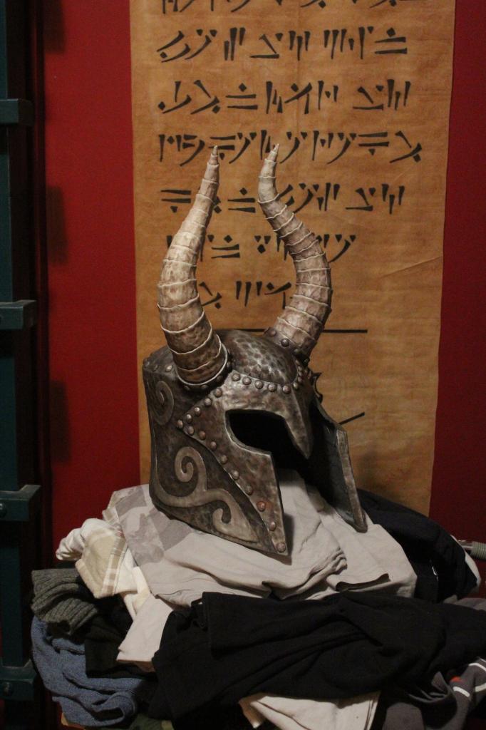

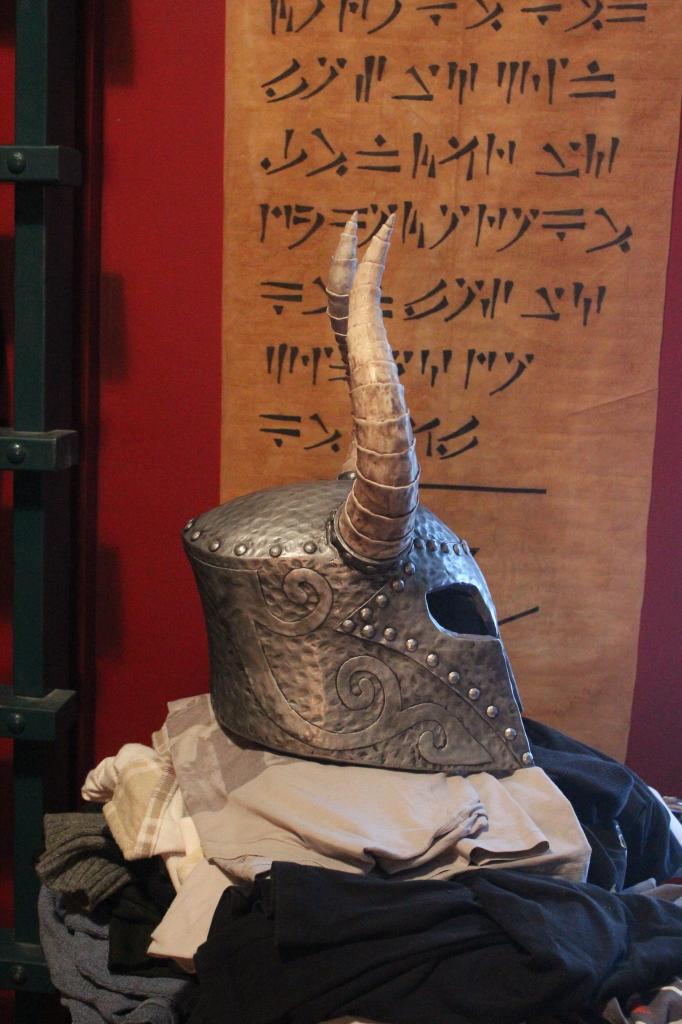

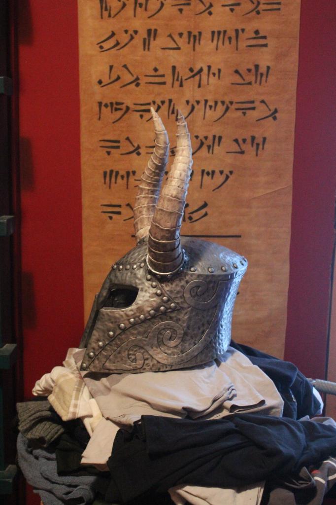

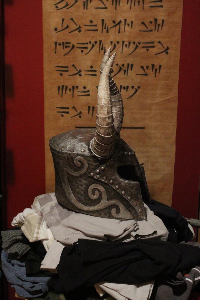

Then after a 4 hour long rust, grime and Rub' n Buff session, this happened...
Sooo worth it in the end
