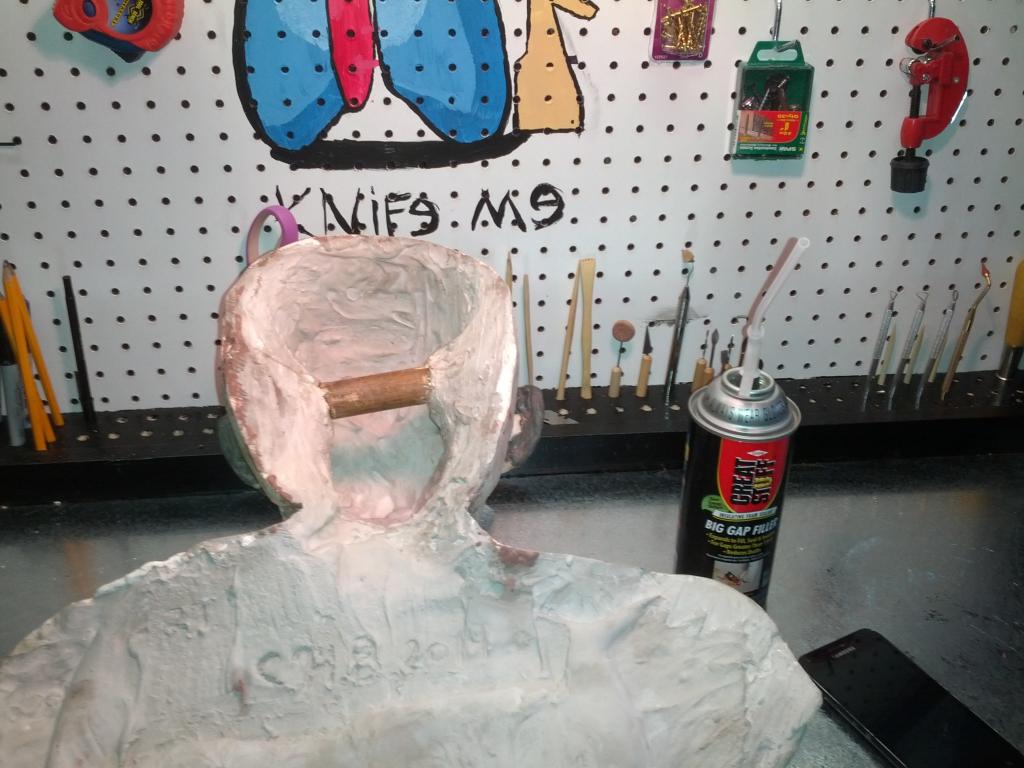

IMG_20141125_142958_zpstqg0gtz0.jpggetting ready to fill the back with foam

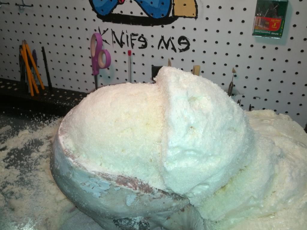

IMG_20141125_172603_zpsuxn7wt7z.jpgI started carving away at the foam only to find it hadn't yet fully cured

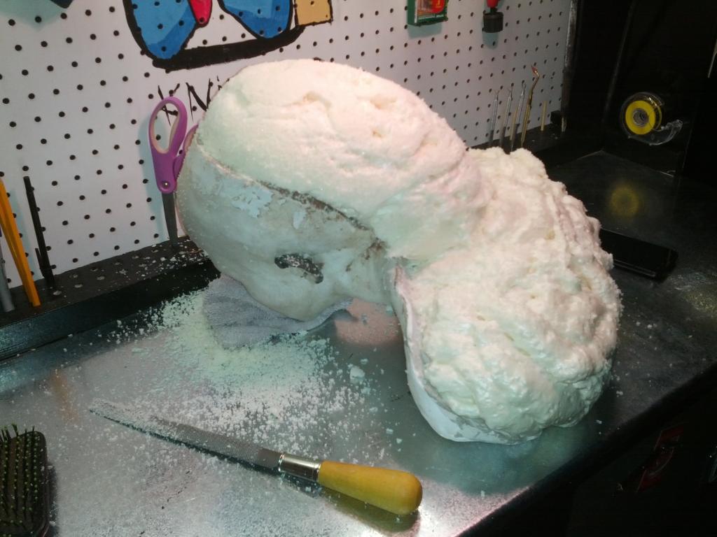

IMG_20141126_133740_zpsibyjvilf.jpgonce it had fully cured I started to carve away the majority of the foam to make the new back half
