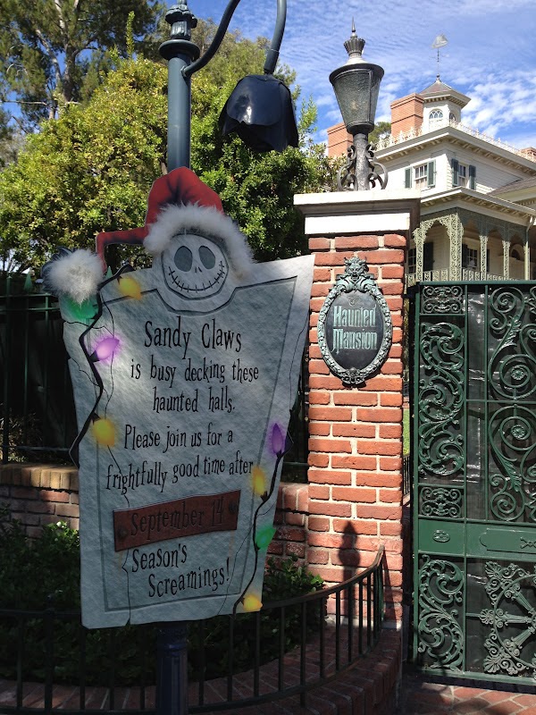

Greetings fellow Mansion fans! I wanted to share my steps in reproducing one of the front entryway columns at the Haunted Mansion. I tried to make it as authentic as possible, but had to limit the height so it would fit inside my house. :)
Here's the real McCoy:
next up materials...
