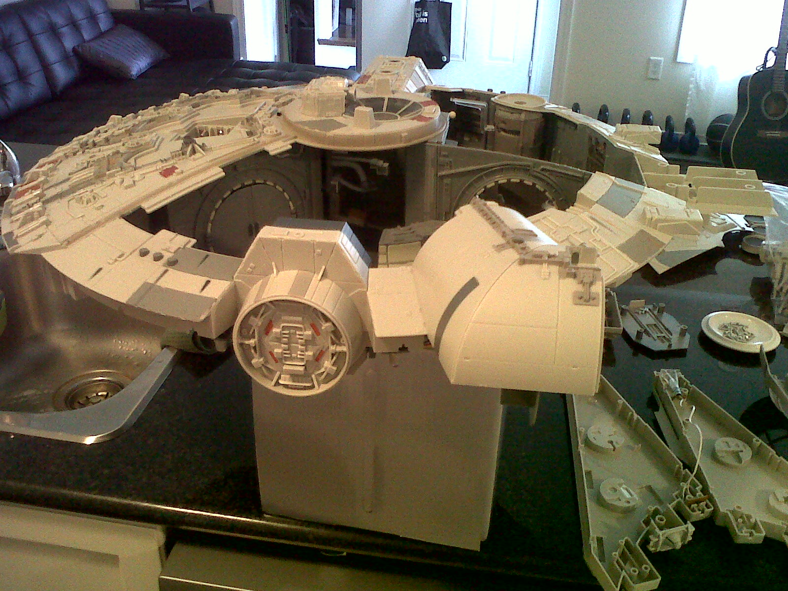

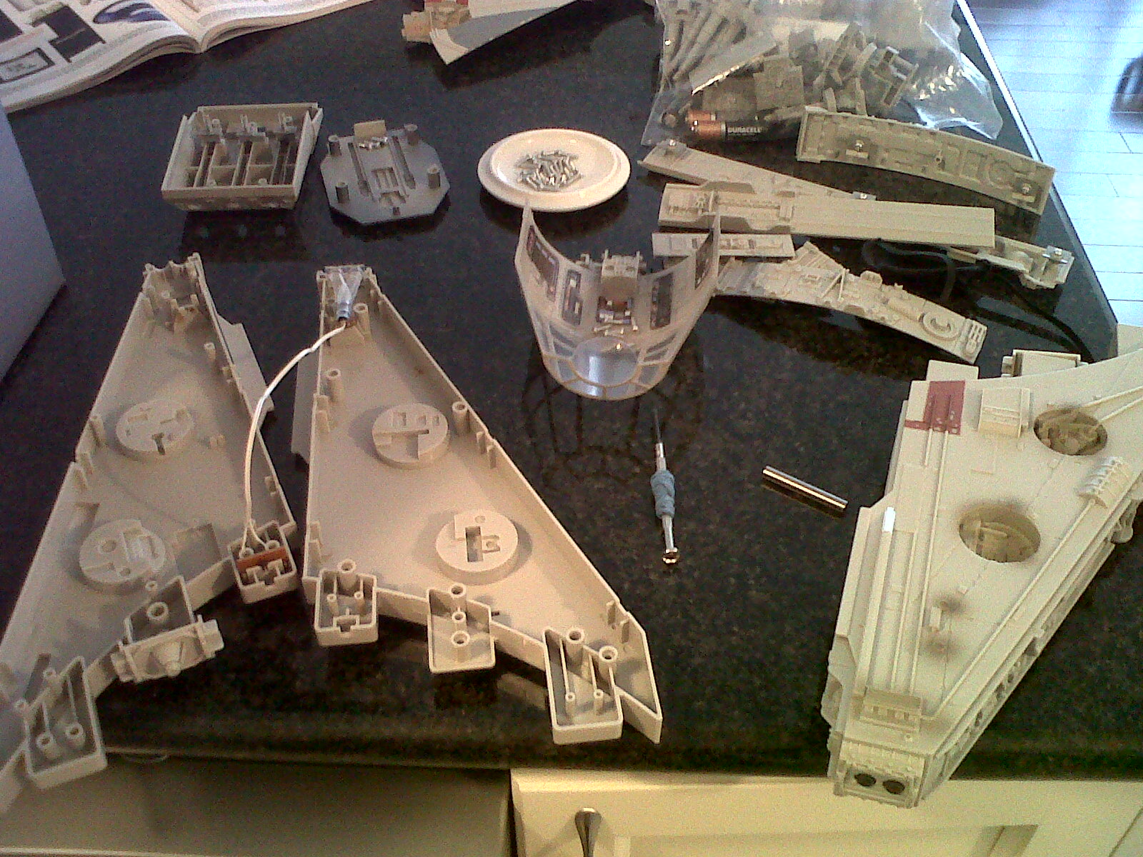

dis-assembly has begun. I should probably plan this a bit more.
After going through this thread and kokkari's thread, then handling the physical thing and also taking it apart - there is a lot involved and I'm flip flopping.
I don't want to get in over my head. But I don't want to end up with "flaws" that will eat at me either. I also like the light and sounds and interior and am thinking if there is a way to keep all that.

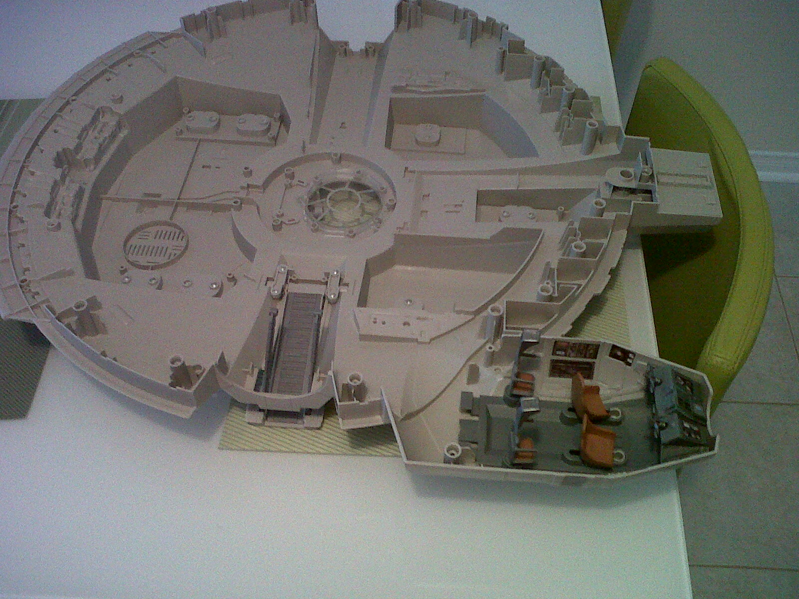

your list is spot on.i spent 4 months on mine and stopped work on it to have a break.next part i plan to do is the cockpit and tunnel.
dont be afraid to reduce all sidewalls,it has to be done and once you test fit the top and bottom hulls you'll be pleasantly surprised to see how good it fits back together and looks sweet.
there is a lot of dremel cutting to do and some locating pins need to be cut off completely and other pins just cut back a small amount and they can still be used as locating pins.
hard work but not too complicated and you'll get a great result.

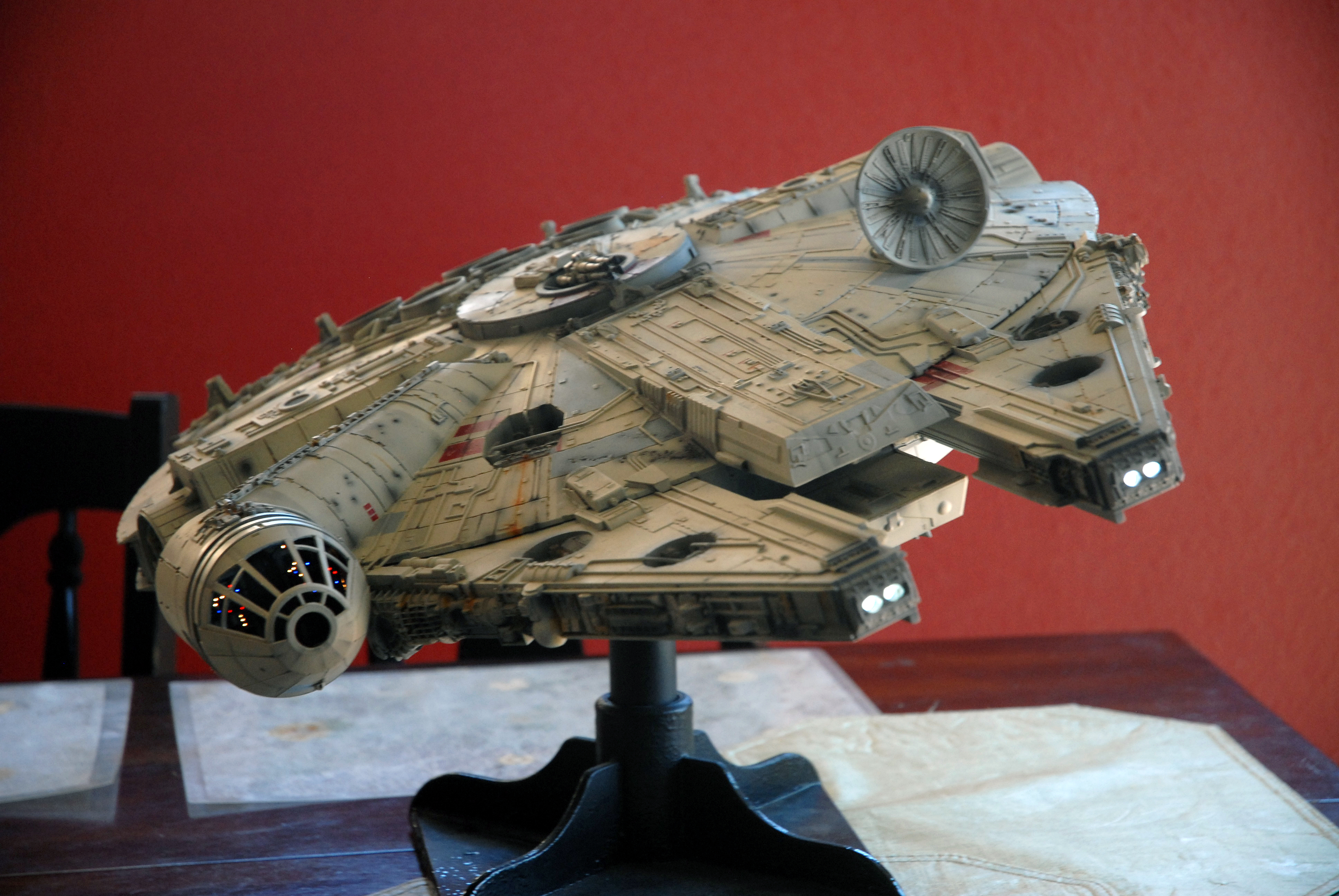

kokkari, your falcon looks awesome. What dimensions are you using for the sidewall thickness? 2.54cm?
If you plan on making new sidewalls from styrene they will need to be 1 inch (2.54cm) in height, which is studio scale. Don't be too concrened about cutting the mandibles down to a certain height as this won't matter because the new sidewalls will set them to the correct height anyway.

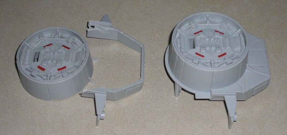

Naturally, by doing this means you'll eventually have to rework the docking rings. There's two ways you'll have to do this because the two docking rings are not the same. The best thing would be to get a hold of another port side docking ring then just trim down the height to match the new sidewall height. The other way is using the existing starboard side ring and cutting the entire ring off (see my photo below) and making a new rear wall to attach it to. The starboard ring also has part of the hull attached to it so don't throw it away and the ring will need a small amount of tidying up because of the mismatch in height due to the way Hasbro designed the boarding ramp.
The sidewall height on the studio scale is 1 inch. Mine turned out more like 1 1/8 inches so I could reuse some of the existing sidewall pieces.
Hahaha. Junk pilot posted the same response the exact same time. He is right on with what he describing. I did the second method for the docking rings which he spoke of which is a bit more complicated in my opinion.
