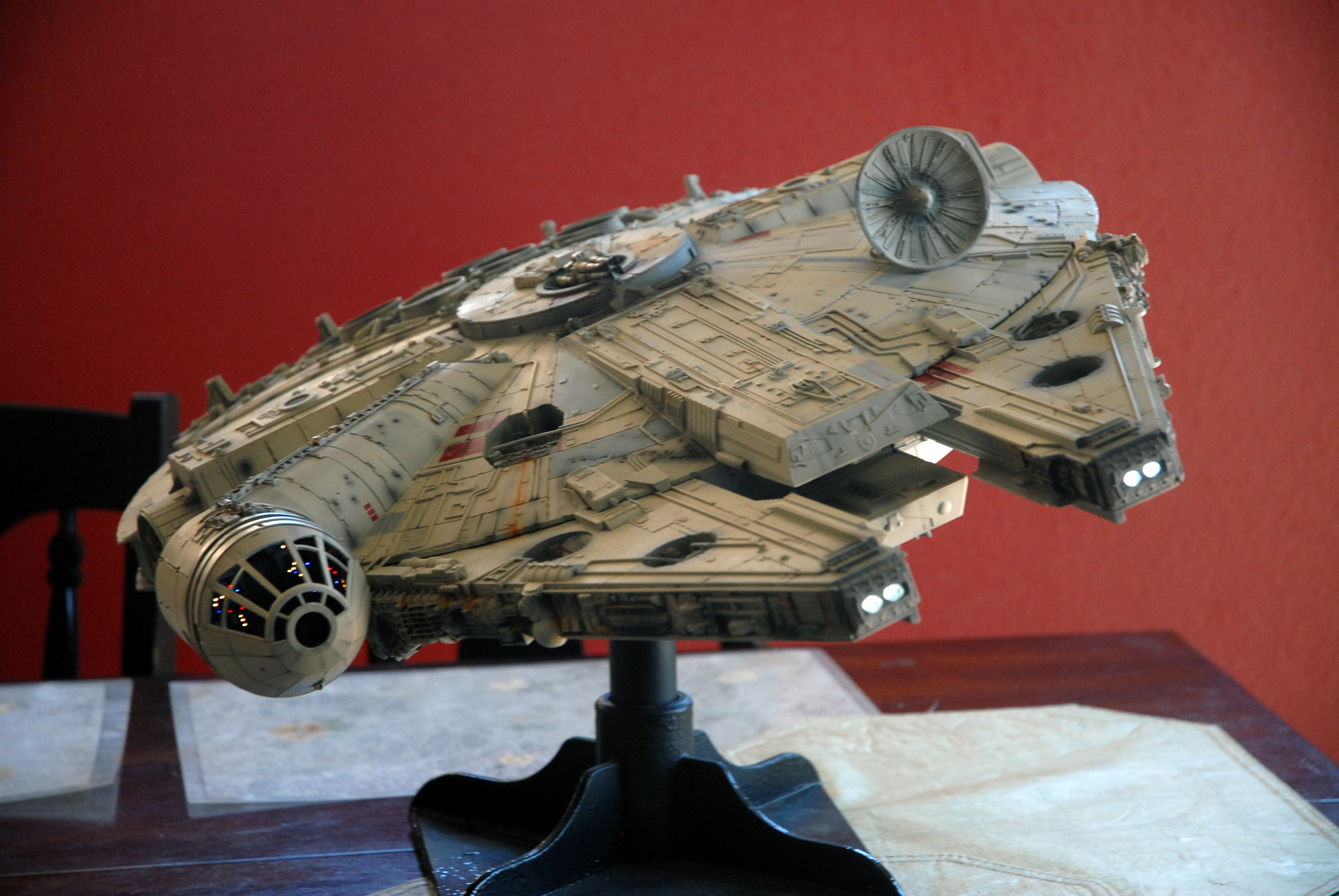

What have you done exactly with the legacy MF? Because this looks VERY COOL! :)
kuzushi, I agree with junk pilot. The sidewall height is a must. I did this project once before and did not change the height and regretted it and subsequently sold it. My latest build I lowered the height and it makes a world of difference. I reused a lot of the side wall pieces and cast some, such as the transmission parts, because the originals off the toy are either much too big or non existent ie the cockpit side. I was able to turn my mandibles in a little, but was a struggle due to the jaw boxes. I would say reducing the turret window is a must also. When you reduce the sidewalls it is a little tricky to do the docking hatch on the cockpit side. I did keep some of the original sounds of the toy (the ones i liked), but then wired engine, cockpit, and head lights separately to their own power source which I keep in the escape pod hatch. Mine is almost done. I just need to finish the cockpit interior which I've been struggling for motivation.
I still have it sitting front and center in my room with all my other collectibles. Depending on how the conversion turns out with the new Millennium Falcon that comes out in October, I may sell it because I only have so much room.

I like the look of your B-Wing. I wish there were more conversions of this ship.
Thanks! This one was fun, completely broke it down, wired it and hid the power jack so it likes like it belongs to the ship. then i built out the cockpit with 28 separate pieces, some metal, ceramic and glass.
It was more of a lark, I mostly do scratchbuilt stuff of all kinds.
