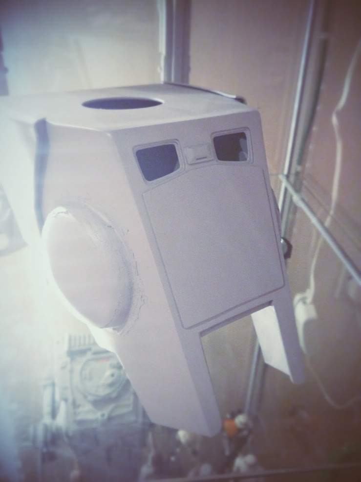

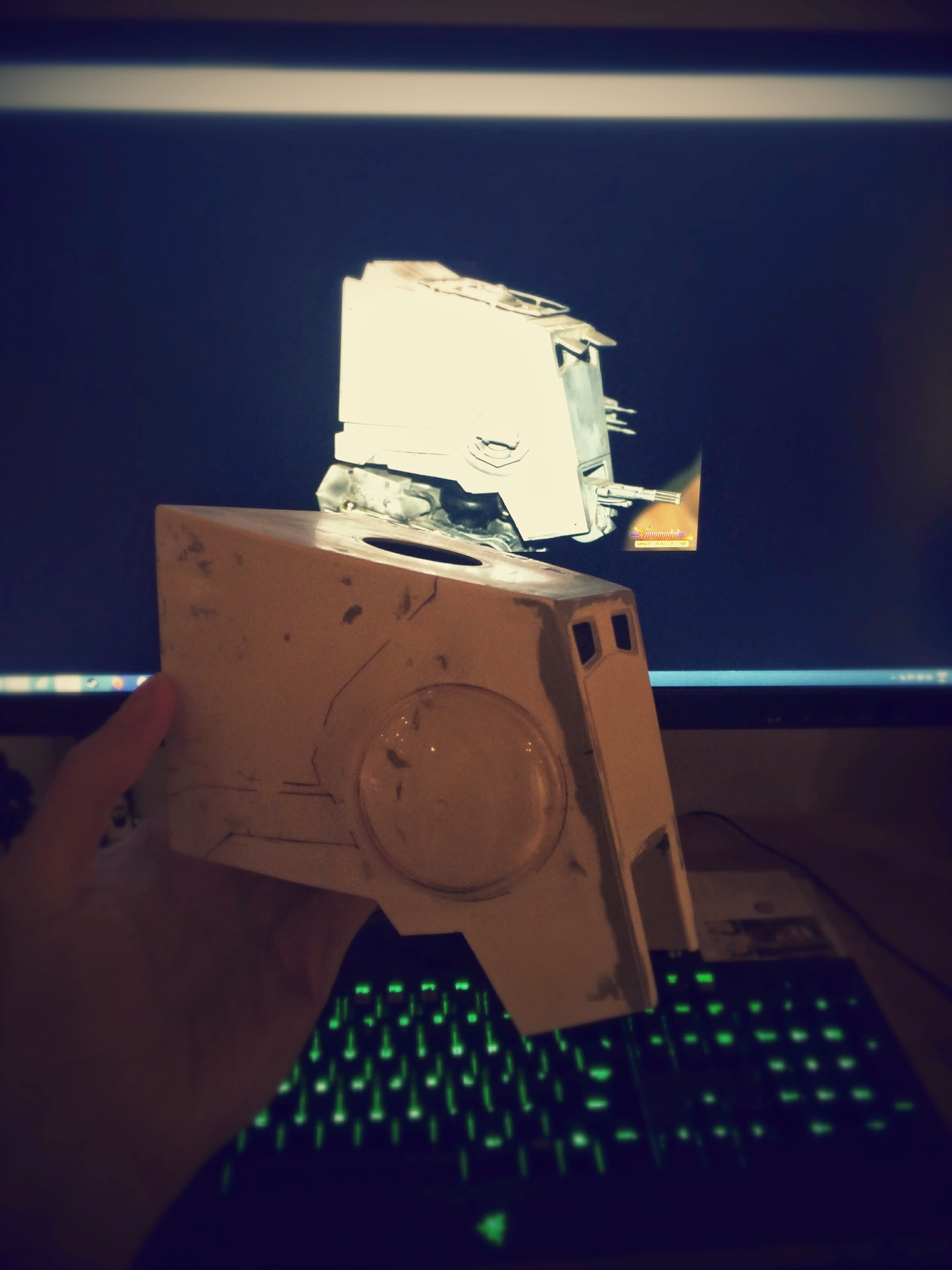

Not made a lot of notable progress on my new head. It took a lot of pain and stress to do the bottom of the head, I've added the gun mounts on and made some armour templates for the head that aren't on yet.
I'm really happy with it looking almost identical to the picture though. :)

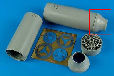

is it this bit I've marked in red? If it is, I can get this without buying the entire kit! :)
Yes you can go with an aftermarket part if you are not too picky regarding the accuracy, it's mostly hidden so not a big deal !
This is not the right part, in your pic this is the closed exhaust, Tamiya also provides an opened version if I'm correct but it's been so long that I could be wrong.

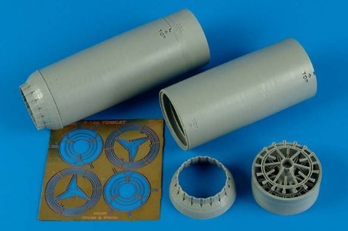

This then? :) $_12.JPG

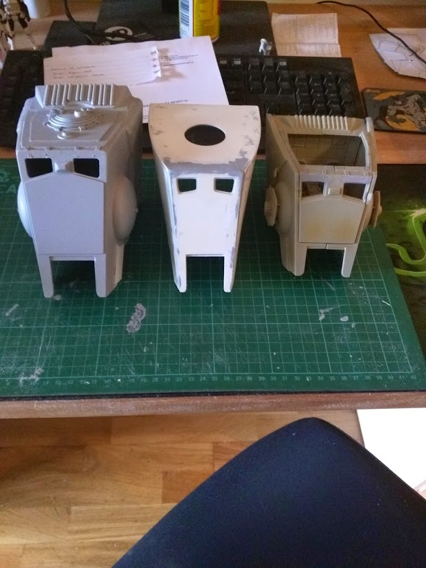

I added my first kit part last night, between the eyes. That, was a good feeling!
Ignore the putty on the dishes, I've sanded that down since. Also I noticed taking this picture I have a bit of a bend in my right side armour panel which I will need to fix!
Update: I've managed to get a hold of the correct dishes for the side gun mounts, so it's going to be a painful evening taking the ones I put on off and sanding it all down. :(

I've successfully taken off the side dishes and sanded it all down, just have to wait for the correct ones to be delivered now!
