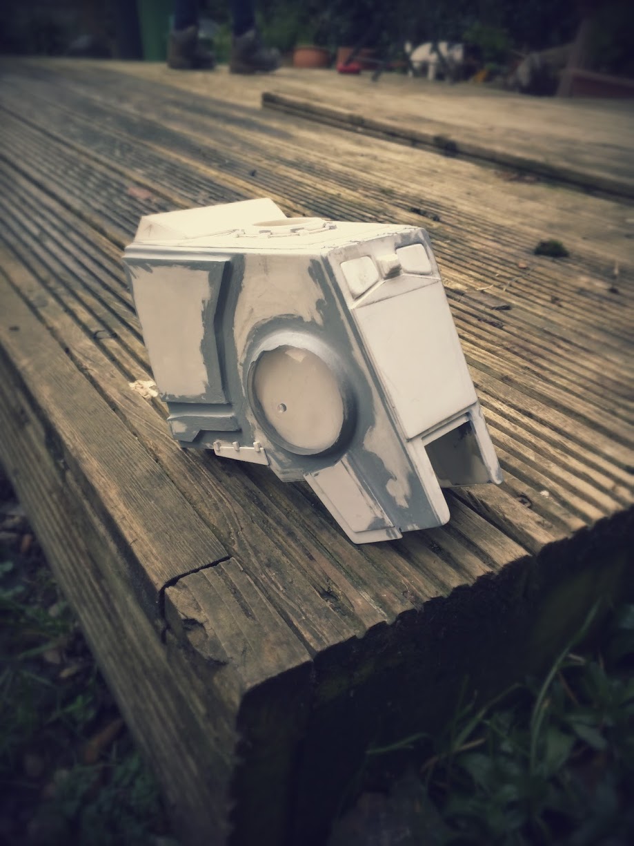

I think I need to redo the mounts for the side armor... :(
I think this is a close enough resemblance to the neck..for now...

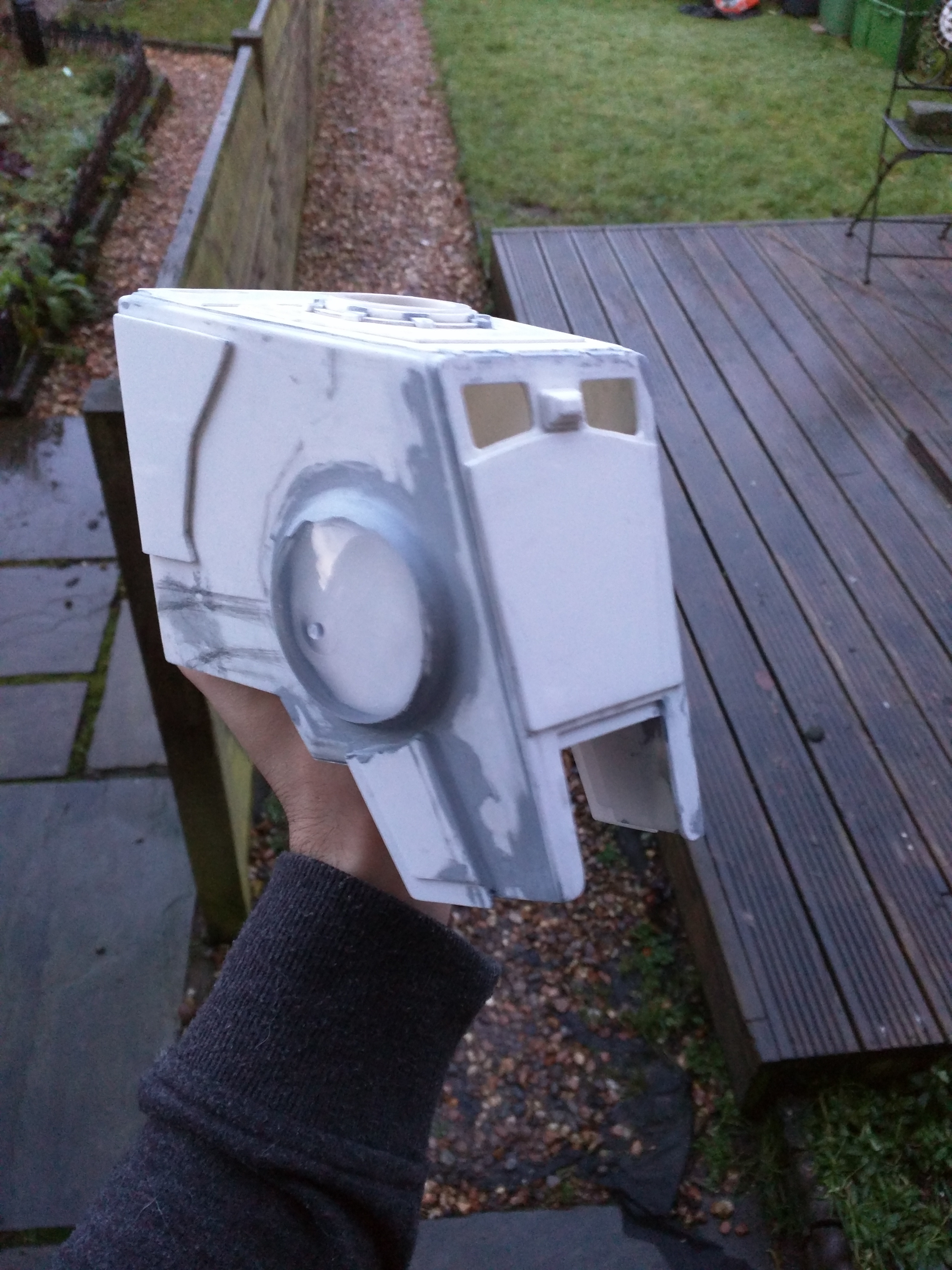

My understanding is the side mount domes are Plastruct VH-200 domes although there are more knowledgeable people out there who would know for certain.
OK so last night I adjusted the eye angles and size... I've also added the side plating at the front part under the domes, needs sanding. Does anyone have any suggestions on how I can do the eye lips? There's 2/3 layers within the eyes, I haven't worked out how to do that yet. :S

The supports for your side armor panels are too short. They should be almost as long as the armor panels less 3 or 4 mm.
Regarding the eye lips, just stack two styrene plates with été cutout, the lower being smaller than the top one and the top one smaller than the eye openings of your head. Glue that on the back of your head, that's what I did on my ATST and that's probably what they did for the master pattern of the original filming miniature. It works only if you use styrene thin enough for the front part.
If you have a CNC or a manual mill you can also mill it in a thicker piece of styrene instead of stacking 2 pieces.
