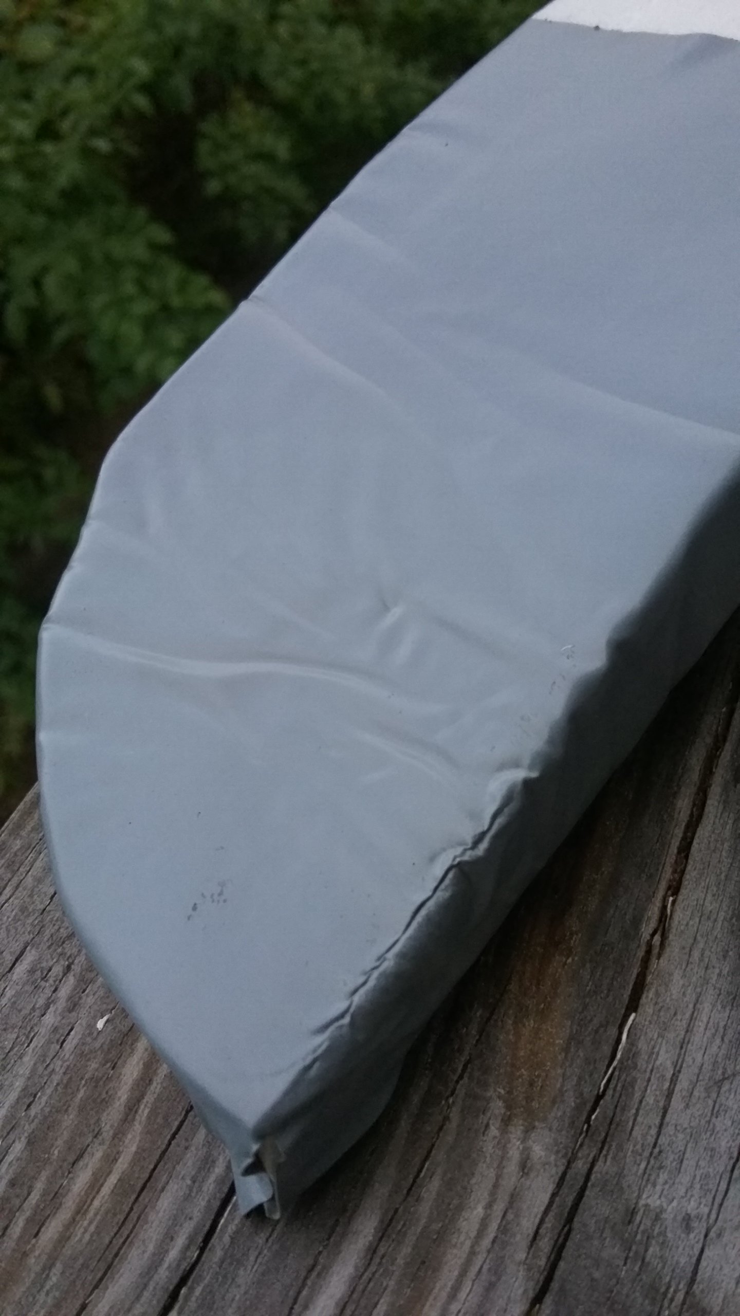

I then used my heat gun to see its effect on the vinyl. Would it be able to shrink the vinyl I'd wrapped around that curved portion so make a nice smooth edge without many cuts?
Apparently not!
Also, rather than the heat gun making the vinyl super smooth and tight as a drum, it seems that the middle only ended up more wrinkled. But the corners became sharper, so it seems careful application of heat is required for the best results.
Now for the flex test. Would the vinyl pull away from the foam? Would it wrinkle or remain wrinkle free?
Ugh! This stuff isn't resilient against wrinkles at all!
I should note however that it is resilient to glue. I got some glue and newspaper on the front of it and I was able to scrape it off with my fingernail without much effect on the vinyl. So it has that going for it.
Okay, so it wrinkles. That's not good. I mean the armor is likely going to get folded and bent at some point, just putting it in the car, or sitting down. It would be nice if it didn't get tons of creases.
But as one final test I decided to hit it with the heat gun again:
Hey, not too shabby! And I just smoothed that out with my fingers.
Let's try creasing it again, but this time I'll smooth it out with a credit card...
Hmn... Well it still creases terribly when bending it 180 degrees, but it is certainly possible to repair the creases with the heat gun and some effort.
