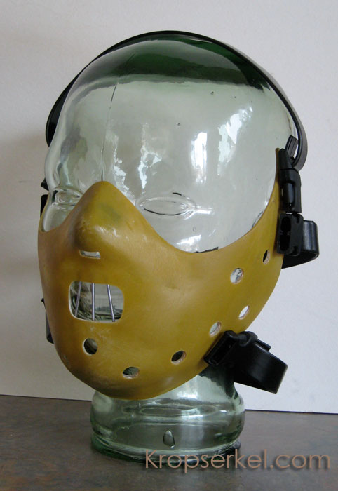

Here's the Kropserkel version:
The mask is pretty accurate, but it needs weathering and although this is the closest to the real strapping system that anyone has done (so far), it's still not right.
Funnily enough, I just purchased a Kropserkel Lecter mask from eBay yesterday (it was a BARGAIN price, so I don't think the seller really knew what they had). When it arrives I will be weathering it and added new, accurate straps so that an ACCURATE replica will finally exist.

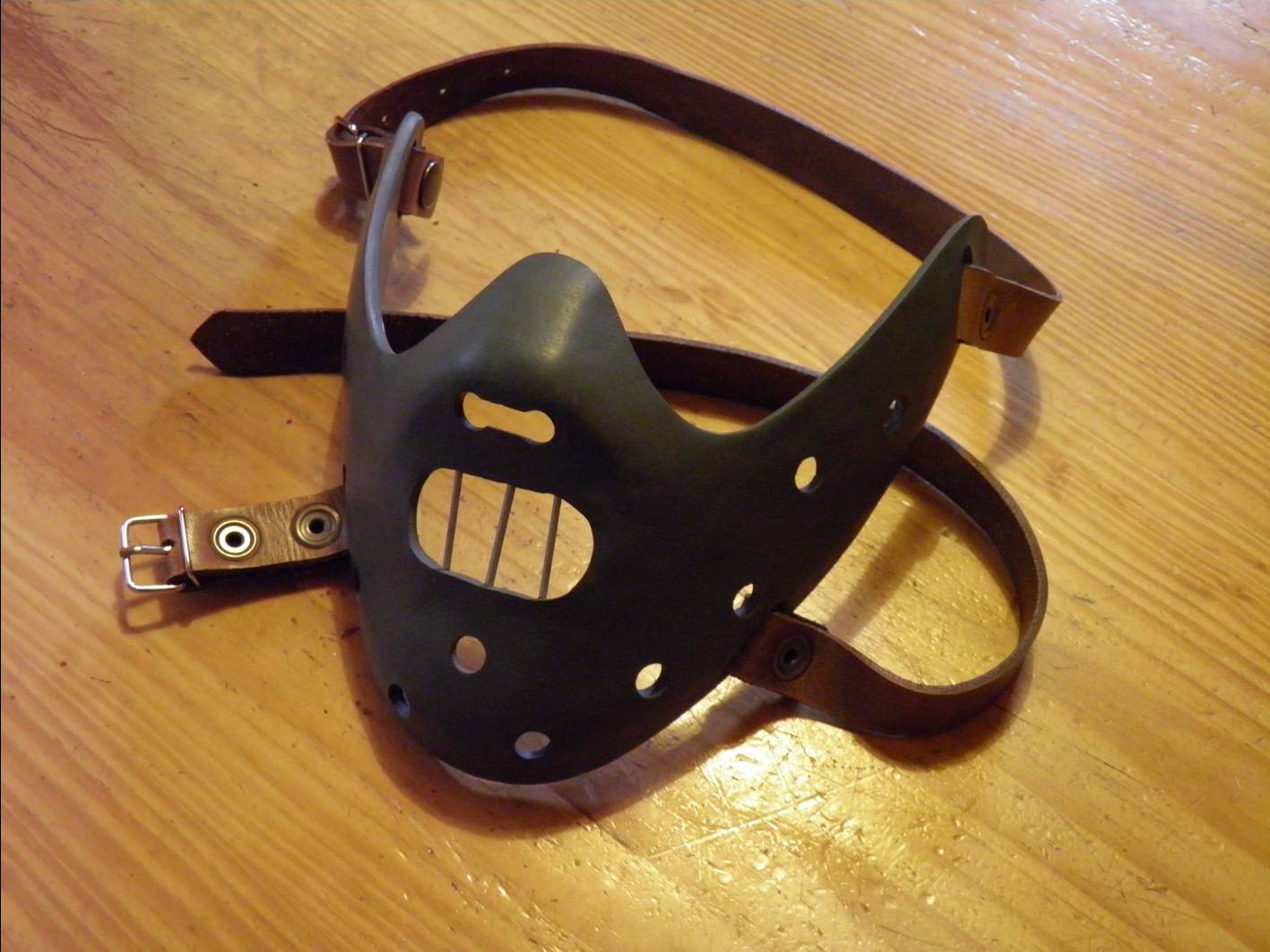

You could try the upgradde yourself (it's not that hard). Paint it the right color, fill the "extra" air holes, re-shape the nose holes with a dremel if necessary, correct the angle of the mouth bars and get the leather straps
Here's a pic of the upgrade I did on mine (before the mouth bars were corrected to the right angle as pointed out at the time by Howlrunner)

Out of curiosity did you use milliput to fill where needed? You did an awesome job btw.
Yeah, it would have been Milliput I used. :thumbsup

I can't/won't write a MEGA detailed approach as you can work out most of this stuff yourself as you go along, but....
1) Fill the two "extra" holes and too-wide nose slit with Milliput (all the instructions you need for this are on the packet). Sand when dry.
2) Use needle files and a drill or dremel to put the correct size nose slit and nostril holes in.
3) Use a dremel to sand/grind down the glue on the inside of the mask used to hold the bars in place until you can remove them.
4) Glue them back in at the correct angles using 2-part epoxy resin.
5) Paint using models paints (Humbrol enamels, Revell or Citadel acrylics are good) - brown base with green wash (which shades up up to you to match reference pictures).
6) Buy leather buckles/straps from Fiberglassmasks.com, thread through slits and pop-rivet.

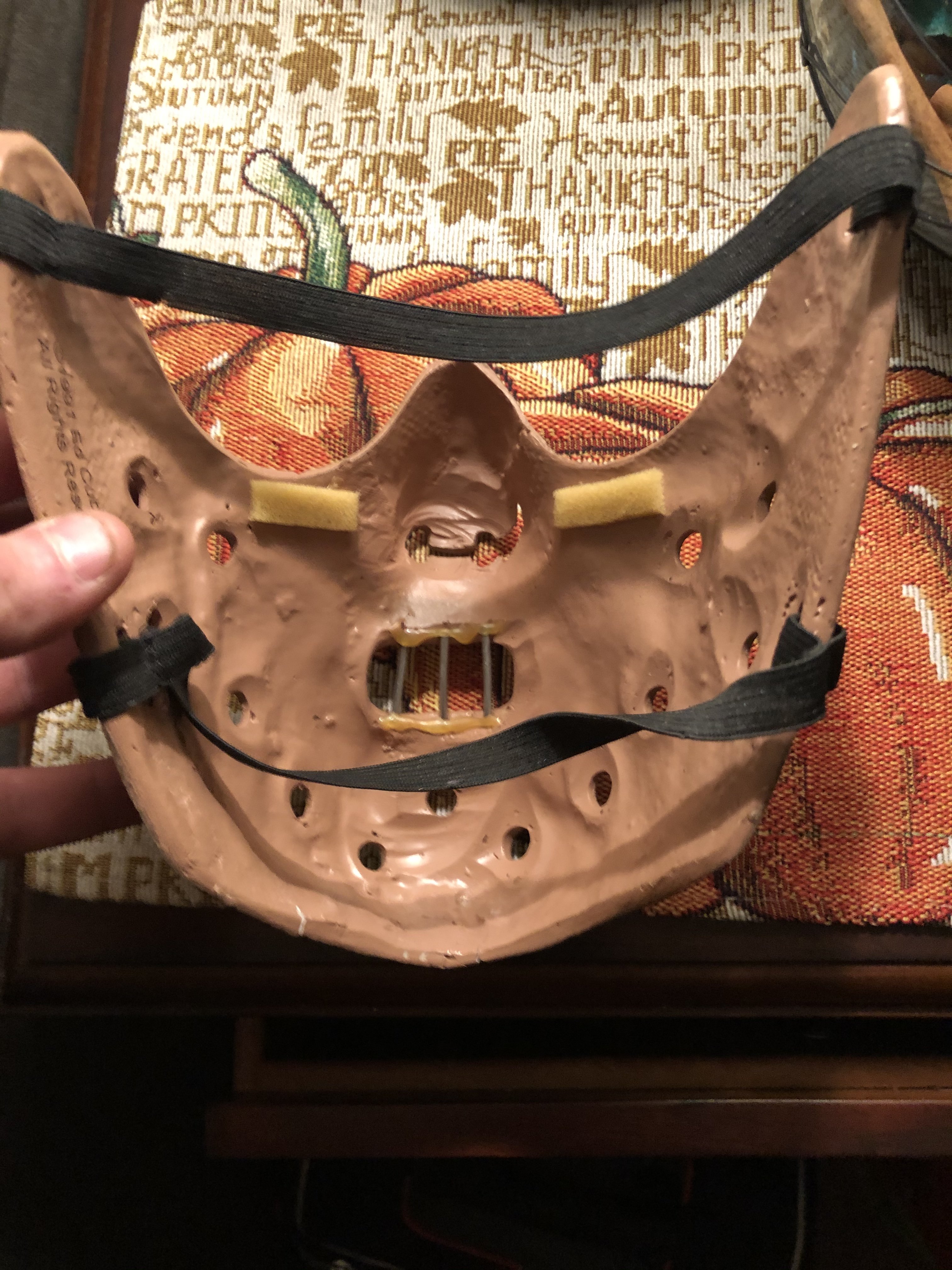

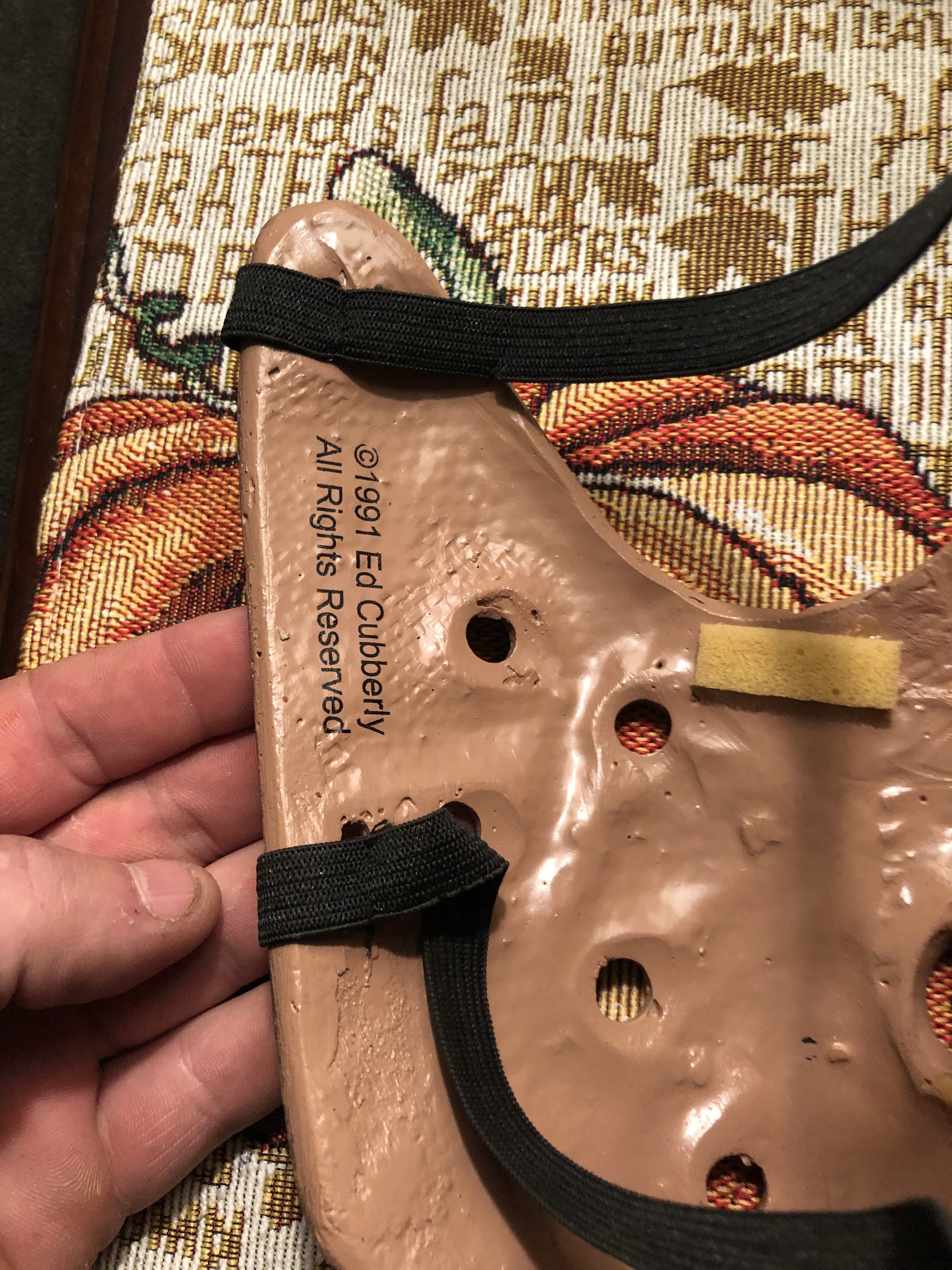

I'm a huge fan of Silence of the Lambs, and I'm trying to replicate the iconic Silence of the Lambs mask he wears in a prison transfer. Here is what it looks
Any information on this mask by Ed Cubberly 1991
