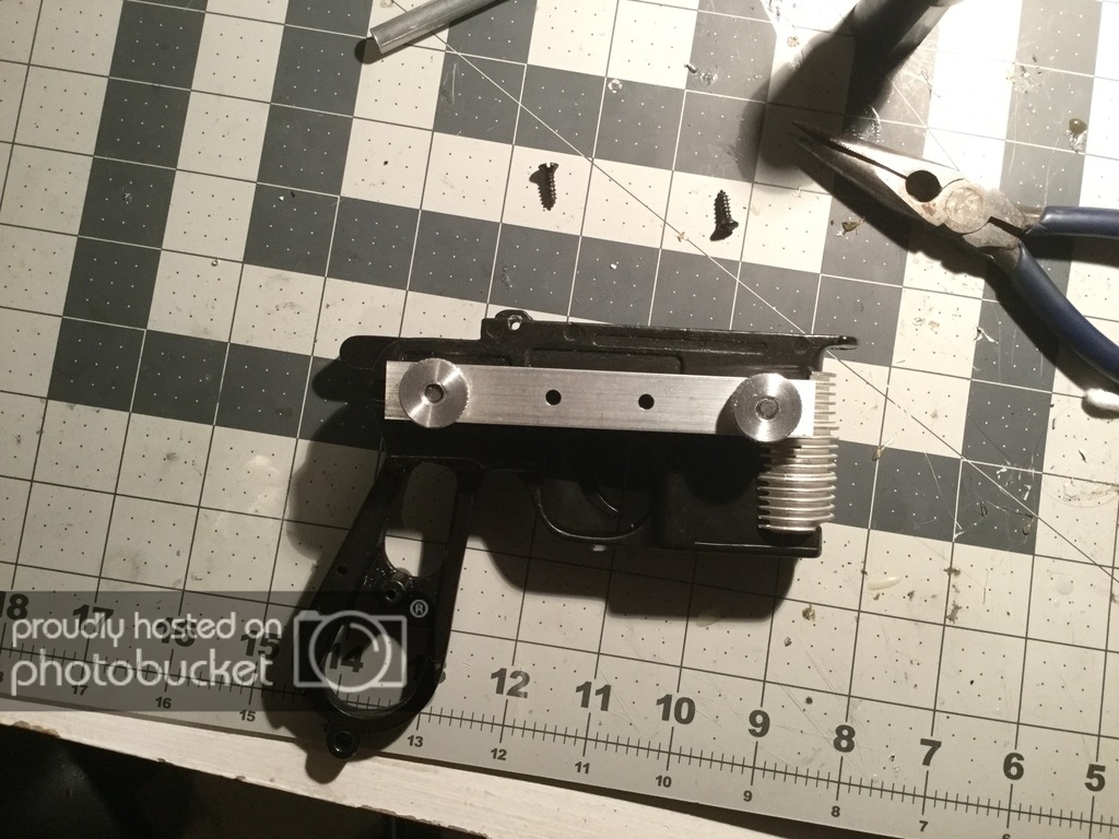

This reveal has been a long time coming but is finally here! Like last time, the assembly of the blaster was based upon the designs of Scottjua. In fact it is thanks to Scott that I got the parts I needed!
Specs
Denix base with real wooden grips
Dark Energy Creations aluminum/pewter cast blaster kit
Todd's steel flash hider
Plecter Labs Blaster Core v3
Superflux barrel LED
Premium speaker
The ANH DL-44 definitely requires a lot more machining work than an ESB style but the end results are more than worth it! DEC did a fantastic job on their kit and it turns the Denix into something completely new. All bare metal parts were painted black with the exeption of the bull barrel and the knobs which were blued with Birchwood Casey aluminum black. I even took the time to drill through the barrel and add lights!

Can i pick your brain and ask what paint you used? Anything special or just a matte black? I can't decide if I want to strip everything and blue it all or just paint.
that came out real great! what did you use to grid down the barrel? the grips look sweet!
The build looks great! I'm getting my parts together to do a similar build.
Yup just a simple matte black. I'm in love with the results. I did take the time to blue the bull barrel though. Word of warning, bluing these takes A LOT of time. If you decide to to that for any part, take your time.
Small hand files, typically used by a jeweler. I actually got them at a Michael's craft store and they have now become a great investment for my work station!
The grips are indeed sweet! They aren't even the DEC ones. Those are stock Denix grips.
