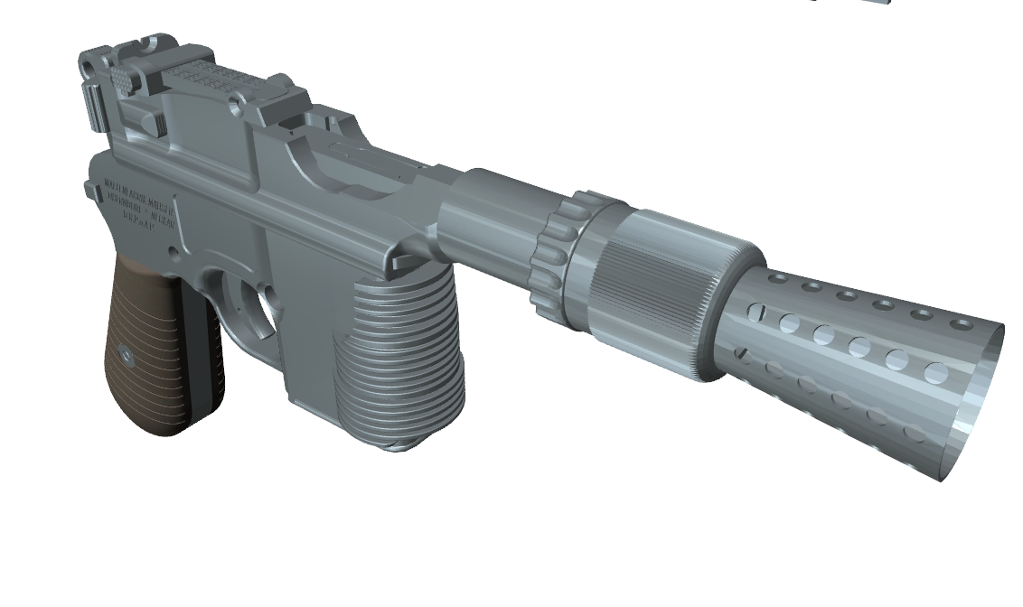

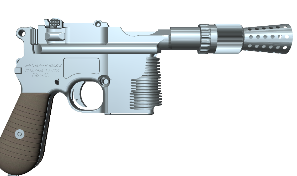

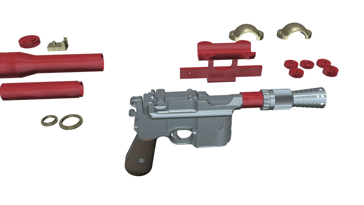

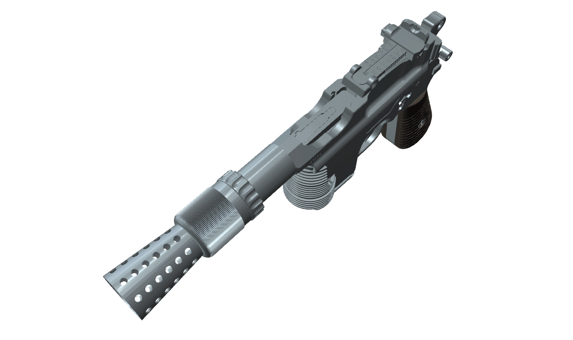

Thanks so much for this! This is outstanding work. I wish I have the funds to make one so I need to resort to 3D renderings and 3D prints :(
Was wondering if I can get some measurements. I'm trying to create a 3D CAD version of this as accurate as I can get it. Here are few pics of what's been done so far but need the dimensions for the parts that are colored in red.
FYI I'm still in the process of modifying the body & grip indentations and markings and other details to match.

It is the wrong type of Mauser for the OT DL-44s. Look at the C96 model.
and kpax, this is fantastic. Love how it was an MGC. It is really a very close replica with the different trigger and hammer. Where do you find mauser parts like this? I've actually only ever seen a real Mauser in a museum.. lol
As Mortifactor said, you have modeled a 712 Mauser like the one used in TFA. I don't have the dims offhand but many are available in the http://www.therpf.com/showthread.php?t=118186 thread.
http://www.therpf.com/showthread.php?t=250942
Looks like you are off to a great start!

Thanks!
All the MGC parts were modified with a file and Dremel grinder. The hammer is a replica of a real Mauser hammer that I molded in Zamac (the same metal as the frame) I needed to modify the lock work and add the serial number.
The trigger is the MGC that I reshaped and bent to match the Mauser. I also recut and modified the rear sight notches and numerals as well as the button release knurls and bolt grooves to accurate number of grooves and pattern.
