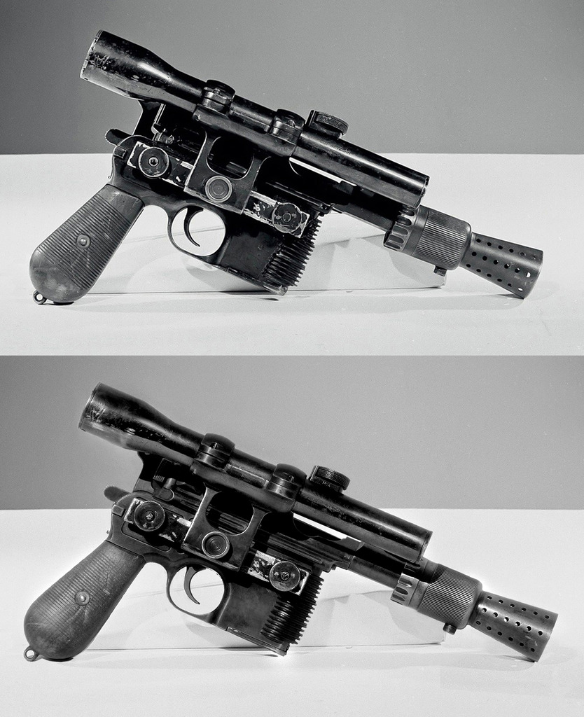

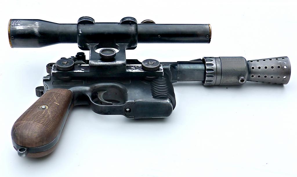

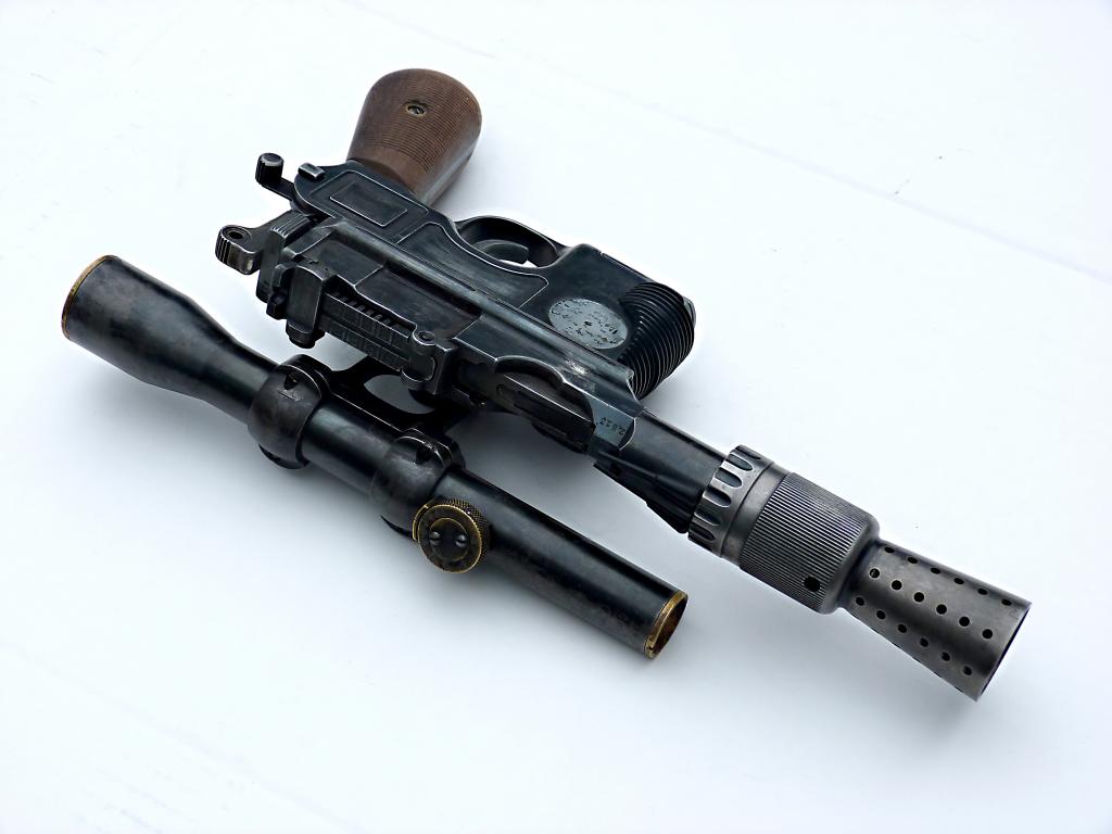

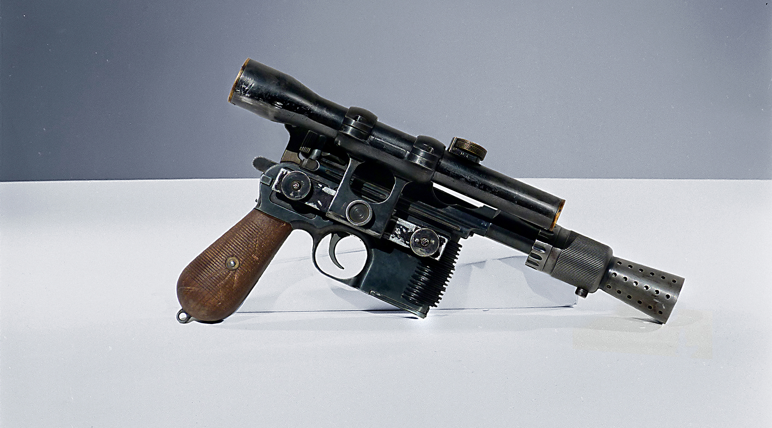

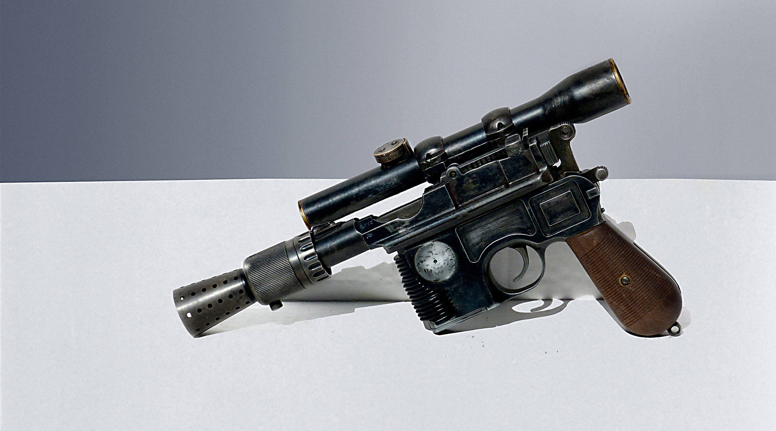

    Hello all Star Wars and Han Solo blaster lovers...
    I have been asked to post links and images of my Han Solo replica Blaster build made from DEC (Dark Energy Creations) and MGC c-96 Mauser parts in case anyone wanted to use them for reference material.
    The project was started in January 2011 with RPF member Deadbolt. We set out to find answers and details never before known about the original ANH Han Solo blaster prop and build an accurate kit for RPF members.
    The following images are the culmination of over 4 years of research and development by many RPF members ending with an ongoing discussion of over 3300 posts and 133 pages! THE SEARCH GOES ON !
    What we ended up with was a Hyper Accurate parts kit based on newly found greeblies original parts as well as endless 2d drawings and images from many RPF members and 3d model builds by Deadbolt.

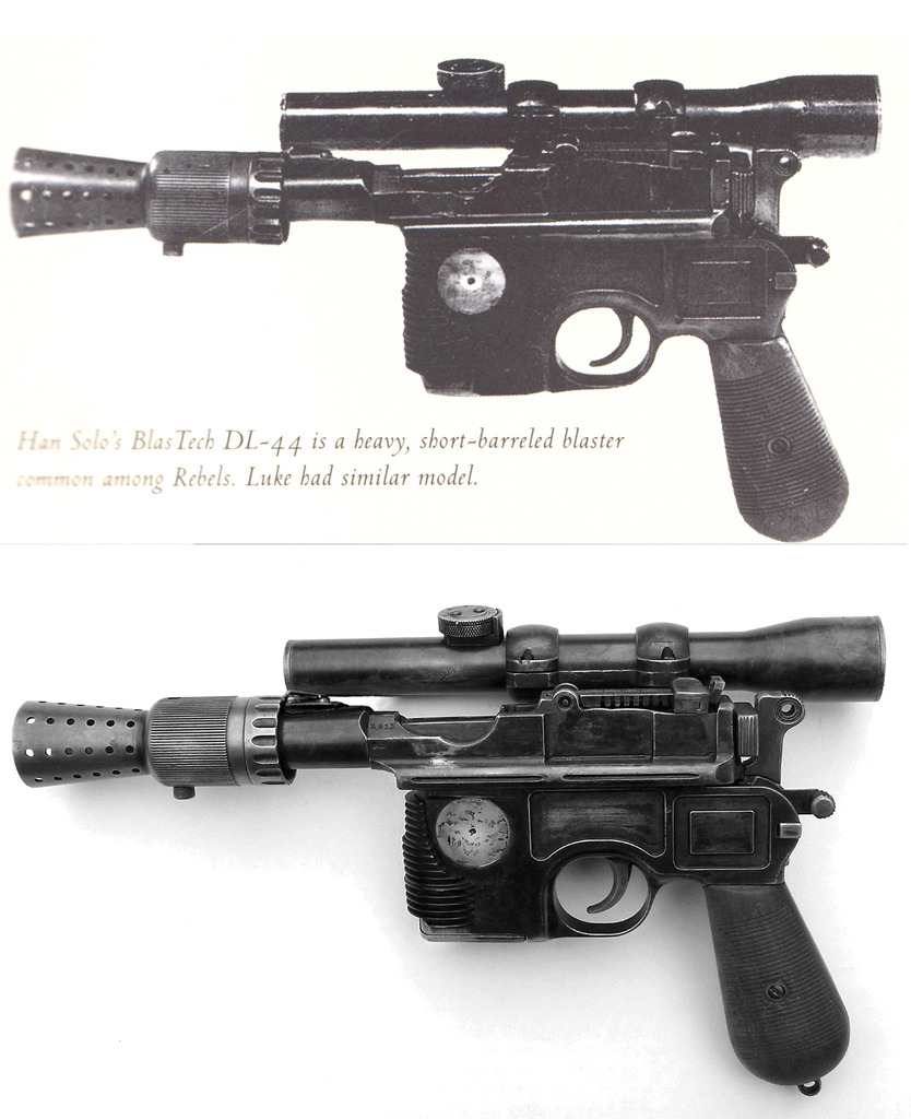

    There are comparison overlays which show, IMO, that the accompanying photos are as near an identical photographic match to the original prop as possible.
    I attempted to make my rendition of the prop a exact "duplicate" of the screen used A New Hope blaster prop as used by as Han Solo, so I decided to duplicate the final post production - last know images of the prop in the same condition as it was last held by Harrison Ford in 1976.* with every Mauser marking and proof mark, HW Scope markings, scratch, ding and surface detail blemish as seen in the available production images. Some of the work includes the asymmetric scope mount risers, Naked Runner Bull barrel latch and removable recoil buffer, Carson's Lump, Real c-96 hammer with correct serial # markings and corrected safety and much more.
    I include comparison images of the actual prop and of my replica as well as detail images in color to show what the actual real prop may have looked like in person...in 1976.
    Thanks for looking.
    KPAX...

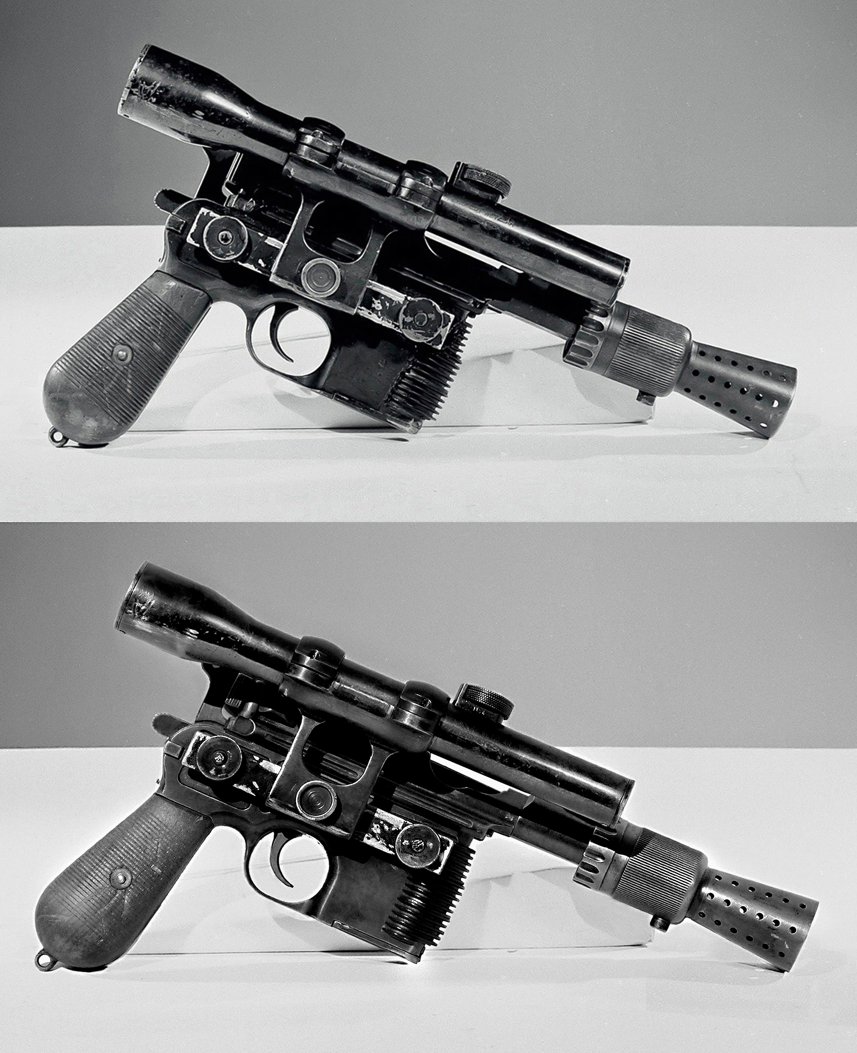

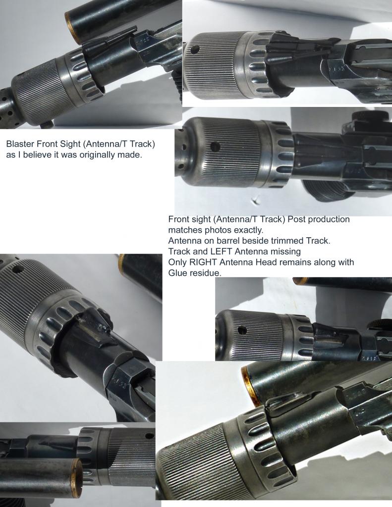

    REAL PROP AND REPRO IN B&W
    Dam you photobucket!
    B&W compare real HERO to Replica
    Full color side views of replica
    1- The Star Wars - Laser Gun - RIGHT - color-POST-enhanced.jpg 2 - The Star Wars - Laser Gun - LEFT - color - POST- enhanced.jpg

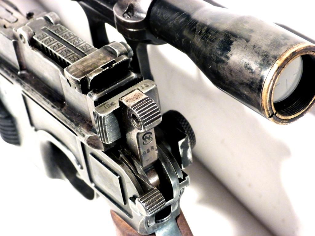

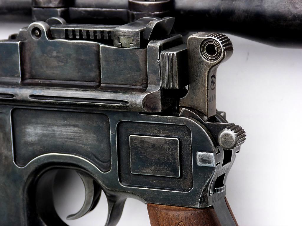

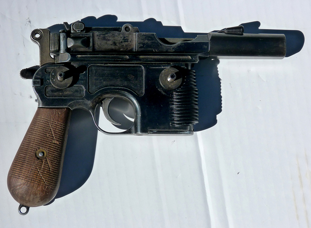

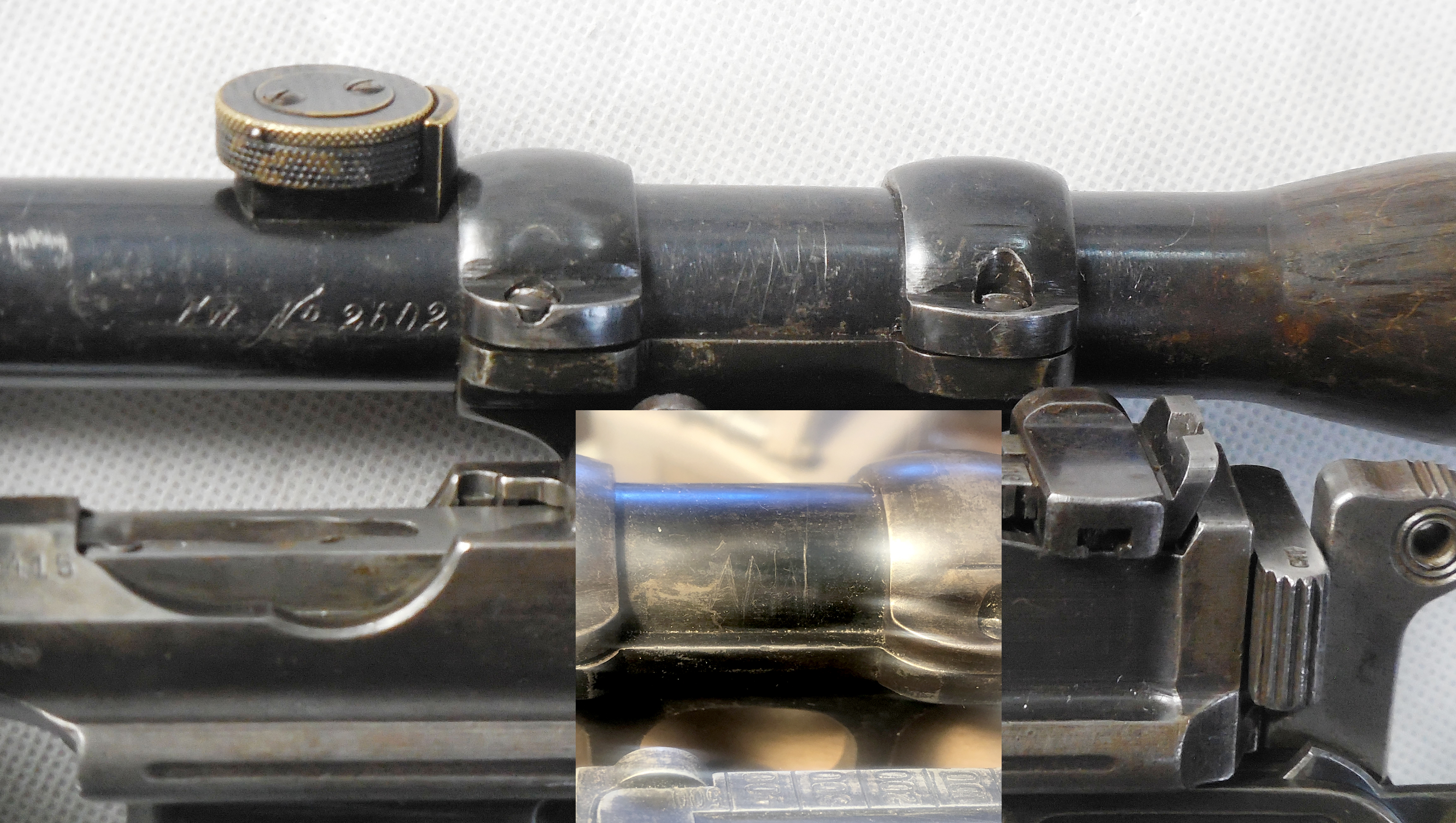

    Yes the lettering markings are there on the original prop and duplicated on my MGC as seen below. There are no other emblems on this version of the c-96 .The main marking are covered by the scope mount crossbar and the W and O can just be seen on the pre-production (unfinished ANH prop ) image below. FYI, the scope mount is reversed here as well. In as used form it is as my model. In these images you can see the scratches and markings better as well as the odd "Carson's Lump" which we assume is a welding fix at the rear of the receiver just in front of the charging bolt. I also re-cut the tang sight thumb knurl which you can see in the image below. Some details changed and were added in production due to damage most likely, such as the grip gouges seen in the Black and White post production images above.
    [​IMG]
    [​IMG]

    Hi kpax,

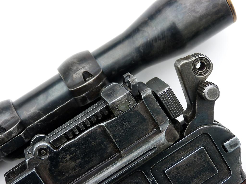

    first: Thank you very much for all the effort you put into the researches. You and the other members have done such an incredible job, that gives guys like me the opportunity to build our own blasters as accurate as we are able to do.
    And by looking at your blaster here, I still can't believe that this is actually based on a MGC C96! How did you achieved that perfect blueing look if I might ask? As far as I know the MGC C96 is made of aluminium alloy, right?
  16. kpax
    kpax Sr Member
    Trophy Points:
    1,505
    Thanks for the kind words !
    The MGC and Denix are made of Zamac...same as most die cast metal stuff.
    It is mostly Zinc and can be cold blued with standard gun bluing. There are many tips in the below thread and others as well.
    Just gotta clean it and follow the instructions for bluing metal. Several coats may be needed. I applied color and weathered it and applied several more times until I got the well worn look I wanted.
    I also did a lot of custom work to the frame for more accurate Mauser details including all the etched markings and correct serial number and real c96 hammer etc.
    http://www.therpf.com/showthread.php?t=118186
    There are parts available for the ANH and now the new TFA blaster kits if you are looking to build one...or two !
    http://www.therpf.com/showthread.php?t=250942
    http://www.therpf.com/showthread.php?t=220734
    Good luck !

  18. Sabs
    Sabs Member
    Trophy Points:
    112
  19. kpax
    kpax Sr Member
    Trophy Points:
    1,505
    Hey ! Thanks for looking so close !
    Actually mine does have the asymmetric scope angles and even the off center scope mount window...if you look close.
    But the reason the gap looks so much bigger on the real hero is that it is missing the rear tang sight release button !
    I was not entirely sure if it was actually missing from the HERO or just cut off in the photograph. The inner part is visible from the LEFT side so I left mine on.
    It is very difficult to match the angles and photographic look of the original without the correct equipment.
    Tried to get close but with digital cameras it's tough to duplicate the field of the original 50-55mm lens and 35mm film.
    At different distances the angles and forced perspective changes dramatically. I tried to match the angles as best I could but you really don't know how close you got until you see it on a monitor and compare.
    The lighting was also very difficult. I tried studio spot lights and reflectors but found natural sunlight worked best...of course I had to wait for the sun to be a approximately the same angle for the shadows to be close.
    Not perfect but close enough for me...for now... ; )

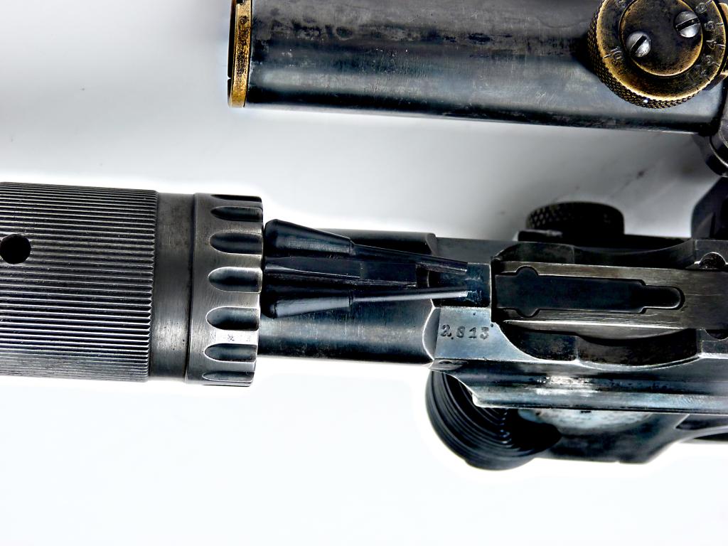

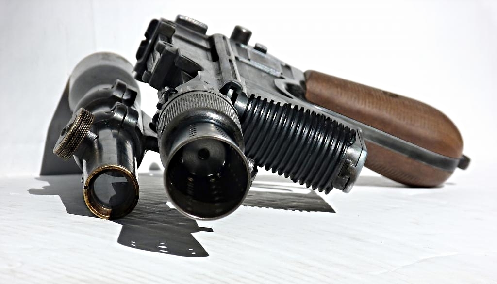

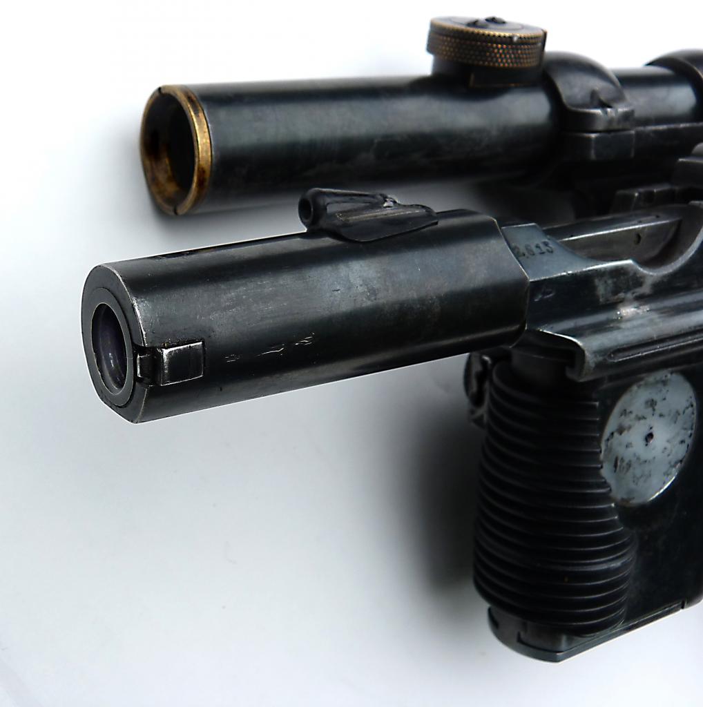

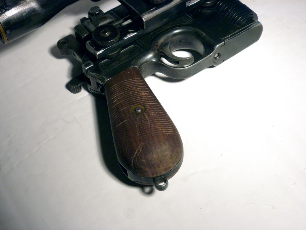

    This is the Naked Runner barrel detail with threaded barrel for the extended rifle barrel segments and release latch... and it works!
    ...and those scratches are accurate...
    [​IMG]
    thd9791 and veektohr like this.

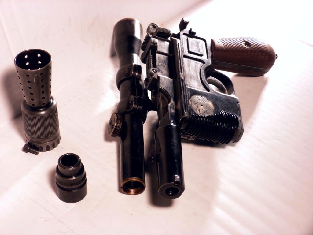

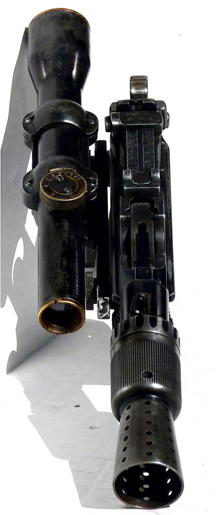

    This is the barrel attachment set up I used. I wanted to keep all the working function and look of the NR barrel and also replicate the look of the only front HERO pic that shows a small bullet muzzle hole...
    [​IMG]
    [​IMG]
    [​IMG]

    May I ask how you archieved this? Did you have it commissioned?
    What did you use for the knurled disk at the barrel tip/ inside the muzzle?

  30. kpax
    kpax Sr Member
    Trophy Points:
    1,505
    hey Markus, thanks.
    i did all the work myself. Resculpting the details of a real Mauser on the MGC frame. Had to change the knurled on the safety, bolt sight release. All hand filed. recut the sight notches and reshaped all the features to match.
    The knurl ed muzzle disk is really a threaded insert in the bullbarrel just like the real one must have had as a muzzle restrictor. There is an image of ford holding the blaster front view where you can see the small hole.
    I made it to actually hold the bull barrel in place so it can be removed if necessary and I didn't need to use the 3 set screws because I wanted to be able to show the naked runner barrel accurately.
    The markings were all etched as was the mystery disk. The mystery disk blotches are accurate as well and change appearance in different lighting like the real one. I imagine the actual marks are glue and missing bluing just like the front sight. Pretty sure the sight is as last seen on the hero. Matches images perfectly I think.
    thanks for looking!

    I just missed the addition of the Naked Runner barrel feature(s), esp. the small latch. mgoob planned to have such a barrel custom made, but never got around to do this afaik.
    I guess your base is Daves steel barrel from the first run, correct? What was involved to add the latch/ how did you get this to actually work?!
    Thx, Markus :)
  32. kpax
    kpax Sr Member
    Trophy Points:
    1,505
    Yes. Daves steel barrel. Cut a rectangular notch and drilled a hole lengthwise to insert a spring bar with machined latch lock.
    I made a threaded insert to simulate the rifle barrel threads and left a slight raised area as a gas seal.
    Ive seen some similar barrel locks and tried to match the lock as close as possible from the best images.
    Should be pretty close. There are actually scratches behind the latch lock tab that can be seen on some stills.
    I also cut a relief inside the booster to allow the latch to insert without forcing it. Just Compress the latch lock and fit the booster over top.

    As Mortifactor said, you have modeled a 712 Mauser like the one used in TFA. I don't have the dims offhand but many are available in the http://www.therpf.com/showthread.php?t=118186 thread.

    All the MGC parts were modified with a file and Dremel grinder. The hammer is a replica of a real Mauser hammer that I molded in Zamac (the same metal as the frame) I needed to modify the lock work and add the serial number.
    The trigger is the MGC that I reshaped and bent to match the Mauser. I also recut and modified the rear sight notches and numerals as well as the button release knurls and bolt grooves to accurate number of grooves and pattern.
    Thanks for the kind words!

    Really just 0000 steel wool, scotchbrite does the best. Just go slow. The wear should be in logical areas wear there would be rubbing contact with holster or would contact if you lay the gun down. The high spots.
    You can always add more bluing or paint if you go too far. Blue on -blue off. Several layers work best. If it's a realistic, used looking blaster, the more you beat it up the better.
    For the crossbar detail pattern, I think someone posted a printable pattern.
    In reality, the "damage" pattern is from removing the scope mount from the crossbar. As you slide the mount forward, the edges of the rear of the mount gouge the crossbar to create the long scratches. The center thumb screw causes the middle damage.
    For the live fire I'd look at Scottjua's builds. He's the live fire master. There are a few mods you may need to do to get it to cycle correctly.

    What mount do you have? I don't know what Todd's are like or made of. You should email Scott about the mounts and function. When full loaded with the parts, FH and bull barrel, the extra weight throws off the cycle and the mounts can break if you don't have a steel one.
  44. mptachenko
    mptachenko Active Member
    Trophy Points:
    312
    Todd's scope mount is all steel. Scott concurred that mount is one of the strongest out there. So far while waiting for the scope, I have run over 50 rounds through my gun with the bull barrel and flash hider mounted with no reliability issues. I went with DEC steel bull barrel and the aluminum flash hider. Here is a link to the thread I started if you are interested.

    The harmonic and balance change with the mount and scope one, and the recoil changes. It does effect cycling... or at least it has on a couple of the ones I've done.
