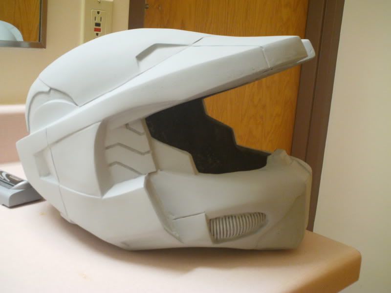

Got my sander in yesterday (fortunatly!) and picked up a needle filing set. Got to work cleaning up the small corners and such, and got rid of a few bubbles lingering around the casting. Along with that, cleaned up the seam line so now it's not noticable anymore. There's still alot more clean up to do, and some mods I'm still debating on whether or not to do. I got a coat of primer on it as well to see exactly what I need to fix.
Gonna need quite a bit of Green to White technology lol
-TC

Did a bit of work the past two days. Mostly just going around the helmet, grinding out bubbles that formed and "straighting" the detail lines. I also added a small detail to both sides of the helmet. This is gonna be based off the H3 Trailer Chief afterall
I'm also going to do another mod I was debating for awhile. This has to do with the vents. It's not that I didn't like the vents already casted on, its just not accurate to the H3 Trailer Chief, to which I already filled one side with 2 part epoxy, which I'm gonna clean up and add the detail lines as needed.

Nothing too big, but I went about smoothing up the filled vent area. I think it's gonna turn out better then expected. It looks alot better then it did earlier, but I'm still gonna need to add some more filler. Put some primer over it, as well as the details I added yesterday to show how it looks.
So yea. I'm out of filler and unfortunatly, they don't sell it on post. I have to wait till whenever I can leave to get some more :(
Other than that, I'm still debating how Im wanting to modify the lower chin detail as well...
