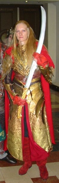

Unfortunately the costume I made for myself that I love the most did not end up having any high quality photos taken of it in full length. And there are some updated versions of the costume that didn't get any close up or decent photos of it at all. So, here are a few of the best ones I do have:
With the sword:
The above hip armor, like the chest armor and other pieces, was cardboard and clay. The below hip armor and shoulder bells were made out of craft foam... a brilliant idea from Gen/Penwiper, to whom I am eternally grateful for her creative ingenuity!!

Because of the clay it was also really heavy...
  • How much it cost - I have no idea. I didn't keep track, but probably over $300... more if you include having to redo pieces over the years.
  • Tips. - If you love something, don't hold yourself back from doing it just because it looks hard or out of your league. Go for it, even if it isn't perfect. ...And then take lots of pictures.

I put duct tape on the cardboard and it was an epoxy clay called Gapoxio that I used. Fix-it is similar and I have something that I'm using for another piece I'm making (I forget what it's called)
To answer your question, where it was thick, it lasted, where it was thin, it cracked. The trouble is, getting a big piece like the chest armor to be thick makes it SUPER heavy. And getting it to be evenly distributed is not easy.
I do not recommend this method for this piece if you can do vacuum form or are happy with the look of the craft foam.

Something I forgot to mention was - I couldn't sit down in the armor. So whenever I wore it, I had to stand the entire time, or lean on something. With all that weight it was dreadfully painful. Go light, if you can for armor!
Oh, and when I met a few of those who played elves at Helm's Deep, they said they couldn't sit down in the movie made costume either... they had to stay in it for much, much longer, but theirs was made out of lighter fiberglass.

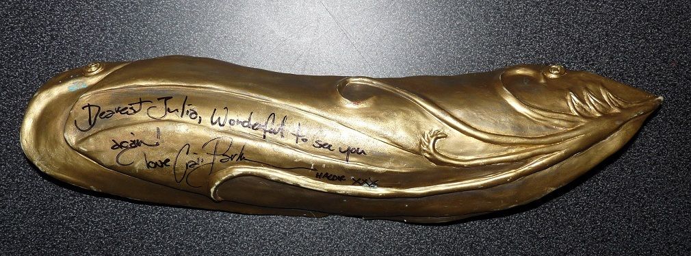

Also, I brought the last piece of the armor (the wrist guards are all that has survived) with me to Dcon and was able to ask Craig Parker to sign it! :D
I'm not that big into autographs, but this one means a lot... Now, I have to run into Daniel Falconer again and get him to sign the other one!!! That would be amazing.
