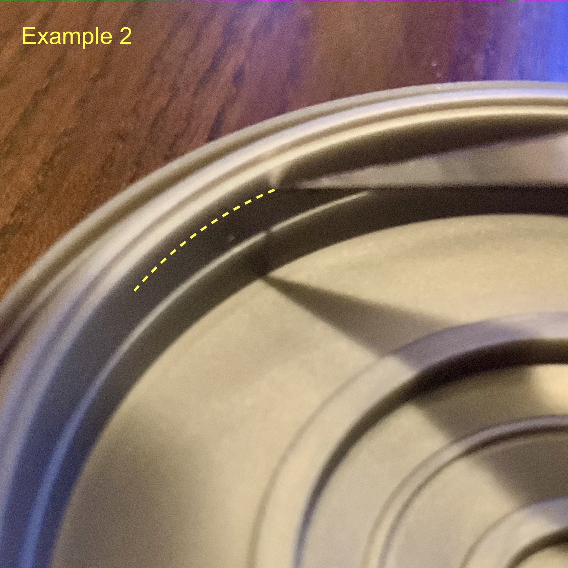

See to me that seems a bit weird because that means the glass lens will be underneath the lip which was originally intended to be a "shelf" for the plastic lens to sit on. To me it seems like example 1 would be the better way to do it.
Hmm
As someone who took a chance and did it, I recommend door #2 (though slightly lower). That will allow the dome of the glass, as it rises beyond the lens holder, to hide the cut, and to allow for some more material to press the glass into. I’d say more like half-way down into the “velodrome” rather than only 1/3.
I was a bit stressed about messing it up, but figured worst case would be I’d have to buy another kit.

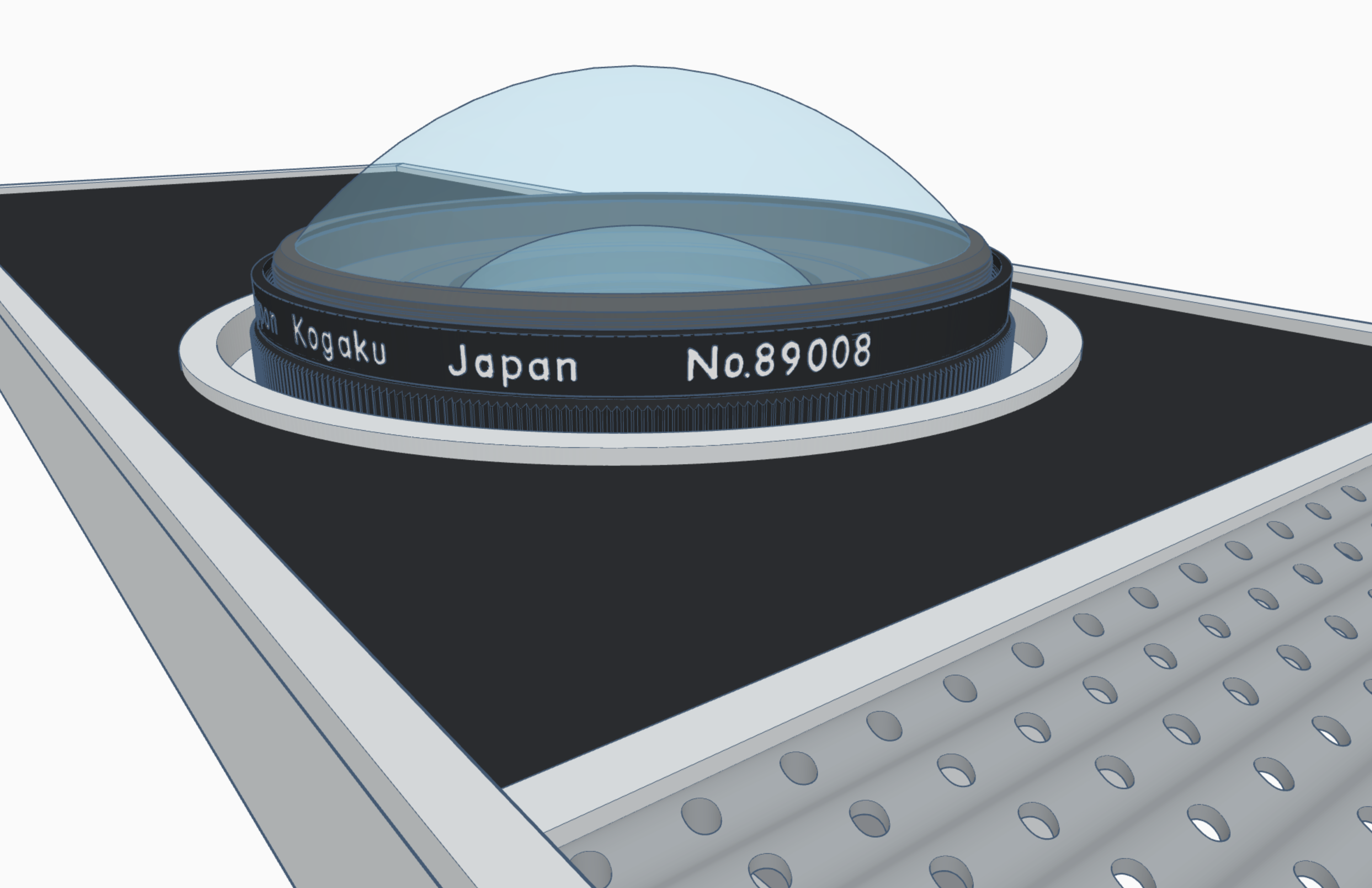

Question of opinion: one of the errors in the Moebius HAL faceplate design is that the bottom of the aluminium ring isn't low enough. The only way to fix this is to make the hole in the black plate bigger - to about 95mm from 80mm or so. How many people are willing to do that?
Right now I've been working on both a drop-in design with various compromises, and a "needs a bigger hole" design that will require more work.
Planning on making my own faceplate anyway, so I'd definitely be in "needs a bigger hole" camp if it means better accuracy.

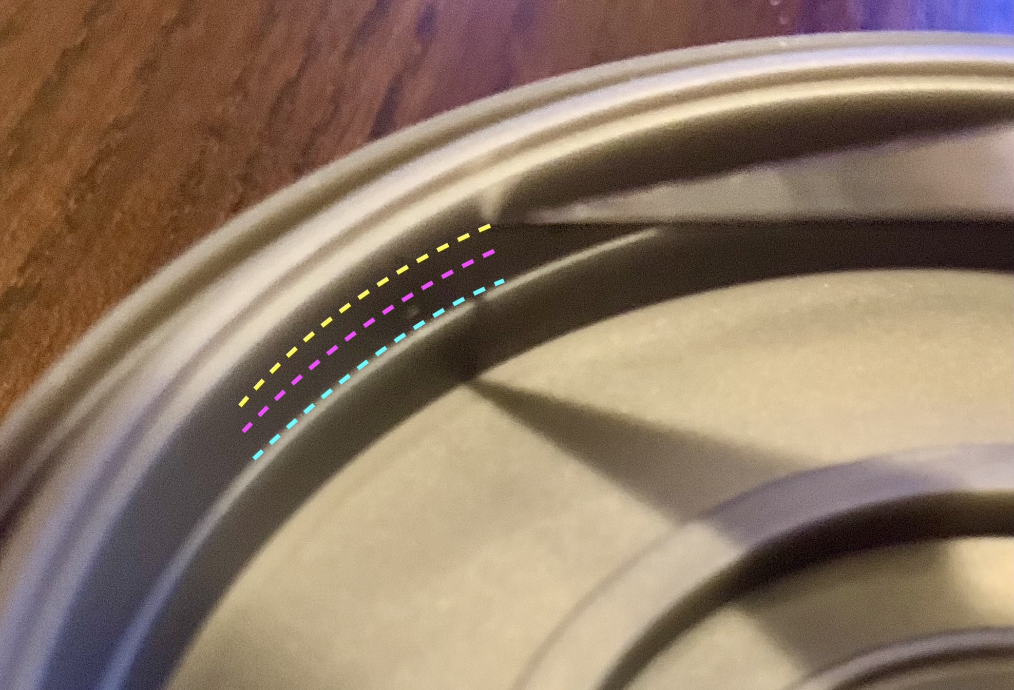

So like the pink here? Or the cyan?
Myself I'm hoping to cut out and replace the existing faceplate with either a brushed aluminum sheet or a sheet of vinyl wrapped styrene.
Either route I will need a hole created from scratch since they don't have one to begin with.
