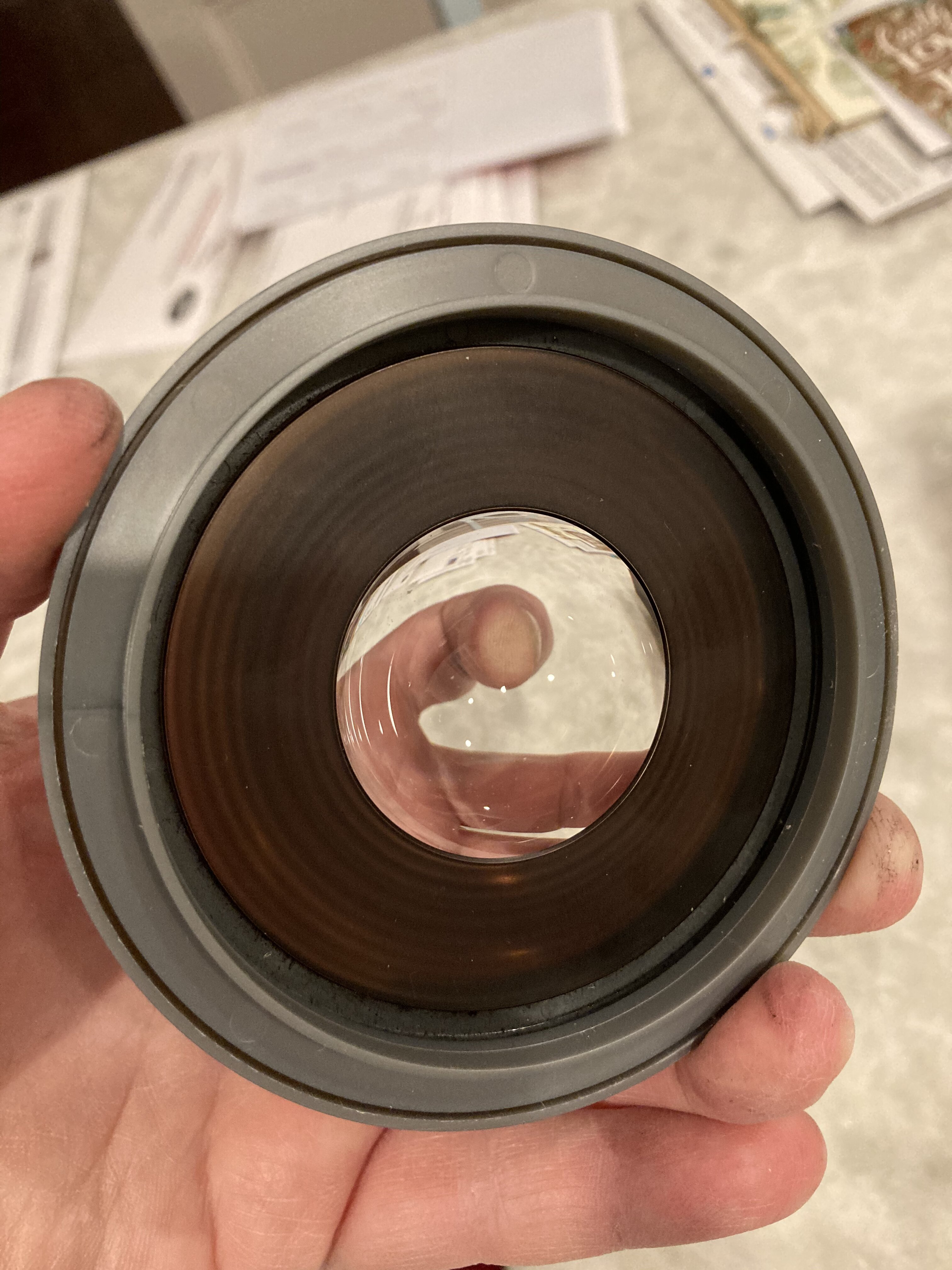

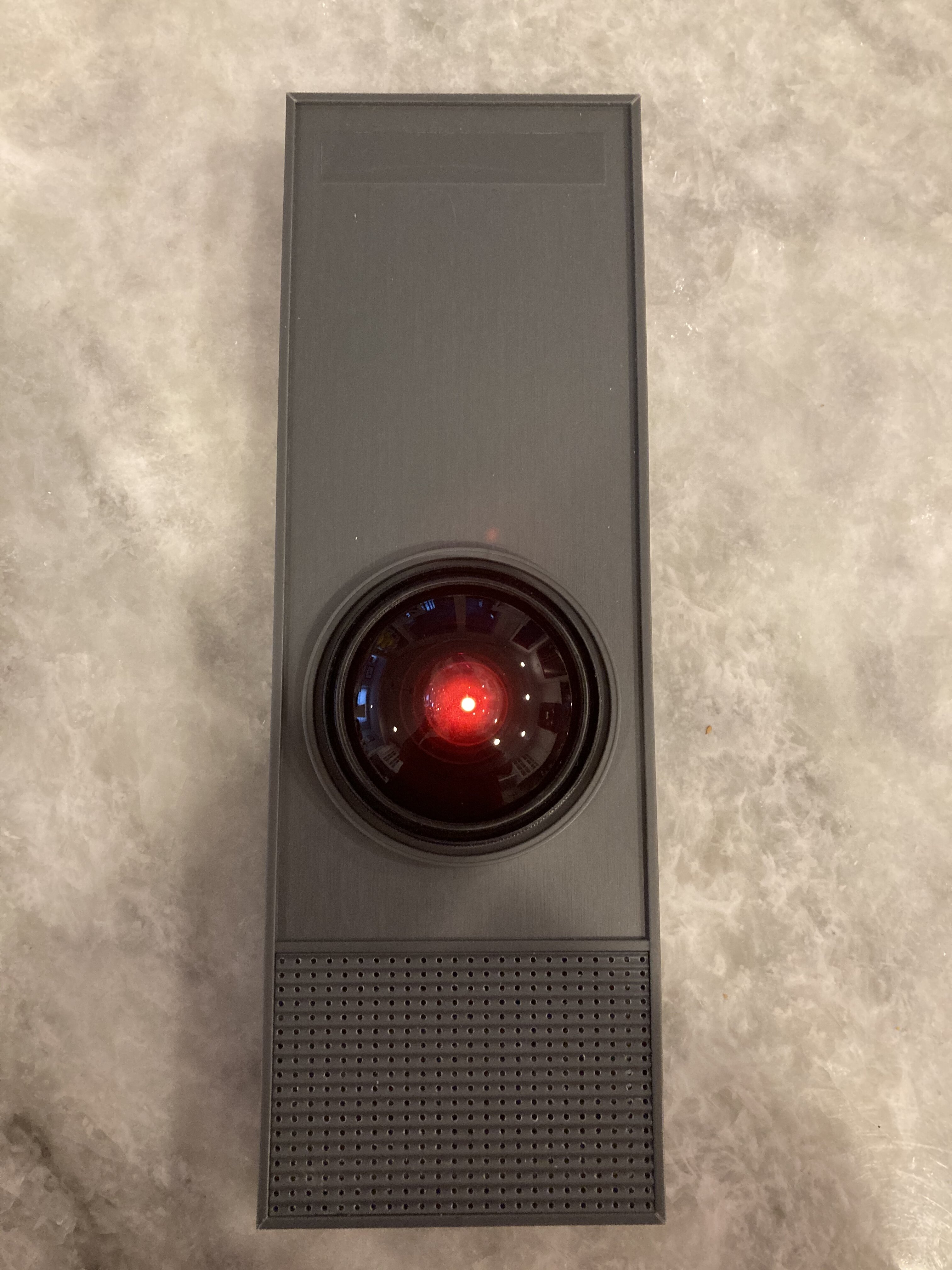

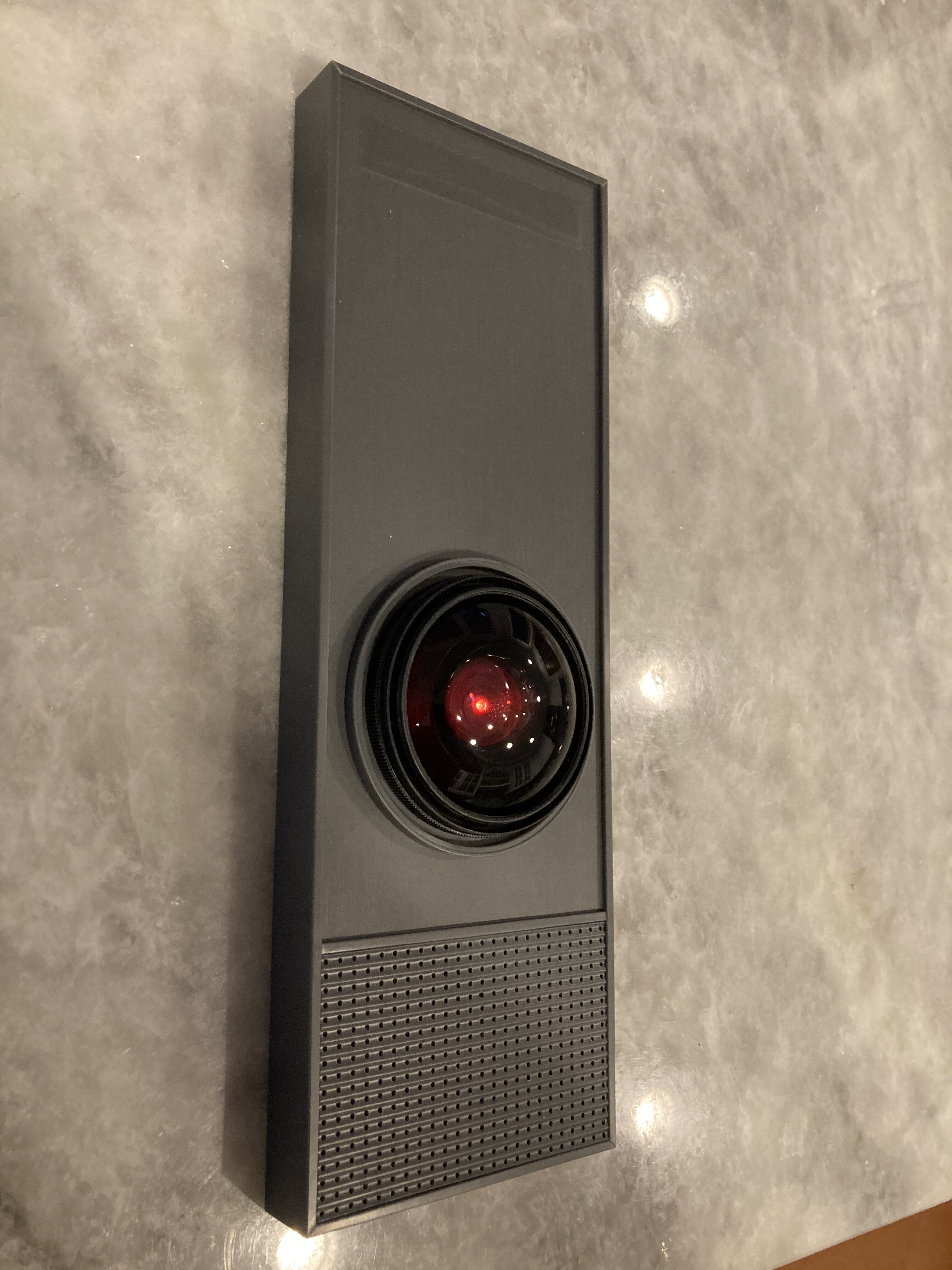

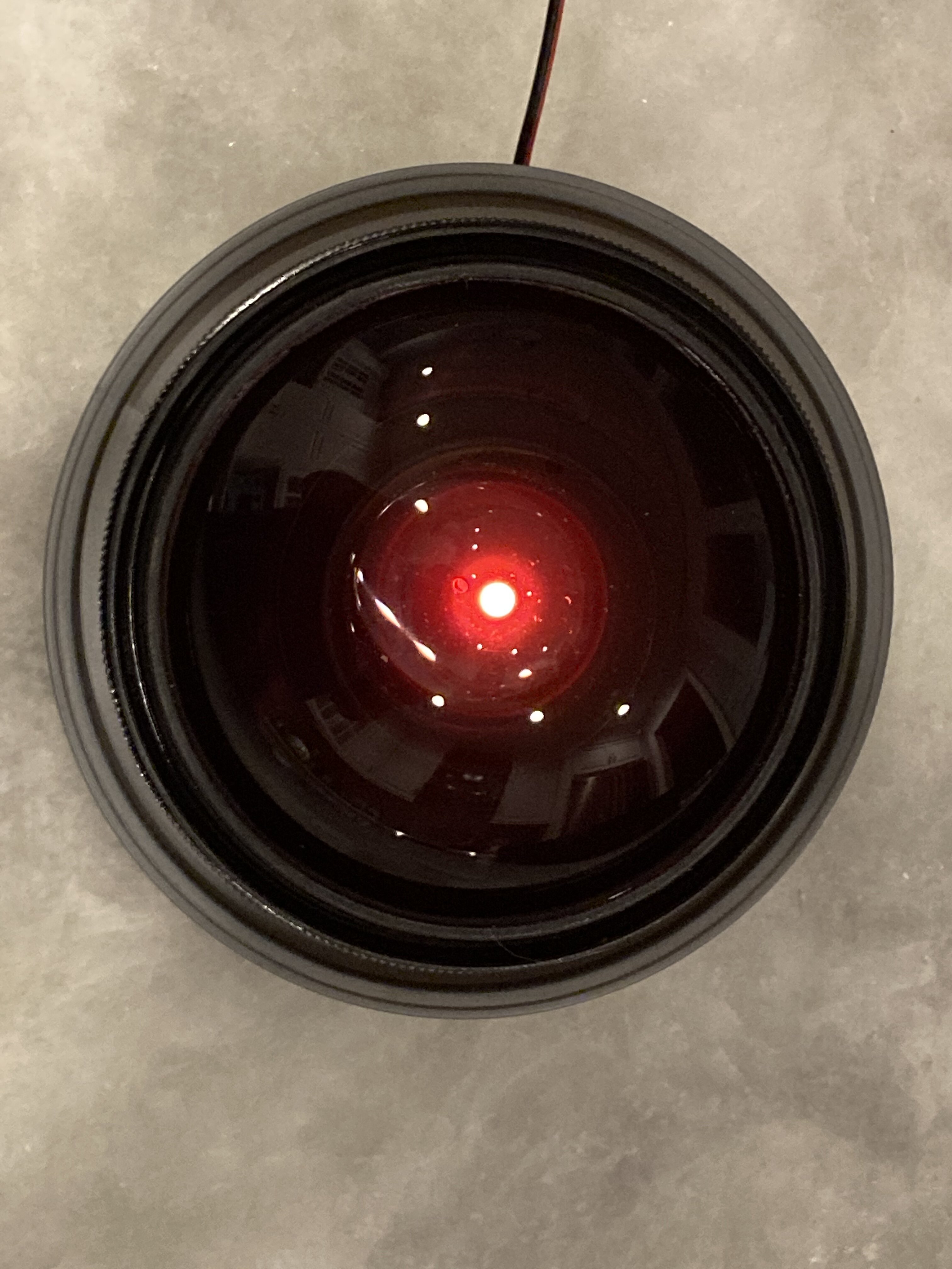

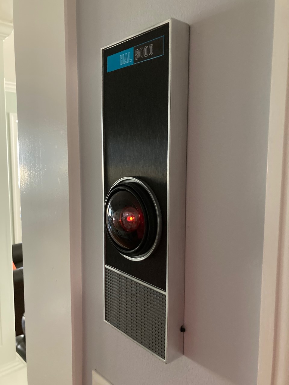

It fits!
The nice thing is you don’t have to be especially steady (I don’t have a particularly steady hand) when cutting to separate the outer ring from the back. I mean, you have to be somewhat careful, but I found that when the lens is press fit into the ring, it tends to hide any sloppy cutting. I scored the inside of the ring with a razor before using the Dremel saw, as a sort of guide.
I’m VERY pleased with the eye effect.

Wow! It does look very good actually. Many thanks for posting the pics. Is the flat surface of the lens painted black, or is the glass black?
It fits!

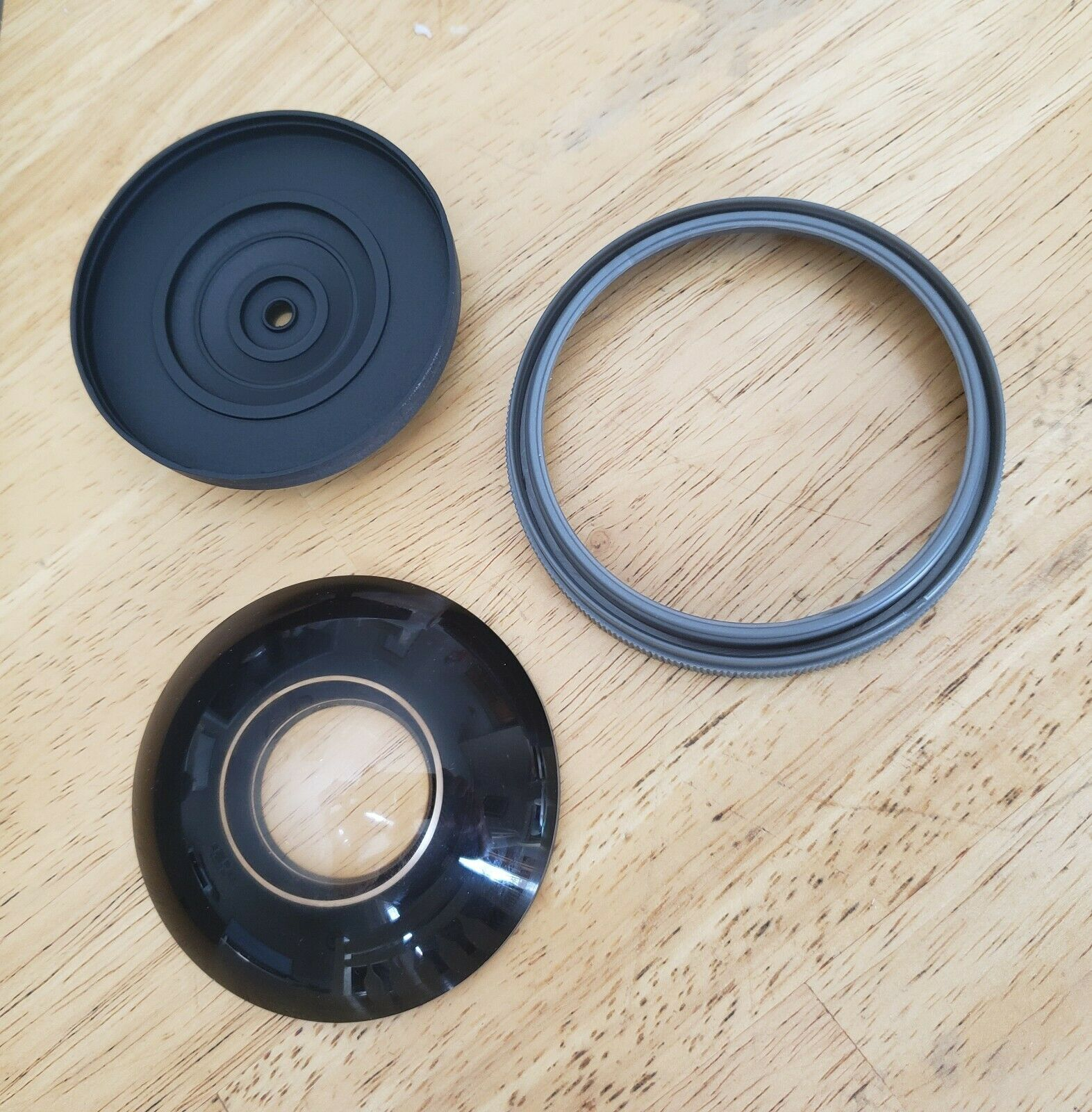

Would you be able to post a pic of the ring only? I'm not 100% sure where I should be cutting and don't want to mess it up
I've press fit the lens in the ring and don't wish to remove / re-install it, for fear of messing up the paint.
But this pic from the auction shows the deal; you need to cut just inside the inside flat surface of the ring. I actually left a bit extra, as I was fearful of messing up the part that would show. Imagine sticking the dremel tool inside the assembly such that the saw will cut around the inside edge. I was quite worried I'd mess it up somehow managed not to. As I said, I scores it first with a razor before sawing. If you screw it up, well, the kits aren't THAT expensive. ;)
I see now. The plane of the dremel wheel would be parallel to the table. Thanks!
Yes, that is a better way of saying it. I felt it was better to leave some extra material and sand down if needed; as it turns out, the curvature if the lens is such that it extends past the lip and hides the material left inside. My cut was far from pretty. The back part just glues onto the backside of the lens (though I have not done that yet and may instead come up with a different solution).

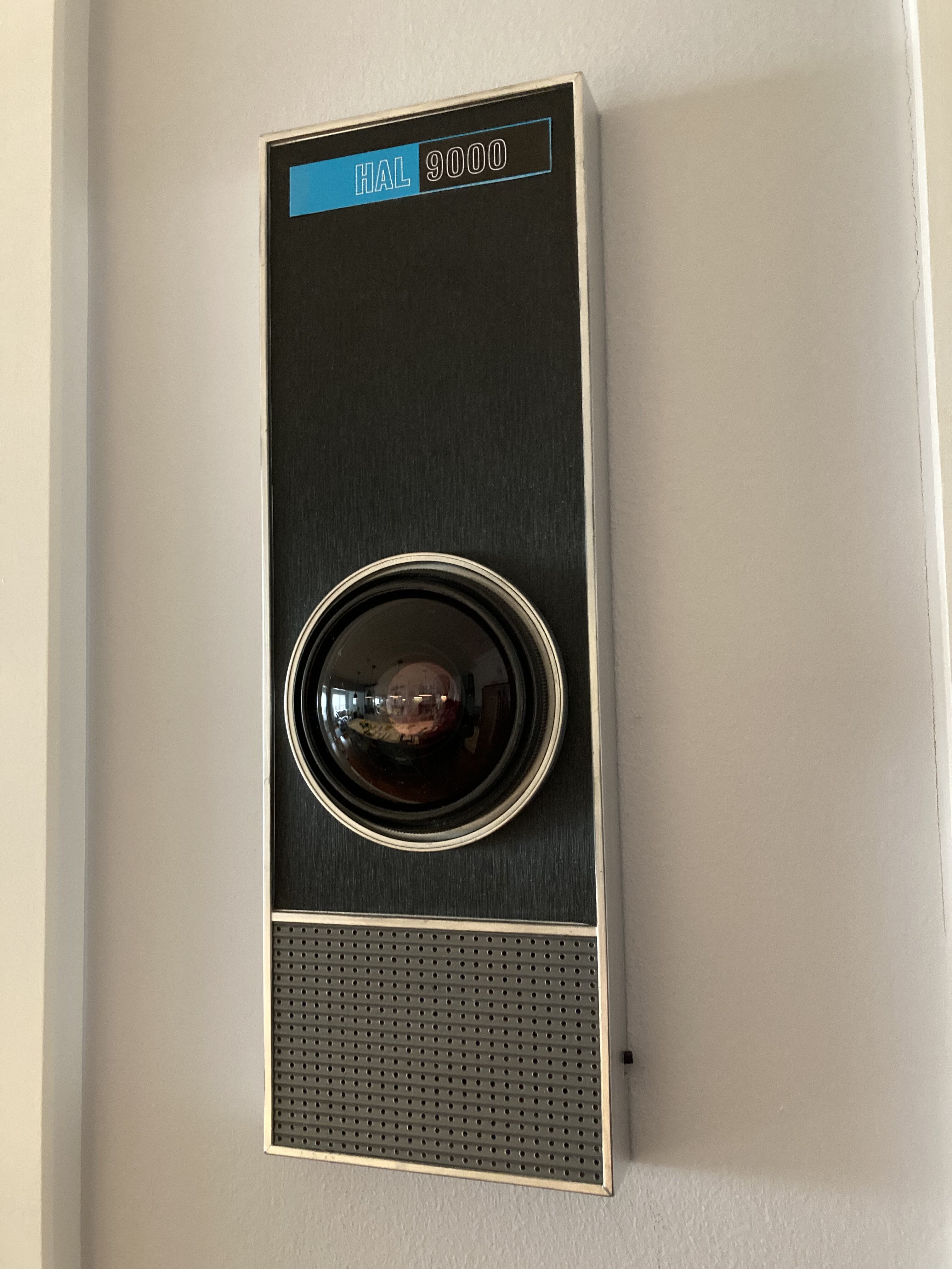

I meant I'll use (used) JBWeld to mount the lens housing to the "aluminum" ring and the ring to the faceplate.
If anyone comes up with a decent "NIKKOR KOGAKU" decal to use on the lens housing (with the correct font) please let me know.;)
