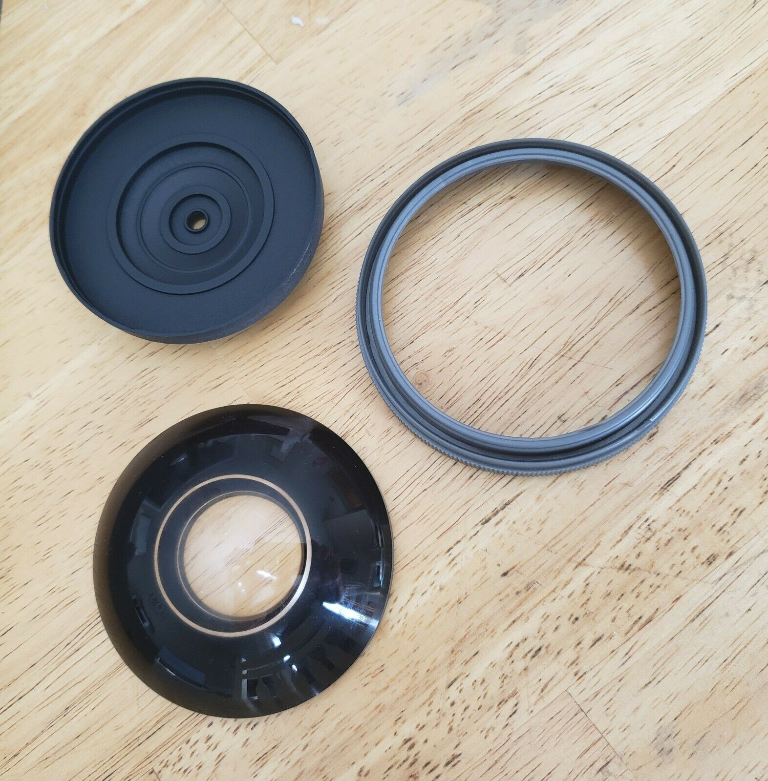

I've press fit the lens in the ring and don't wish to remove / re-install it, for fear of messing up the paint.
But this pic from the auction shows the deal; you need to cut just inside the inside flat surface of the ring. I actually left a bit extra, as I was fearful of messing up the part that would show. Imagine sticking the dremel tool inside the assembly such that the saw will cut around the inside edge. I was quite worried I'd mess it up somehow managed not to. As I said, I scores it first with a razor before sawing. If you screw it up, well, the kits aren't THAT expensive. ;)
I was wondering once you cut the back of the lens housing off, how does one attach the led and filter? Do you reattach the back section again some how, and insert the white led thru the original hole?
Yes, I reused the back piece with the filter trimmed to size and placed inside, and the white LED through the original hole. I did not want to glue the back piece on the backside of the lens for fear that it might show though the front, so I secured it in place from the back with tape. I'm sure something better could be rigged up.
I’ve yet to cut apart my Moebius lens but I worry about how the glass lens will stay put within the cut piece. I hear press fit but it’s hard to visualize since it won’t be snug as far as I can tell.
Snug as a bug in a rug. I posted a pic on the prev. page, on Feb 26th showing the lens inserted in the lens holder.
I did see those pics but when I looked at them it looked to me like the lens could/would just fall backwards into the inside of the main body. I couldn’t see what would prevent it. I’m hoping once I get my Moebius lens cut open it’ll make sense or become more clear to me.

The "inside" plastic bit goes back behind the glass, so it essentially fits back together like kit is meant to; there isn't a hole for the lens to fall back into.
And I'm not sure your razor blade trick will work. The part of the ring you're supposed to cut faces the middle of the ring assembly

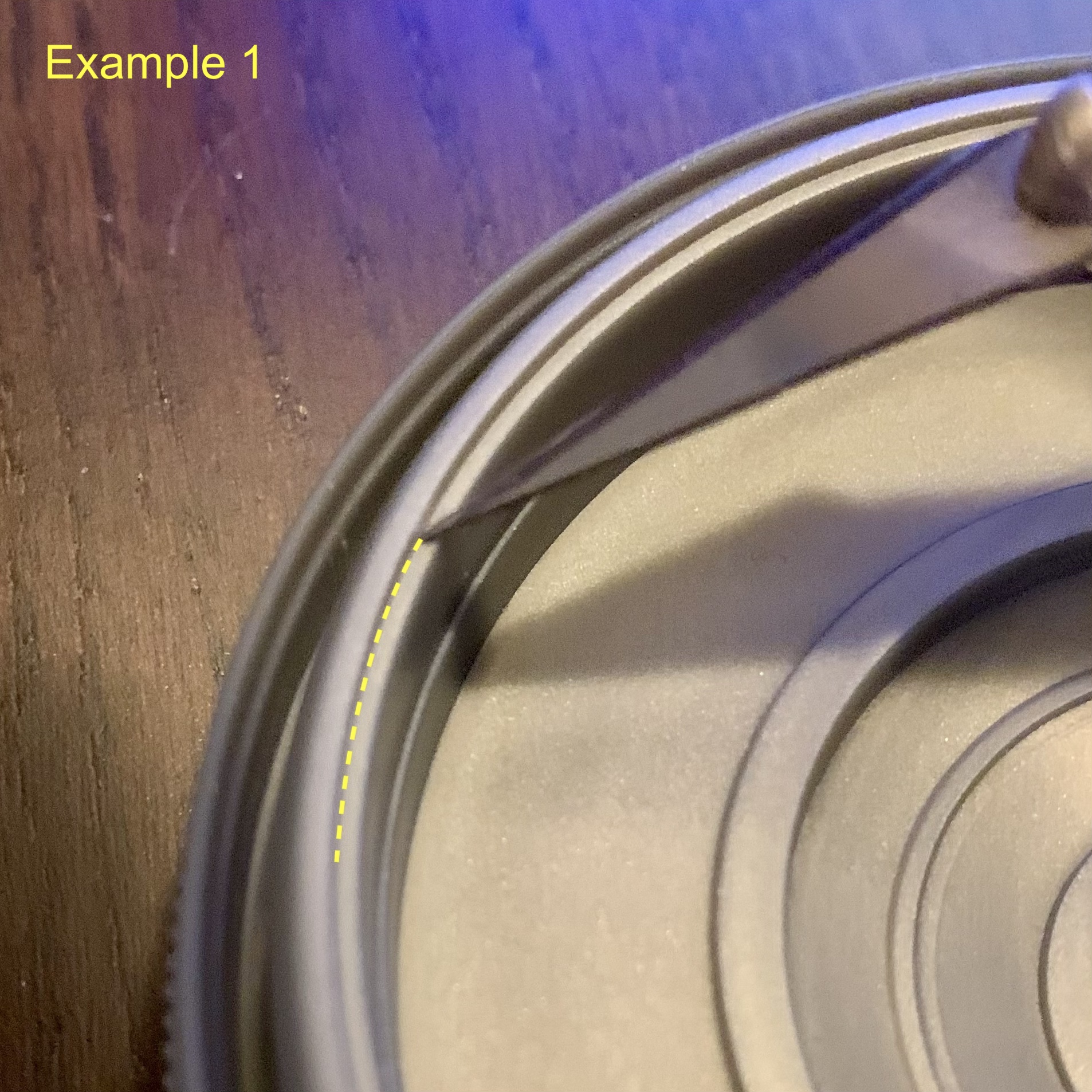

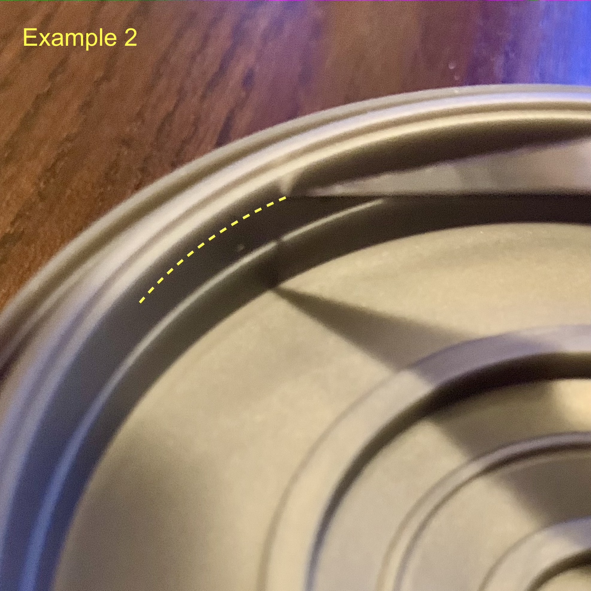

You mean like example 2 below right?

I've yet to cut mine, but yes, example 2 from my understanding
See to me that seems a bit weird because that means the glass lens will be underneath the lip which was originally intended to be a "shelf" for the plastic lens to sit on. To me it seems like example 1 would be the better way to do it.
Hmm
Hmm
It's all dependent on the diameter and curve of the glass lens and where that meets the ring housing. From what previous posters have said, it sounded like cutting it like B allows for a pressure fit and for any imprecise cutting to be hidden away as the edge is forced underneath. Which means if you cut like A, you're going to have a gap between your glass and the ring.
The glass isn't fitted to the ring - it's not the same size as the plastic dome - so any structural intention for that little ledge is moot

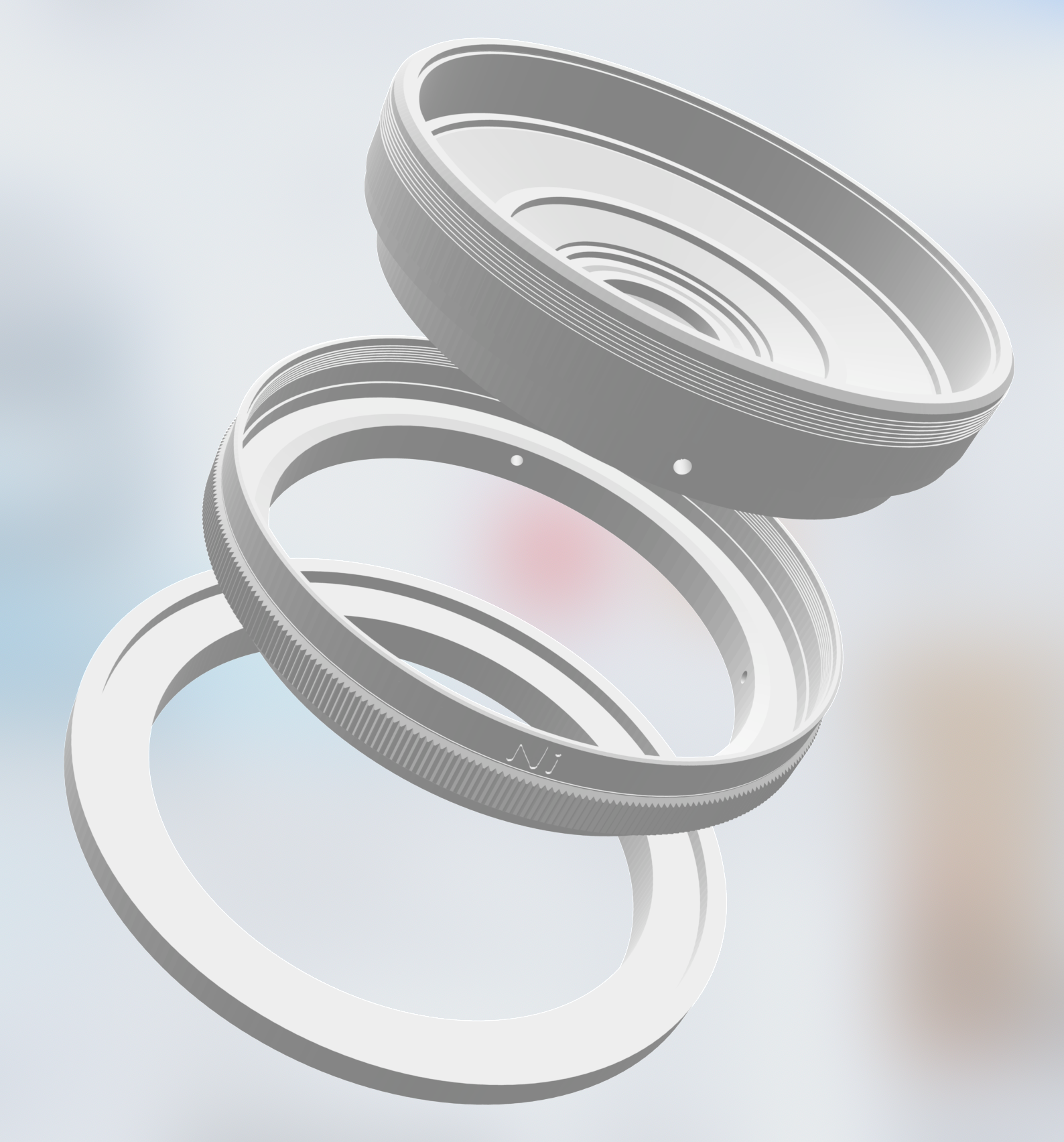

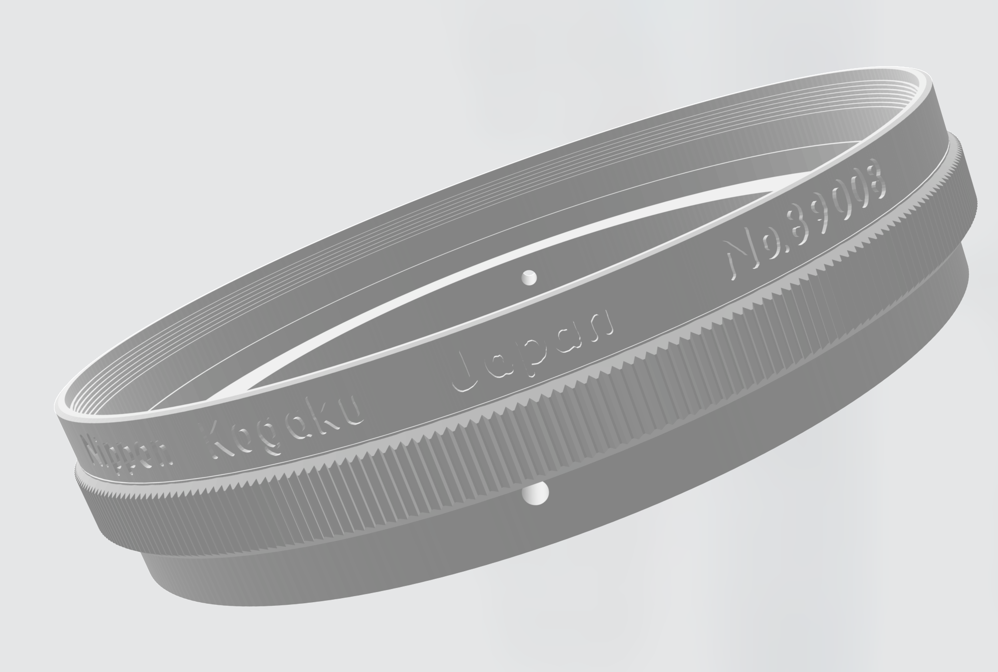

Are you going to sell 3D Prints of these?
I'm probably going to make prints available via Shapeways. Doing some tests now. I've managed to emulate the look of the original engraved letters pretty closely, based on photos of the actual lenses. Rather than using a font. (the Moebius approach) So I want to see how those look printed.
