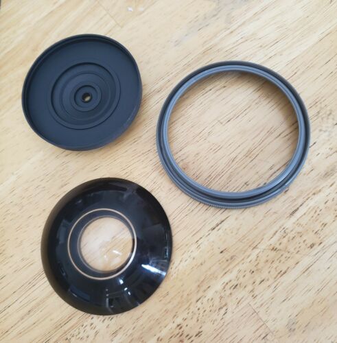

Necroposting here, but if anyone is still looking for a decent option for a lens, I ended up using this very cheap macro filter of Amazon for my Moebius kit:
Green L - 72mm Macro Filter 10x
The curvature of the lens is slightly lower than the original but it looks a million times better than the plastic kit lens. I also found it very easy to remove the glass from the filter ring - the elements twisted right out.
The overall diameter of the glass is about 1mm too small, but fixed this by adding some tape to the inner rim of the housing.

Here is something that I tried some time ago. I got this lens dirt cheap from aliexpress. The curvature is great. But in this case, the diameter of about 60mm is just a little too small. I tried to use it inside the 100mm arcade button (as an internal lens element), but it is too thick to fit in there.
Has anyone considered just buying a cheap 8mm fisheye and taking it out of the plastic housing? I'd like to build a replica around that, but keep it as close to the Moebius kit measurements as possible. I think I measured the outer lens of the Moebius kit to be 72mm and that mostly fits a 72mm filter adapter I own (there's a bit of jiggle room). So I'm looking for cheap 8mm Fisheye lenses that use 72mm filter rings. I feel like that's the only way to get the true diffusion of light. That might just mean that the case has to be a bit deeper than the usual to support the additional lens elements.
Anyway, has anyone gone down this path? Any specific inexpensive fisheye lenses that have been found that will fit with the kit?

I like my HAL well enough but have been looking to replace that plastic lens, so I ordered one.

Figured this would be a more inexpensive option than finding and retrofitting a wide angle lens, so I went ahead and ordered one too. I'd be interested in seeing how you install yours when you get it in hand
So I received my lense today exactly as advertised.Pretty quick considering I ordered it late Friday night. It looks great as the curvature is so much more extreme than the plastic lense. I built my HAL when I got it so I was able to get the plastic lenses off and pull the eye from the frame, but those 3 parts ar not coming apart so I’ll have use a dremel to cut the inner lip, but it appears the glass will fit right in there. Not sure what glue to use, Anyway I’ll do the surgery after work tomorrow and update.
Fett_Ish I was unclear from the eBay post. Does it include the lens housing and ring as shown here?
Took the plunge, and got a 'posted' notification and tracking number within an hour.
Working on a 3D printed mount so it's a straight swap.
