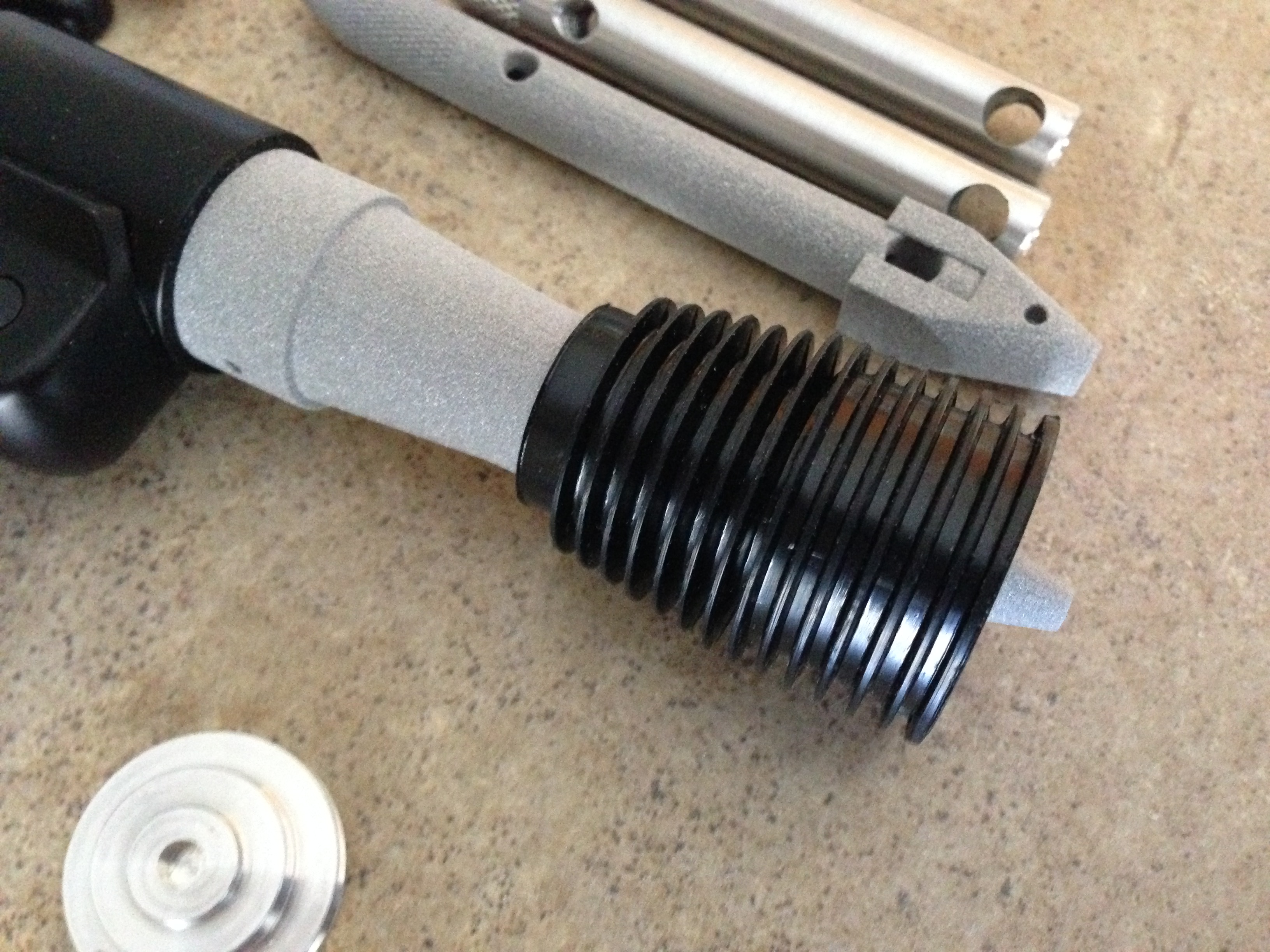

Revised the barrel so that it is tapered up to the point where the Tomtit piece sits at which point it is straight & will fit inside & go to the depth of the recess. Opposite that I came up with a "witch hat" spike, that will fit into the recess opposite the barrel. This is made to slide inside the Tomtit piece. For the barrel & the spike there may be some fitting, but it should be very close., but there won't have to be any cutting or modifying the Tomtit piece.
The barrel has a .500" hole with a key way that will mate up to the preferred airsoft pistol that everyone seems to be using.

Thanks MJF. I am pretty happy with the barrel now & how everything will fit together. I am still not sure on the consensus about the cone inside the barrel but it looks pretty close to the reference photos & I used dimensions from the Mitchell pieces that were used on Boba Fett's Knee darts/toe spikes. I think this would be very secure as well.

I only used the Boba Fett pieces as reference cause if I was to make it like the actual piece the cone is twice the length & this would have required drilling a hole in the Tomtit piece. I could easily make it an option if someone was wanting that though. The only real difference that I can tell is the cone length is around 34 mm which I made the cone length 17 mm. I made the diameter of this 12 mm (7/16") which is pretty close to what I came up with from the reference photo, it may actually be 12.7 (.500") but hard tell. With this it will stick out the end of the gun by 6.35 mm (.250").
I went with more of what I thought looked good without any mods to the Tomtit piece.

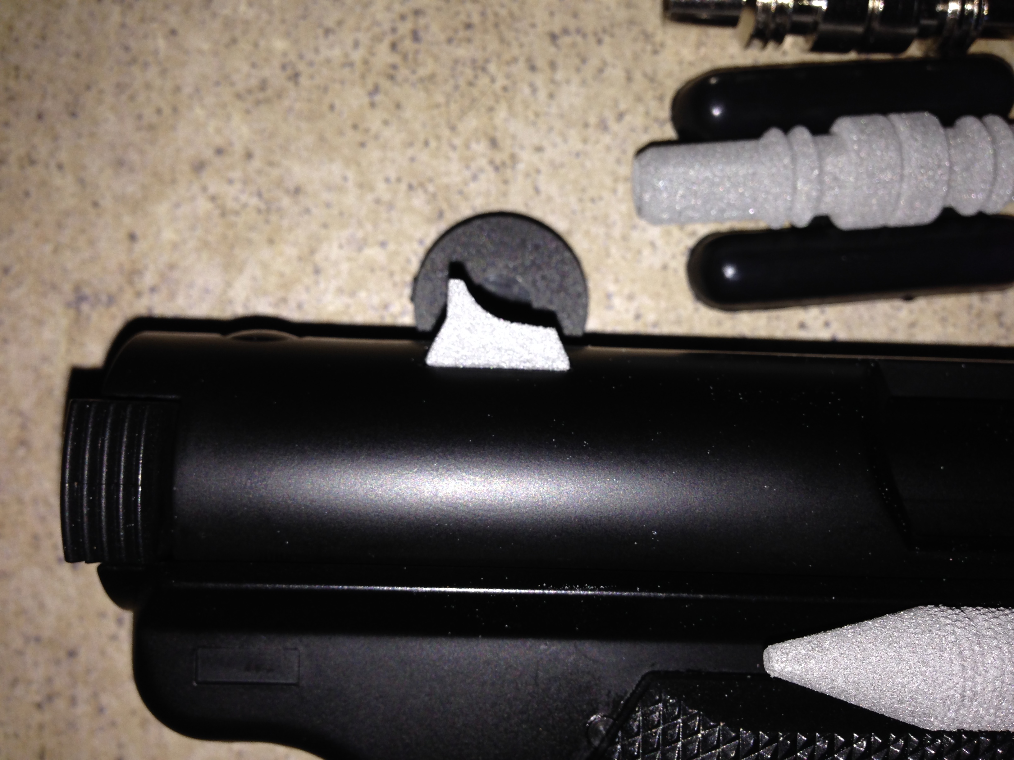

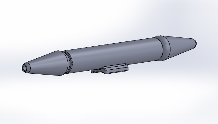

MJF asked if I could add some kind of mount to the sight so I revised the sight & added a mount area that would help attaching it to the top of the gun. This will raise it off the top of the gun .5 mm (.020") the base is 6 mm X 10 mm. It has an arc that will sit on a 12.7 mm diameter. The thickest section of the mount is 1.71 mm (.067"). This is what I came up with. Thoughts?

I like it. It's a simple thing I know but it really helps. I do not know anything about the real mount or its size. Ideally it should be high enough so that the rods align and set into the groove of the notch of the rear sight. That looks right to me.
My build it going to look so much better than it would have thanks to you. :)
Great, I have a KJW Ruger MKI airsoft on order & should have it next week sometime. Will be ordering what I need as well for my build.

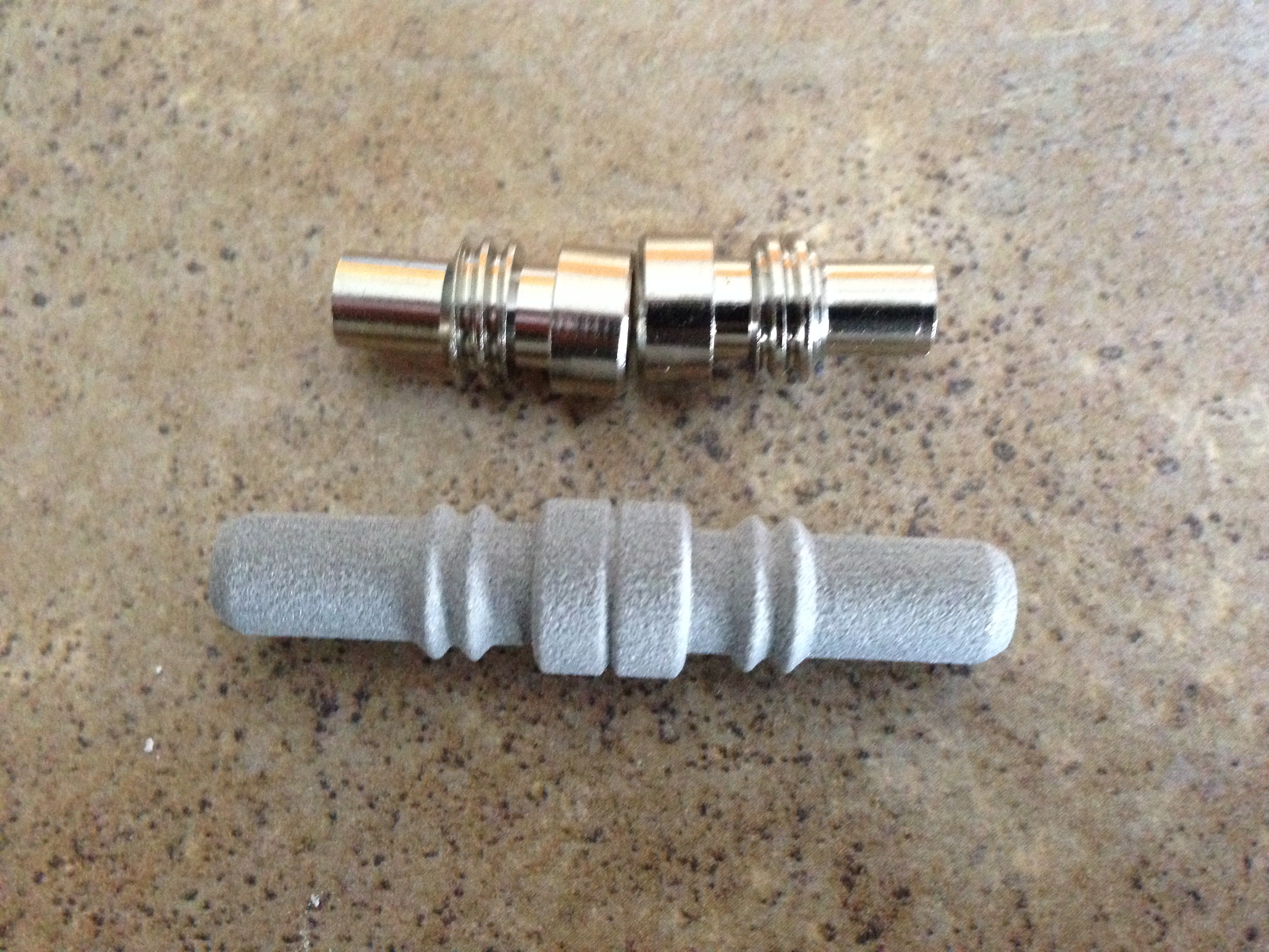

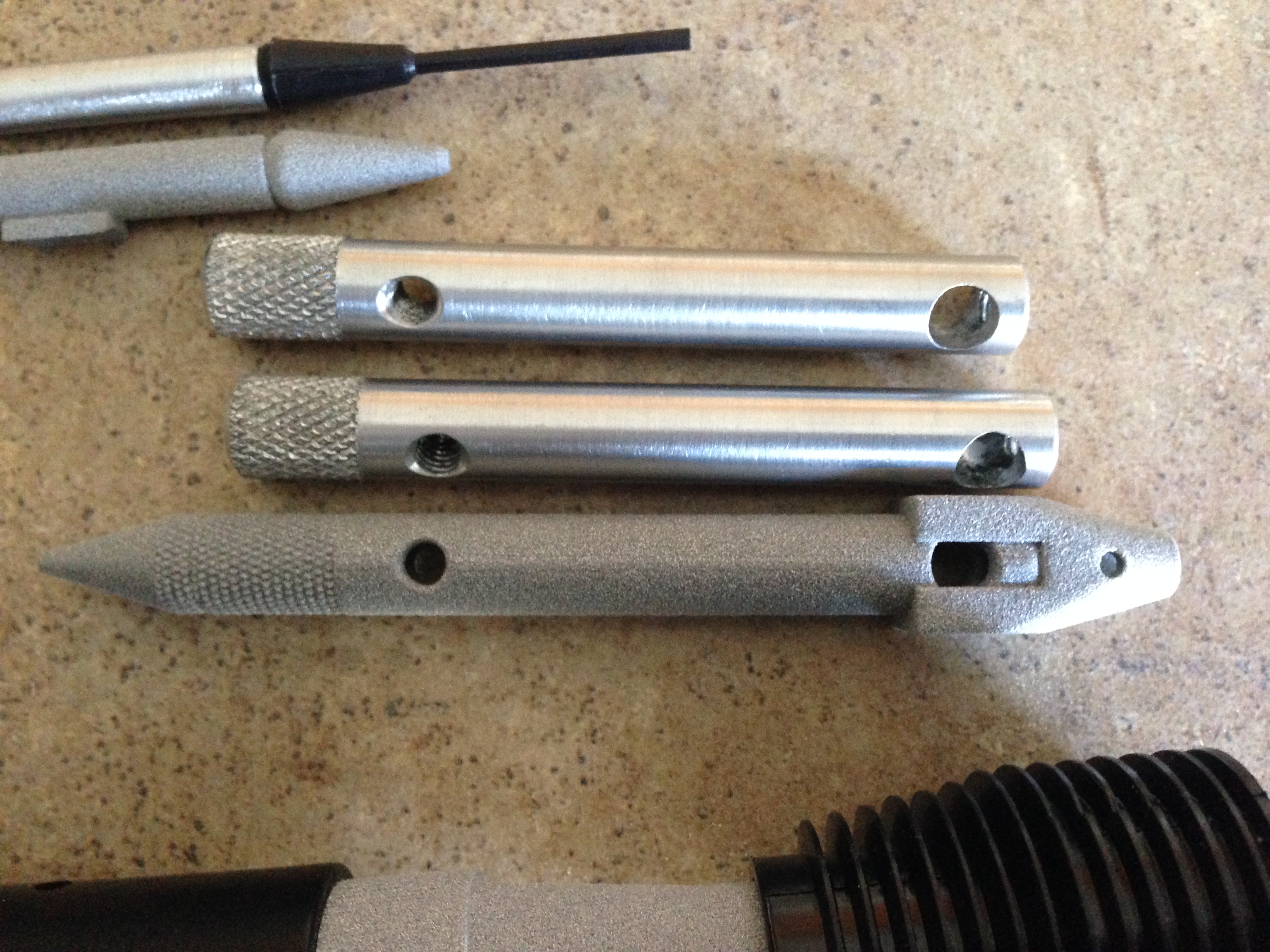

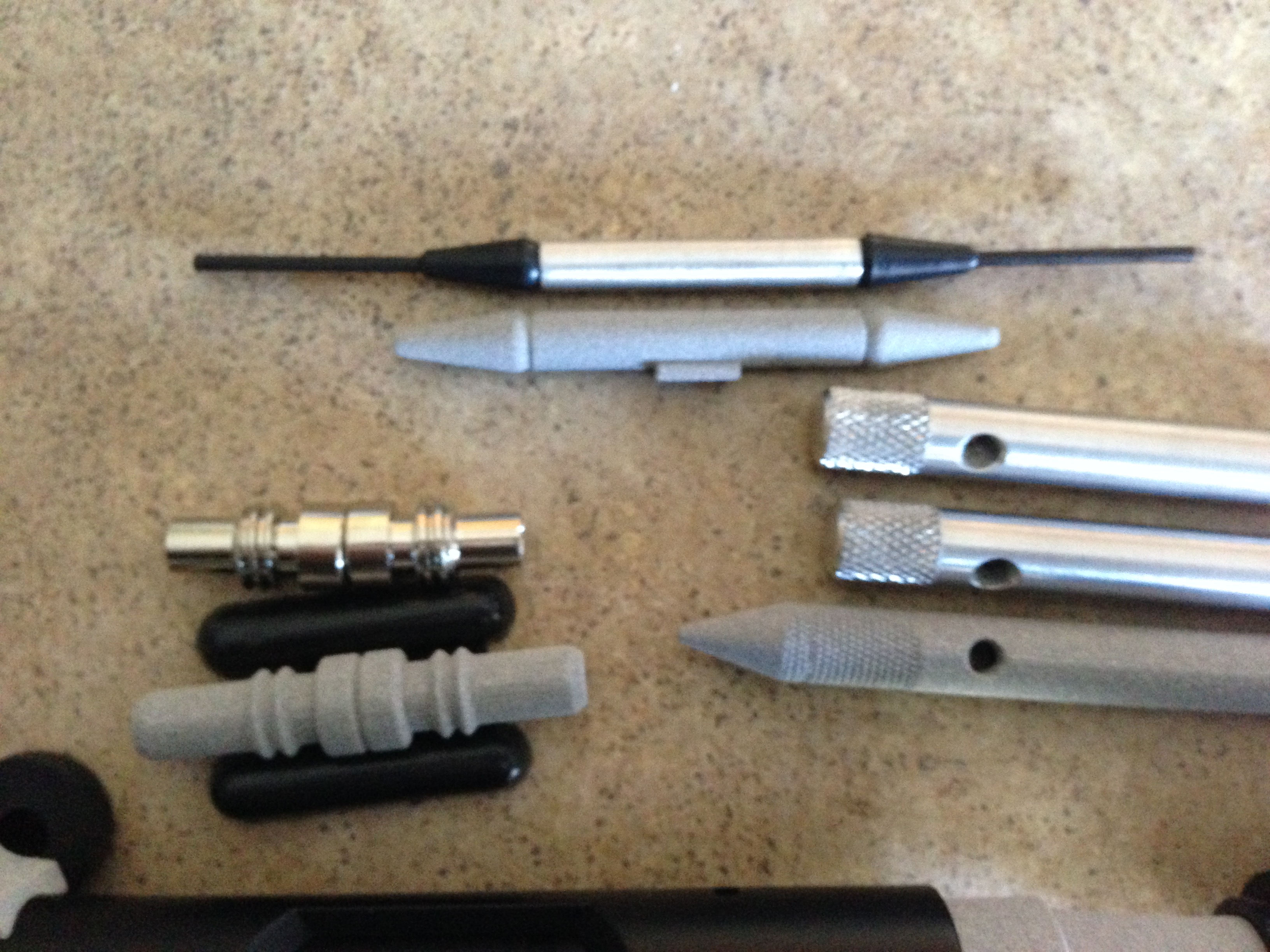

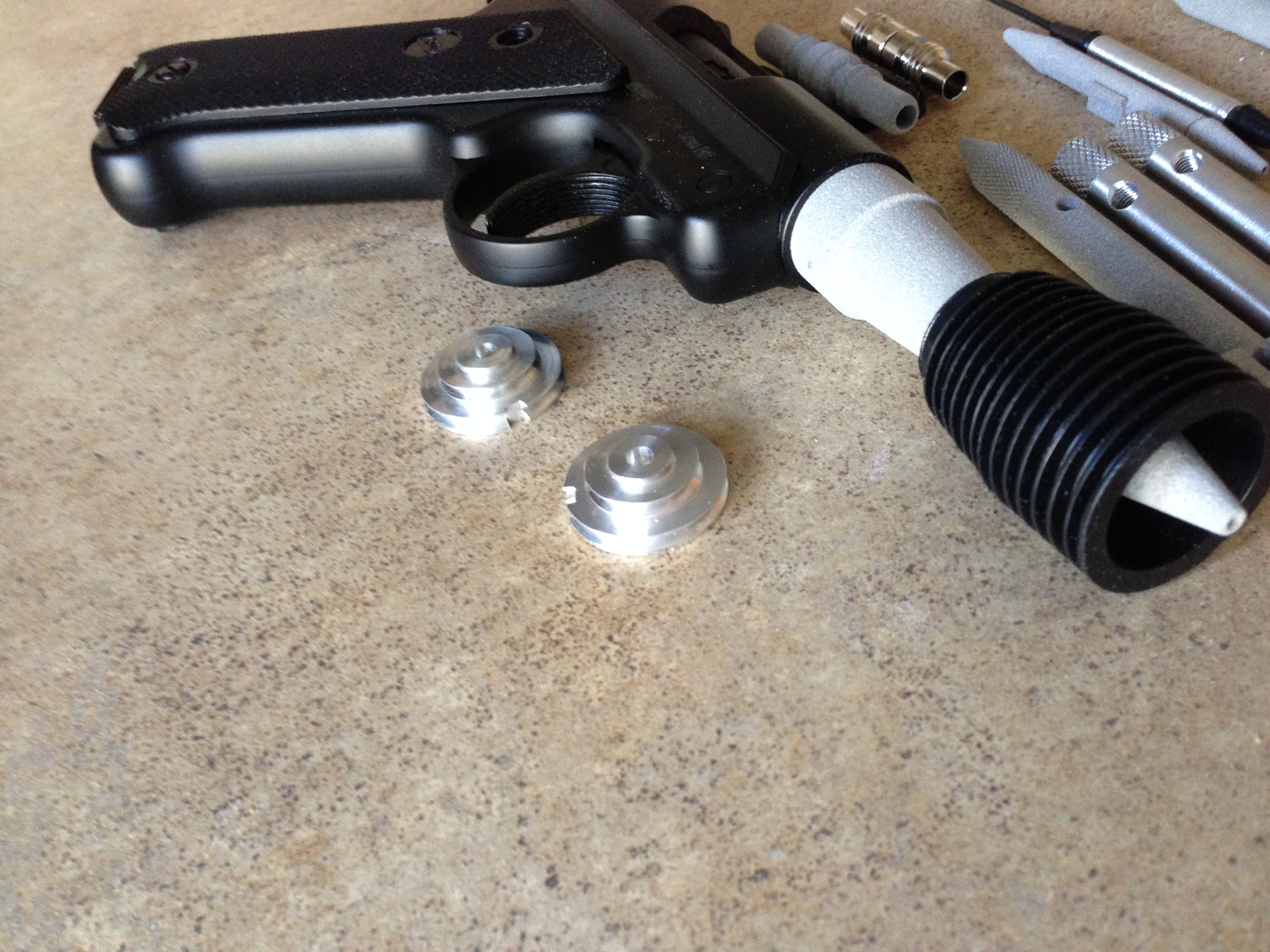

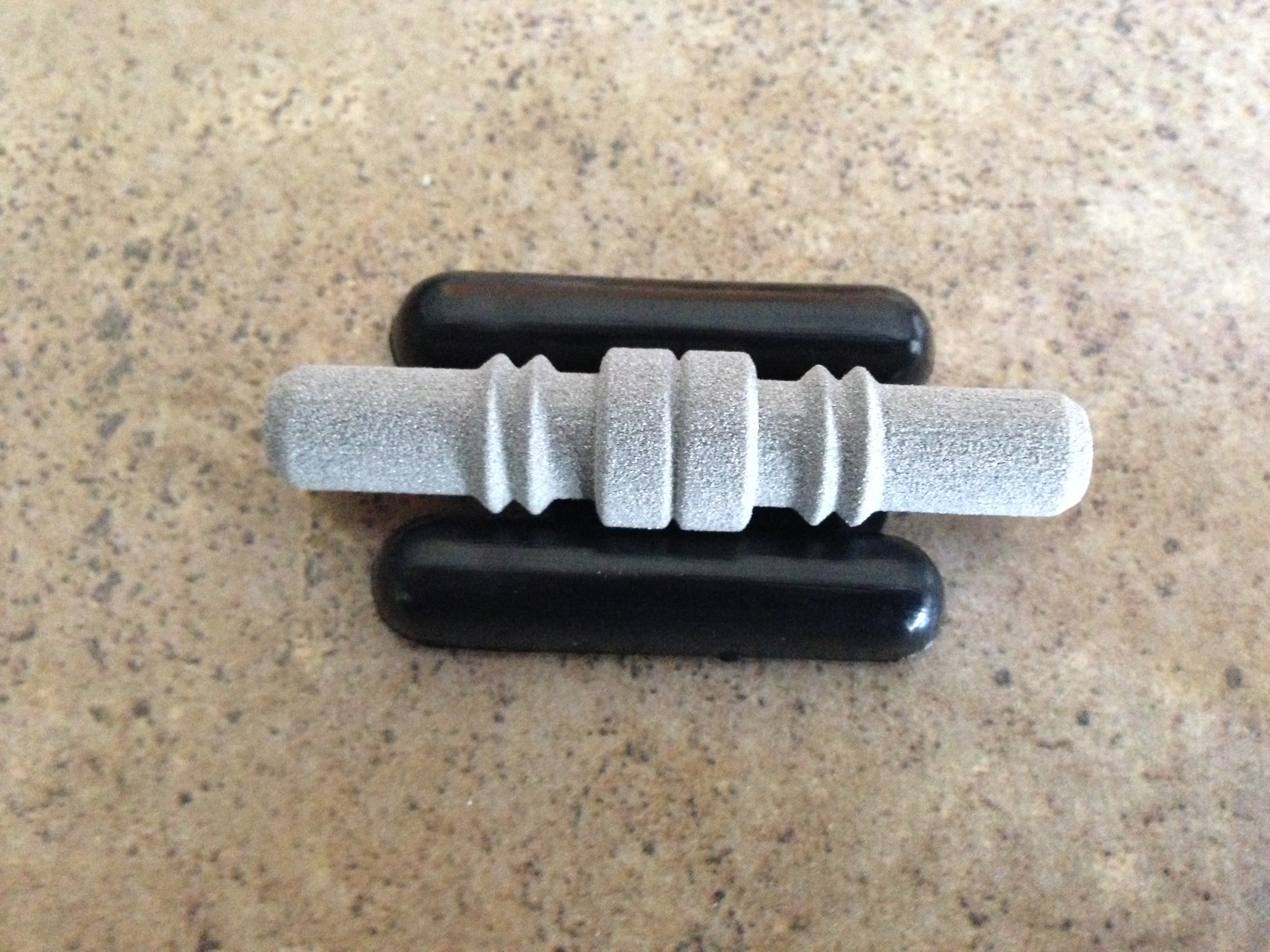

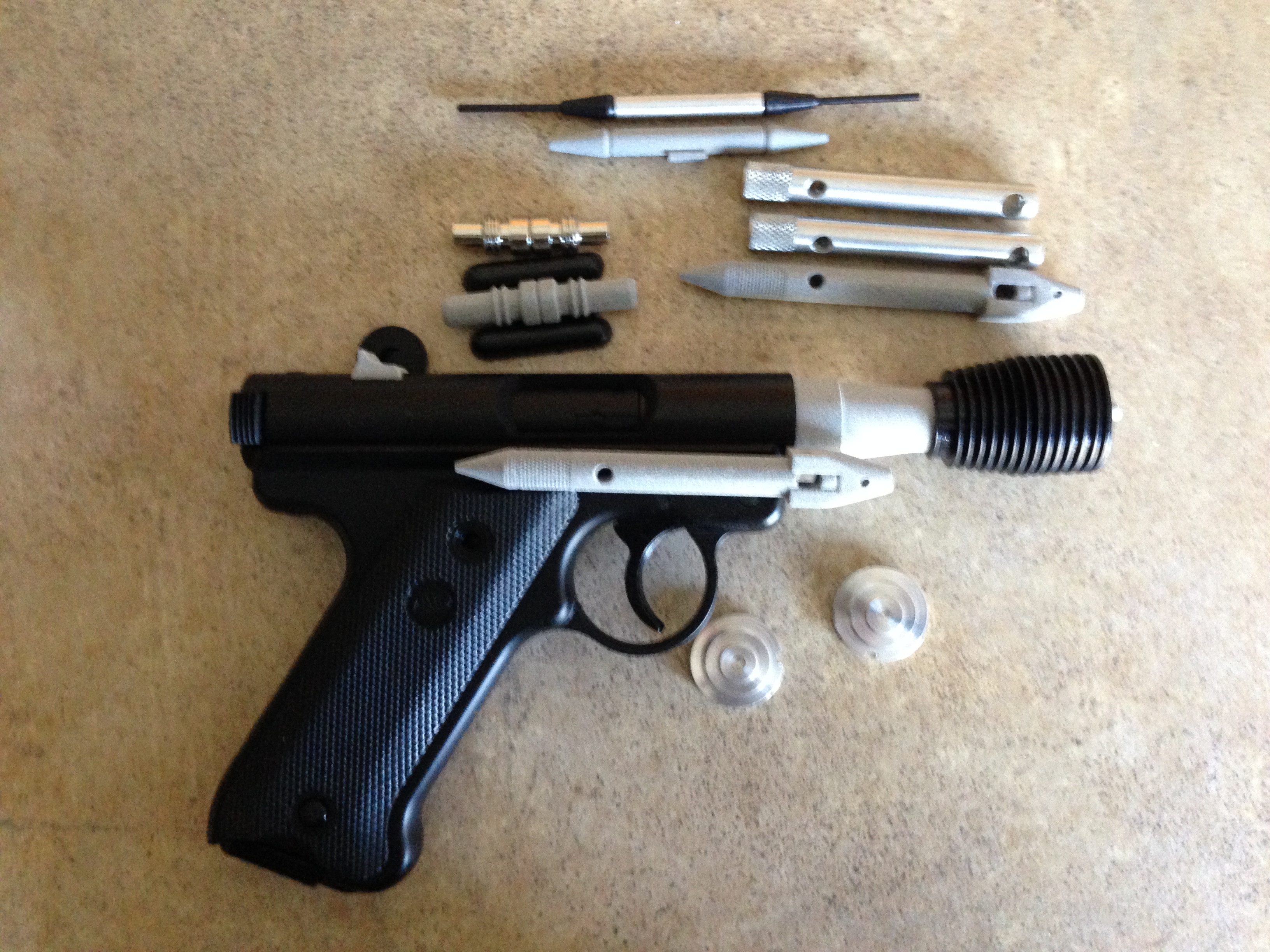

Here are images of the parts. I'll talk about them in detail later.
