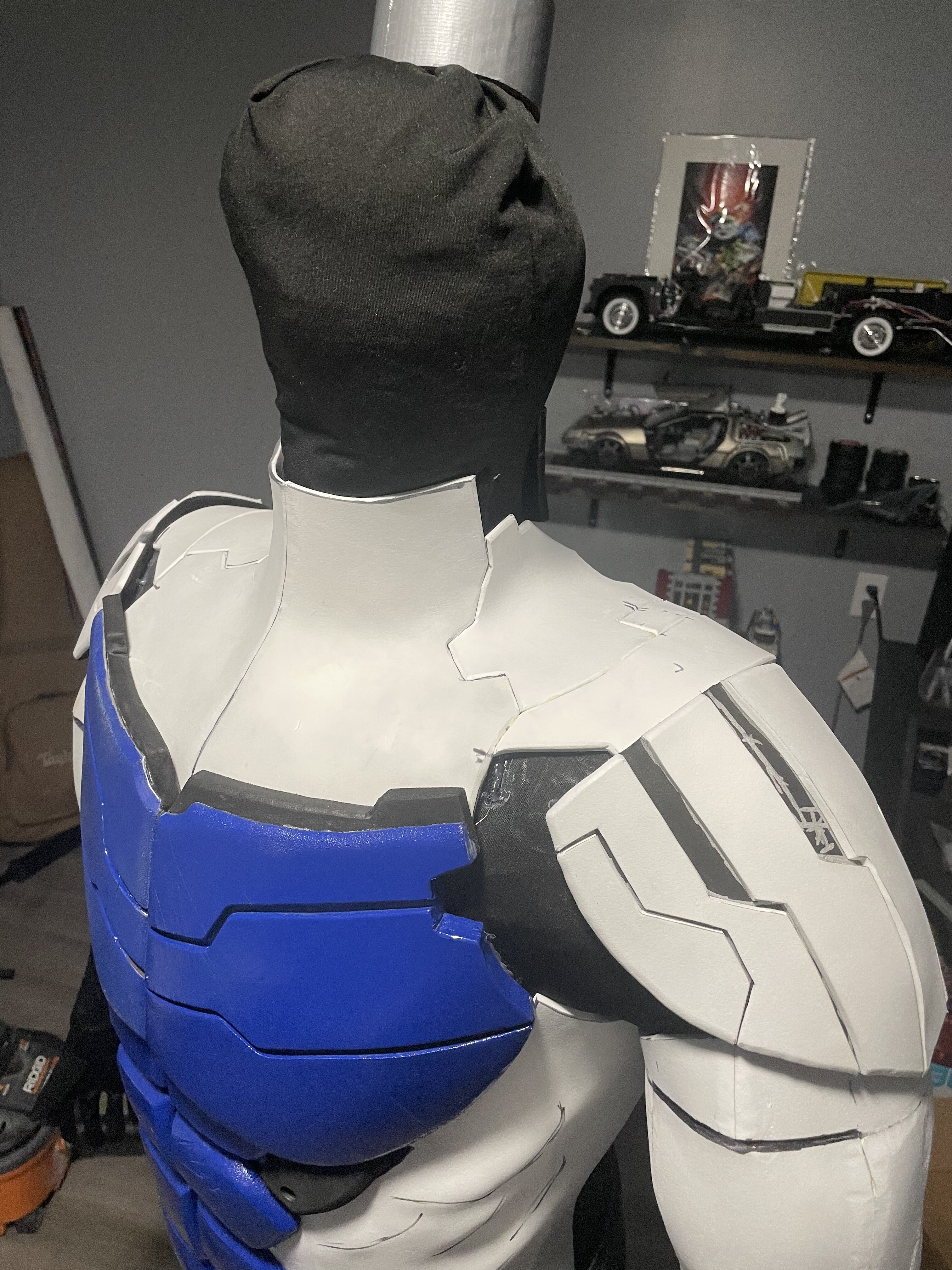

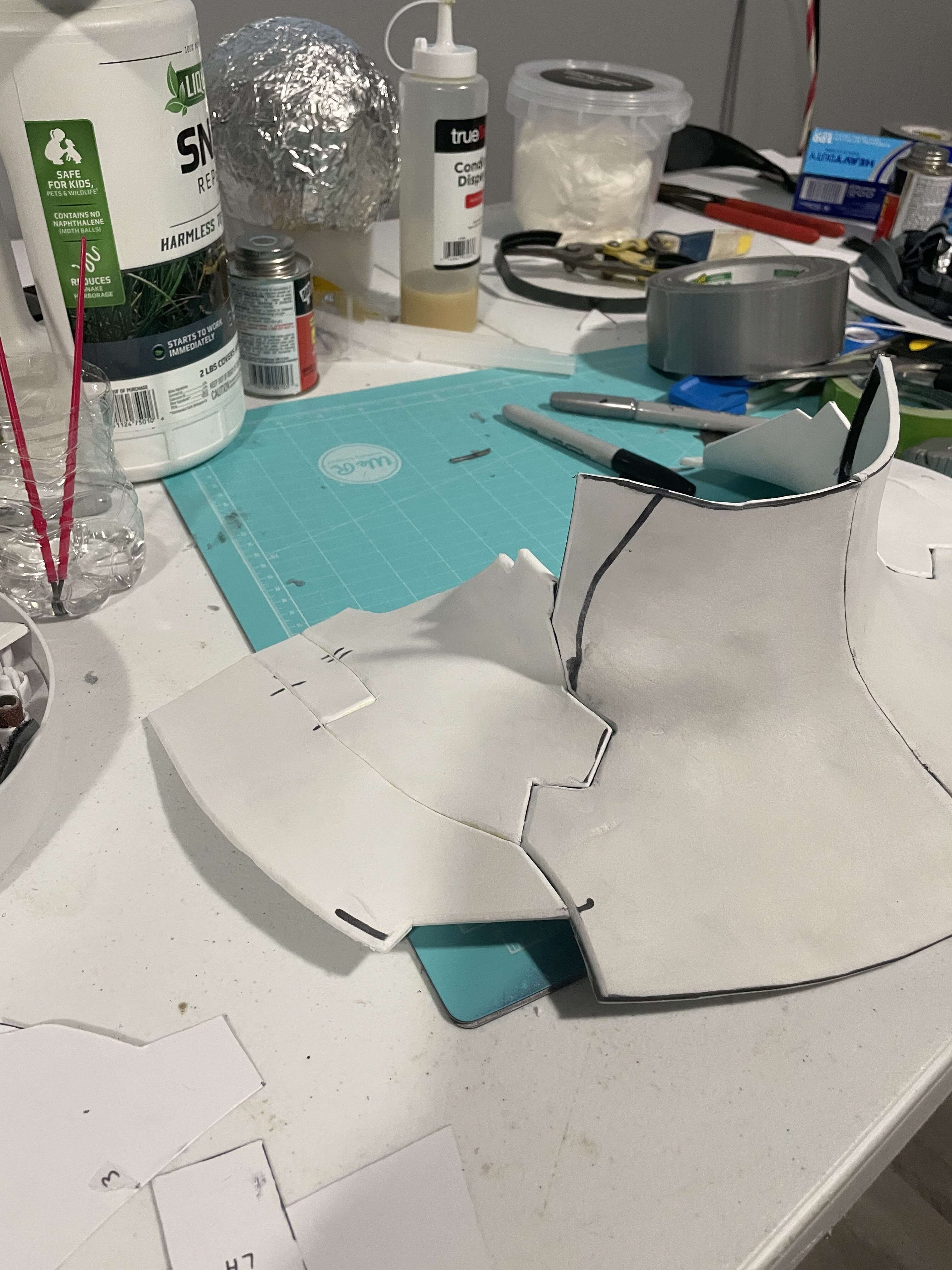

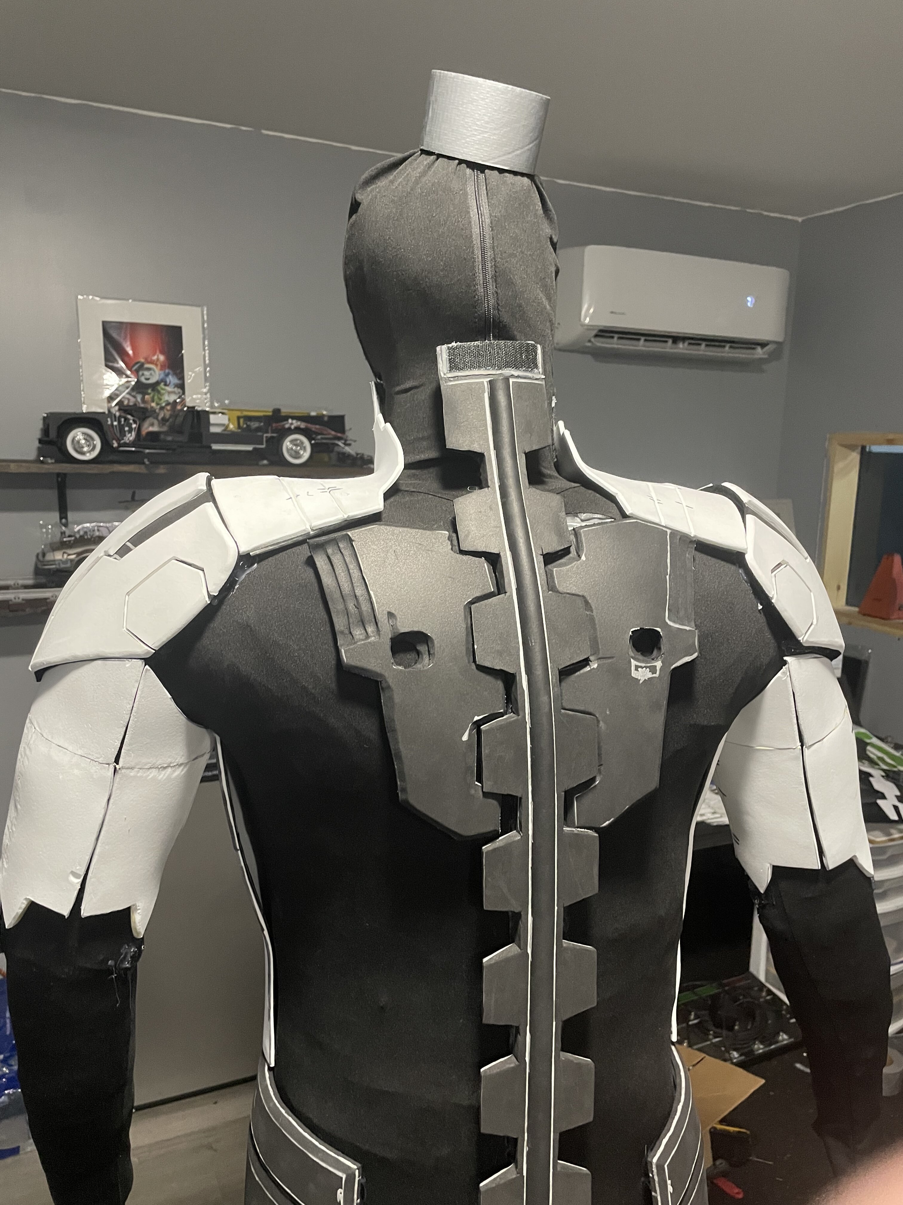

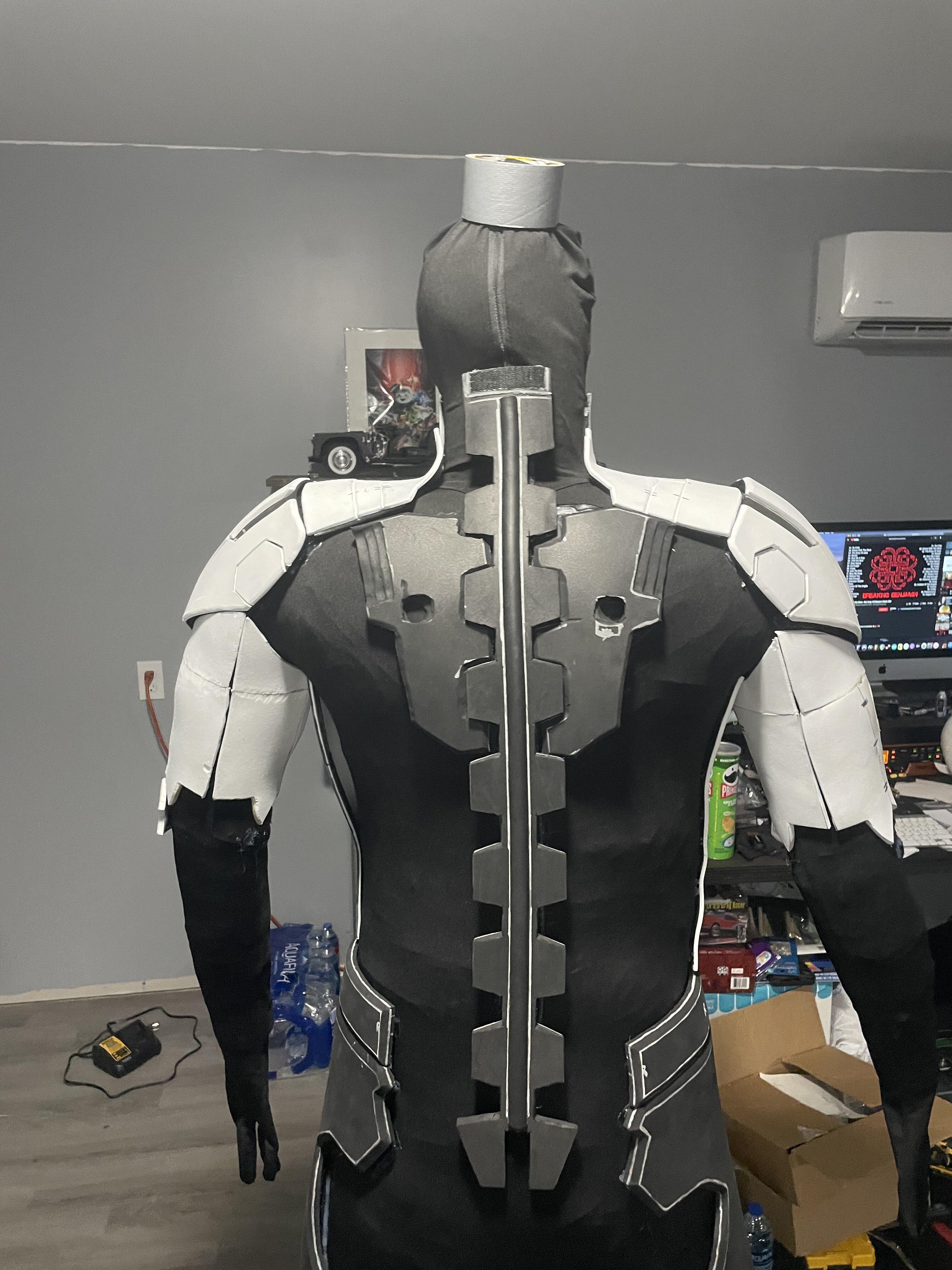

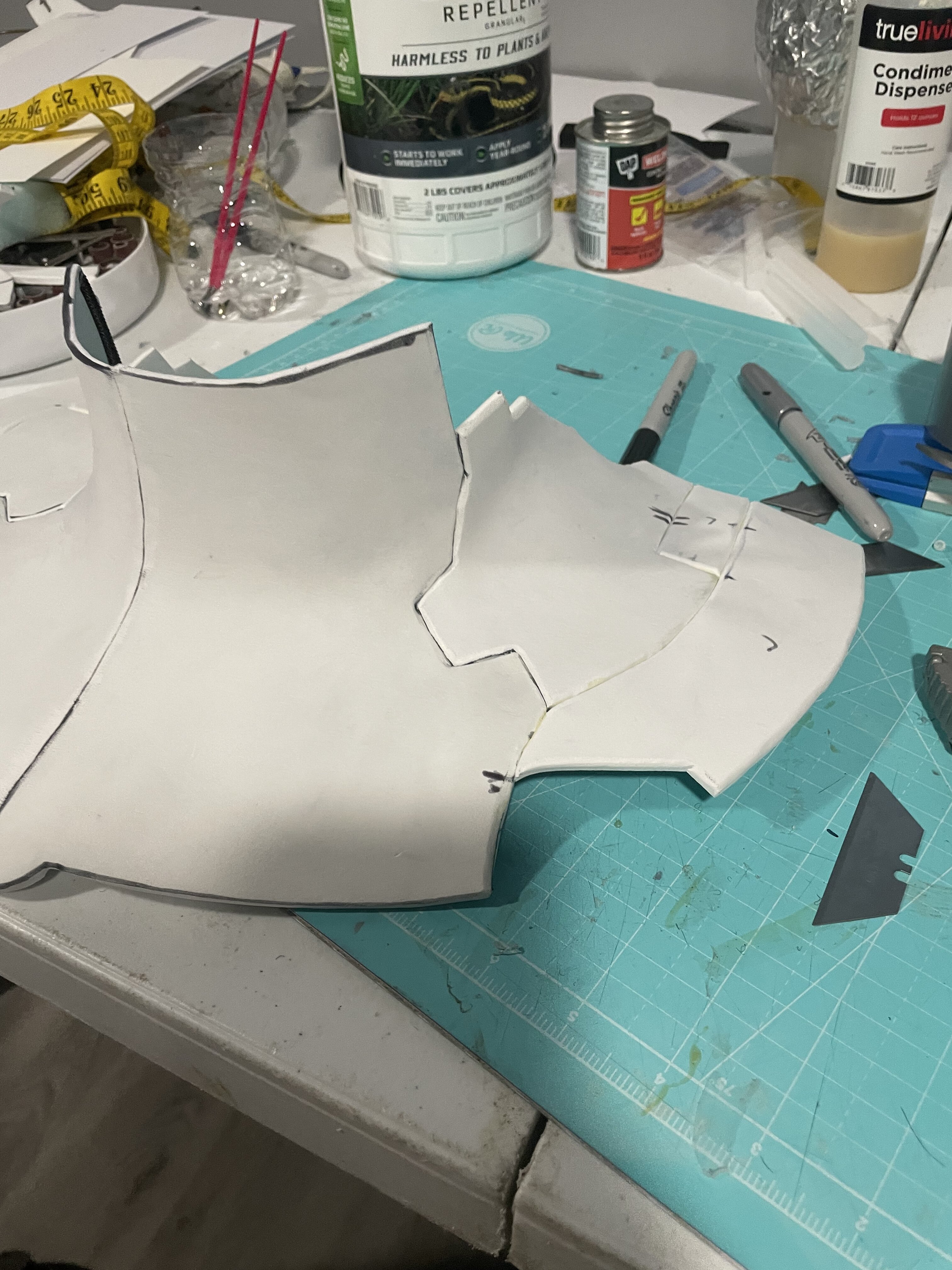

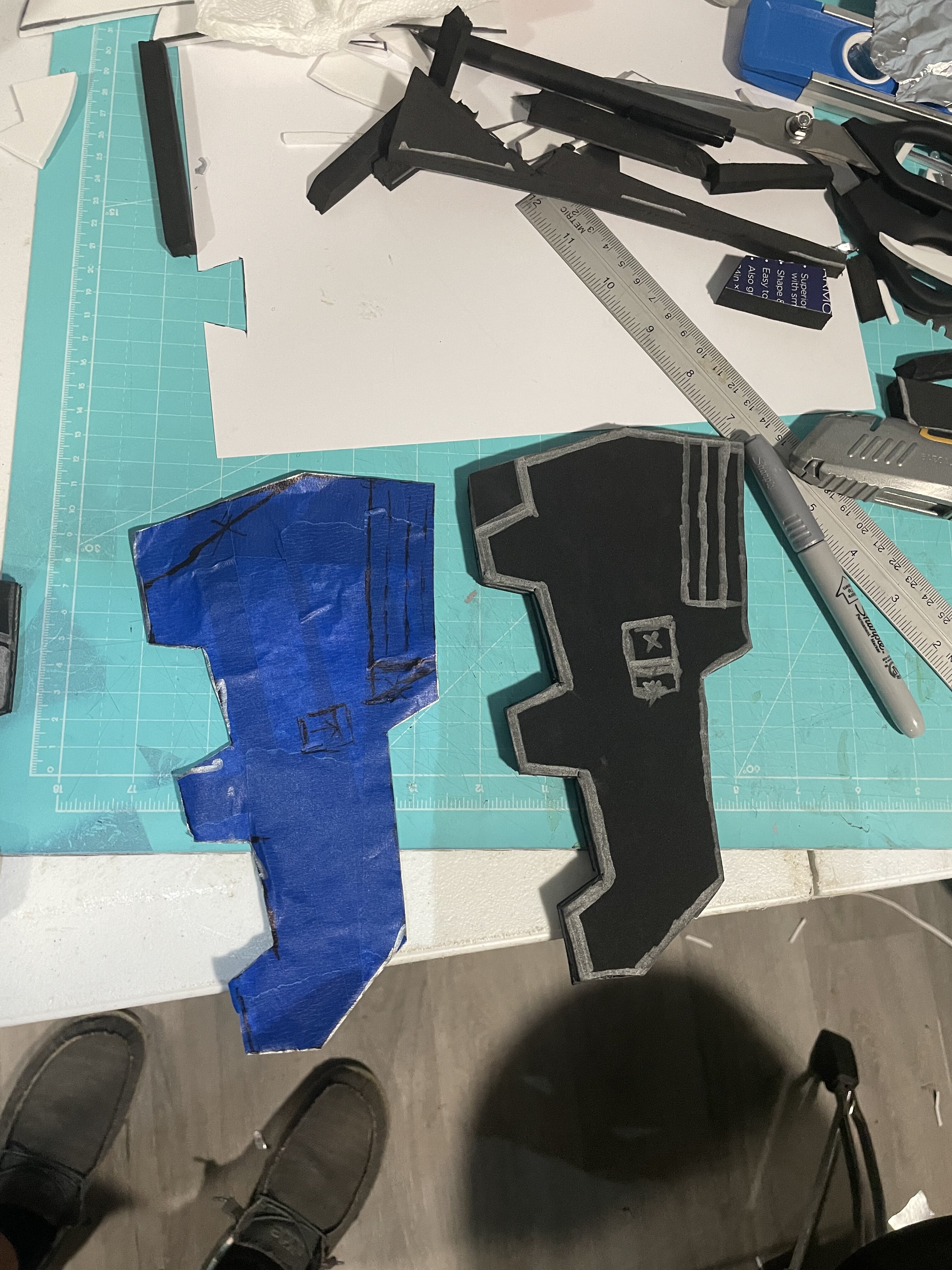

Hey guys. Got a little Sunday update for you all. It’s a little pic heavy.

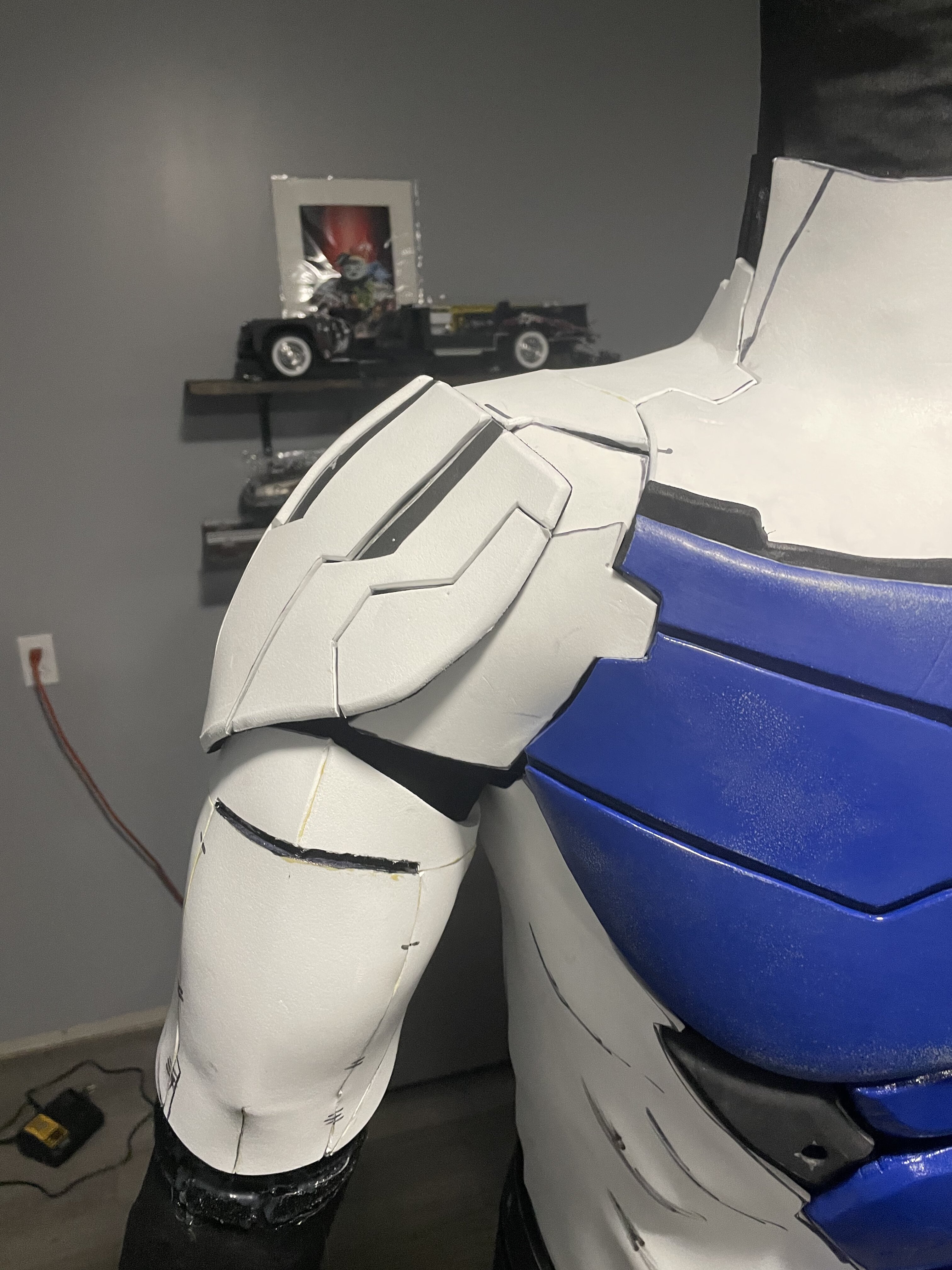

I started off by working on the neck/shoulder pieces. This will be the third time I’ve tried making them, and I’m finally happy with it.
I then moved onto the “arm pit” pieces.

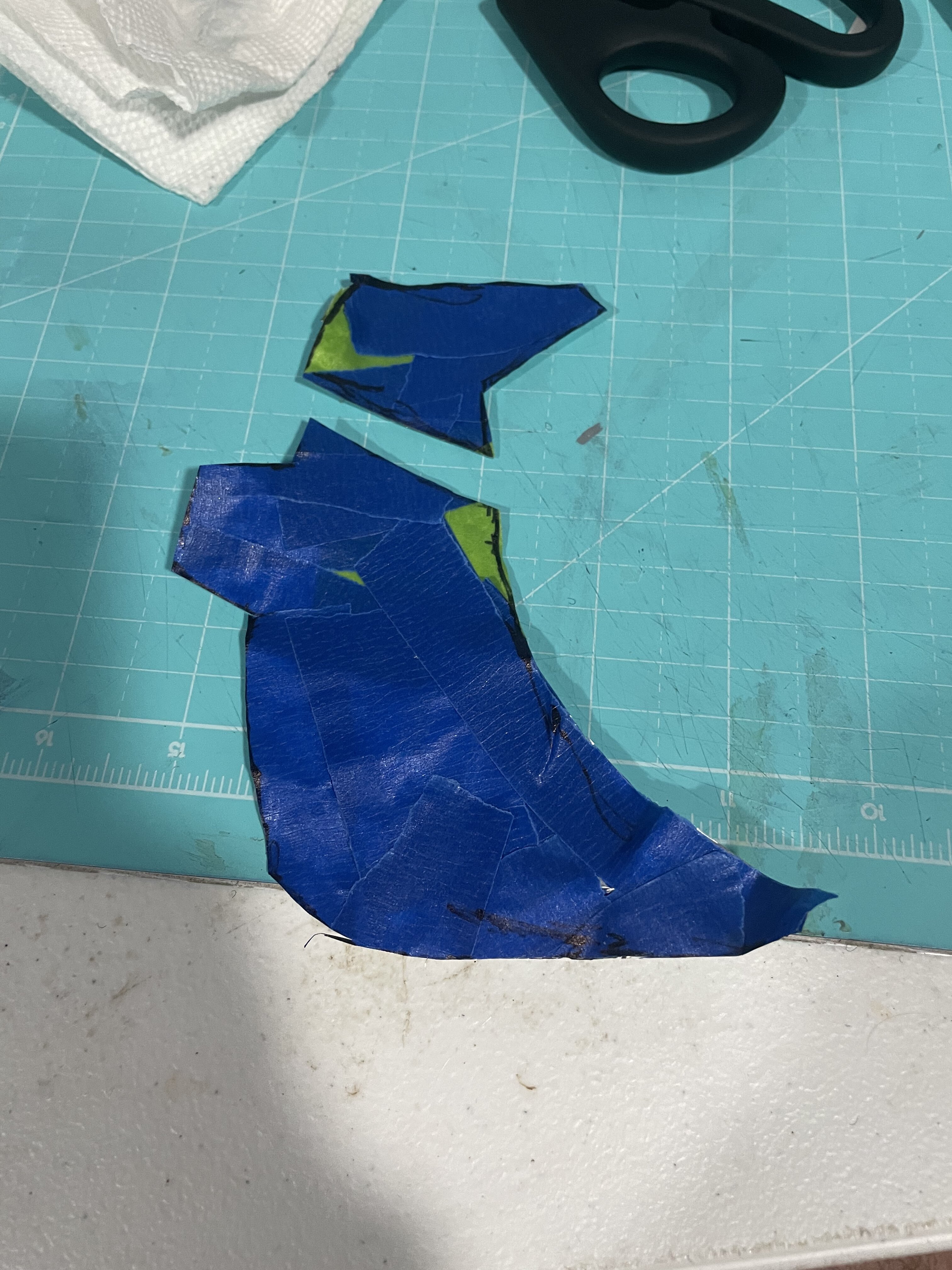

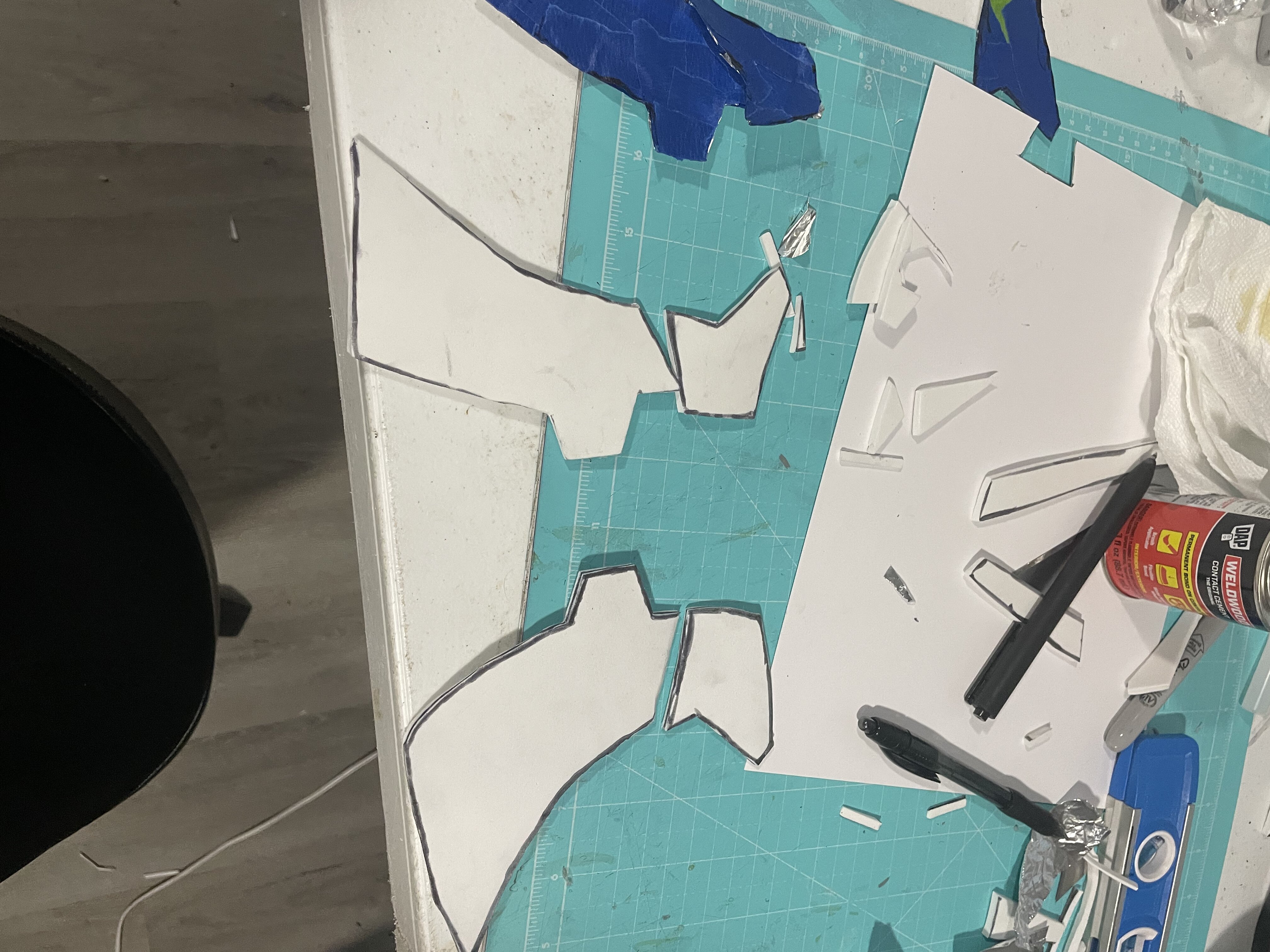

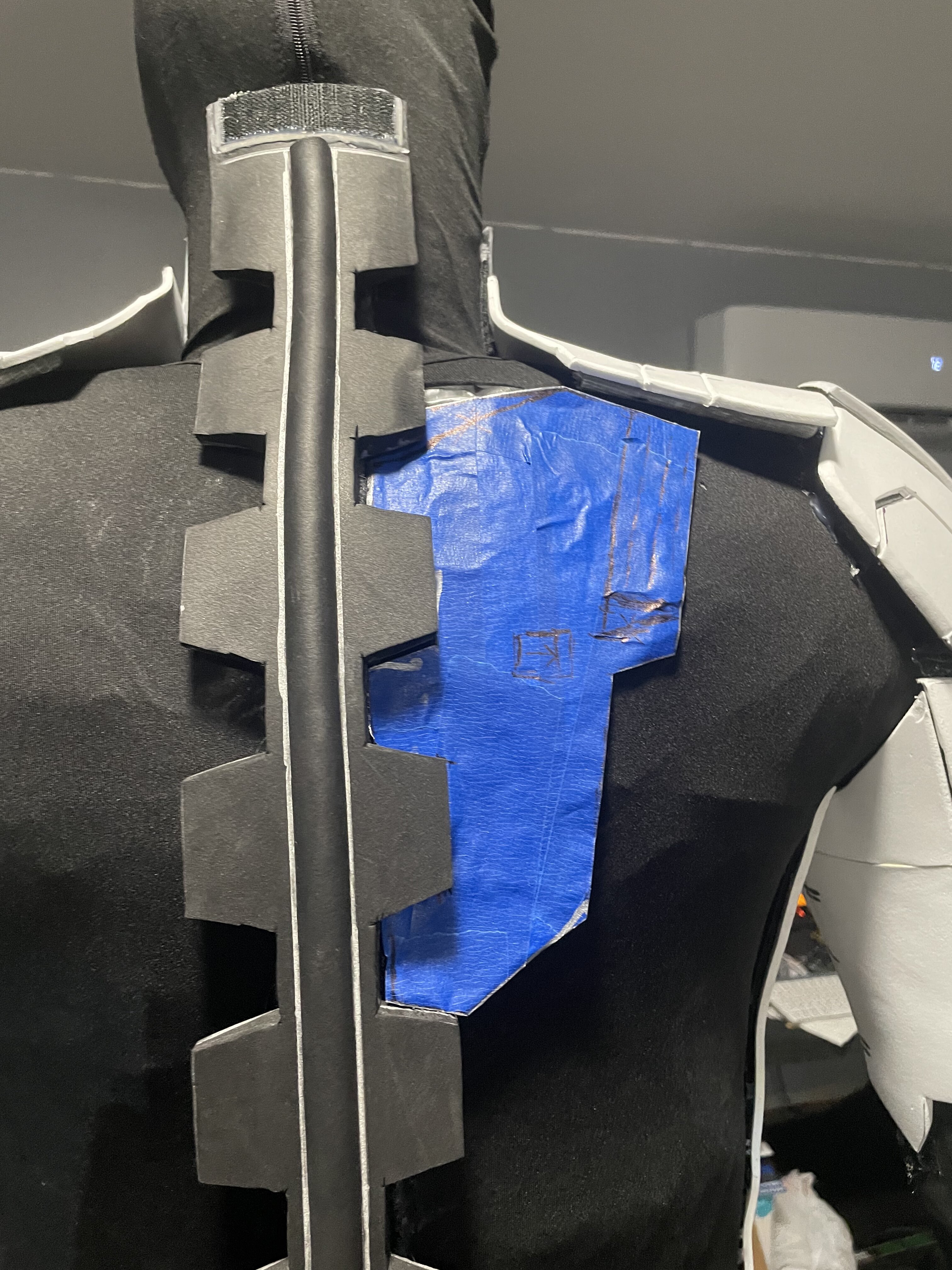

I still have 2 more pieces to make to fill that void. I then moved onto the first of the back plates. I started off with my tried and trued tape and foil template.
I plan on continuing the back plates throughout the week. It may a few days before I update again, as I have some yard work to tend to, but let me know what you guys think. I appreciate any and all feedback!

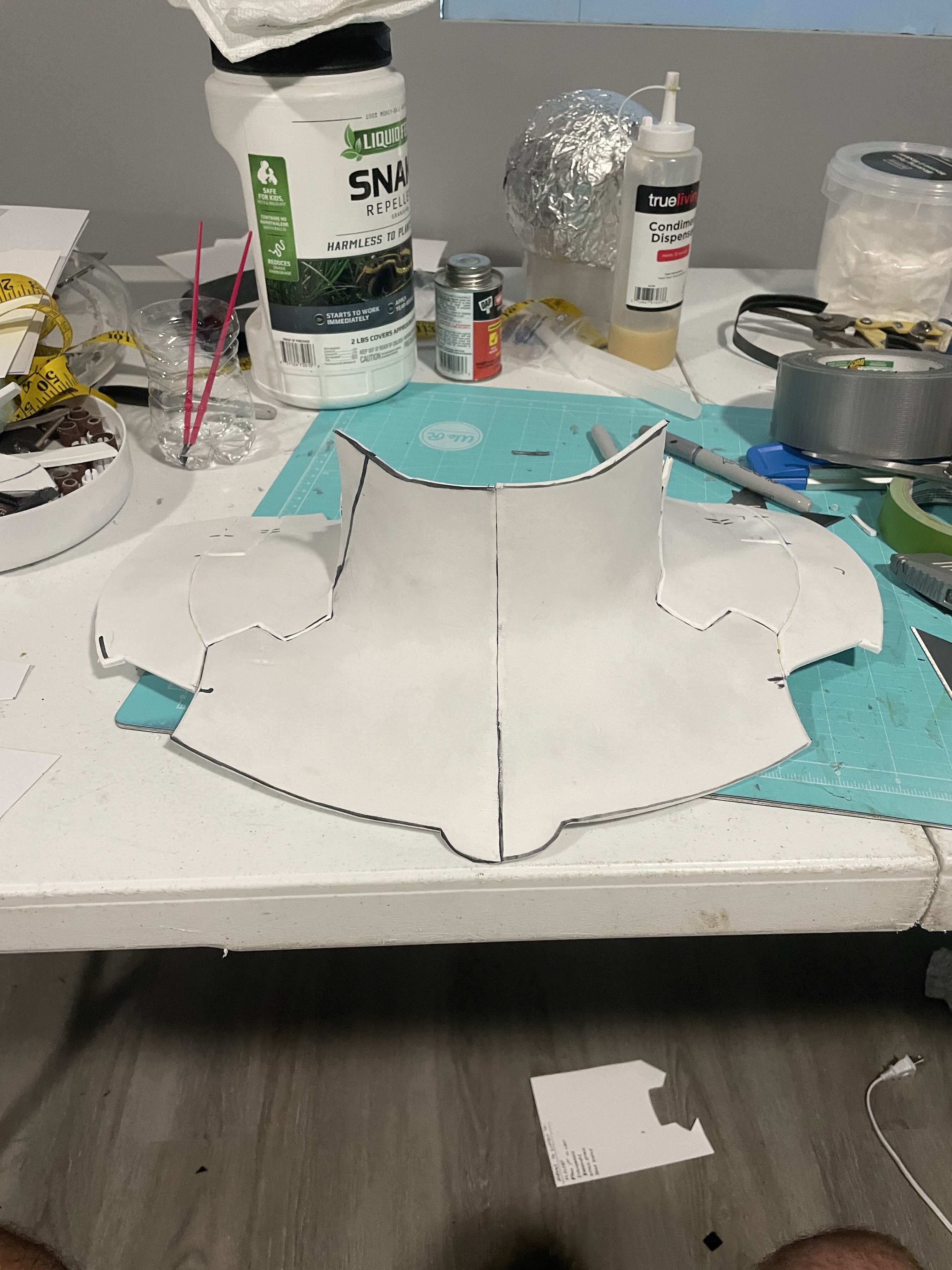

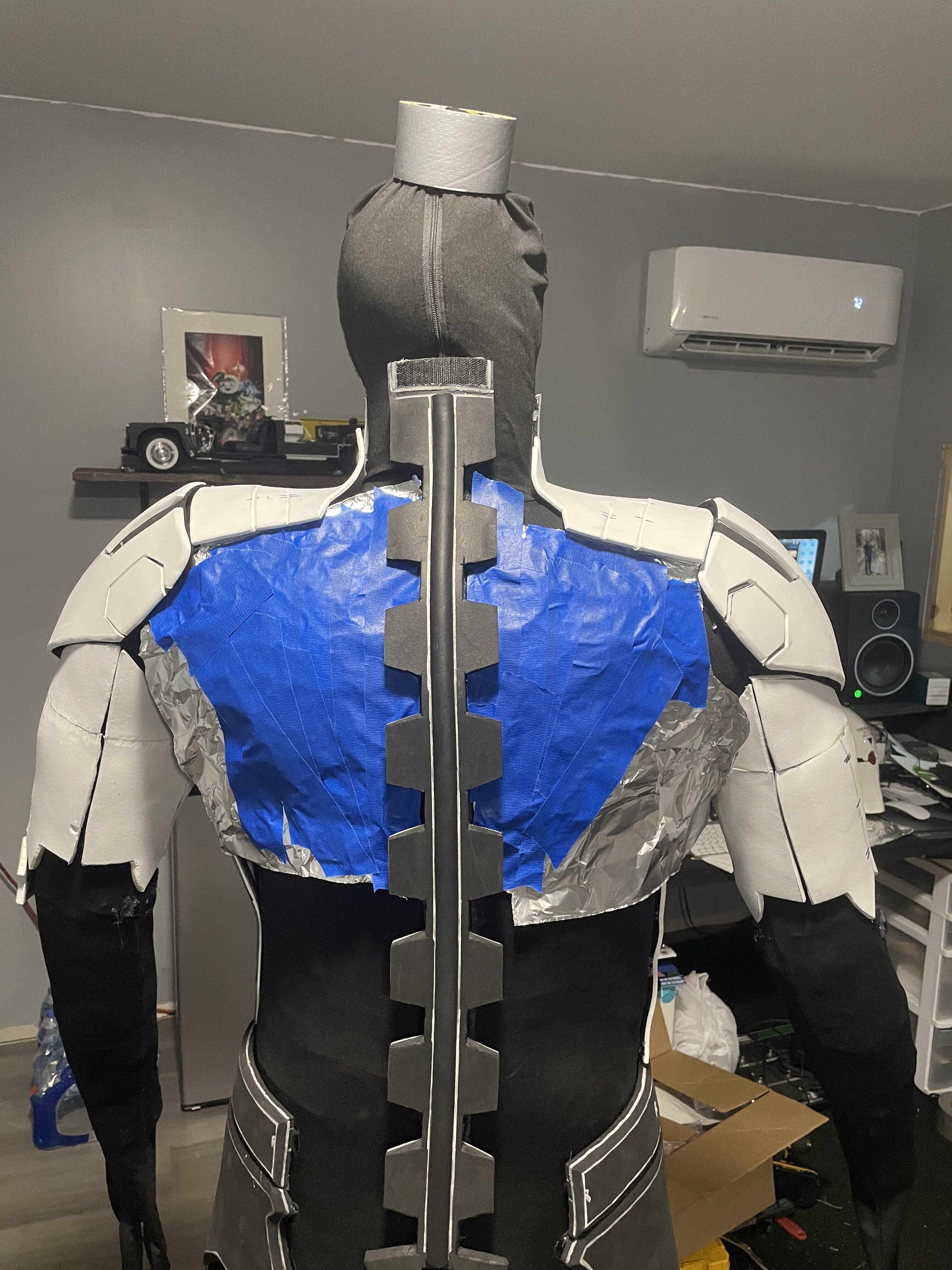

I started off by working on the neck/shoulder pieces. This will be the third time I’ve tried making them, and I’m finally happy with it. View attachment 1617977
View attachment 1617990View attachment 1617992
View attachment 1617999View attachment 1618000View attachment 1618001View attachment 1618002
View attachment 1618004View attachment 1618005

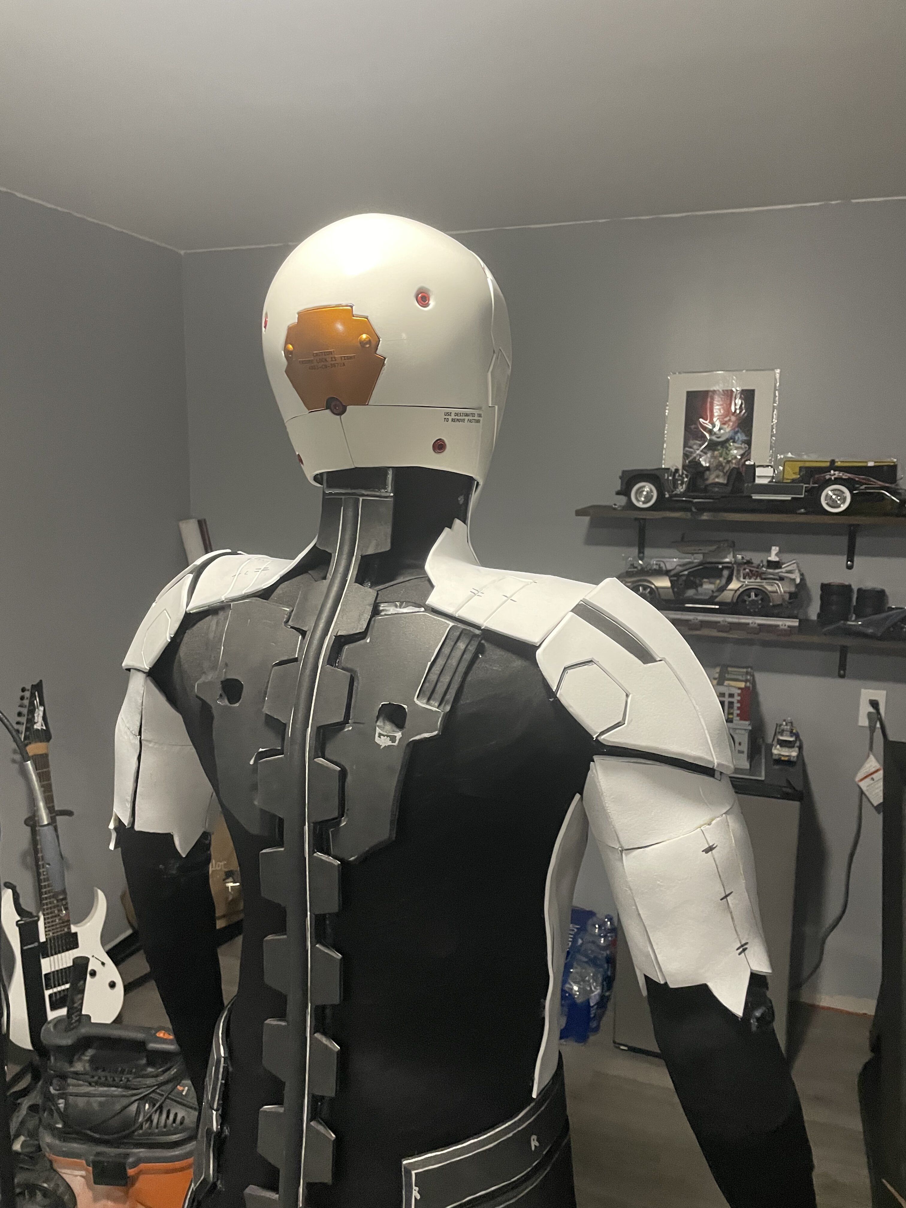

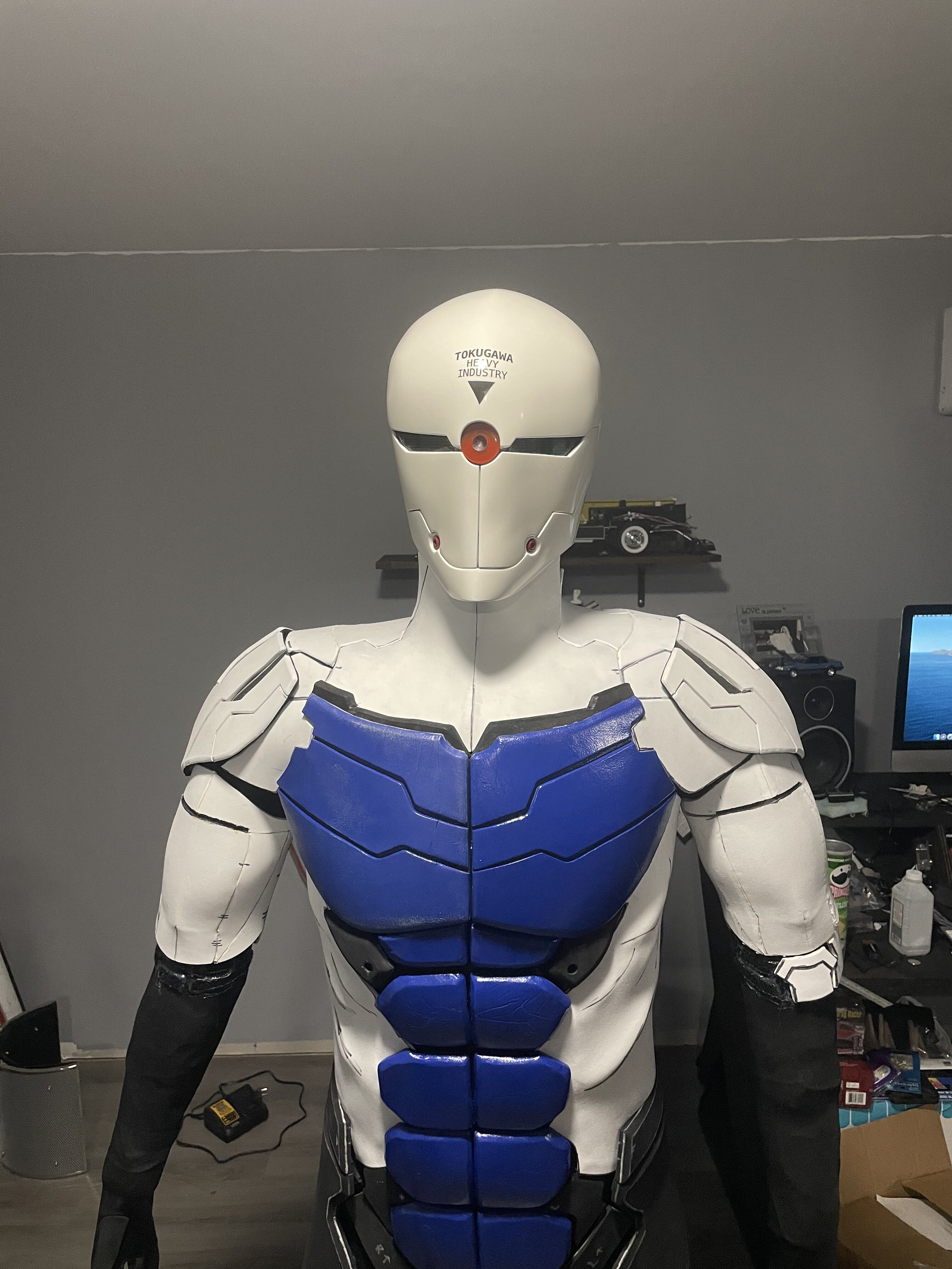

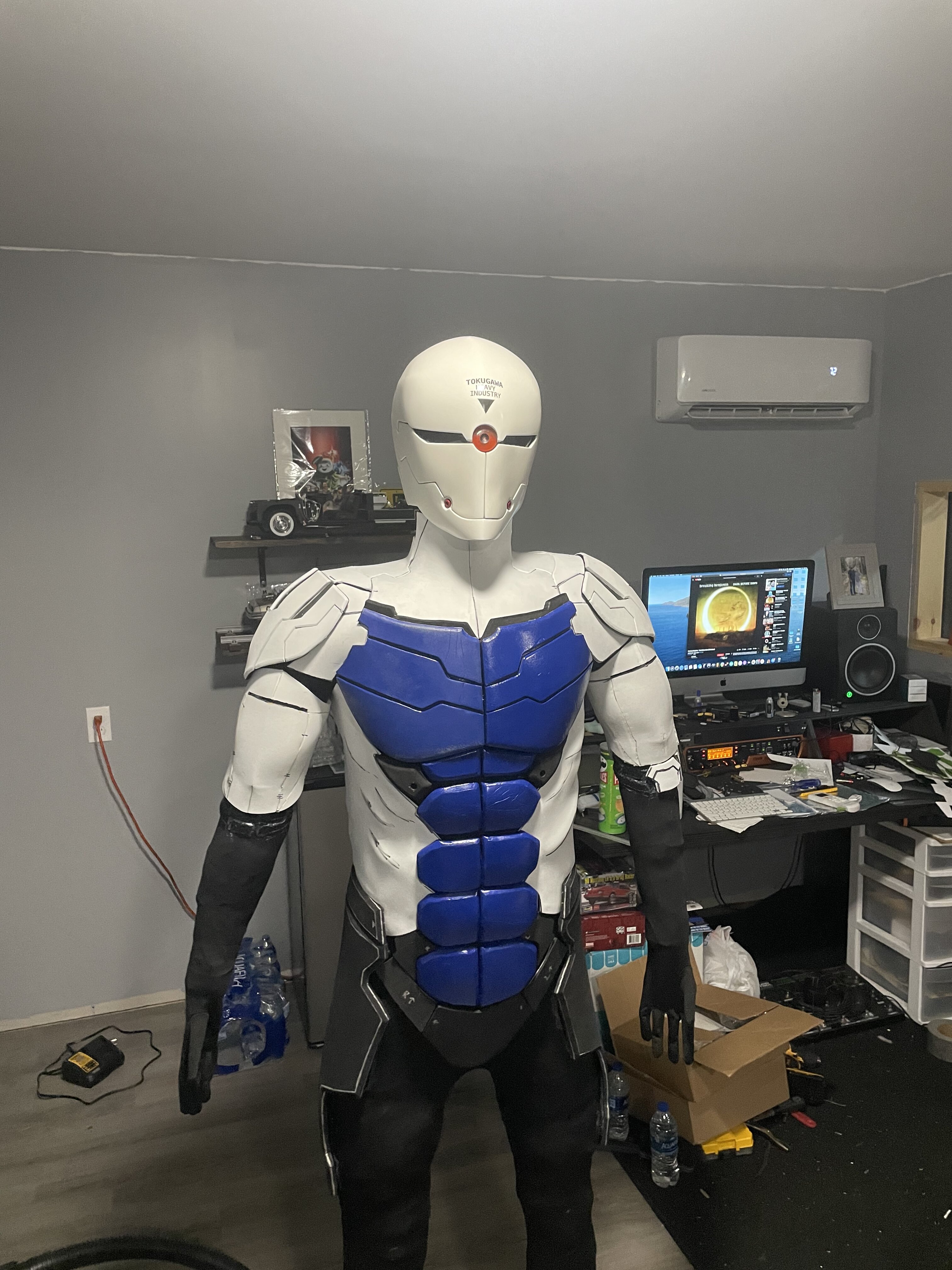

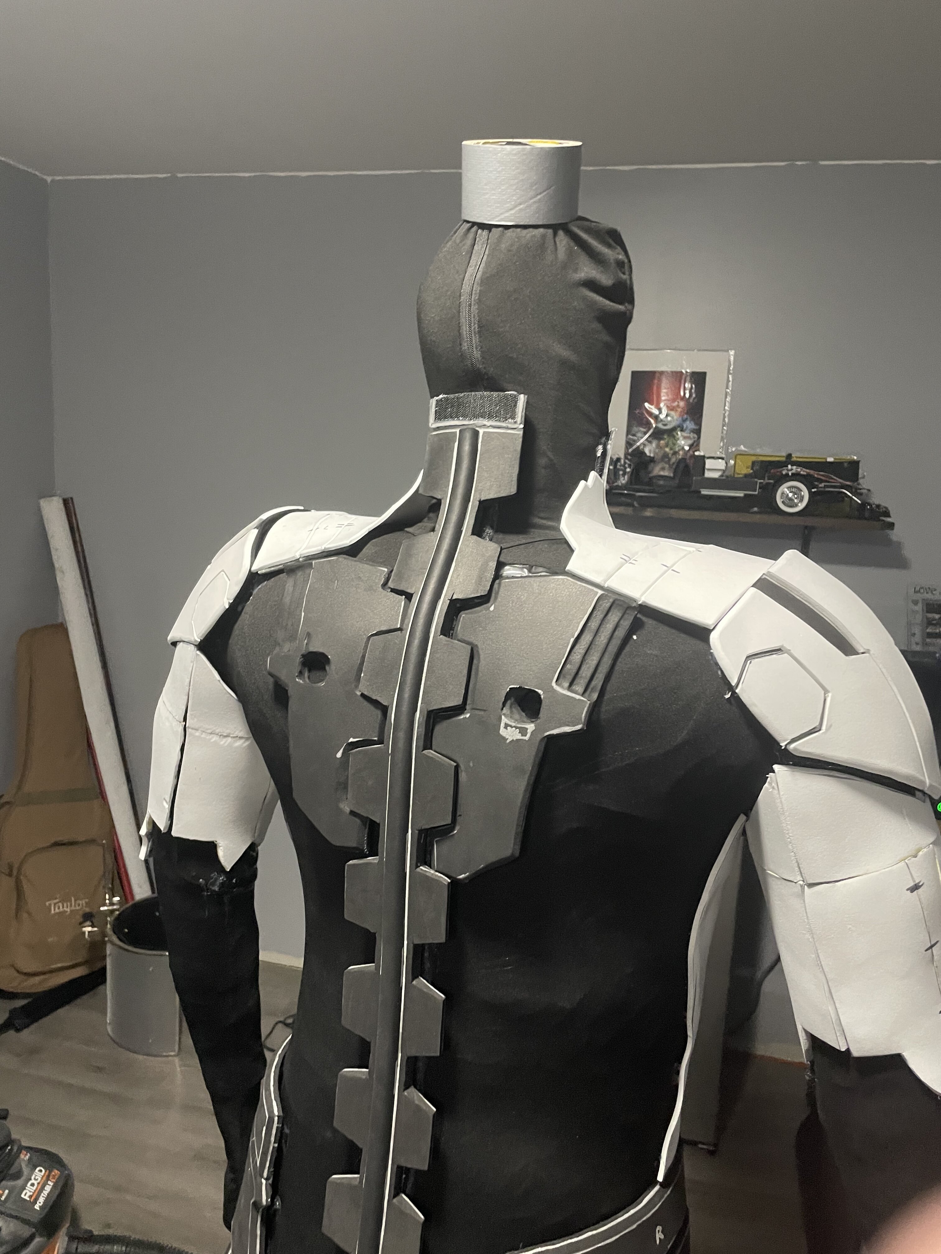

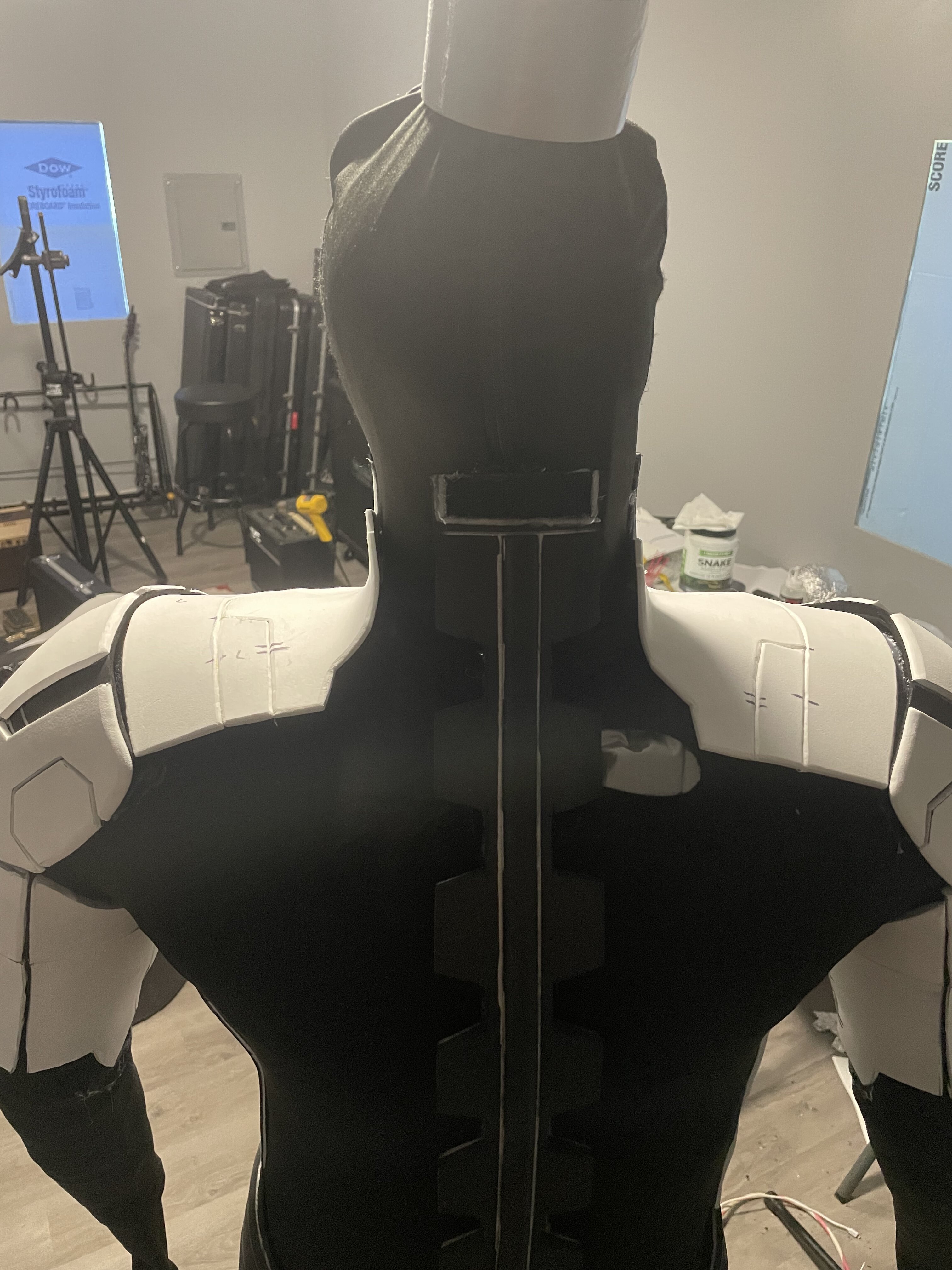

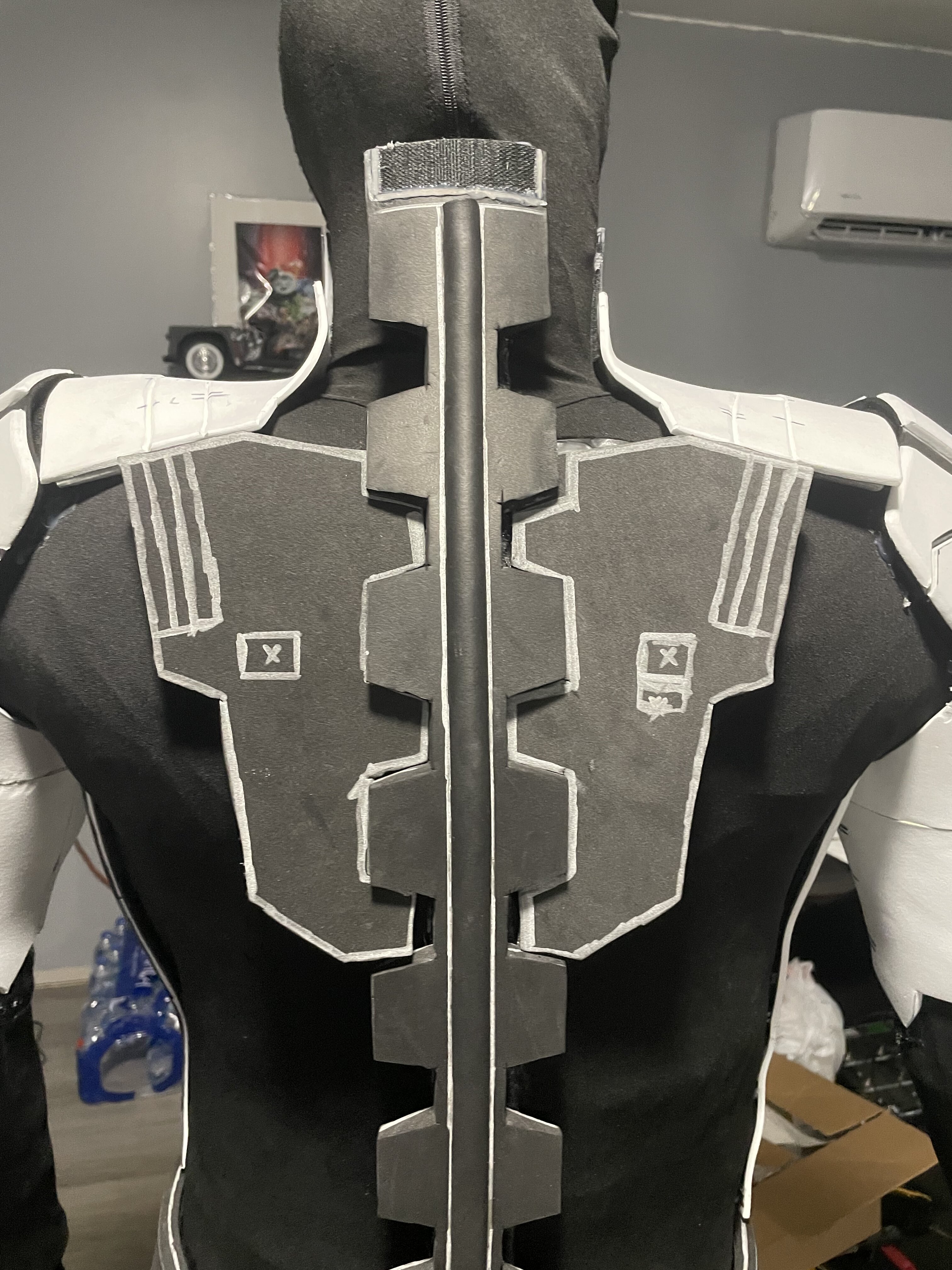

Hey guys. Sorry I didn’t make an update post this past Sunday. I honestly didn’t get a lot done over the last week. I went in with a lot of ambition, but ended up deciding to remake a few things. I did attach Velcro to the rest of the neck and shoulder plates, and they laid down nicely. The spine, as bad as I didn’t want to accept, was too short. The tailbone end would just be too high and the whole thing needed to move upwards. So, I started remaking it roughly 1.5” longer. That also means the back plates I also made will be positioned differently, so those are getting remade as well. They weren’t entirely correct to begin with, and really bothered me. I really wish I could have bought one of these figures when they were affordable. I’m gonna try to have an update next Sunday worth showing.

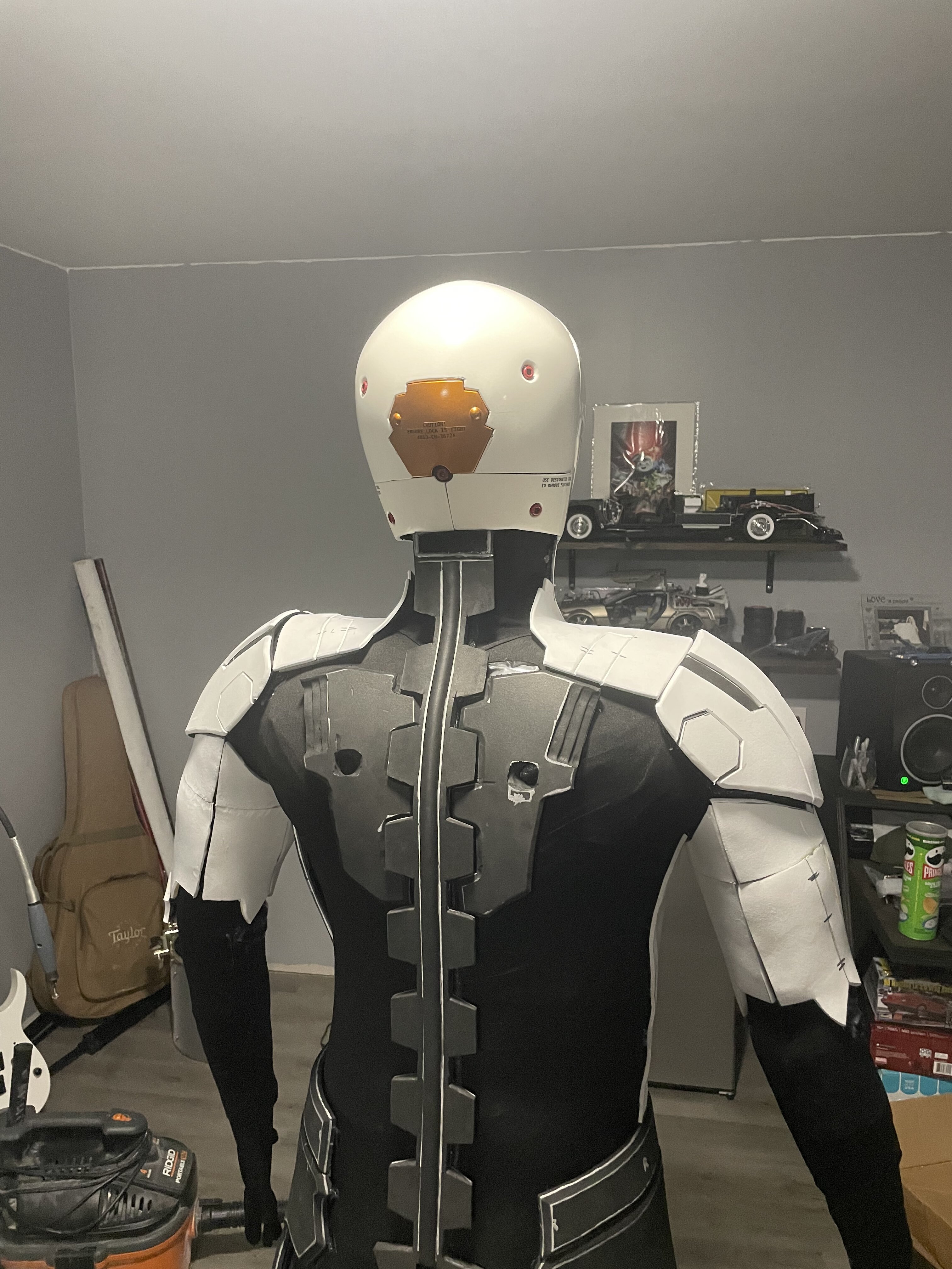

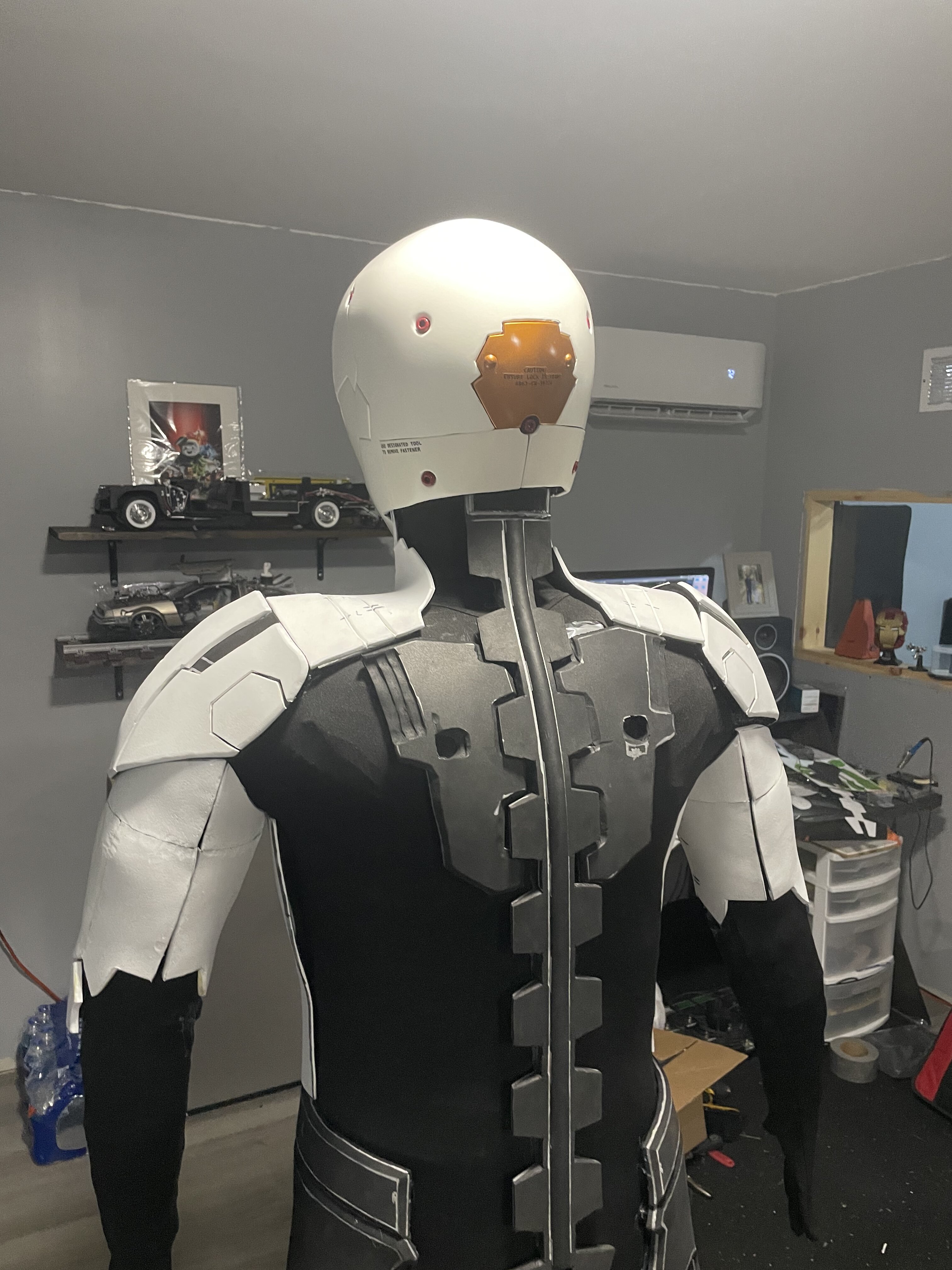

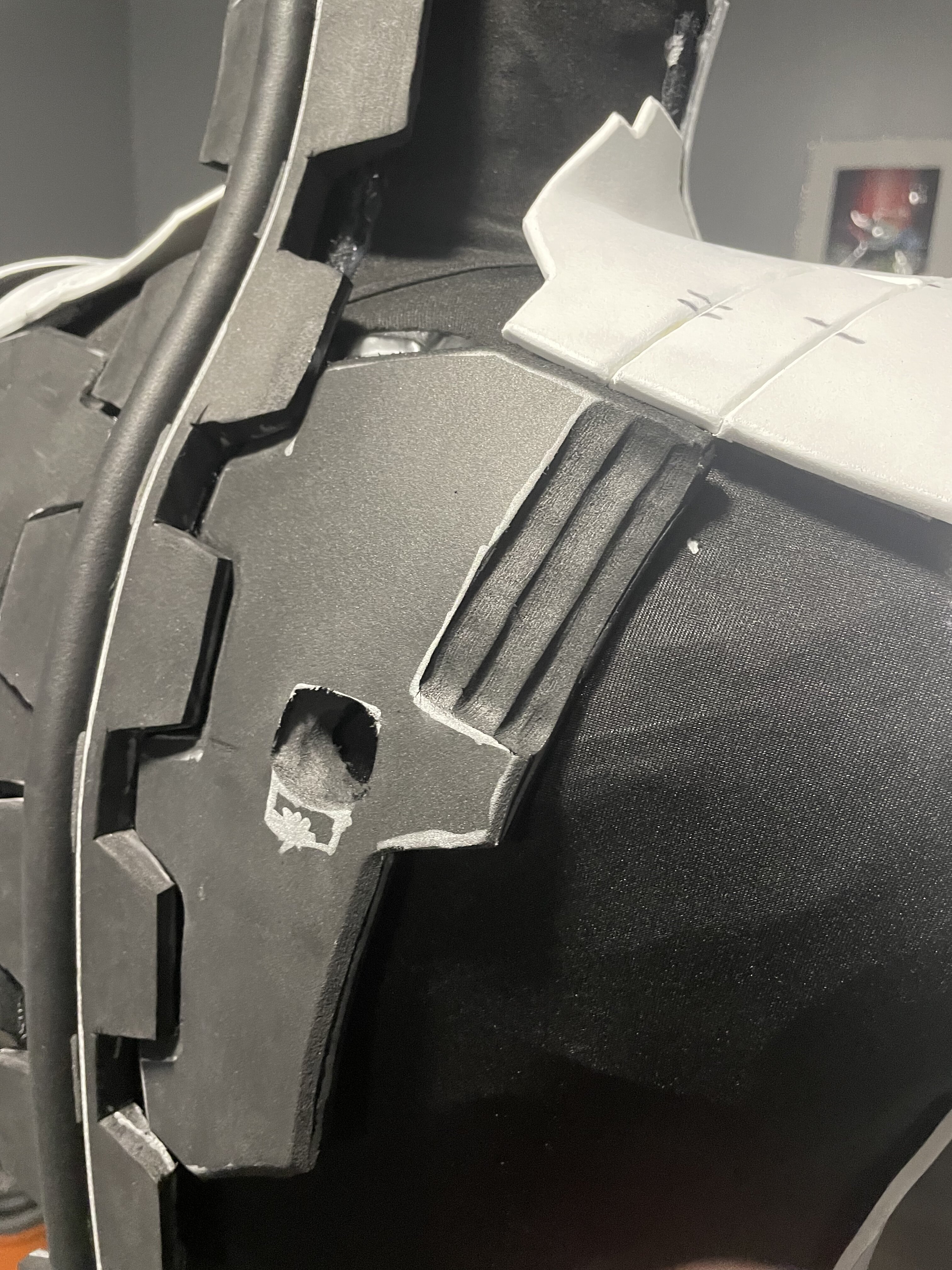

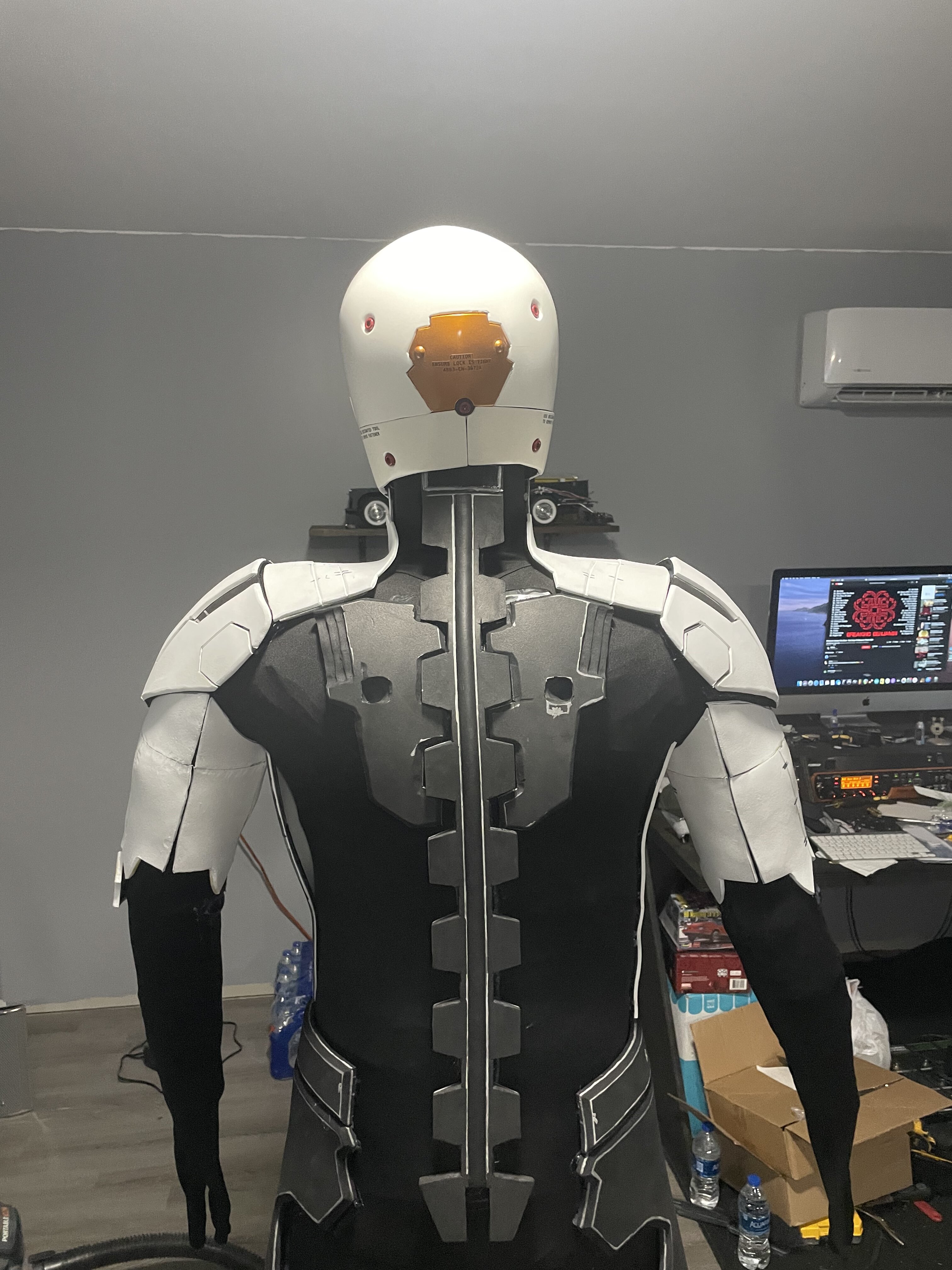

Thanks everyone for the encouragement, as always. Remaking some of this stuff is only a minor speed bump. I had about an hour and a half to work on it last night.

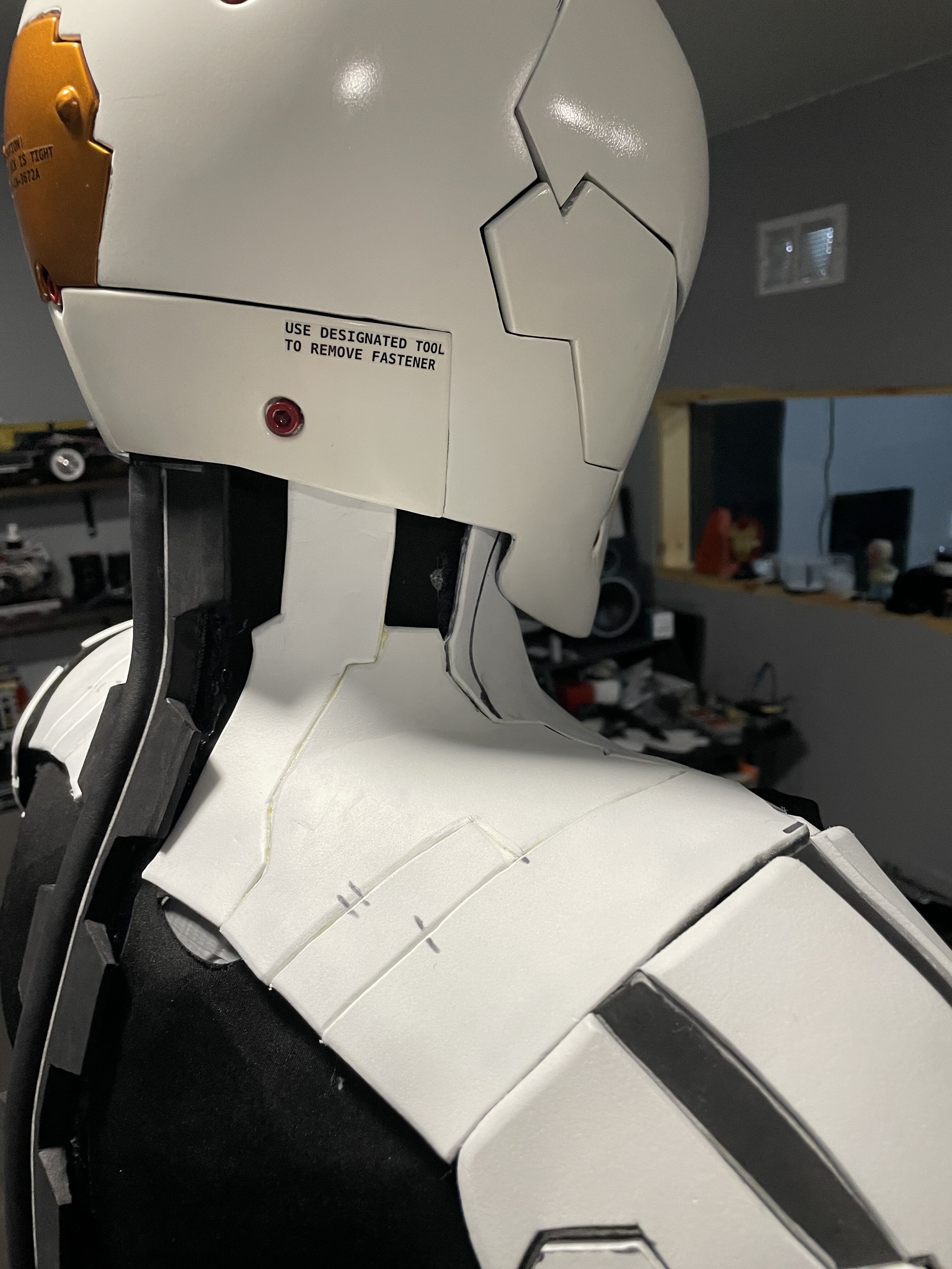

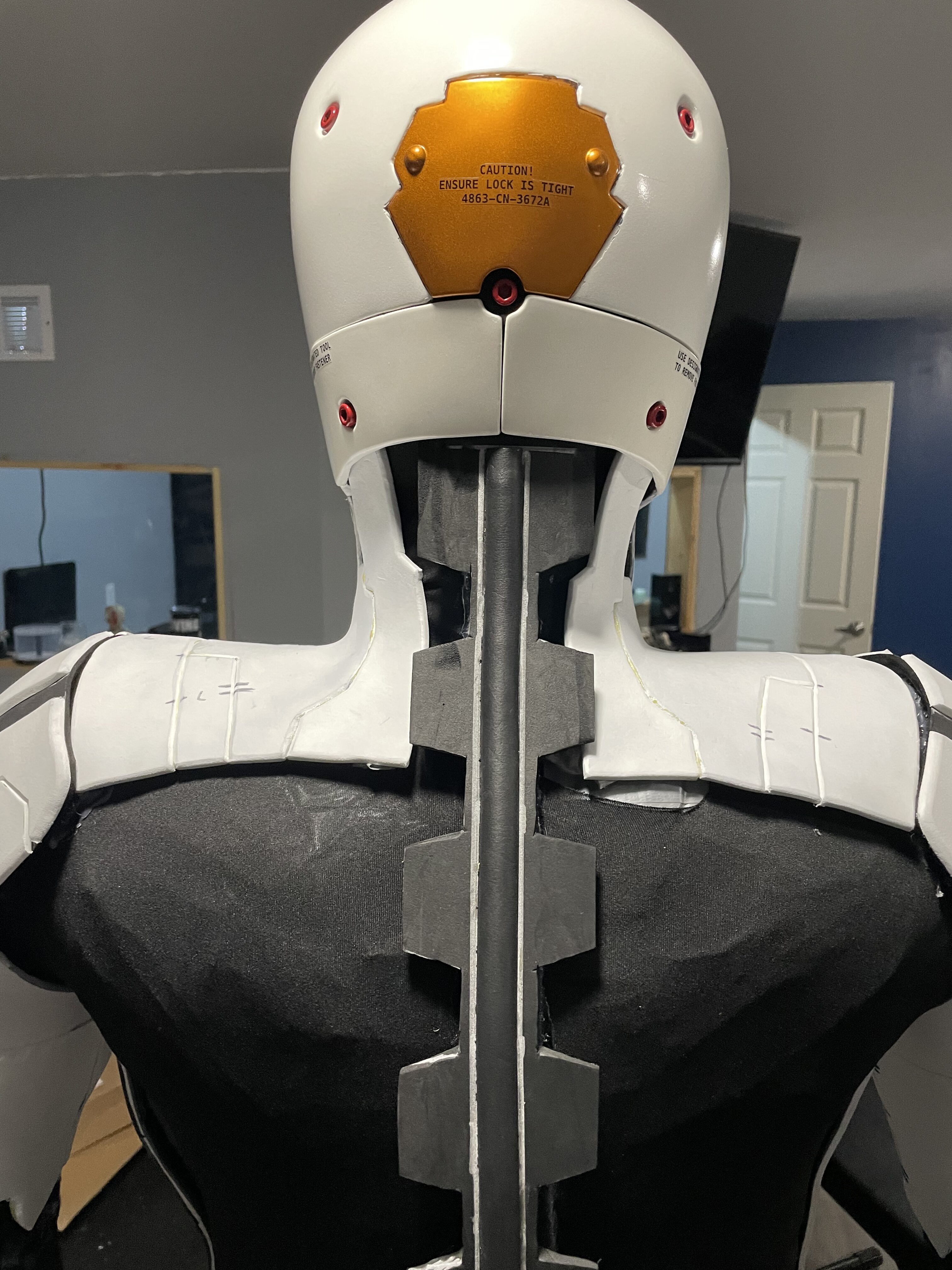

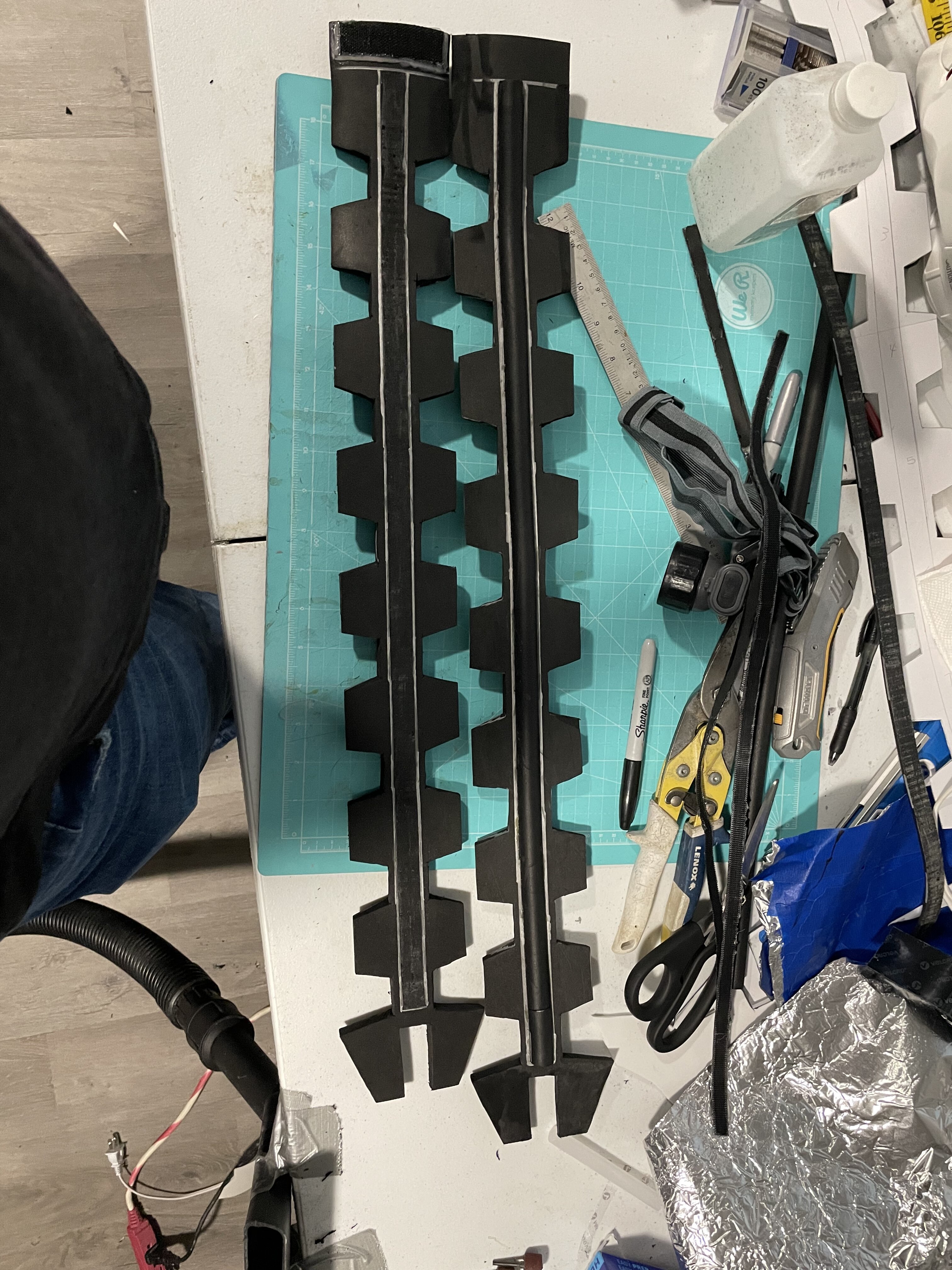

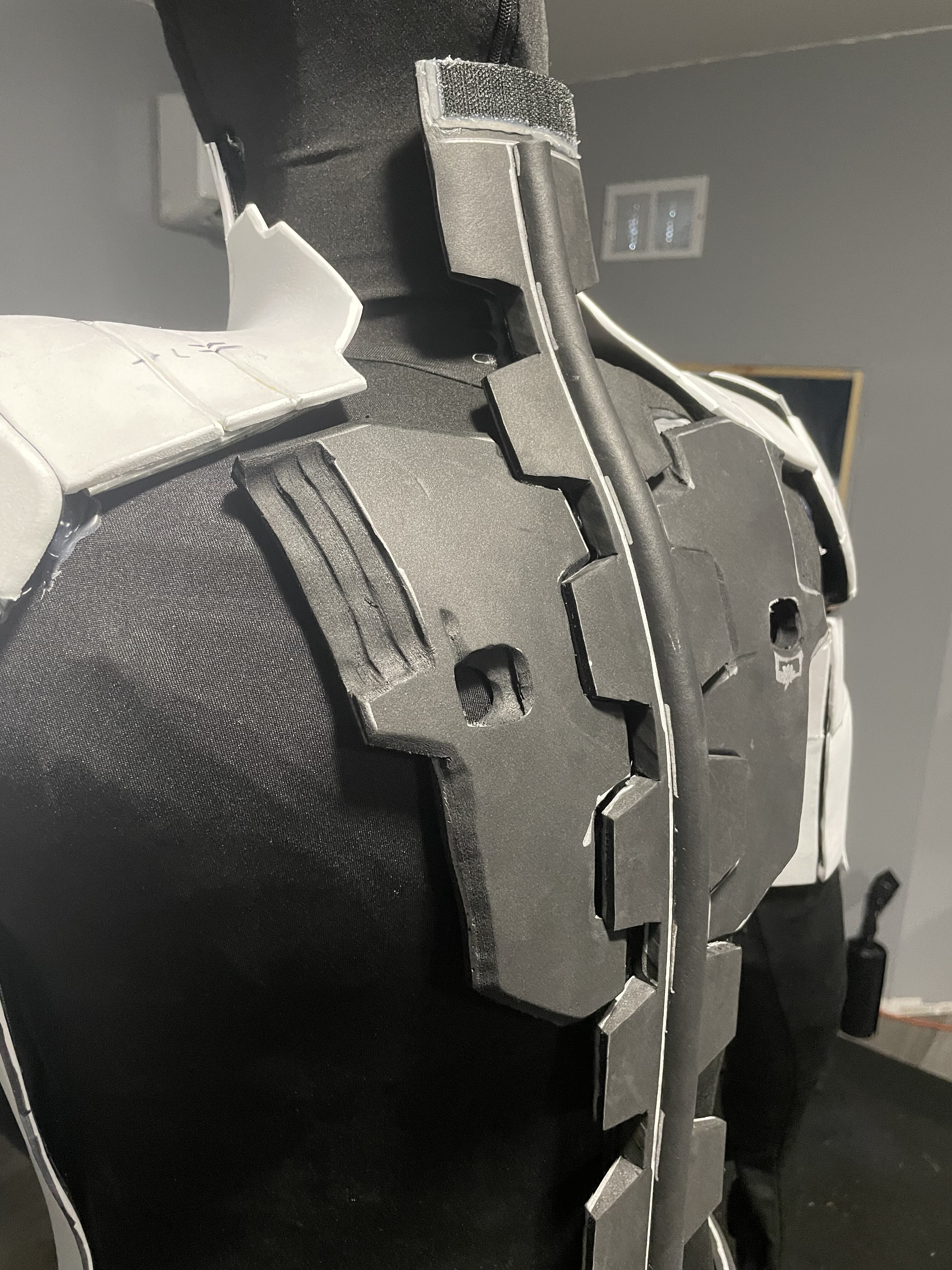

I got the rest of the backside of the vertebrae on the new spine beveled, and attached the Velcro to it. As you can see, it’s slightly longer than the previous one.

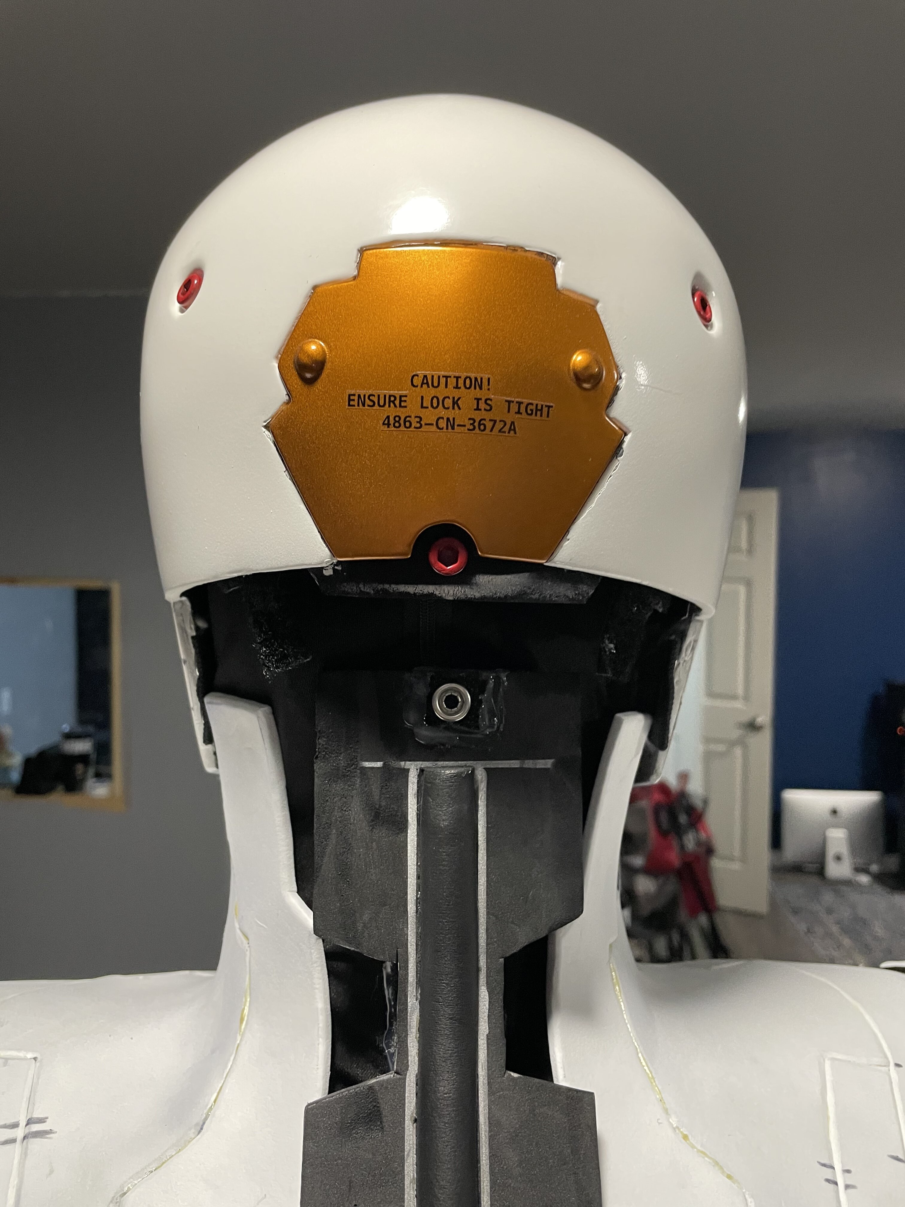

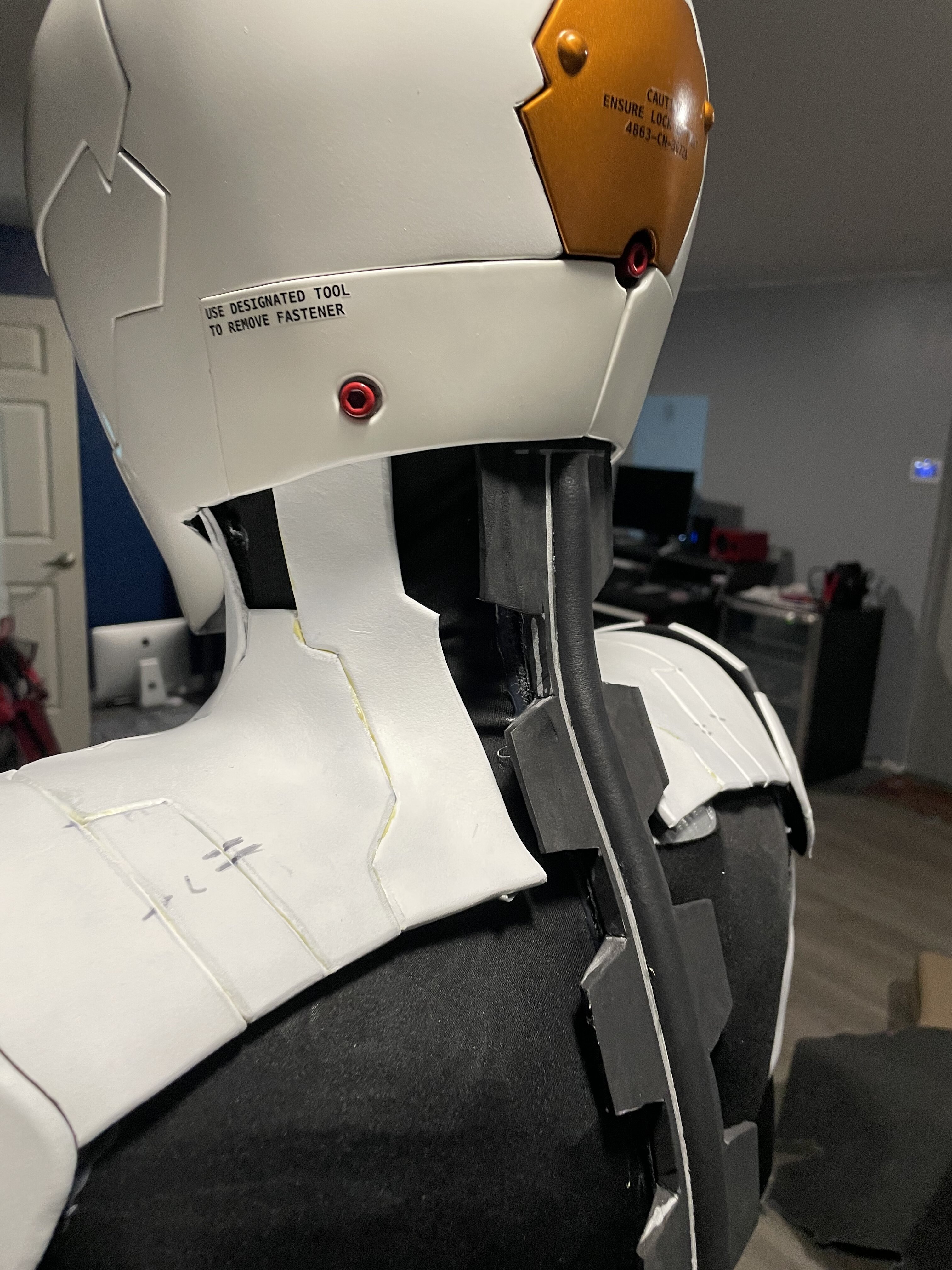

I also started making a couple of the last remaining neck pieces. The neck has been quite a challenge.
I made a change to this spine at the top where it tucks under the helmet. I used a single snap button instead of Velcro, so that the spine can pivot when I turn my head. I’ll attach the other side under the back cover. The source photos show this movement as well.
I still have some heat shaping and tweaking to do, but it’ll have to wait till Sunday. I’ve still got to Flex Seal most of the pieces, and do some beveling on the outside edges. I really want to wait until the full suit is built before making it perfect, in the event I gotta remake more pieces. I’ve been doing some searching for some of the other components I need, such as gloves and boots. I believe I found some gloves that will work with some modifications, and boots on Amazon that look very, VERY similar to the reference photos. I appreciate everyone’s kind words in the last few posts. You guys keep me motivated. I’ll update again hopefully on Sunday. Thanks!
