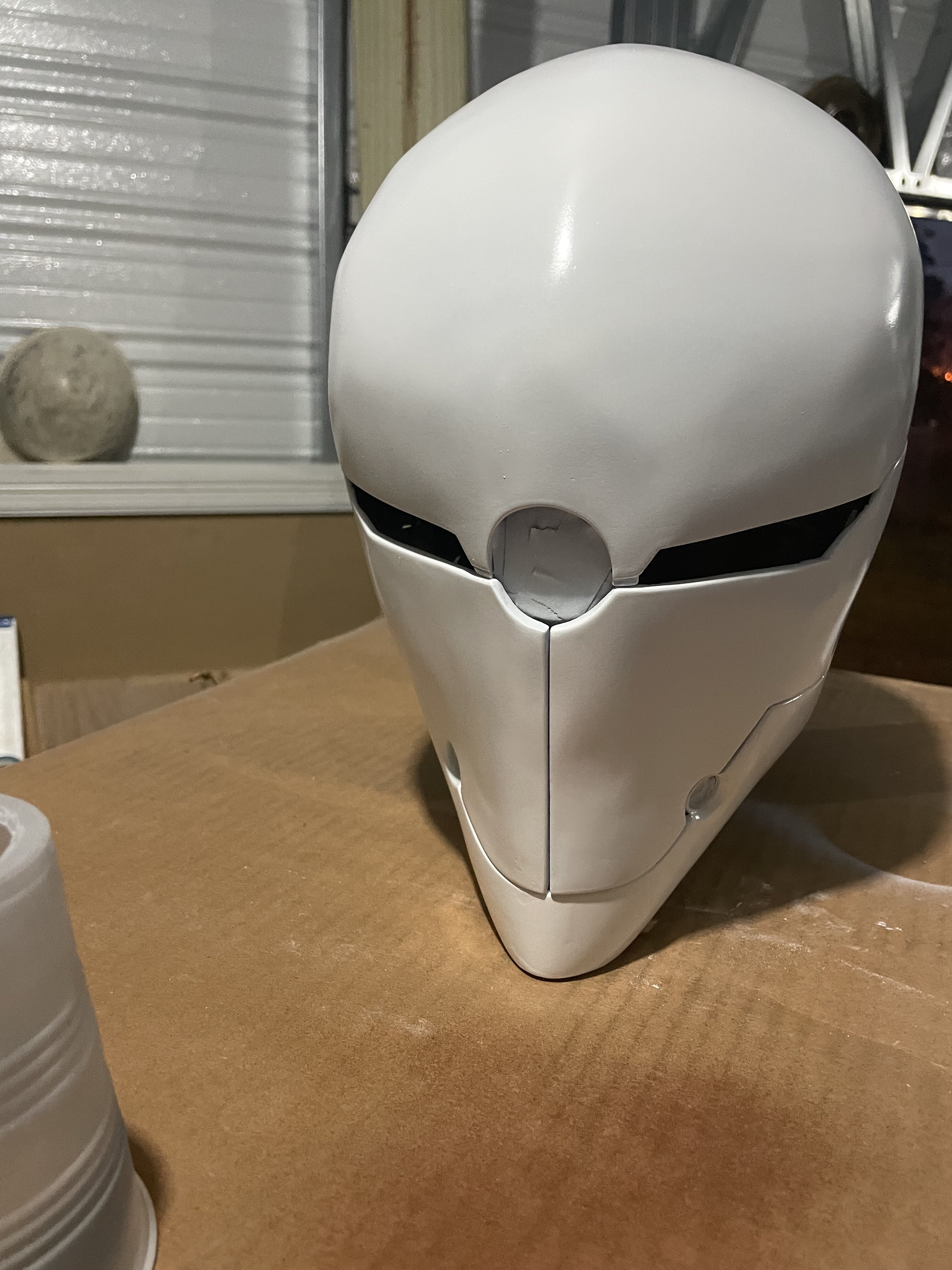

Morning everyone. I didn’t get a chance to add anymore coats last night, but I did have a few minutes to roughly fit it all together. I am so pleased with how it’s turning out so far! Im glad I doubled back and fixed the panel gaps. Thanks to all who stayed on my butt about it! There’s a few spots that need some attention, but one more coat of base should do it. I plan on doing that tonight and getting my decal supplies tomorrow or Saturday. Paint should be cured enough by then I hope, so Sunday I’ll hopefully apply decals and clear coat.

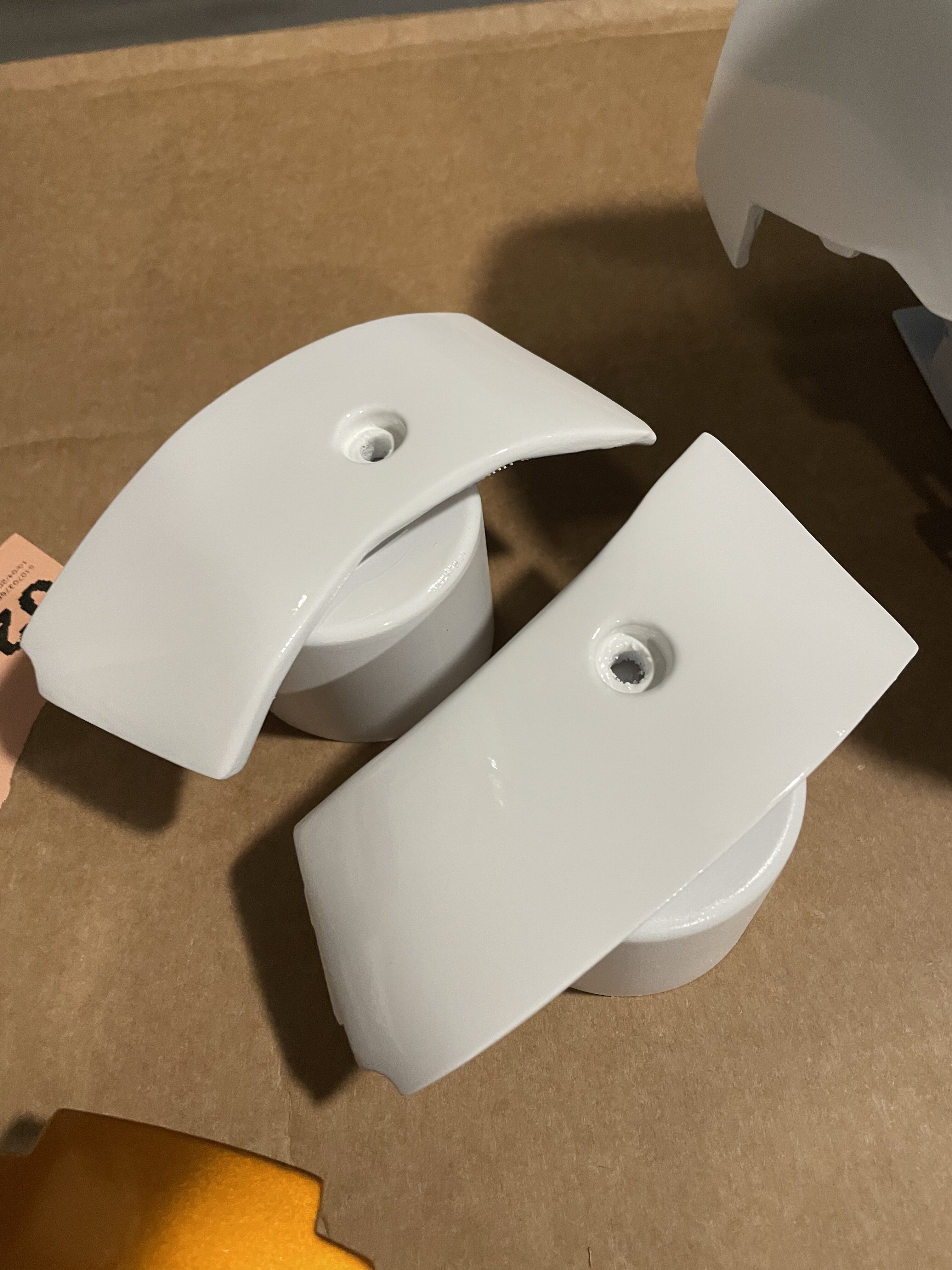

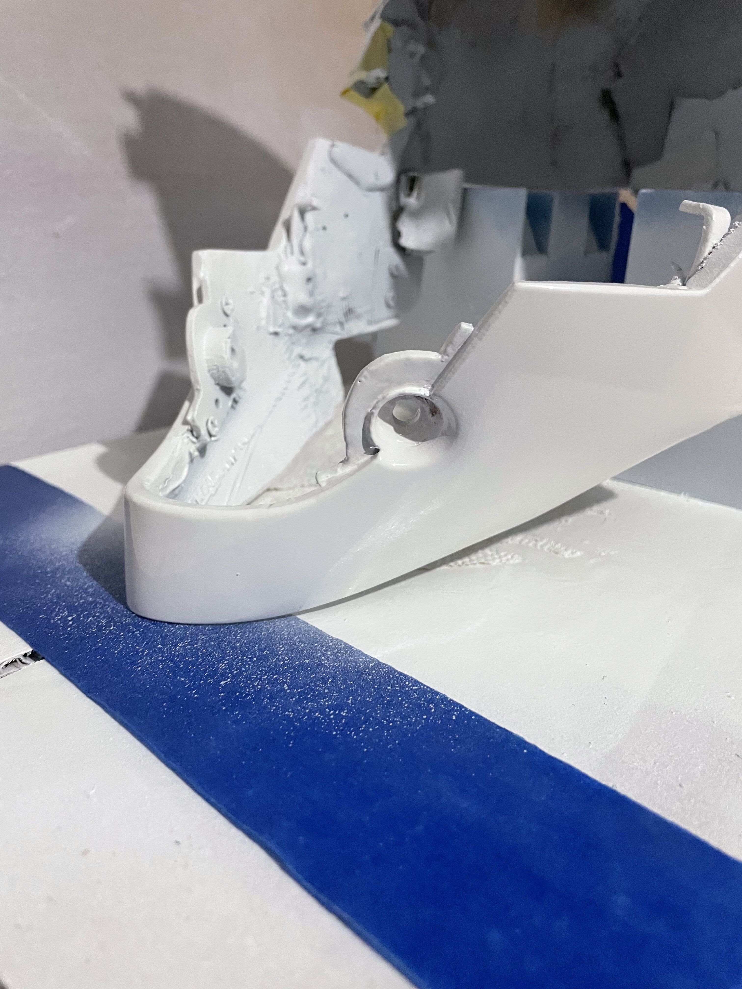

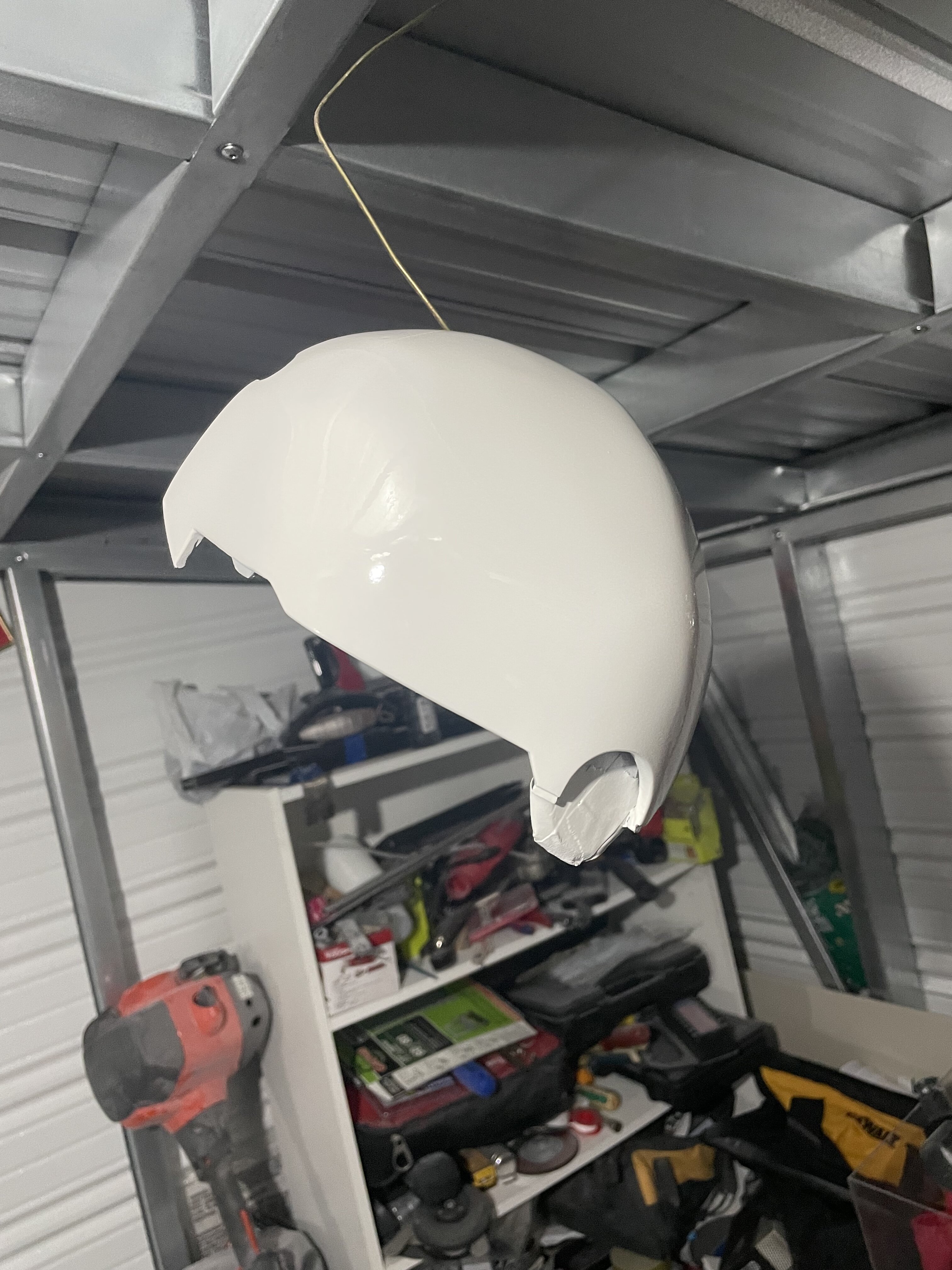

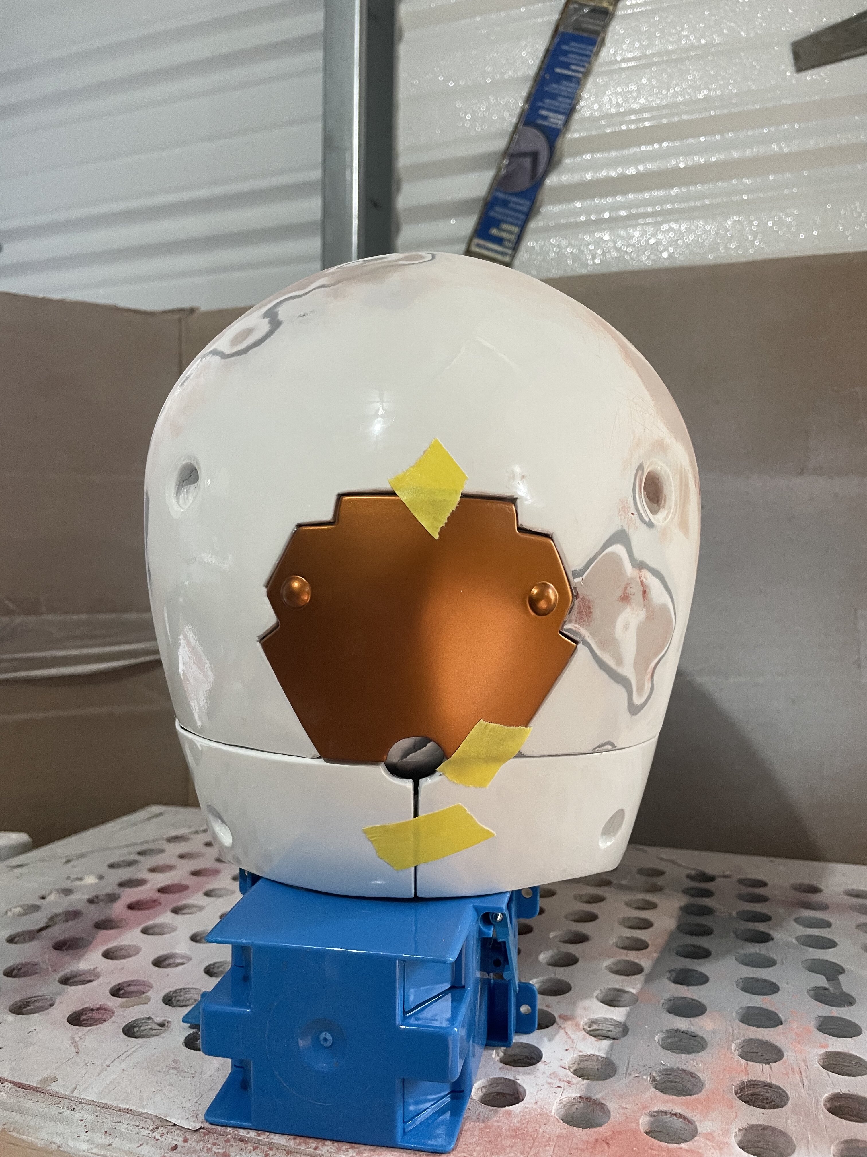

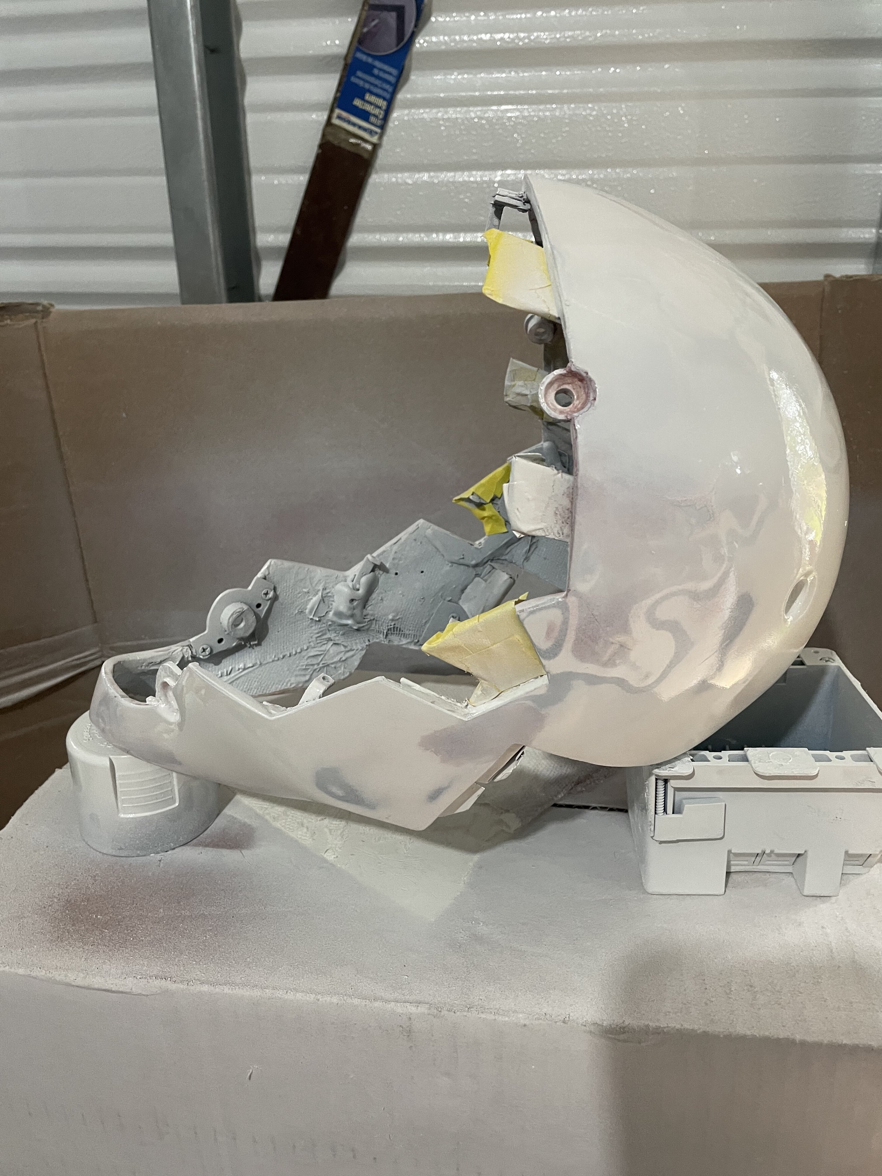

Hey guys. Dropping a Sunday night update. Since my last post, i continued painting. However, coat number 2 had an awful showing. That nice, smooth, level first coat was followed up with this wrinkly mess:
I used the exact same paint as the first coat, only sanding a couple small runs out and knocking down some fuzzies. This happened within a couple minutes of applying the coat. The first coat was dry by a couple days. I had never seen this mess before using spray paint. I had also painted all of the red Allen head screws for the sensors. I had to install them in the sockets before I repainted the whole helmet. I am STOKED at how well they turned out and how they look installed.
After checking that out, I sanded everything down heavily and tried one of the smaller pieces again, this time with a different gloss white paint. Same thing. I even wiped the piece down with mineral spirits to ensure there was no oil, sweat, anything on it. Turns out, it was too heavy of a coat. The lighting in my work space isn’t that great, so I didn’t realize that was the issue at first. The next piece I did with a very light coat and had MUCH better results. So I continued to coat everything with many more small coats.
I am very pleased with the results. I’m gonna let this “cook” overnight and try to wet sand a few spots that need leveling tomorrow. Then I’ll apply a few coats of clear either tomorrow or Tuesday. I found some water-slide decal paper locally so I may work on that tomorrow as well. I’m just glad I was able to figure out why that paint wrinkled. I’ll keep y’all posted on more updates. Thanks guys!

Thanks! Yeah, lighter coats about 15 mins apart solved the issue. Trying to spray white with not a lot of light is kinda tough. I’ve got to upgrade the lighting in my shed. I can see the light at the end of the tunnel though. I still need to do some flat black for some of the inner pieces. Mainly where the servos go. I’m trying to think of a good way to attach the red lens to the frosted lexan housing without it fogging up or appearing like there’s a glob of something under it. Would some clear epoxy work?

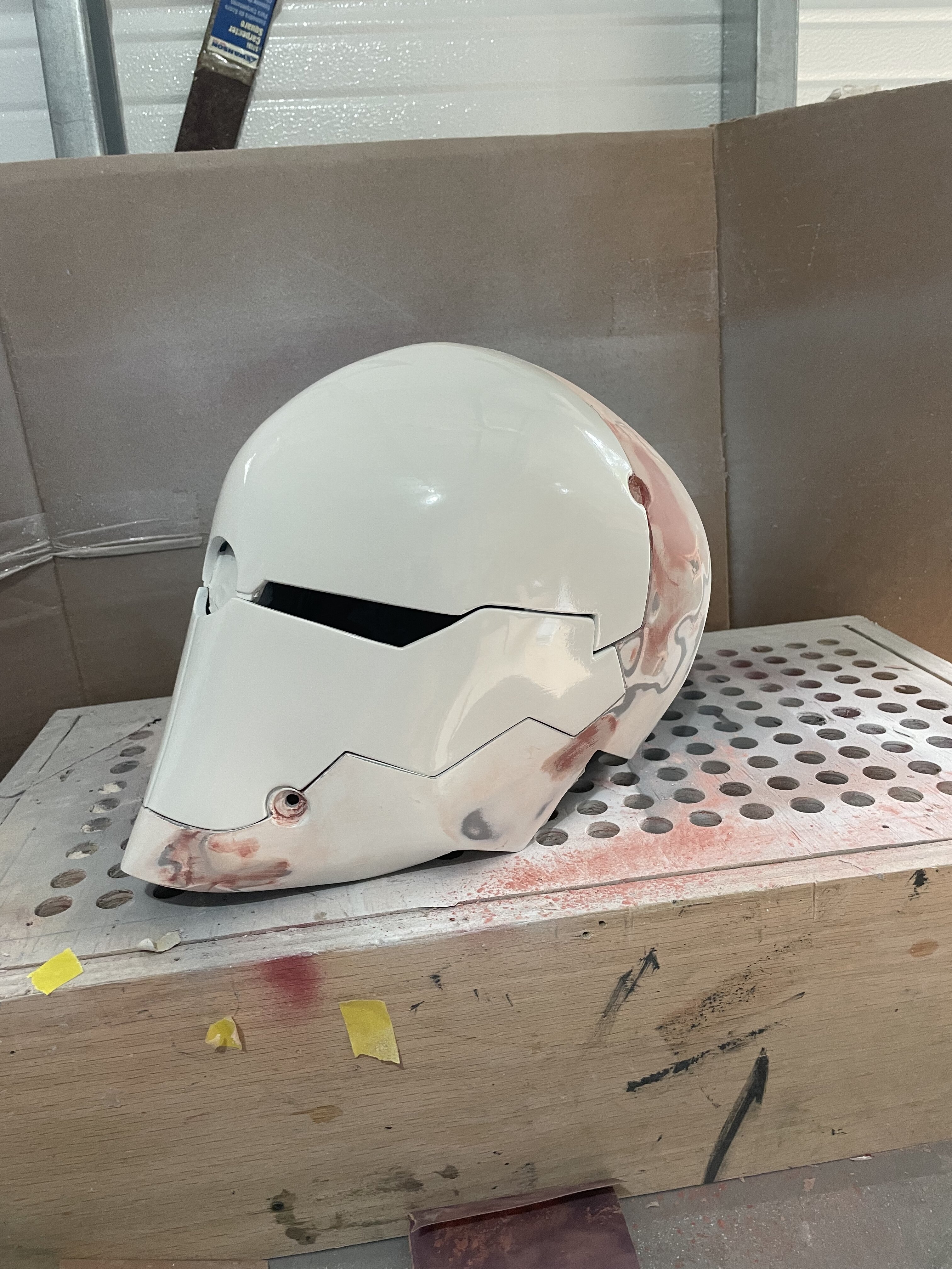

Good evening everyone. I promised updates, however, this one isn’t great. There is a silver lining to it though. Monday night, when I came out to check on the paint job from Sunday, I went into the shed and discovered that somehow, a stack of random items I had moved earlier Sunday, had fallen onto the main shell of the helmet.
I had reorganized my shed earlier Sunday and I thought the stack was good as I had been moving around for hours earlier while painting and nothing wobbled, or fell, or showed any indication of toppling over. I don’t know what caused it to fall over but it did. It was an oversight on my part to not move the main piece of this now 6-month long project out of potential harms way.

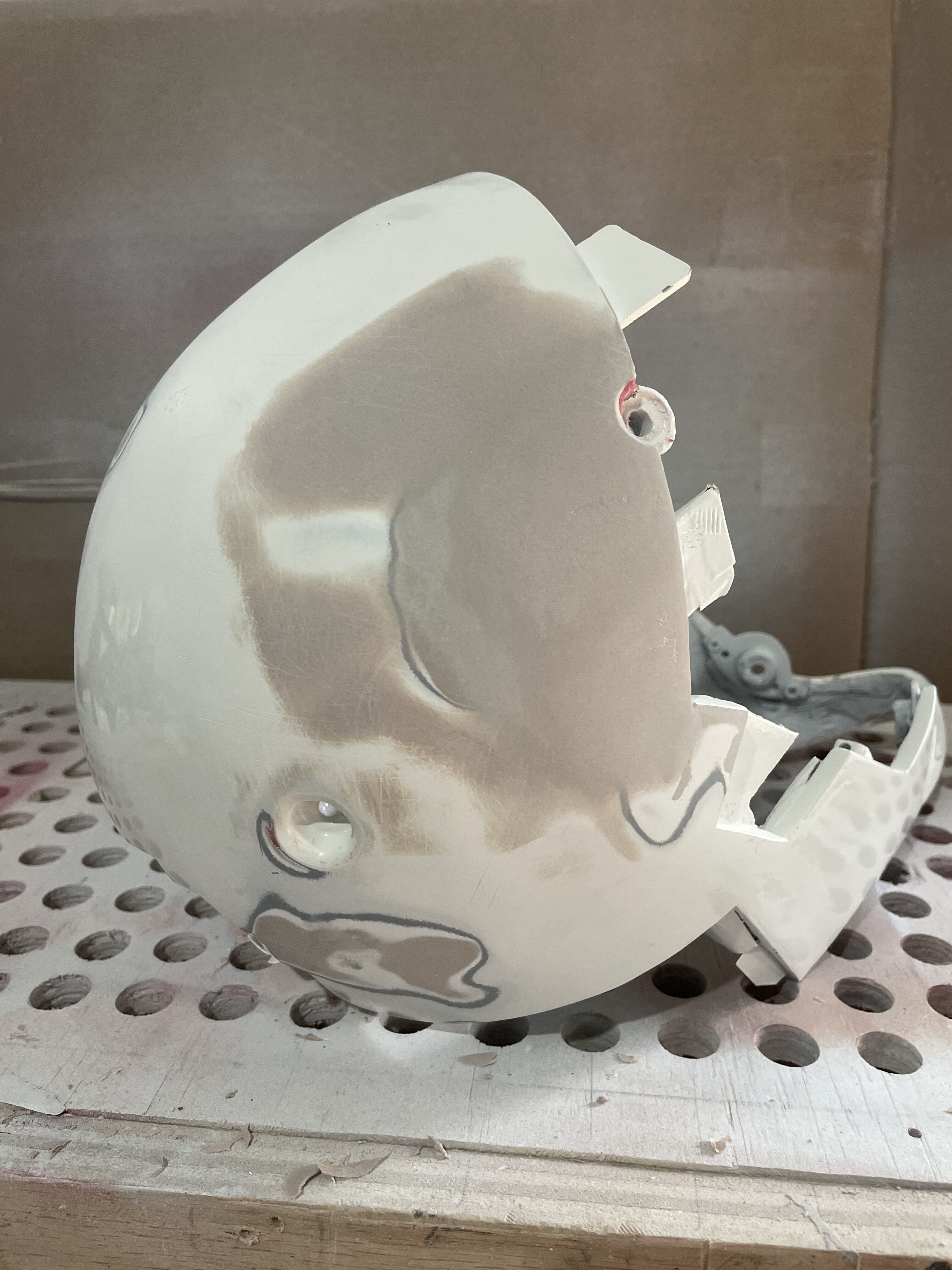

I didn’t take pics of the damage I found, as I was absolutely in shock. I literally lost my breath when I saw how many cracks were in it. Turns out, the cracks only went bondo deep. The helmet was in no way distorted. Once I took my dremel with a grinding bit and grooved out the cracks, they stopped at the fiberglass. However there were some large chunks of bondo that had to come out. These pics are the start of the repair phase:
Turns out this thing was completely salvageable. I sanded a good deal back so I could start applying bondo again. Two coats of bondo later it was back to shape.
Then came the spot putty…again.
I actually managed to get paint on this thing this evening, two days after I thought I’d be starting over again from scratch.
Words can’t express how devastated I was Monday. It made me nauseous. So much work undone in seconds. The fact this thing survived dumbfounds me. I guess it can actually take a real life hit, so perhaps it’s truly a “helmet”. I contemplated even mentioning this huge mishap, but you guys have followed me from the start, so I figured why not? If anything, it can be a lesson to anyone building something like this to never admit defeat until you verify that it’s a lost cause. I lost sleep Monday night because of it. Turns out it really wasn’t that bad. I mean, my awesome paint job was ruined, and I lost a day and a half fixing it. I can say it’s out of harms way curing tonight.

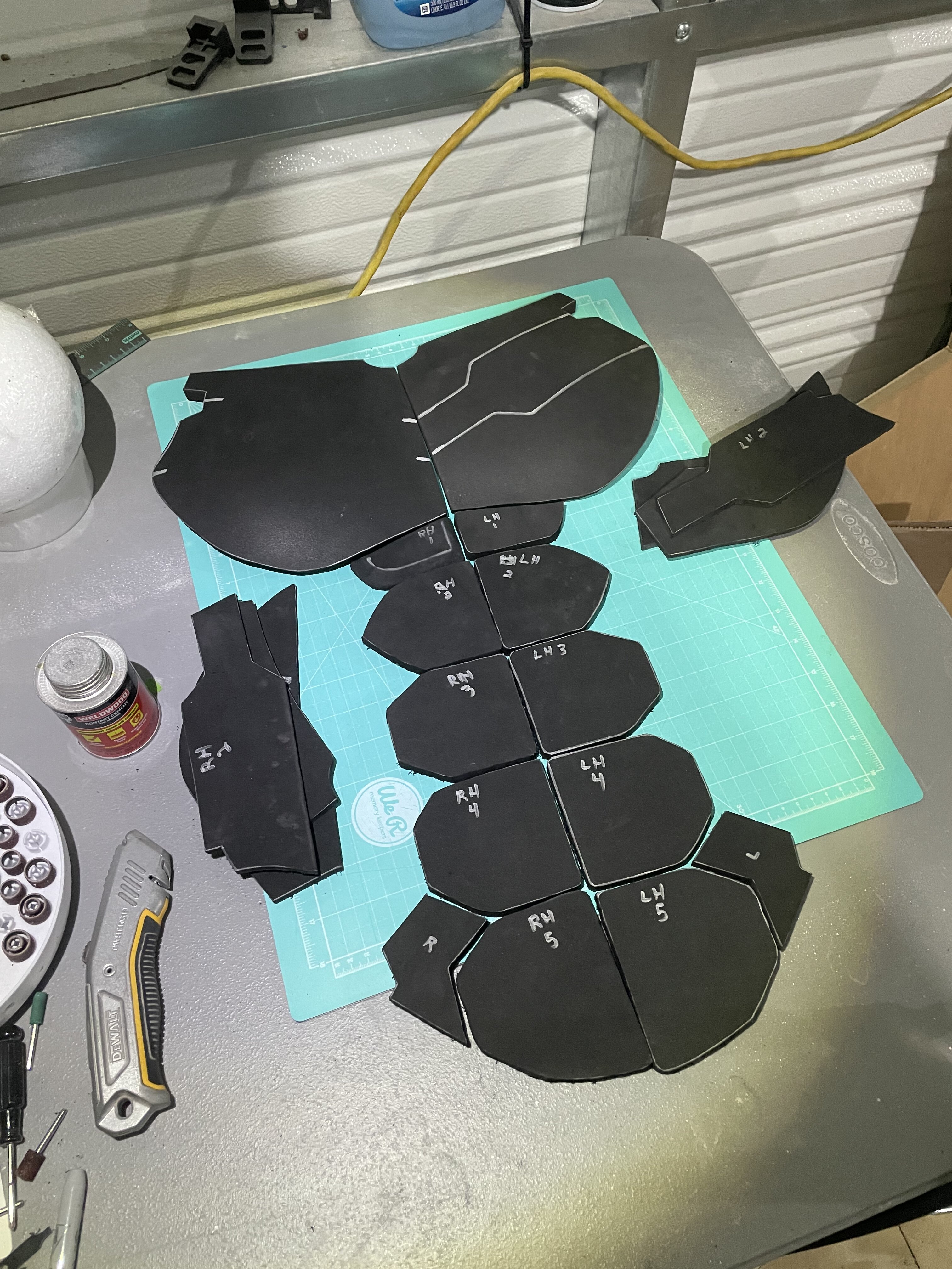

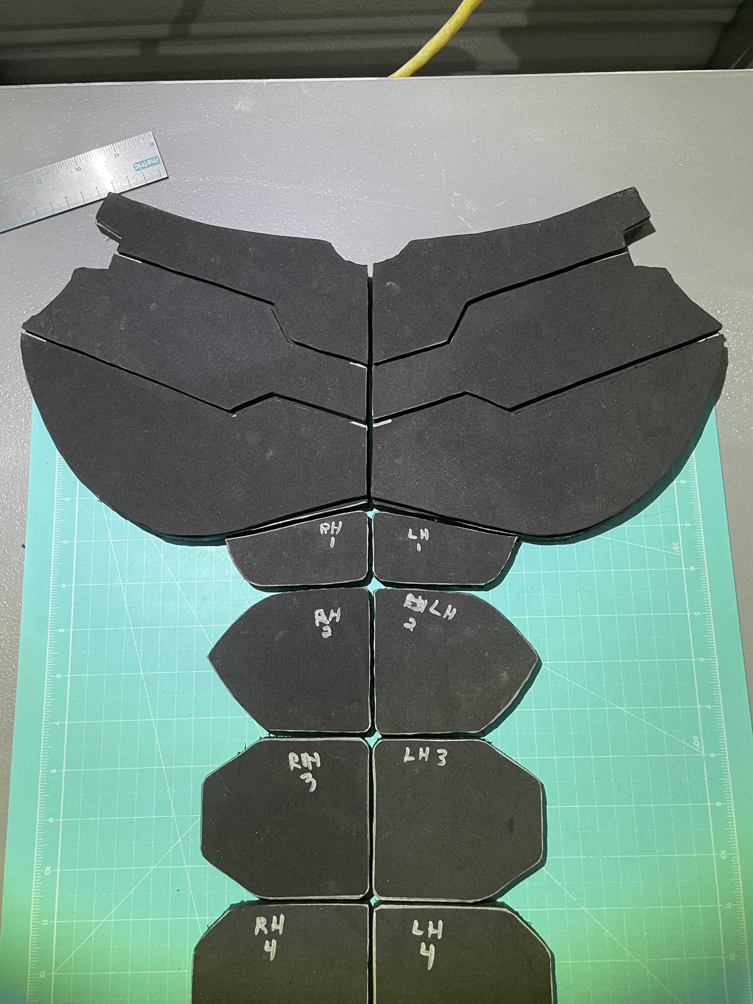

Being the weather was crappy and couldn’t paint, I decided to try working on the suit a bit. I am so glad I was recommended to watch Punished Props’ YouTube channel. I would have never thought to use my vertical bandsaw to cut foam. It makes 90° cuts so much easier. It’ll help me with bevel cuts too, as I can tilt the platform on it. Anyway, I started cutting out the pecs/abs sections, as I’d already made templates months ago.
I started to go around the edges with the dremel with a fine stone bit. I may need to get less aggressive sanding drums, or just adjust my technique. I started playing around with the heat gun and shaping the pecs.
I then took a small piece and started sanding it to the shape it’s supposed to be.
I ran out of time after I did this. I’m super eager to continue work on the suit.

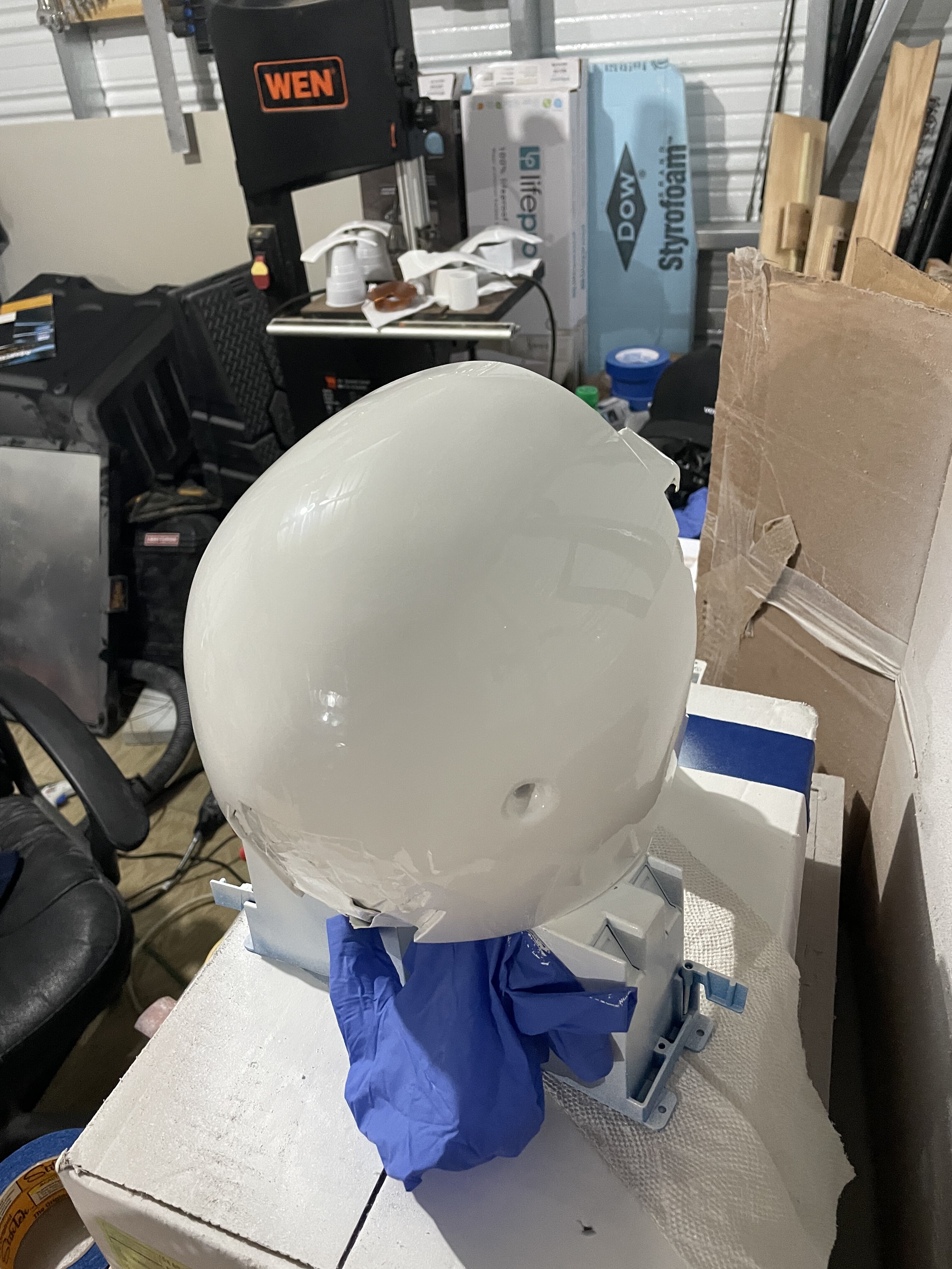

I took Friday and Saturday off from the build, as my wife is off those days and I spent time with her. Sunday, the weather was wonderful. Humidity was way down for South Georgia, so I got to painting around noon.
I didn’t take pics during the process, but all of it is painted and has a few coats of clear.
I’ll let it cure for a few days before I mess with it. I still need to make my decals. I’ll probably do that tonight so the clear coat I spray on them will have time to dry for a few days. But that’s all the progress I have for now. Hope everyone is doing well. Have a great one!

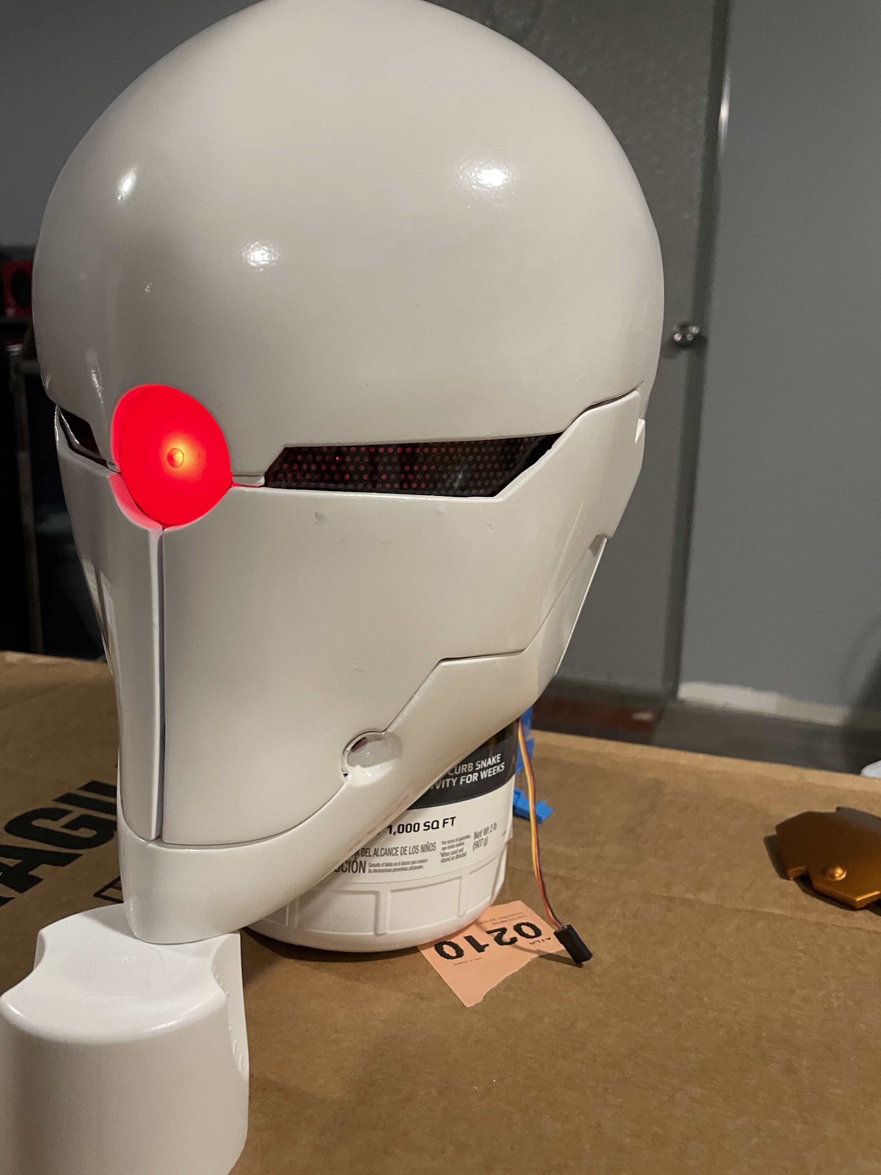

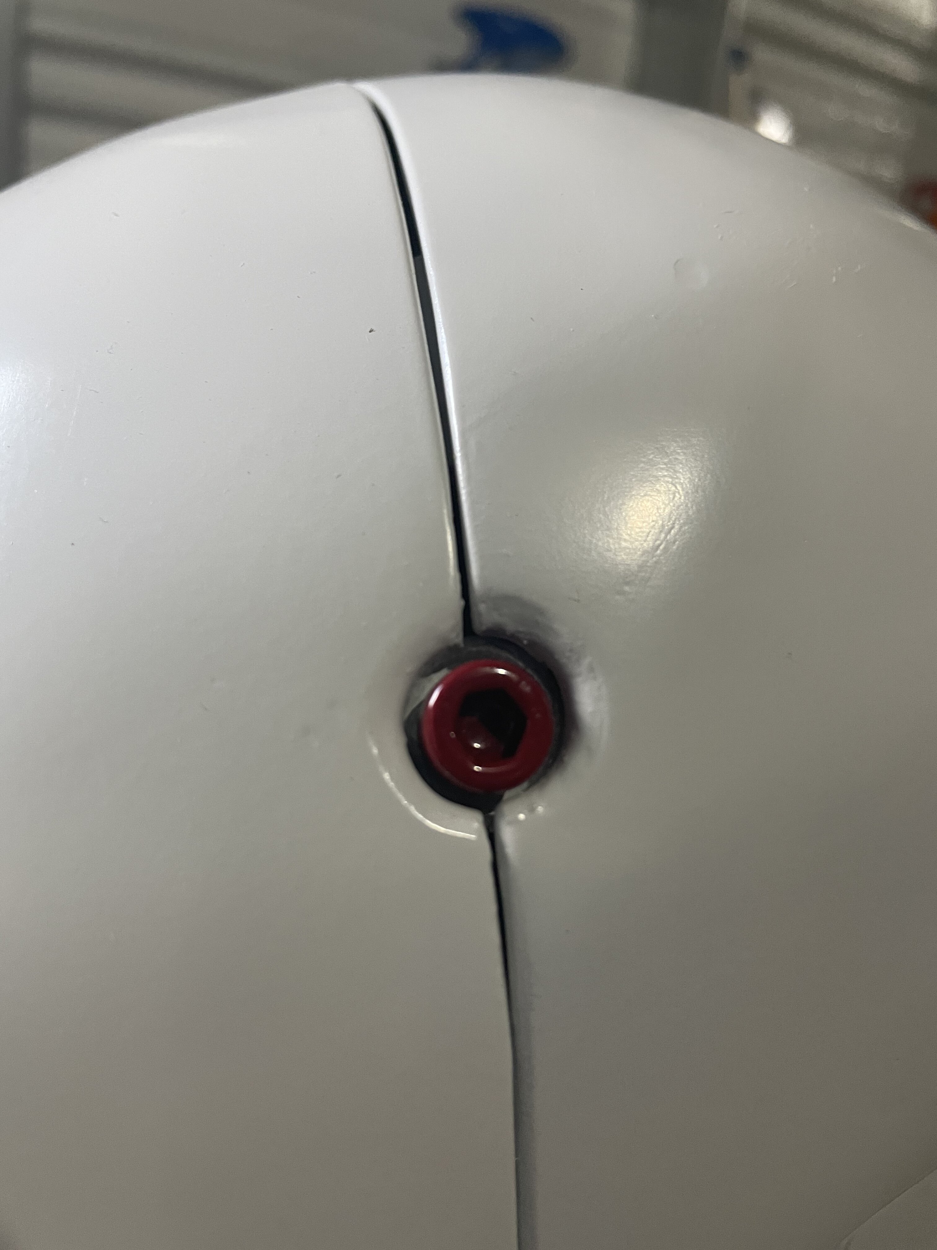

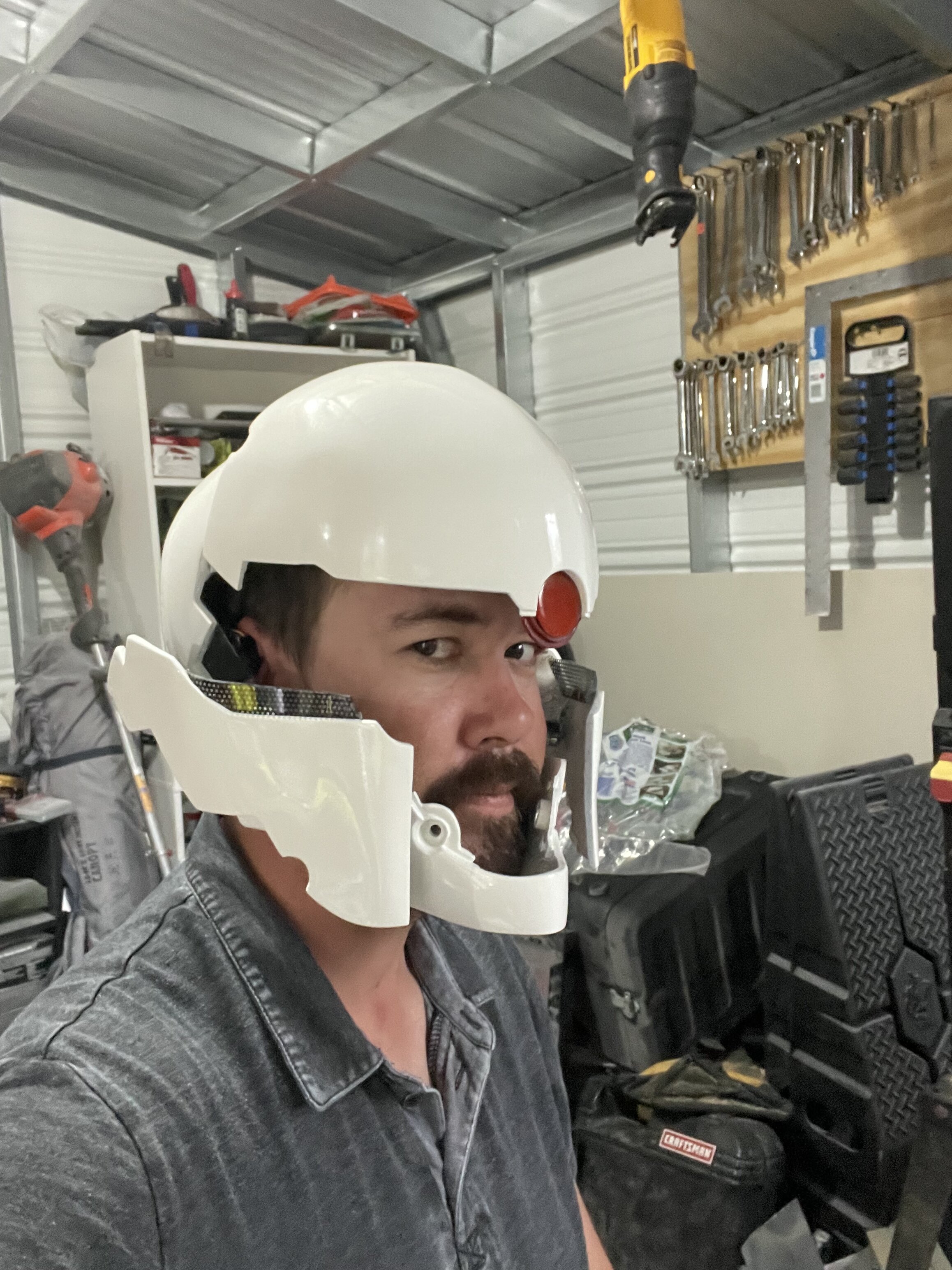

Hey guys. Update time. I let everything dry for a few days, and did a “dry fit” without all the servos and such mounted. I hooked up the led to a watch battery just for kicks.
I’m pretty pleased overall with the finish. I guess at some point, some spot putty worked it’s way down in the screw holes for the eye lenses, and started pushing out when I was installing the screws. I should be able to fix it easily.
I then went on to install all of the servos and screwed a few “sensors” I had to try it on.
I’ll say this, once I manage to shoehorn my big head in this thing, it’s kinda alright. However, it is awful to put on, and kinda painful, especially on my ears and forehead. I have to shimmy between the servos on the sides. All the flexing has kinda stress cracked some of the spots I had to fix when it got damaged.
When I initially scaled this thing, I didn’t have the servos on hand, but knew they were roughly 1/2” wide. What I didn’t know, was how and where exactly I’d mount them. Also, the rear neck flaps don’t like to stay shut very well and there’s NO way I can make a lip that the top can rest on with more magnets. I won’t be able to fit into it. Another issue, I have to position the helmet just right for the faceplates to close all the way. The front swing arms hit my cheeks. I can scoot the helmet back some but it doesn’t look right when opened. I’m gonna try one more thing with them before I re-evaluate. Also, I didn’t lay fiberglass nearly thick enough where the brackets for them screw in. They keep stripping out.
In hindsight, the helmet needs to be about 1/2-3/4” wider. So, I’ve already dove into Blender and started modifying my 3D file for Mark 3 in the event this one ends up a shiny paperweight. I’ve revised a few things that will improve it. A revised neck opening, not so sharp corners on the top surfaces, and I changed the angle for the neck covers at the front to follow the downward angle of the rear of the faceplates instead of being nearly 90°. I will continue to work on this one and finish it. If anything, I’ll apply all the same mechanisms that make this one operate into the new one, so this one was like a prototype. I’ve proven the concept so I can’t beat myself up too much. I’m gonna start pep work on the new one tonight. Thanks for the continued support guys. I appreciate it!
