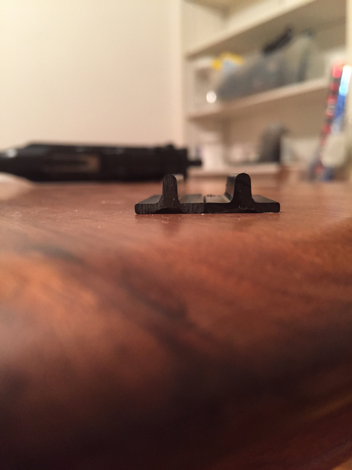

I mean the profile of the T-track when you look at it on the end. Here is a couple example of more accurate T-track profiles. There are better pics of the profiles, best I could find quickly.

Hi, thank you, yes I can see that profile on the picture.
Did the ANH version have those stuck on or riveted/screwed in? I was wondering if it’s best not to do that as it’s a major change to the bottom of the flash but not sure.

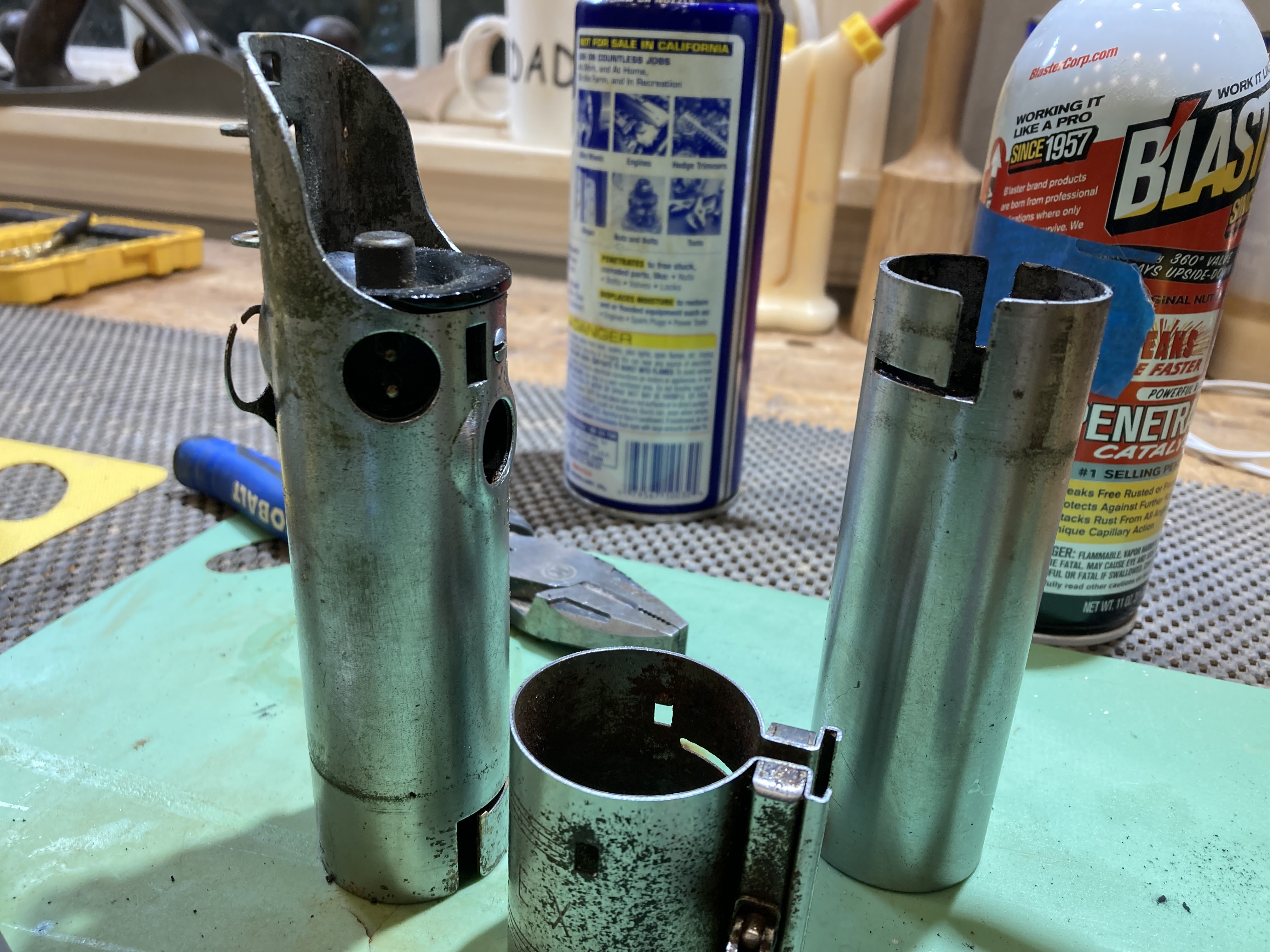

If you’re keeping it in a climate controlled environment, it shouldn’t continue to rust. You could try some paste wax on the inside of the clamp to add a protective layer… the flash could have likely been in a damp place or maybe the old batteries were left in for a while.
I have a Graflex that had batteries left in it for probably 50+ years and it took a toll.
The last battery basically fused to the inside of the flash. It took hours to open it up and clean out what was left.
