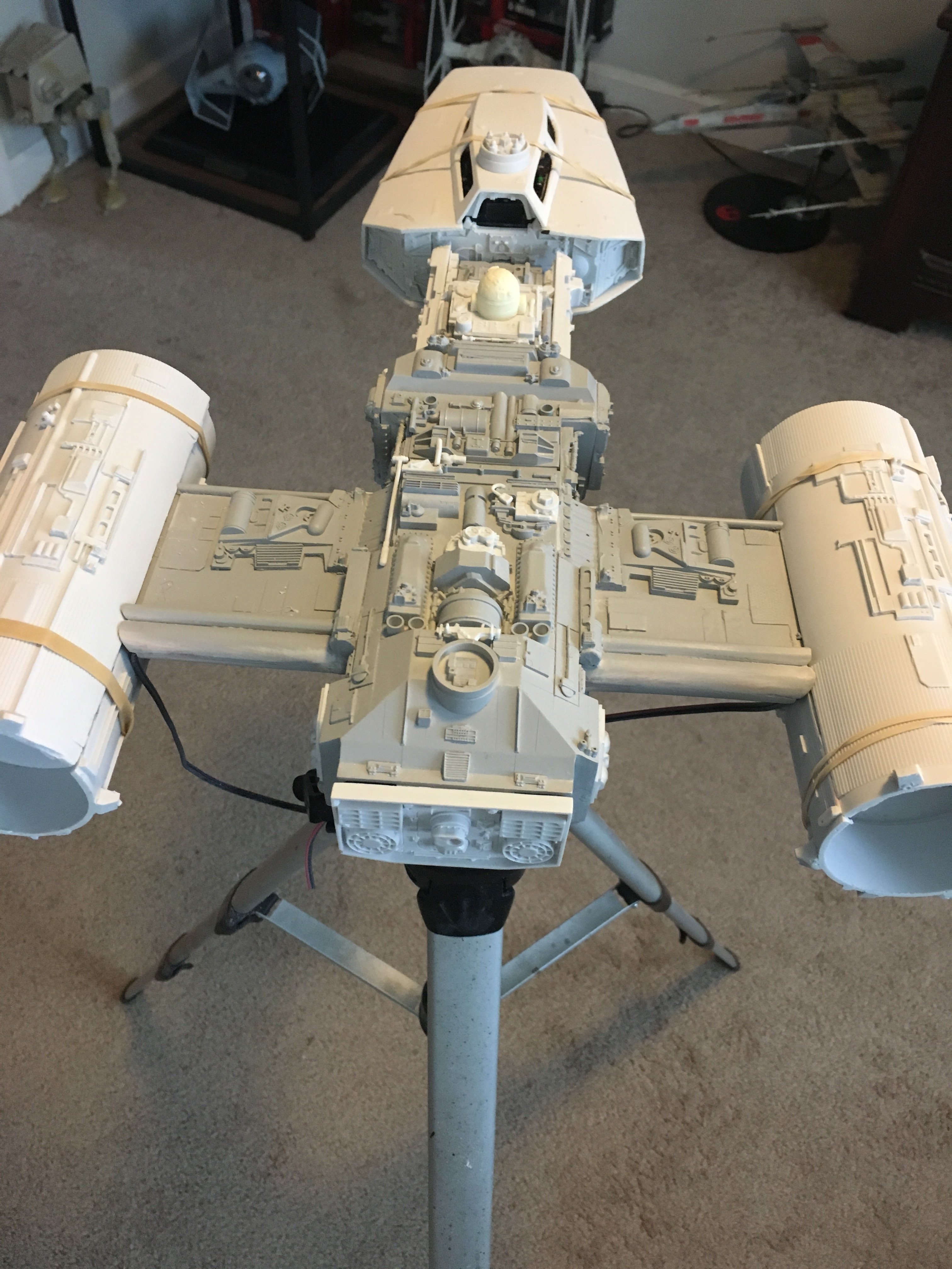

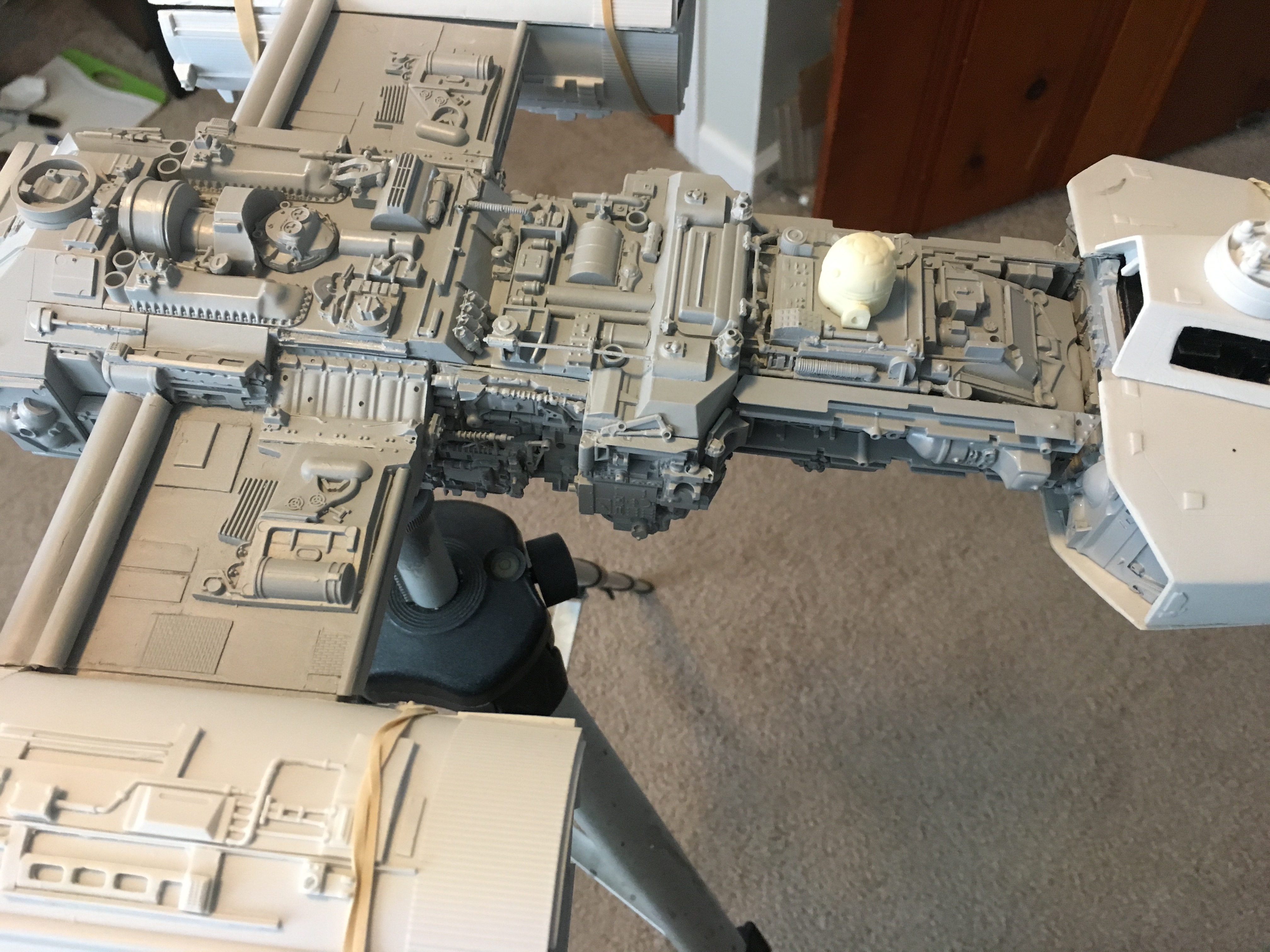

I use a camera tripod as a work stand. I can adjust it up to 4' high, and it's also great for painting. It's nice, because if I need a break from sitting and working, I can raise the model up to a very comfortable height to work on standing up.
Dont have any specific pics of the stand, but this will give you the gist of it...
I find it very handy, and it was inexpensive.

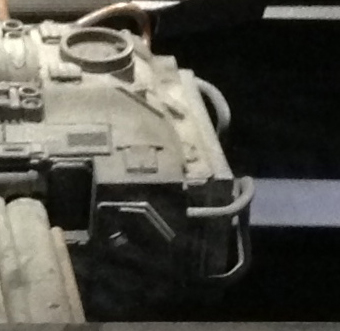

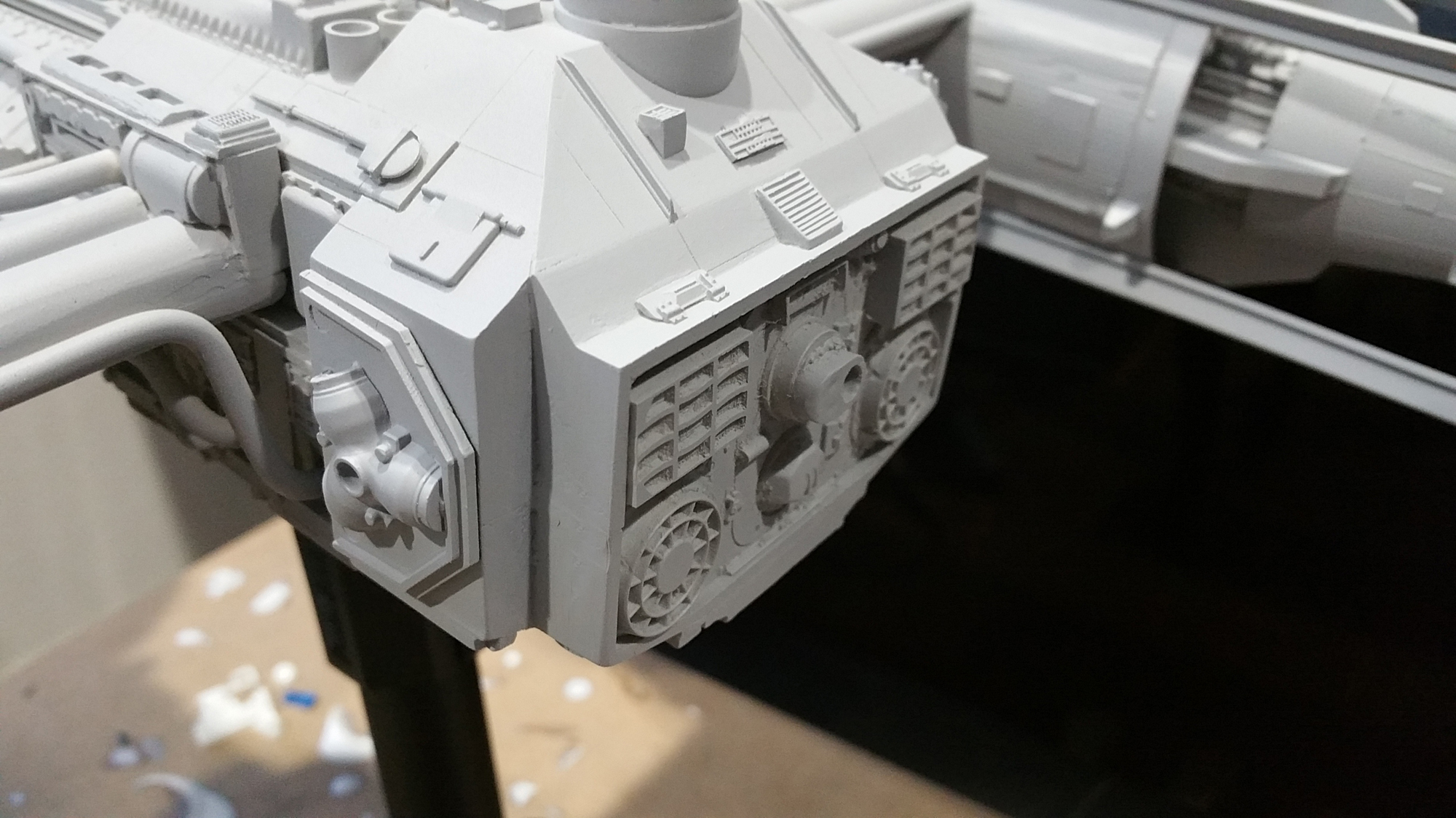

Hey Jkirkon, looking good. I don't know if you already noticed, forgive me if you have, but the butt plate is set up for the Red Jammer Y on this kit. Meaning it sticks out further than all the others, including Tie Killer. To show you what I mean the image on the left is Red Jammer and the one on the right is the Ladd Y.
One way to fix this is to trim off the edges on the given butt plate and make is so it can be inserted into the void like this.
Again, forgive me if you already know this, but may be helpful for someone making this kit none the less.
