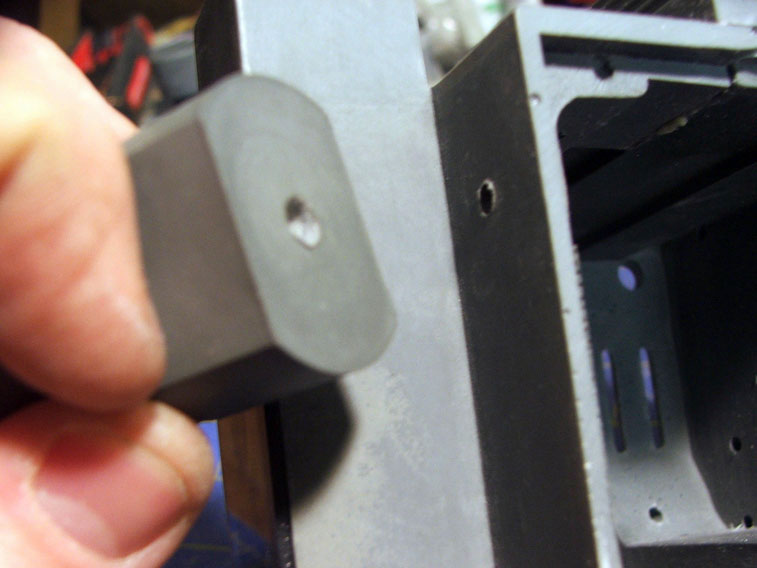

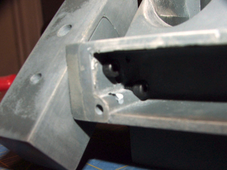

Attaching the Trigger Box is rather simple. I start by attaching the side plate to the Rear Instrument Bar using two button head screws using the pre-marked holes at quadrants 2 and 4. Once in place I drilled two holes through quadrants 1 and 3, straight through into the inside of the Rear Instrument Bar.
Once drilled, I used an angled Allen wrench to bolt the box to the side plate through the inside of the Rear Instrument Bar.

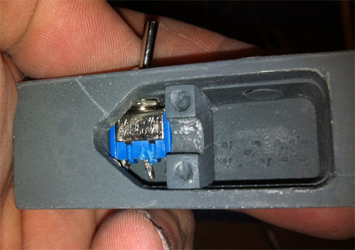

Before we get too far ahead you need to decide what size switch you want to use. The commonly acceptable sizes are mini and micro. If you are using a mini switch, you do not want to glue down the inside bracket before installing the switch, otherwise you won’t have a large enough opening to fit the switch. The inside bracket fits very tightly into the trigger box, so when it does come to gluing it down I would suggest just adding a tiny drop of super glue, this way you can break the bond should you ever need to remove the switch. If you are using the micro then this probably will not be an issue, this may not even be an issue for all mini switches, just check the fit before you glue the bracket down.

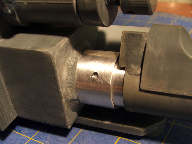

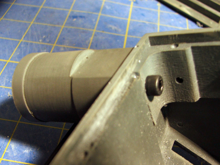

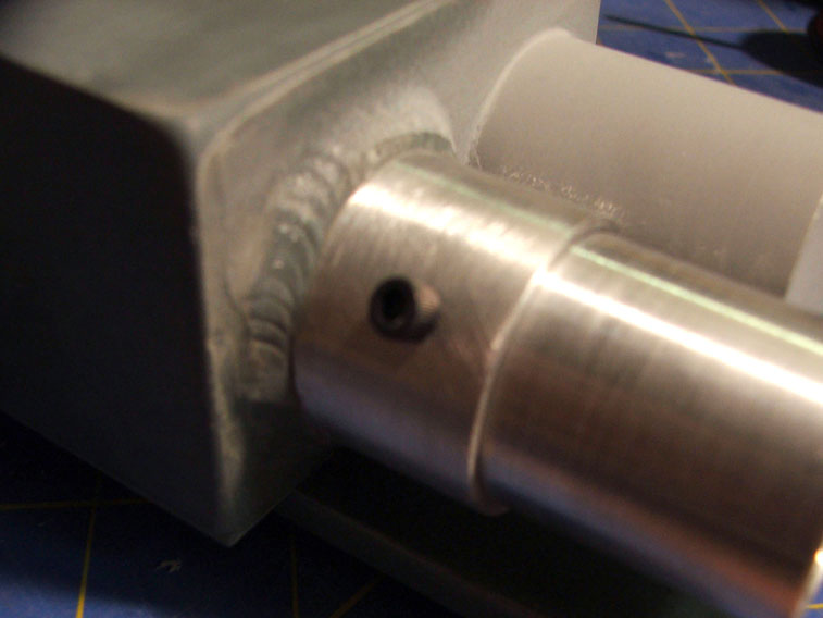

Another big change in this kit from previous versions is how the front handle attaches. Previously there was a resin peg cast with the gun body that you’d slide your handle over. Now I’ve oped to make things closer to how they did it with the film props by casting a real aluminum nub onto the front of the gun. If you do not care about rotating your barrel, you can go ahead and glue the front handle over the supplied aluminum tube then secure it to the proton gun body using an Allen head bolt.

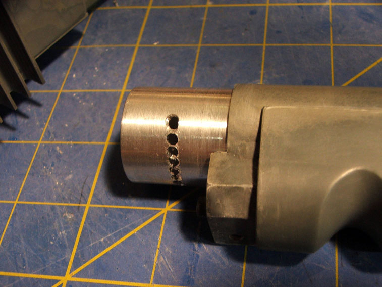

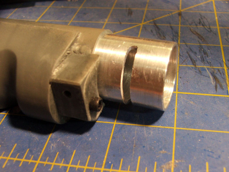

But if you are like me and want your front barrel to rotate as it does in the film, it’s a fairly simple task that can be accomplished with just a drill and a small file. My method is to glue the aluminum tube inside of the front handle as mentioned above, then, with the barrel facing away from me, slide this into the nub and rotate the grip counter-clockwise until the barrel lock is just a hair away from touching the front cylinder. I then drilled my first hole.
I then rotated the barrel clockwise ever so slightly and drilled another hole. Rinse and repeat until the barrel lock is now a hair away from touching the gun track. When you are done it should look like above.
I then took a small file to the holes to open them up. The aluminum is fairly soft and will file easily.
After a few minutes I’ve carved out this nice little notch for the bolt to fit into. When you attach this to the nub the slot will allow it to rotate back and forth along the bolt.

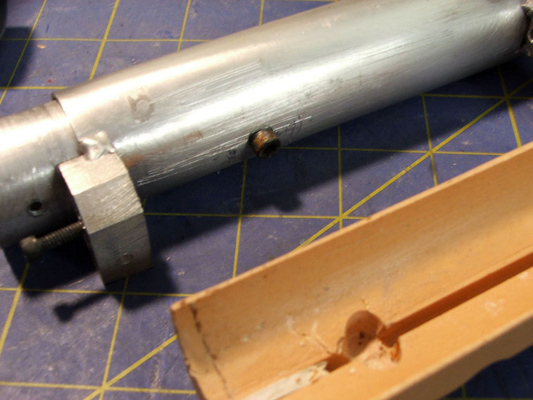

Alternatively you can use a welded aluminum front handle from one of the metal fabricators on GBFans. Installing it isn’t all that different from the resin version, but the placement of the slot changes. Rather than rotating the grip inside of the nub, the nub is secured to the inner tube and the outer tube rotates around it. The slot is carved further up the tube where the bolt would be covered up by the front grip.
Carve a notch in the grip so it can fit over the bolt.
Then secure the grip to the handle using a bolt through the Barrel Lock and the front ear.

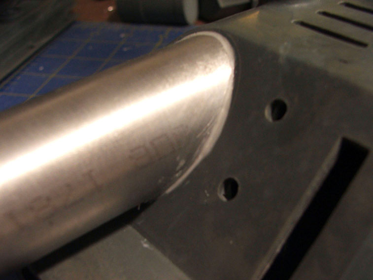

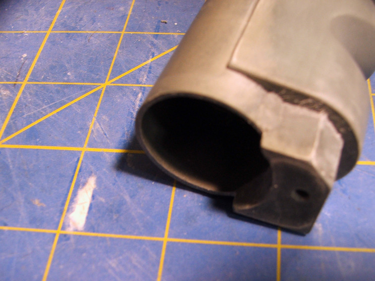

For the rear handle you want to trace the inside of the gun body onto your tube and then cut out a notch like this.
Added glue to all the surfaces the tube is going to touch inside of the gun. I used Gorilla Glue. I would suggest that or some kind of epoxy. The tube is then screwed down to the mounting block in the inside of the gun body.

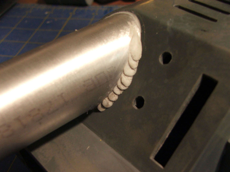

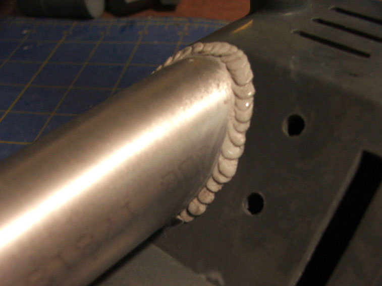

Using an epoxy putty to make a fake weld, I started by filling in the seam between the bun body and tube.
To make my beads I rolled out a thin string of the putty then cut it up into tiny sections. I’d roll them in balls before placing them.
Press the putty bead down along the seam and then pull away as you push down. It’s like a half circle that is then smeared off in one direction. Always follow the same direction.
I like to look at reference material while I do this so I can follow the bead pattern as best I can. The thrower I was modeling this after had them going counter-clockwise around the rear handle seam.

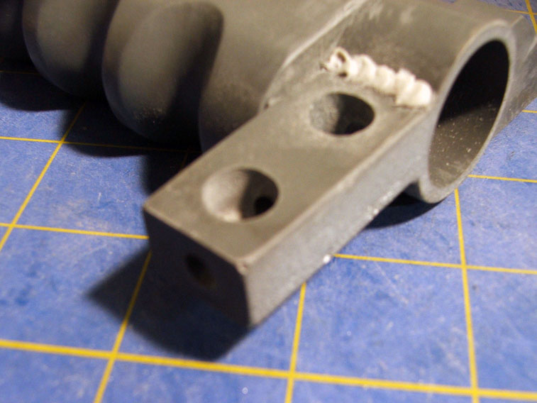

I did the same to cover a seam line on the front handle ear.

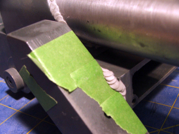

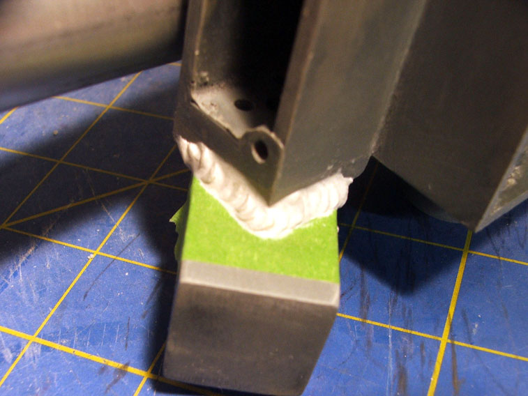

The original film prop had a pretty heavy weld along the Rear Instrument Bar and Trigger Box. Since I want to be able to remove my Trigger Box in the future, I had to get a little creative with this application. I want the fake weld to stick to the Rear Instrument Bar, but not the Trigger Box, so I masked off the Trigger Box and then applied a release.
Same process as before.
After the putty has cured, I take fresh putty and squeeze it over the beads. This smooths them out a bit and completes the look.
Same as above. At this time I also filled any bubbles or casting seams that needed to be patched up.
Thanks to the tape and the release the Trigger Box separated from the weld just fine.

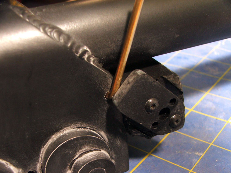

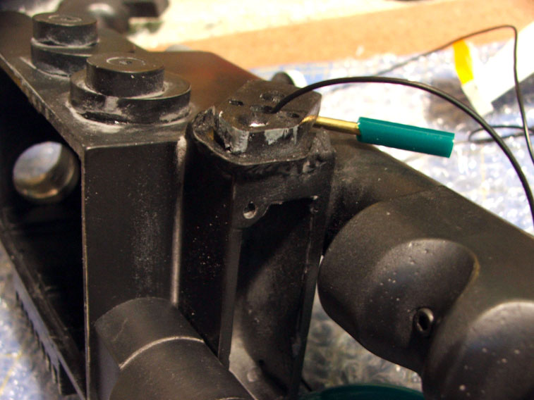

After painting we are ready to put it all back together. Here I’ve loosened the Trigger Box side plate so I could place the brass rod.
Running wires for the Heavy Props light kit.

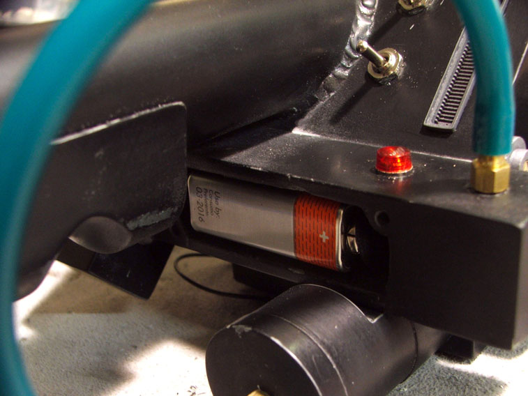

The light kit runs off of a 9volt battery, which happens to fit perfectly inside of the Rear Instrument Bar.
