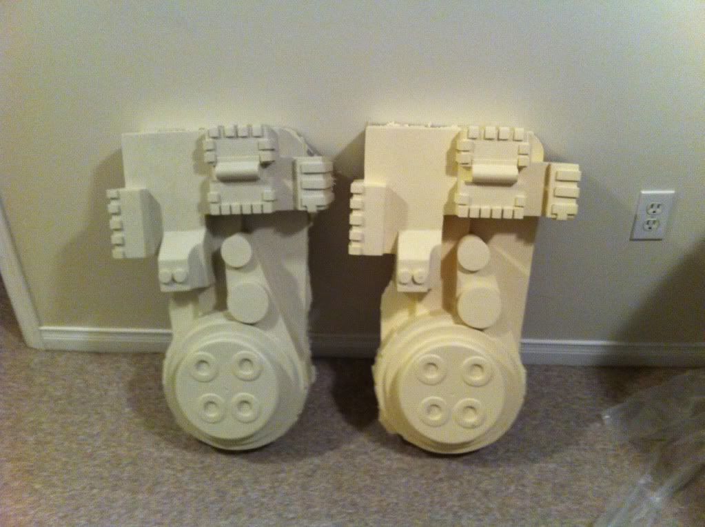

Hey everyone sorry that it has been a while since I have made a post. But I have some new pics of the pack for everyone. Made some little changes and I hope you like them.
So some of the changes are I put a fifth strip on the power cell, and I re-moved the ion arm for molding. I put the 2 PPD's on the pack and the spacer for the bumper guard on the cyclotron. I had also added the 2 block pieces at the bottom of the pack.
I hope everyone likes it. Also I have an interest threat going in the junkyard now. Iam going to start molding it
Hello everyone sorry it has been awhile since my last post. I have been changing some things up on my pack.
So as you can see the ion arm and N-filter are off it I will be molding them seperately to save cost in mold supplys. And the trim parts going around the cyclotron have been changed as well.
I also fixed the over hang where the PPD's are.
Well I hope everyone likes the changes.

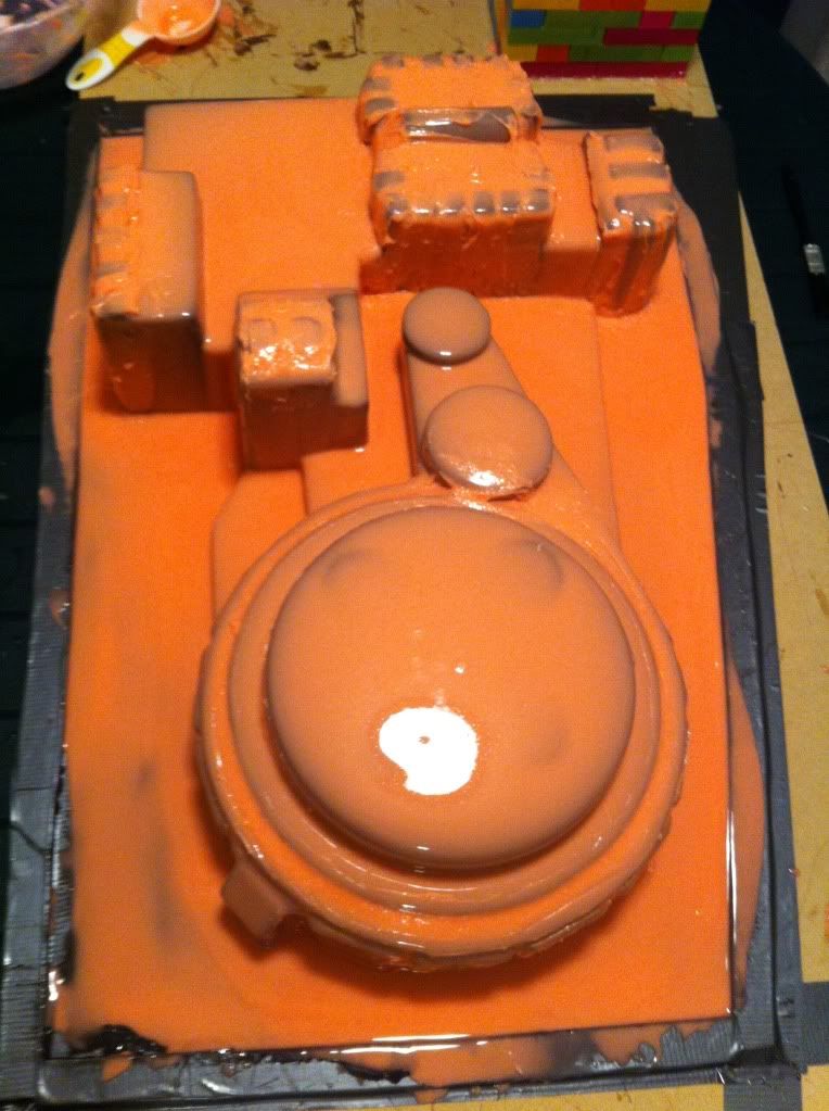

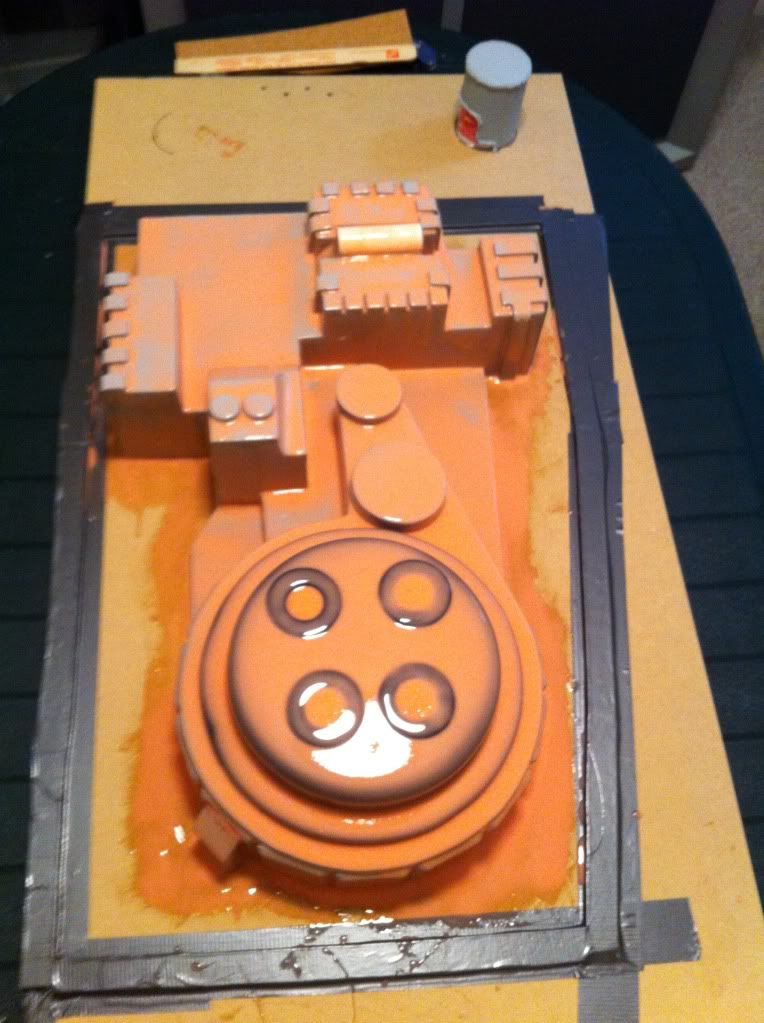

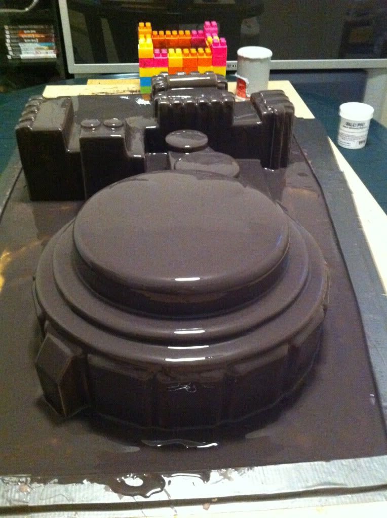

These were the final changes. next making the molds first step silicon :)

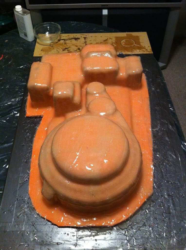

I used a silicon dye so I could tell that I was making even coats.
Also had to make sure that the silicon is nice and thick. Due to when removing the copy no parts could tear.

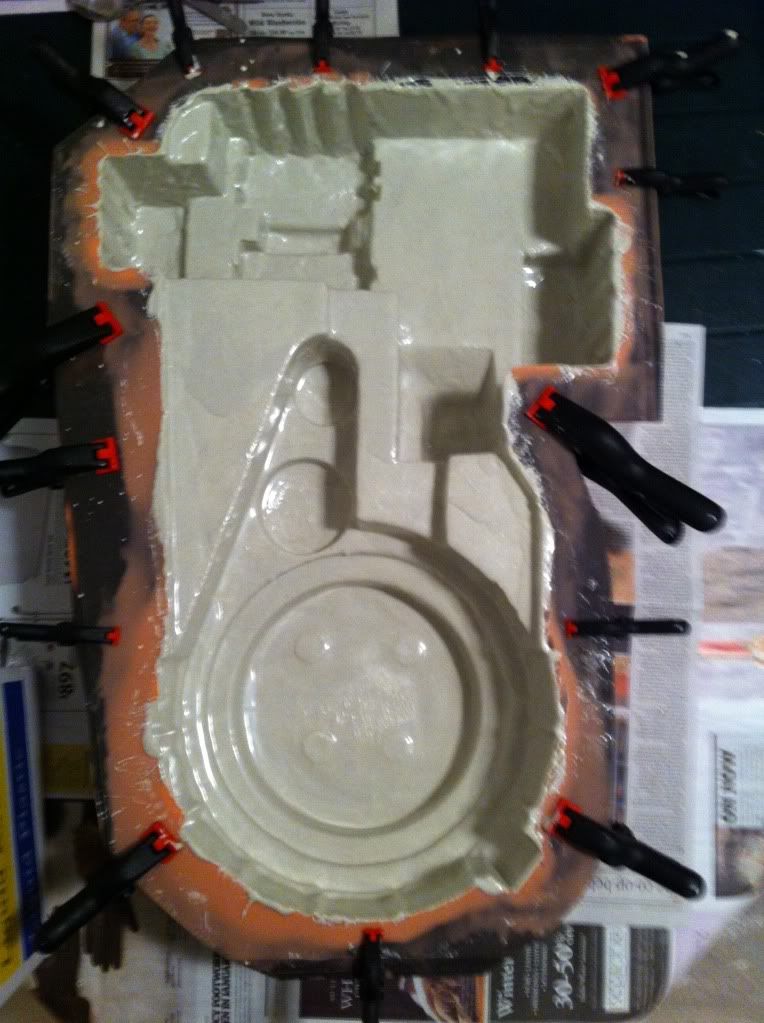

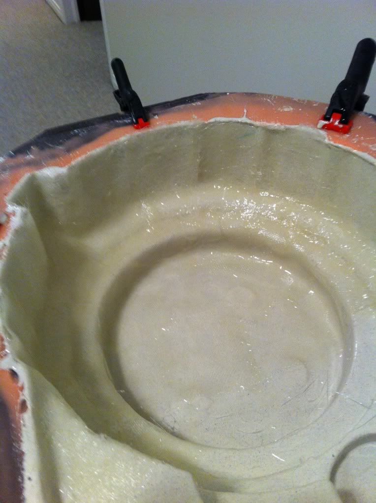

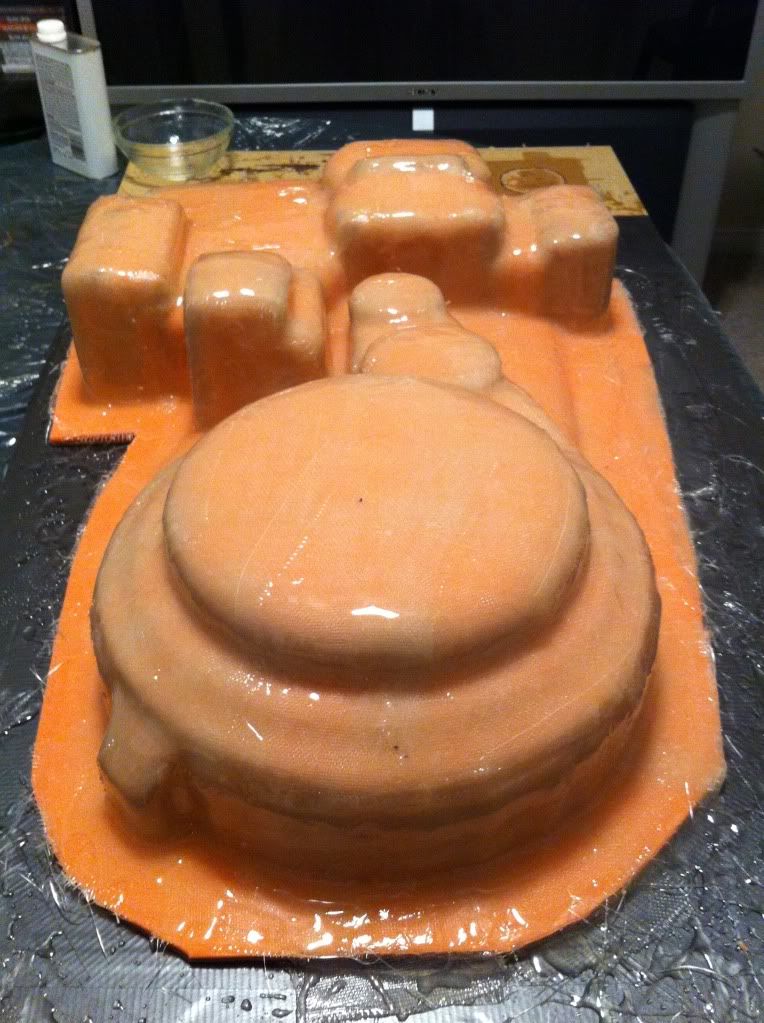

Now on to the fiberglass shell.
Then wait 24 hours (ding) and presto lol.
not going to lie working with the silicon was fun lol.

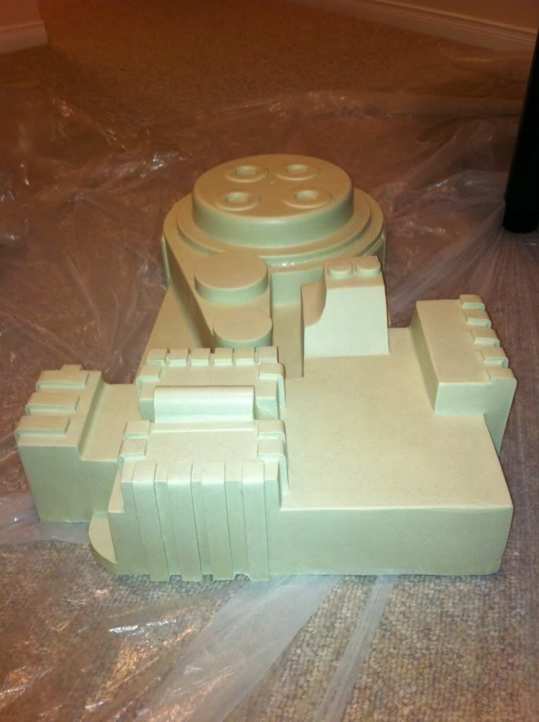

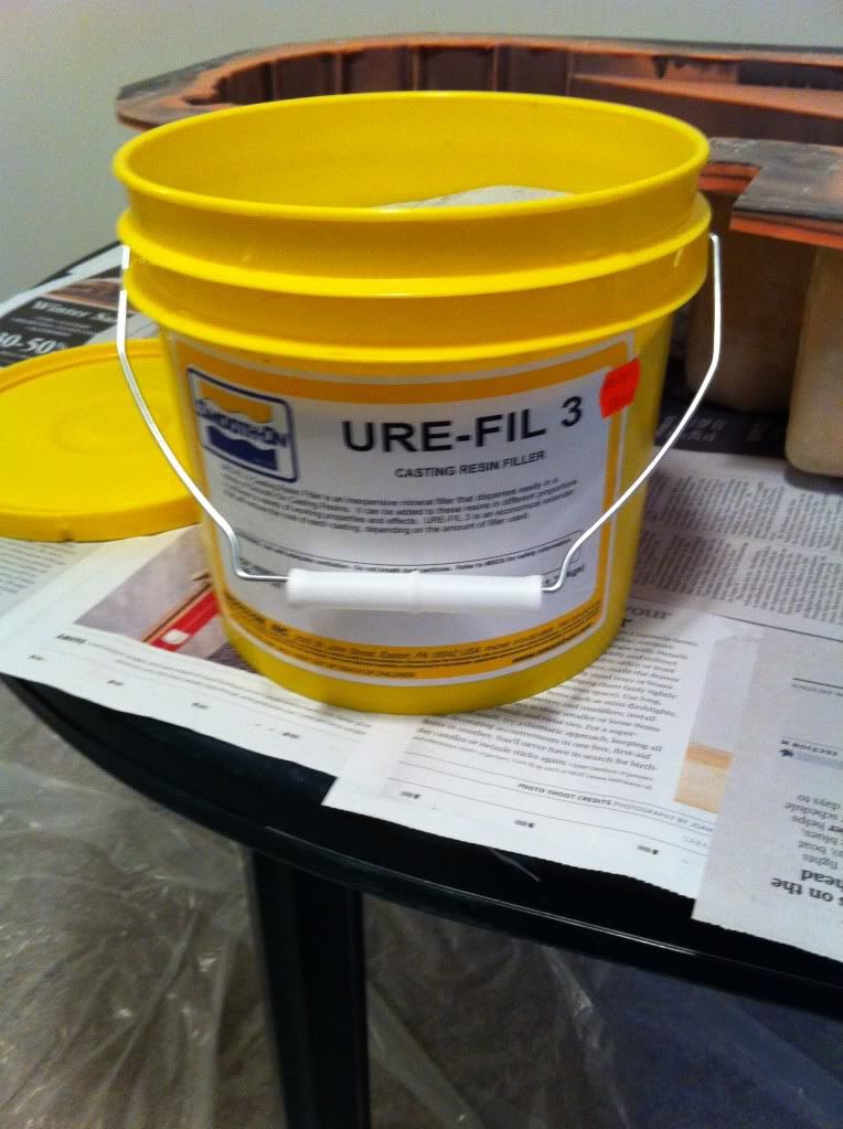

But one to the making of the first copy. For this I used Smooth cast 320 and Ure-fil 3 and renforced the pack with fiberglass
What the Ure-fil 3 did was make the smooth cast 320 thicker so I could basicly paint it on with out having it run.
Then the fibergalss.
After all is said and done my first unlicensed nuclear accelerator lol.
Popping the fist copy was unbelievably hard to do. Took my self and a friend to pull it. A awesome tip is coat the fiberglass shell with vaseline it makes a difference trust me.

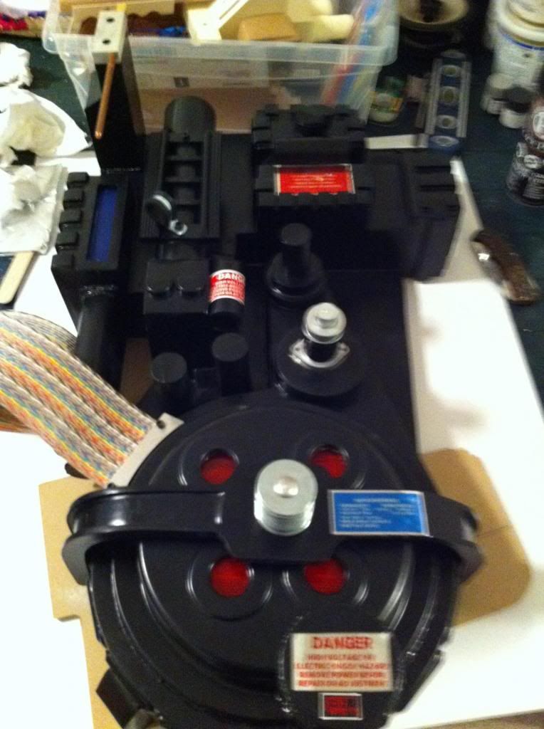

Well again it has been some time since I last updated my thread but I have some new pictures of my pack to show.
getting the stickers makes the pack jump out I think.
Also for the red and blue lens on my pack I used something alittle different I went with refelctors and for the blue lens well it was a lid for a tubaware lol.
I got the ribon cable from GBfan.com again allot of websites out there. Another website I got some parts from was bobspropshop.com as you can see now I have been adding on the geeblies.

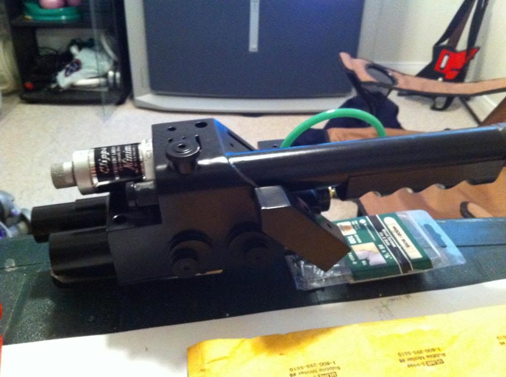

I would also thank Throwing Chickens for the proton wand. I purchased one of his for my pack.
Just seeing it like this was such a good feeling lots of work still to do. more pics will be coming.
