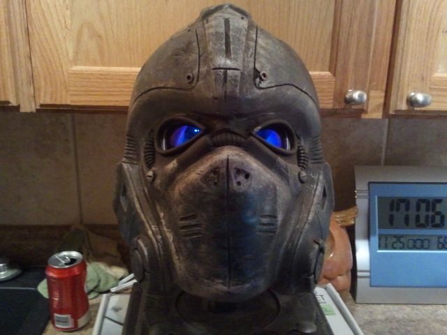

Gears of War 3 Clay Carmine helmet
SENTI3NT6
Finished this up a while back for a friend thought id share it.
Thanks for looking!

What was the process of making it? And is it wearable?

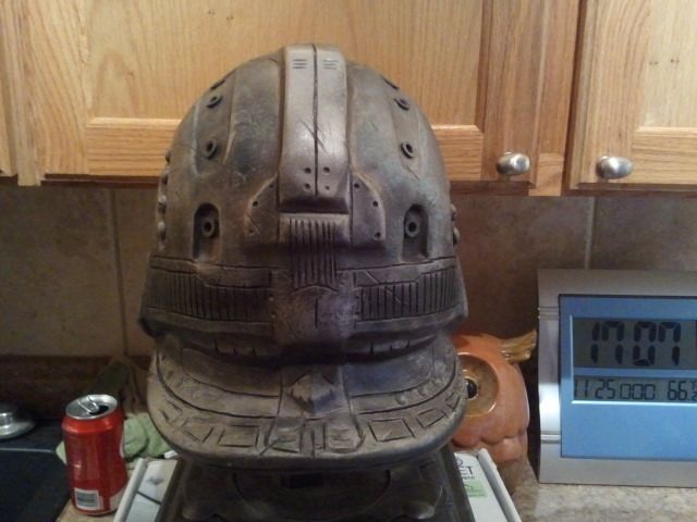

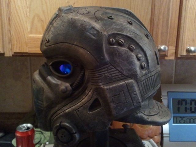

It was just a basic pep build but instead of fiberglass or rondo I used a generic smoothcast type resin to harden it. After that just a lot of bondo and sanding to get the basic helmet shape nice and smooth. The detailing I did with a dremel and used playing cards to create the shape of the raised parts and filled them with rondo and cleaned em up a bit. It is wearable but fairly toxic so it just a display piece for now. Thanks for looking!
